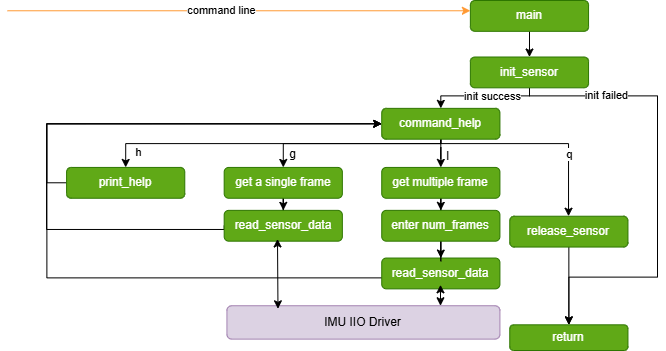

Software architecture diagram:
3.13.2.3. Data Flow Description
  1. The application layer uses init_sensor() to find and validate the target IIO device under /sys/bus/iio/devices/.
  2. The sensor abstraction layer reads raw values from nodes such as in_accel_*_raw and in_anglvel_*_raw, and converts them to physical quantities using scale.
  3. The application layer obtains one frame of ImuData via read_sensor_data(), then calls print_imu_data() to output acceleration (m/s²), angular velocity (rad/s), and timestamp.

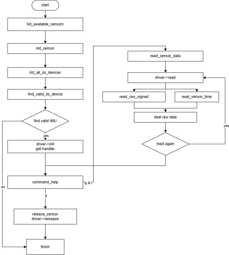

3.13.2.6. API Process Description
sample_imu_iio is built primarily on standard kernel IIO interfaces. The overall process based on program functions is as follows:
  1. List available sensors: Call list_available_sensors() to traverse the built-in supported sensor driver list and print the names.
  2. Initialize sensor: Call init_sensor(), passing the sensor type to find and validate the corresponding IIO device, then call the specific driver initialization function.
  3. Read sensor data: Call read_sensor_data(); the sensor abstraction layer reads one frame of data and fills ImuData.
  4. Release sensor resources: Call release_sensor() to release the driver context and handle.
api_process

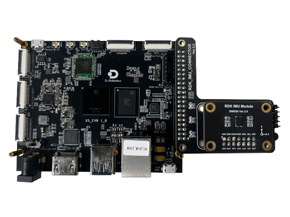

Hardware Environment Setup
Refer to the following connection method (using BMI08x sensor):
40pin_connect
After confirming the hardware connection is correct, verify whether the corresponding driver configuration is enabled. (Since this sensor is not an onboard device, the following configurations may be disabled by default in the SDK. Please check whether they are enabled in the actual code before use.)

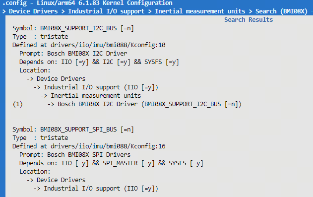

Then check whether the corresponding defconfig (e.g., hobot_x5_soc_defconfig used by default on EVB) has enabled:
CONFIG_BMI08X_SUPPORT_I2C_BUS=m
CONFIG_BMI08X_SUPPORT_SPI_BUS=m

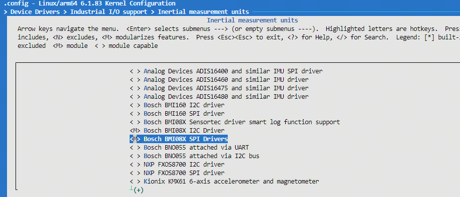

These can be enabled via menuconfig. The search location can refer to the screenshot below:
boot_menuconfig_search
The enabling method can refer to the screenshot below:
boot_menuconfig_config

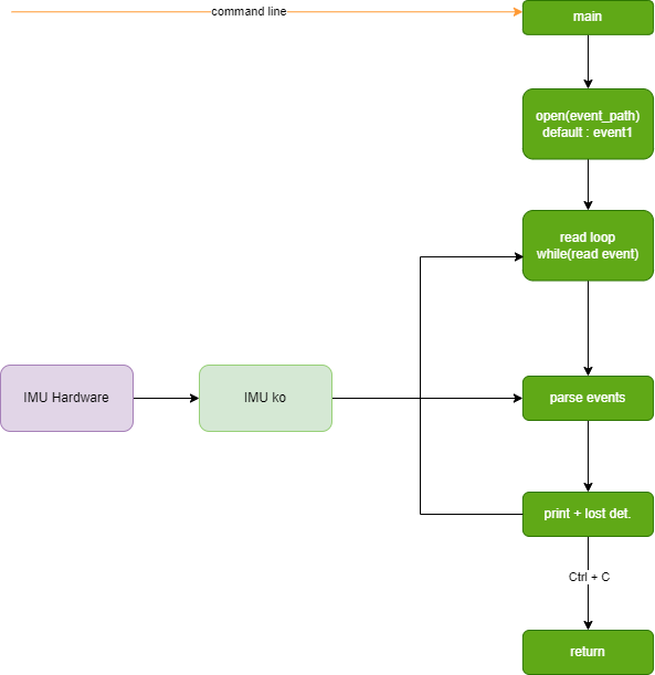

sample_imu_input demonstrates how to read IMU data reported by the driver through the Linux Input subsystem. Unlike the sysfs polling/reading approach in sample_imu_iio, this example reads the /dev/input/eventX node, parses six-axis raw values, hardware timestamps, and IRQ counts continuously reported by the driver via EV_MSC events, and performs packet loss detection based on timestamp intervals.
Features of this example:
  • Continuously reads driver-reported events; no interactive g/l/q menu
  • Outputs six-axis raw LSB values and 64-bit hardware timestamps (ns)
  • When the interval between adjacent frame timestamps exceeds 3.5 ms, it is treated as possible packet loss and a warning is printed
For prerequisites such as hardware connection, device tree, and kernel configuration, refer to sample_imu_iio Hardware Environment Setup. For basic IMU concepts, refer to Background Knowledge.

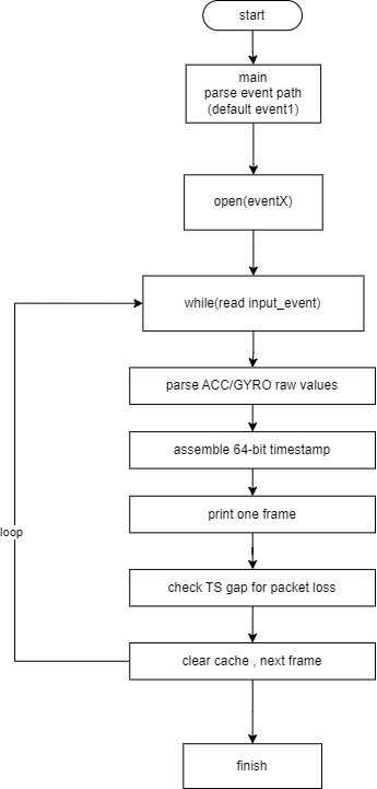

sample_imu_input.c starts from the main entry, opens the /dev/input/eventX device, and enters a read loop. Each time an input_event is read, it parses EV_MSC fields, assembles a frame on SYN_REPORT, prints six-axis data and timestamps, and performs packet loss detection based on adjacent frame timestamp intervals. The program runs continuously until the user presses Ctrl+C to exit.
3.13.3.3. Data Flow Description
  1. After each sampling completes, the kernel BMI088 driver reports multiple EV_MSC events through the Input subsystem (code = BMI088_MSC_DATA).
  2. One frame ends with SYN_REPORT; when the application receives SYN_REPORT, it assembles the cached 9 MSC fields into one frame of IMU data.
  3. The application prints ACC/GYRO raw values, timestamp, and IRQ count, and statistics packet loss based on adjacent timestamp differences.
MSC field order per frame:

sample_imu_input is implemented based on standard Linux Input interfaces. The main process is as follows:
  1. open() opens the /dev/input/eventX device node.
  2. Loop read() to read the input_event structure.
  3. Cache fields on EV_MSC events; assemble and print the frame on SYN_REPORT events.
  4. Determine packet loss based on the difference between adjacent hardware timestamps.
  5. On program exit, close() the device and output statistics.
