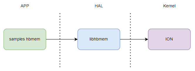

3.14.1.1. Software Architecture Description
This sample is implemented based on the libhbmem API. libhbmem is a memory management library built on ION, providing functionalities such as memory allocation, sharing, and recycling. It offers a unified API interface, enabling application developers to manage memory more conveniently, improve memory utilization, and achieve memory allocation for different buffer types and inter-process sharing. Refer to the software architecture diagram below for specific details.

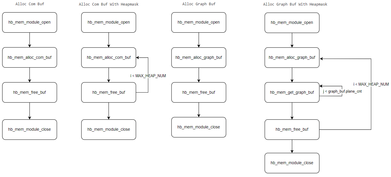

3.14.1.3. API Flow Description
libhbmem provides a series of API interfaces, including: libhbmem library calling ION for buffer allocation.
The sample_hbmem example includes the use of hbmem APIs such as Alloc Com Buffer, Alloc Graph Buffer, and Share Pool, and illustrates the allocation and usage flowcharts of each API.
  • Alloc Com Buf: Allocates a shared communication buffer for data exchange between multiple processes, effectively supporting inter-process collaboration.
  • Alloc Com Buf With Heapmask: Allocates a shared communication buffer and specifies a heapmask to allocate the buffer to a specific heap.
  • Alloc Graph Buf: Allocates a graphic buffer, including configuration, manipulation, and transformation of graphic data, meeting the dynamic memory requirements in visual data processing.
  • Alloc Graph Buf With Heapmask: Allocates a graphic buffer and specifies a heapmask to allocate the buffer to a specific heap.

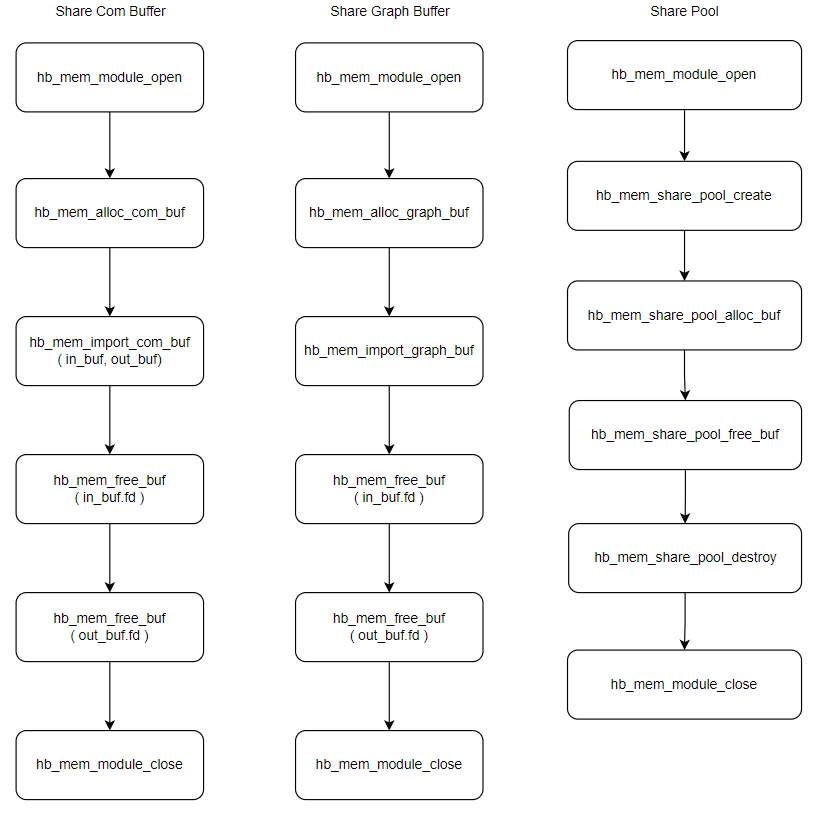

  • Share Com Buffer: Shares a communication buffer for data exchange between multiple processes, effectively supporting inter-process collaboration.
  • Share Graph Buffer: Shares a graphic buffer, including configuration, manipulation, and transformation of graphic data, meeting the dynamic memory requirements in visual data processing.
  • Share Pool: Shares a memory pool, implementing allocation and release strategies for shared memory pools, optimizing resource utilization through shared memory pools, reducing the overhead of buffer creation and destruction, and improving the flexibility of memory management.

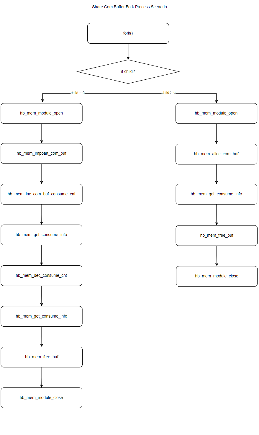

  • Share Com Buffer Fork Process Scenario: Usage of shared communication buffers when creating child processes.

  • Intra-process Common Buffer Sharing
# ./sample_hbmem -m 6
sample_mode = 6
Ready to sample_share_com_buffer
alloc com buf, share_id: 7
import com buf, share_id: 7
[1510:1510] Do system command cat /sys/kernel/debug/ion/clients/1510*.
       heap_name:    size_in_bytes :  handle refcount :    handle import :       buffer ptr :  buffer refcount :  buffer share id : buffer share count
         ion_cma:            10000 :                2 :                2 :         df1cdf5a :                4:                7 :                2
          total             10000
[1510:1510] Do system command cat /sys/kernel/debug/ion/heaps/ion_cma | grep -w 1510 | grep -w sample_hbmem.
         ion_cma     sample_hbmem             1510            65536
    sample_hbmem             1510            other            65536 0
[1510:1510] Result 0.
free com buf
         ion_cma:            10000 :                1 :                1 :         df1cdf5a :                3:                7 :                1
          total             10000
free import buf
          total                 0
[1510:1510] Result 256.
sample_share_com_buffer done
  • Inter-process Common Buffer Sharing
# ./sample_hbmem -m 7
sample_mode = 7
Ready to sample_share_com_buffer_fork_process_scenario
alloc graph buf form ion_cma
socketpair: 0
[1527:902] In parent process.
[1528:1527] In child process.
parent write share buf: parent test common buf share.
share_consume_cnt: 0
[1527:902] parent send msg 1
[1528:1527] child recv msg 1
child read share buf: parent test common buf share.
share_consume_cnt: 1
child write share buf: child test common buf share.
[1528:1527] child send msg 2
[1527:902] parent recv msg 2
parent read share buf: child test common buf share.
[1527:902] parent send msg 3
[1528:1527] child recv msg 3
[1527:902] parent quit
[1528:1527] child quit
alloc graph buf form carveout
socketpair: 0
[1529:1527] In child process.
[1529:1527] child recv msg 1
[1529:1527] child send msg 2
[1529:1527] child recv msg 3
[1529:1527] child quit
alloc graph buf form cma_reserved
socketpair: 0
[1530:1527] In child process.
[1530:1527] child recv msg 1
[1530:1527] child send msg 2
[1530:1527] child recv msg 3
[1530:1527] child quit
sample_share_com_buffer_fork_process_scenario done
  • Intra-process Graphic Buffer Sharing
# ./sample_hbmem -m 8
sample_mode = 8
Ready to sample_share_graph_buffer
alloc graph buf, share_id0: 7, share_id1: 8, share_id2: 8
import graph buf, share_id0: 7, share_id1: 8, share_id2: 8
[1531:1531] Do system command cat /sys/kernel/debug/ion/clients/1531*.
         ion_cma:            e1000 :                2 :                2 :         b65c6afe :                4:                7 :                2
         ion_cma:            71000 :                2 :                2 :         d4b2ed6c :                4:                8 :                2
          total            152000
[1531:1531] Do system command cat /sys/kernel/debug/ion/heaps/ion_cma | grep -w 1531 | grep -w sample_hbmem.
         ion_cma     sample_hbmem             1531          1384448
    sample_hbmem             1531            other           921600 0
    sample_hbmem             1531            other           462848 0
[1531:1531] Result 0.
free graph buf
         ion_cma:            e1000 :                1 :                1 :         b65c6afe :                3:                7 :                1
         ion_cma:            71000 :                1 :                1 :         d4b2ed6c :                3:                8 :                1
          total            152000
free import buf
          total                 0
[1531:1531] Result 256.
sample_share_graph_buffer done

  • Inter-process Share Pool Sharing
# ./sample_hbmem -m 10
sample_mode = 10
Ready to sample_share_pool_fork_process_scenario
[1576:902] In parent process.
[1577:1576] In child process.
[1576:1576] Do system command cat /sys/kernel/debug/ion/clients/1576*.
       heap_name:    [12121.854779] ion_share_pool_monitor_ref_cnt failed -512
         ion_cma:            20000 :                1 :                1 :         4b5ef9a2 :                3:                7 :                1
         ion_cma:            20000 :                1 :                1 :         baf4062a :                3:                8 :                1
         ion_cma:            20000 :                1 :                1 :         c865393e :                3:                9 :                1
         ion_cma:            20000 :                1 :                1 :         5db7853d :                3:               10 :                1
         ion_cma:            20000 :                1 :                1 :         d973ee69 :                3:               11 :                1
          total             a0000
[1576:1576] Do system command cat /sys/kernel/debug/ion/heaps/ion_cma | grep -w 1576 | grep -w sample_hbmem.
         ion_cma     sample_hbmem             1576           655360
    sample_hbmem             1576            other           131072 0
[1576:1576] Result 0.
hb_mem_share_pool_alloc_buf 0 0xffffa12b0000
hb_mem_share_pool_alloc_buf 1 0xffffa12d0000
hb_mem_share_pool_alloc_buf 2 0xffffa12f0000
hb_mem_share_pool_alloc_buf 3 0xffffa1310000
hb_mem_share_pool_alloc_buf 4 0xffffa1330000
[1576:902] parent send msg 1
[1577:1576] child recv msg 1
[1577:1576] child send msg 2
[1576:902] parent recv msg 2
free 0 0xffffa12b0000
[1576:902] parent pool.avail_buf_cnt: 0
free 1 0xffffa12d0000
[1576:902] parent pool.avail_buf_cnt: 1
free 2 0xffffa12f0000
[1576:902] parent pool.avail_buf_cnt: 2
free 3 0xffffa1310000
[1576:902] parent pool.avail_buf_cnt: 3
free 4 0xffffa1330000
[1576:902] parent pool.avail_buf_cnt: 4
[1576:902] parent send msg 3
[1577:1576] child recv msg 3
[1577:1576] child send msg 4
[1576:902] parent recv msg 4
[1576:902] parent pool.avail_buf_cnt: 5
[1577:1576] child quit
[1576:902] parent quit
sample_share_pool_fork_process_scenario done
  • Using Share Pool
# ./sample_hbmem -m 11
sample_mode = 11
pool.avail_buf_cnt: 9
pool.avail_buf_cnt: 8
pool.avail_buf_cnt: 7
pool.avail_buf_cnt: 6
pool.avail_buf_cnt: 10
sample_share_pool done
