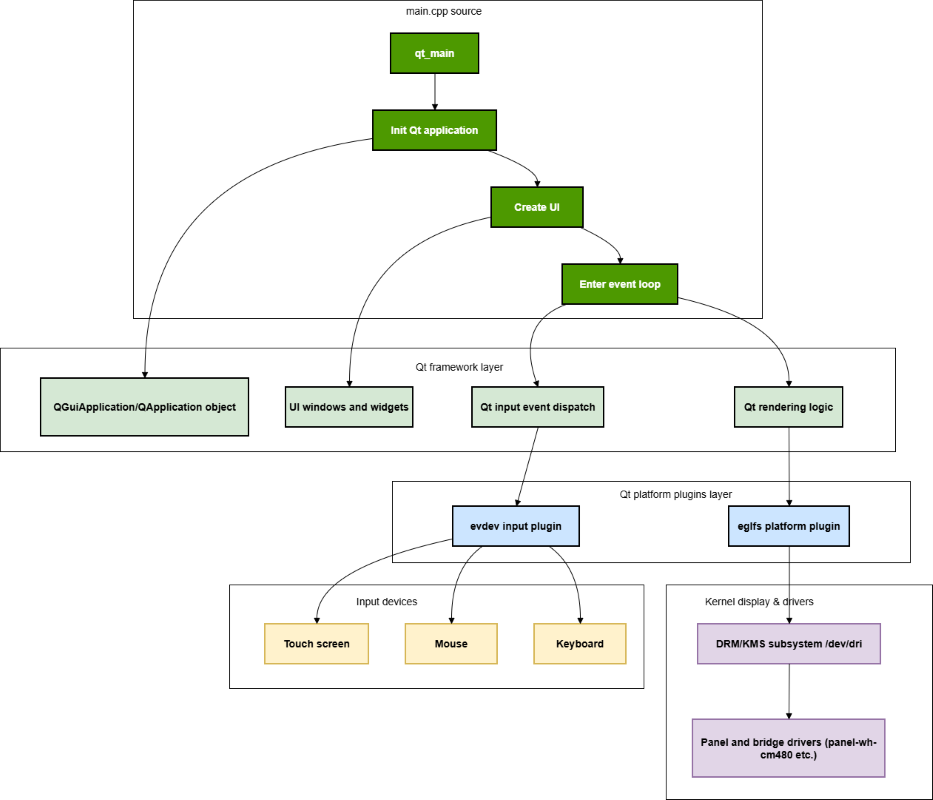

3.20.1.1. Software Architecture
The overall software architecture of sample_qt is shown in the following diagram:
software_architecture_diagram
From top to bottom, it mainly includes the following layers:
  • main.cpp source code layer: Contains qt_main, “Initialize Qt Application”, “Create Interface”, “Enter Event Loop” and other steps. Through these functions, Qt application initialization, interface creation, and finally entering the event loop are completed in sequence.
  • Qt framework layer: Consists of QGuiApplication/QApplication objects, interface windows and controls, Qt input event dispatching, Qt rendering processing and other modules, responsible for managing application lifecycle, displaying interfaces, and processing input events from users.
  • Qt platform plugin layer: Contains eglfs platform plugin and evdev input plugin. The former outputs Qt rendering results to display devices provided by DRM/KMS, while the latter reads events from input devices and hands them to the Qt framework for dispatching.
  • Display and input hardware layer: At the bottom are DRM/KMS subsystem (/dev/dri) and its underlying display driver, panel and bridge chip drivers (such as panel-wh-cm480, etc.), as well as input devices such as touchscreen, mouse, keyboard (/dev/input/event*), which together complete the final image display and input acquisition.

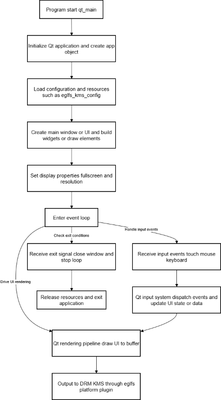

3.20.1.3. API Flow Description
The typical call flow of this sample is as follows:
  1. Qt application initialization:
    • Create QGuiApplication or QApplication object in main.cpp to complete basic initialization of the Qt runtime environment (including platform plugins, fonts, translations, etc.).
  2. Interface creation and rendering:
    • Create main window or scene, add basic controls or drawing elements for demonstrating Qt rendering effects and input response.
    • Set the window to full screen display to adapt to the current DRM output resolution.
  3. Platform and display adaptation:
    • Through Qt’s eglfs platform plugin, bind the rendering target to DRM framebuffer, and select output device and mode according to the configuration in eglfs_kms_config.json.
  4. Event loop and input processing:
    • Enter Qt main event loop, continuously read input events from devices such as /dev/input/event* (completed through Qt input plugin), and dispatch them to corresponding windows and controls.
  5. Resource release and exit:
    • When the user exits the program or the system sends an exit signal, the Qt application exits the event loop, releases windows and related resources, and finally ends the process normally.
For further understanding of the specific function call relationships in the code, you can read the main.cpp source code together with Qt official documentation.
