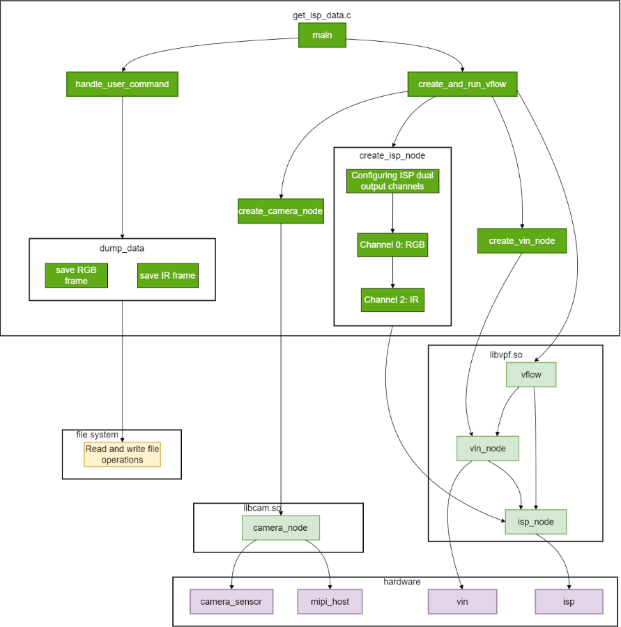

Software Architecture Description

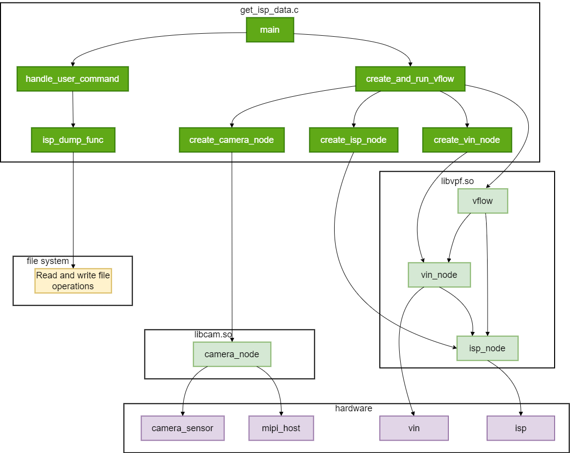

The functional modules in get_isp_data code achieve camera management and video stream processing by calling functions from libcam.so and libvpf.so. The camera module mainly relies on the camera control functions provided by libcam.so, while the video processing module depends on the video stream processing and node management functions provided by libvpf.so.
The get_isp_data software architecture is shown below:
  • The main function in get_isp_data.c serves as the program entry point. It calls the create_and_run_vflow function to create and run the video stream, and calls the handle_user_command function to process user commands.
  • The create_and_run_vflow function is responsible for creating various nodes in the video stream, including the camera node, video input node, and image signal processing node, as well as creating and starting the video stream.
  • The create_camera_node function is used to create the camera node, which is associated with the camera sensor and MIPI host in hardware, implemented via camera_node in libcam.so.
  • The create_vin_node function is used to create the video input node, which is associated with the video input engine in hardware, implemented via vin_node in libvpf.so.
  • The create_isp_node function is used to create the image signal processing node, which is associated with the image signal processing engine in hardware, implemented via isp_node in libvpf.so.
  • The handle_user_command function calls corresponding functions based on user input commands. The isp_dump_func function is used to acquire frame data from the image signal processing node and write it into a file in the file system.
  • The vflow node represents the video stream, connecting the video input node and the image signal processing node, implemented via related functions in libvpf.so.
  • Hardware nodes include the camera sensor, MIPI host, video input engine, and image signal processing engine. They are associated with corresponding software nodes, jointly completing image data acquisition, transmission, and processing.

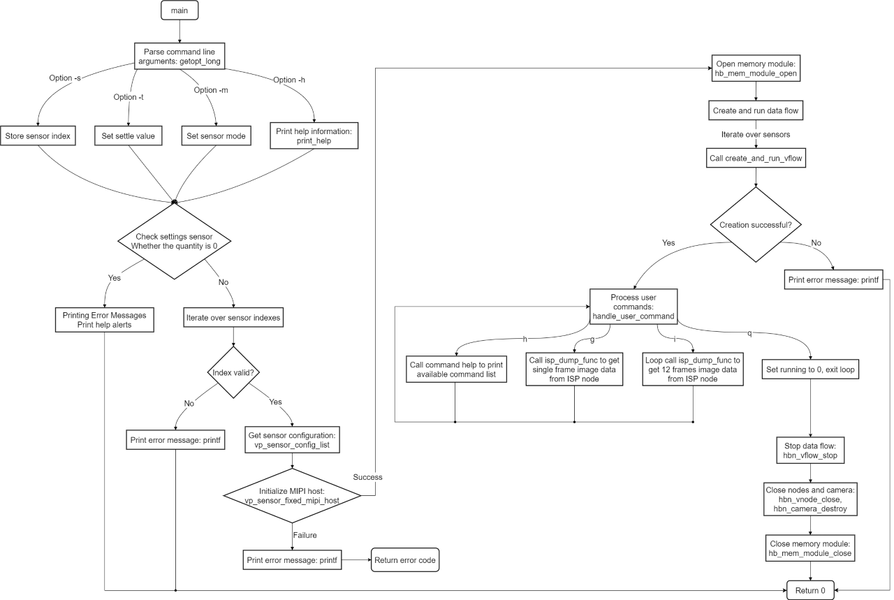

API Flow Description
The program flow of get_isp_data is as follows:
Description:
  • Parse command-line arguments: Use the getopt_long function to parse command-line arguments.
  • Print help information: Call the print_help function to display help information.
  • Obtain sensor configuration: Retrieve configuration from vp_sensor_config_list.
  • Initialize MIPI host: Call the vp_sensor_fixed_mipi_host function for initialization.
  • Open memory module: Call the hb_mem_module_open function to initialize the memory management module.
  • Create and run data stream: Call the create_and_run_vflow function to create and start the data stream for each sensor.
  • Handle user commands: Call the handle_user_command function to enter user interaction mode.
  • Stop data stream: Call the hbn_vflow_stop function to stop the data stream.
  • Close nodes and camera: Call the hbn_vnode_close and hbn_camera_destroy functions to release resources.
  • Close memory module: Call the hb_mem_module_close function to close the memory management module.

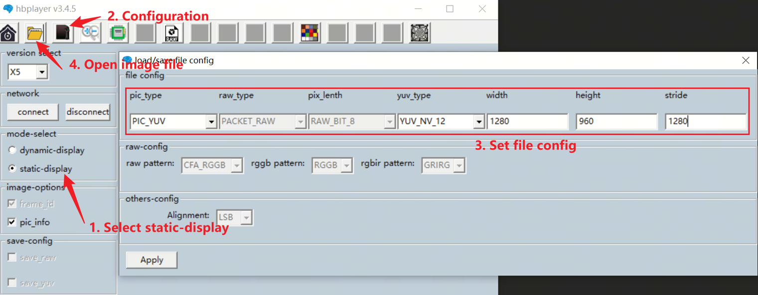

After running the program, YUV images with naming format like isp_chn0_1280x960_stride_1280_sframeid_1.yuv will be obtained.
You can use the Hobot player tool to view the images. The image parameter configuration is explained as follows:
  • View YUV Image
Configure options as shown in the figure below. In the file config, pay attention to the settings of pic_type, yuv_type, width, and height. For sc1330t, configure as (PIC_YUV, YUV_NV12, 1280, 960).

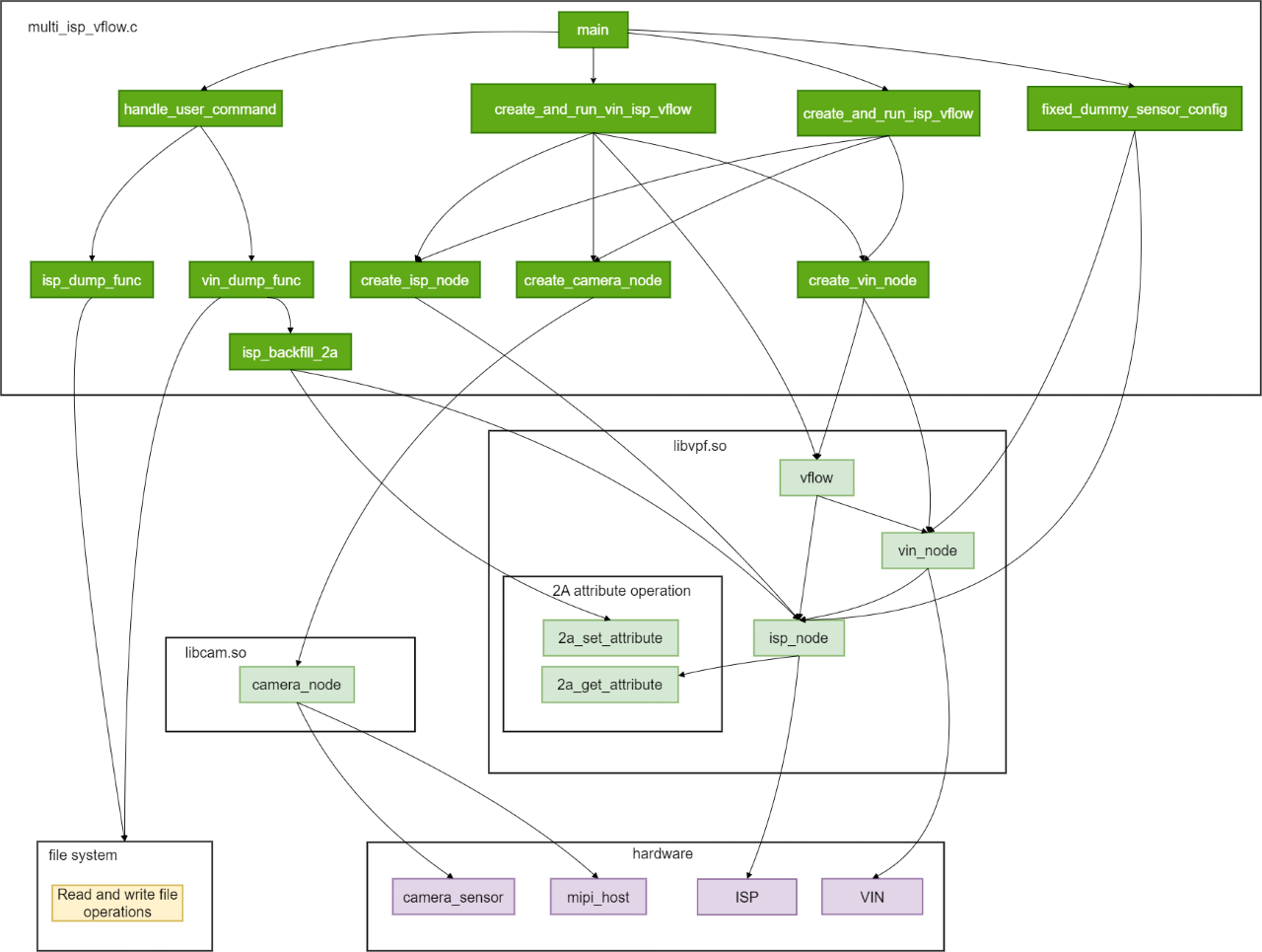

multi_isp_vflow calls APIs from libcam.so and libvpf.so to implement camera initialization, image capture, video input, and ISP processing, constructing a complete software architecture for image signal processing and video input processing. Among them, libcam.so is responsible for camera device driver and control, while libvpf.so provides core functions for video input and ISP processing. These two libraries work together to achieve input, processing, and output of image signals.
The software architecture of multi_isp_vflow is shown below:

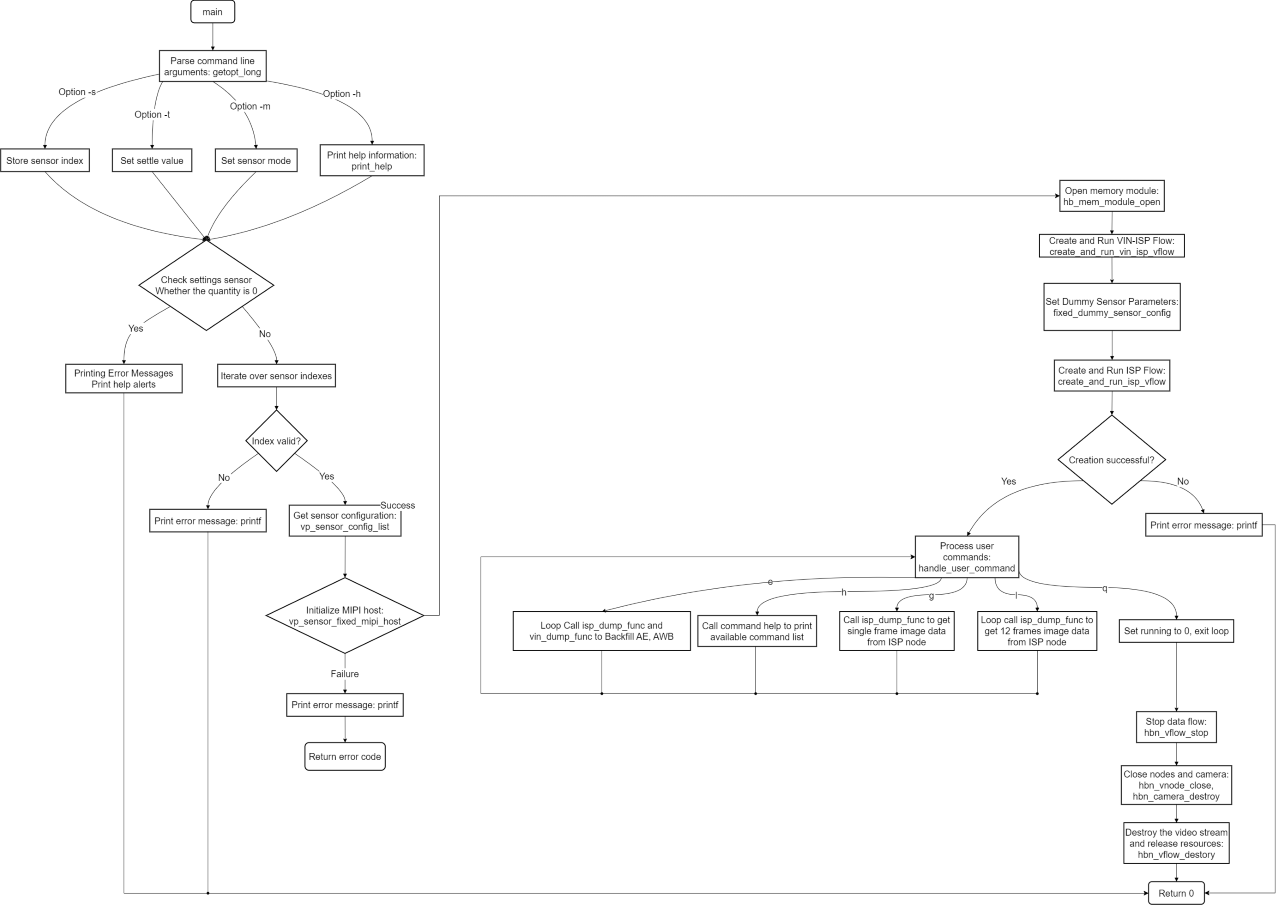

Description:
  • Parse command-line arguments: Use getopt_long() to parse command-line input.
  • Get sensor configuration: Obtain the sensor configuration at the specified index via vp_sensor_config_list[index].
  • Initialize MIPI host: Call vp_sensor_fixed_mipi_host() to initialize the MIPI host.
  • Create and run VIN-ISP flow: Use create_and_run_vin_isp_vflow(&vin_isp_contex) and create_and_run_isp_vflow(&isp_contex) to create and run data flows.
  • Set dummy sensor parameters: Set related parameters of the dummy sensor via fixed_dummy_sensor_config(&vin_isp_contex, &dummy_sensor_config).
  • Handle user commands: Process user input commands via handle_user_command(vin_isp_contex, isp_contex).
  • Stop VIN flow: Call hbn_vnode_releaseframe() to release frame data.
  • Close VIN and ISP nodes: Use hbn_vnode_close() to close nodes.
  • Destroy camera: Call vp_sensor_destroy() to release camera resources.
  • Print help information: If the sensor index is invalid, call print_help() to print help information.

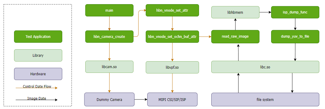

  • isp_feedback initializes the MIPI CSI, SIF, and ISP modules through a virtual Camera Sensor, reads RAW image data, and feeds it back into the ISP for tuning to generate YUV images.
  • During tuning, isp_feedback applies parameters from the specified Camera Sensor and uses the corresponding ISP effect library.
  • For compilation instructions, refer to the Compilation Methods section.
isp_feedback leverages APIs from libcam.so and libvpf.so to implement initialization of the virtual Camera Sensor, image acquisition, video input, and ISP processing, forming a complete software architecture for image signal and video input processing.
  • libcam.so: Manages the driver and control of the virtual Camera Sensor device.
  • libvpf.so: Provides core functions for video input and ISP processing.
Main API Descriptions
  • hbn_camera_create: Creates a virtual Camera Sensor node and initializes the Camera Sensor device.
  • hbn_camera_attach_to_vin: Binds the virtual Camera Sensor to a video input node to enable data transmission.
  • hbn_camera_destroy: Destroys the virtual Camera Sensor node and releases device resources.
  • hbn_vnode_open: Opens a video input or ISP node, initializes the node device, and enables data processing.
  • hbn_vnode_set_attr, hbn_vnode_set_ichn_attr, hbn_vnode_set_ochn_attr: Set node attributes, input channel attributes, and output channel attributes to configure operational parameters such as resolution, frame rate, and color format to meet various processing needs.
  • hbn_vnode_getframe, hbn_vnode_releaseframe: Retrieve and release frame data from the node, enabling data reading and management.
  • hbn_vflow_create, hbn_vflow_add_vnode, hbn_vflow_start, hbn_vflow_stop, hbn_vflow_destroy: Create, manage, bind, start, stop, and destroy data flows (vflow), controlling data transmission and processing across nodes.
  • hbn_isp_get_awb_attr, hbn_isp_set_awb_attr, hbn_isp_get_exposure_attr, hbn_isp_set_exposure_attr: Get and set ISP Auto White Balance (AWB) and Exposure (AE) attributes to adjust and control image quality.
Code Location and Directory Structure
The source code for isp_feedback is located at /app/samples/platform_samples/sample_isp. The code structure is as follows:
└── isp_feedback
    ├── Makefile
    └── isp_feedback.c
  • Makefile: The Makefile used to compile the program.
  • isp_feedback.c: The main source code file of the program.
Tool Location and Directory Structure
The tool is located on the board under /app/platform_samples/sample_isp/isp_feedback:
root@buildroot:/app/platform_samples/sample_isp/isp_feedback# ls
isp_feedback
API Workflow Description
Description:
  • Parse Command-Line Arguments: Use getopt_long() to parse command-line input.
  • Retrieve Sensor Configuration: Obtain the sensor configuration at the specified index via vp_sensor_config_list[index].
  • Create and Run VIN-ISP Flow: Use create_and_run_isp_vflow(&isp_contex) to create and start the data flow.
  • Set Virtual Sensor Parameters: Configure virtual sensor parameters using fixed_dummy_sensor_config(&vin_isp_contex, &dummy_sensor_config).
  • Stop VIN Flow: Call hbn_vnode_releaseframe() to release frame data.
  • Close VIN and ISP Nodes: Use hbn_vnode_close() to close the nodes.
  • Destroy Camera Sensor: Call vp_sensor_destroy() to release Camera Sensor resources.
  • Print Help Information: If the sensor index is invalid, call print_help() to display help information.
