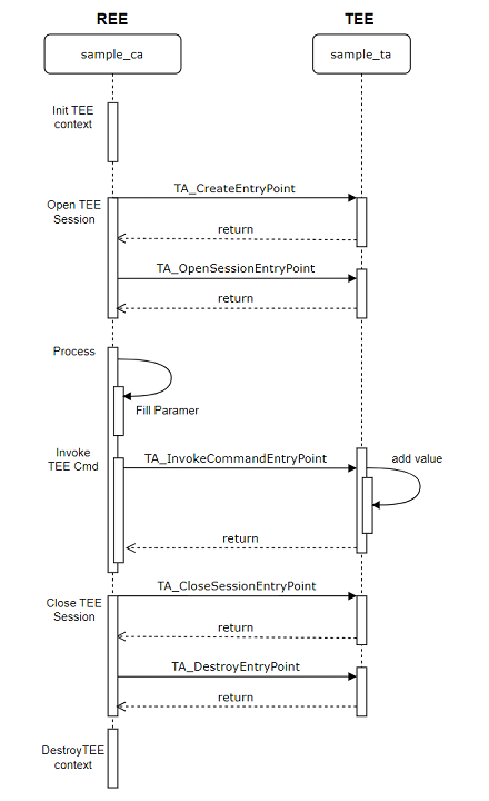

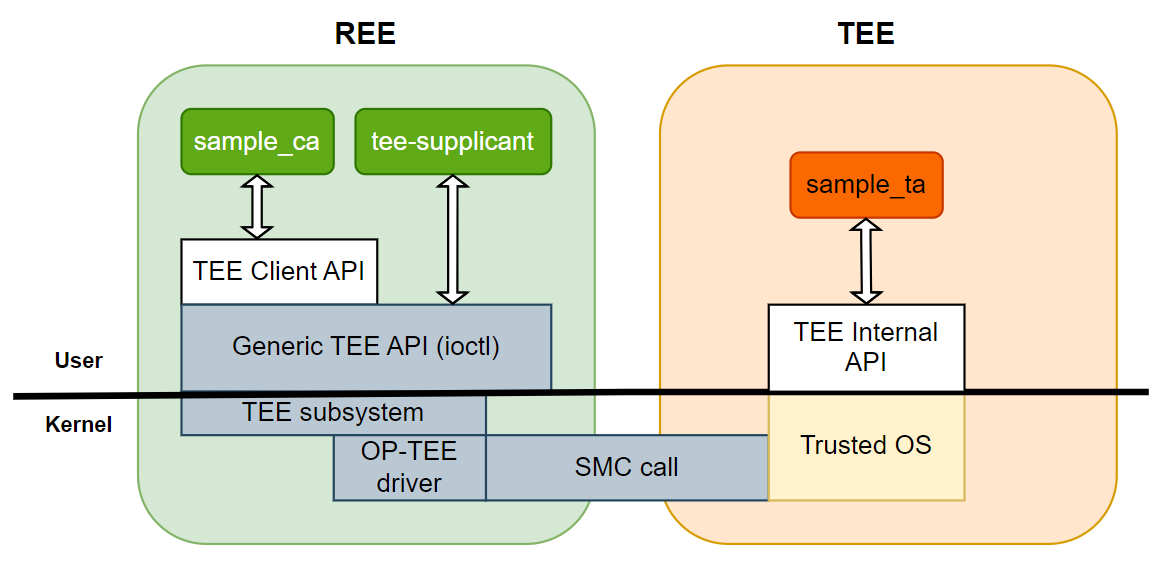

3.18.1.1. Software Architecture Description

3.18.1.3. API Process Description

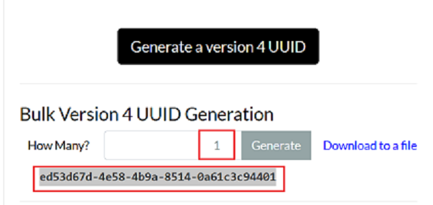

  • Generate UUID
This step can be skipped if using the UUID provided in the example.
Multiple TAs can coexist in the system, each requiring a unique UUID.
UUIDs can be generated at: https://www.uuidgenerator.net/
As shown above, the generated UUID value is ed53d67d-4e58-4b9a-8514-0a61c3c94401.

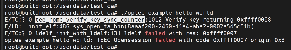

3.18.5.1. CA Program Fails to Call TA with “Verify key” Error
  • Solution:
    TA loading depends on the user root key.
    For instructions on burning the user root key, please refer to efuse
