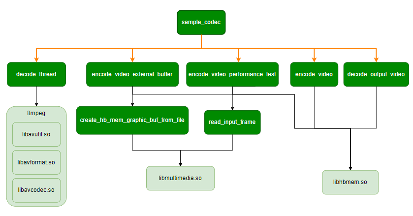

3.7.1.1. Software Architecture
sample_codec_framework

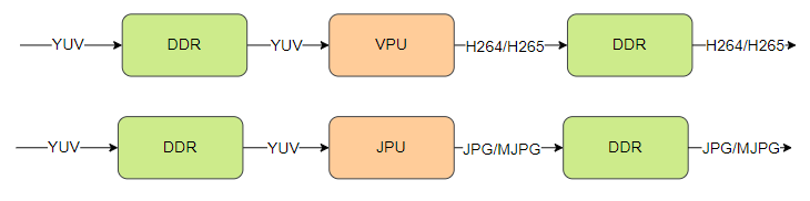

Encoding Data Flow
sample_codec_encode_data_flow

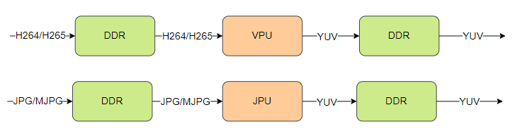

Decoding Data Flow
sample_codec_decode_data_flow

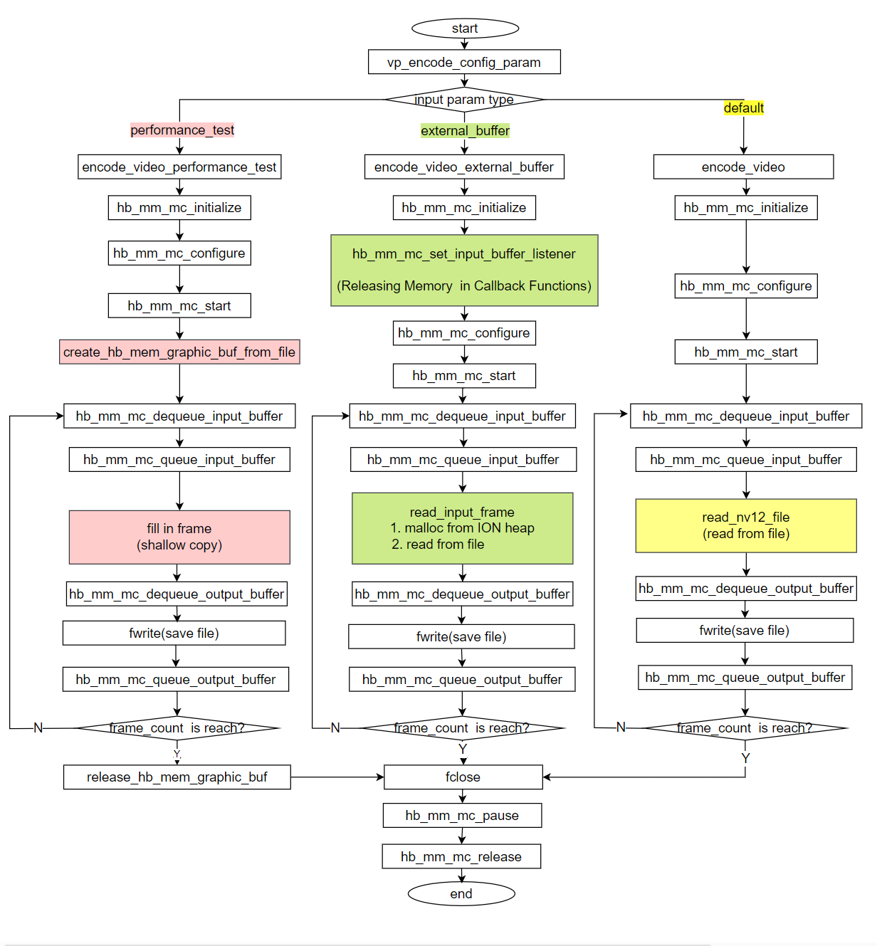

Encoding Workflow
Depending on different input parameters, the encoding workflow is divided into three scenarios:
Scenario Description Characteristics Differences (text background color in diagram)
Performance Testing Pre-load YUV data into memory; no file reading during loop Red
Input with External Buffer 1. Read file and store into memory allocated via hbmem interface as input buffer
2. Release through callback function
Green
Input with Internal Buffer Use buffer allocated within the MediaCodec framework Yellow
sample_codec_encode_flow

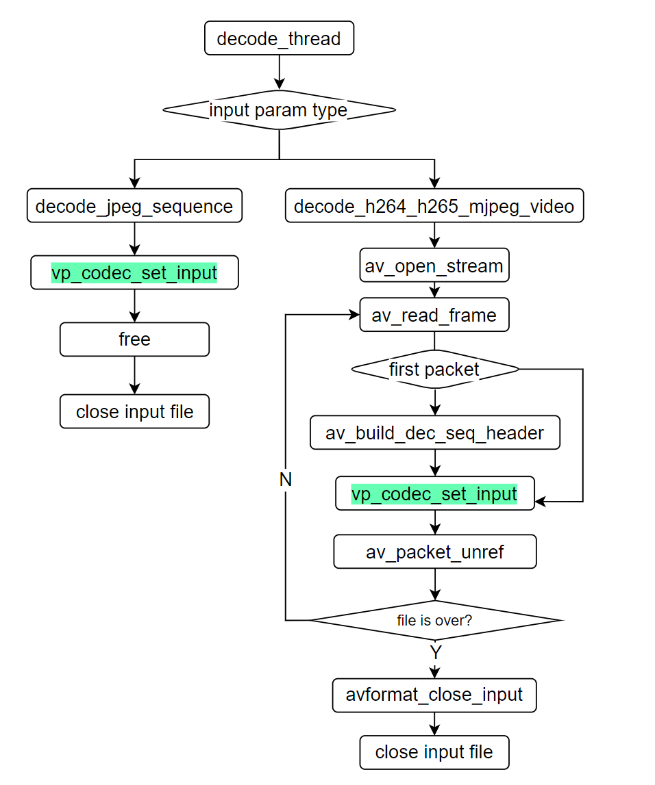

Encoded File Reading Thread
Encoded file reading thread: Calls ffmpeg interface to read video file and feeds data into hardware decoder via MediaCodec framework functions.
sample_codec_decode_read_file

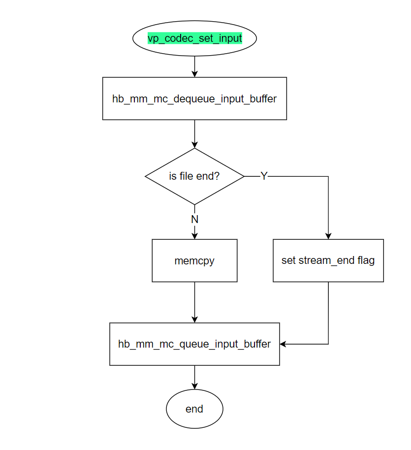

In the encoded file reading thread diagram, vp_codec_set_input (text background in green) calls MediaCodec framework functions to fill the input buffer. The process is as follows:
sample_codec_decode_set_input

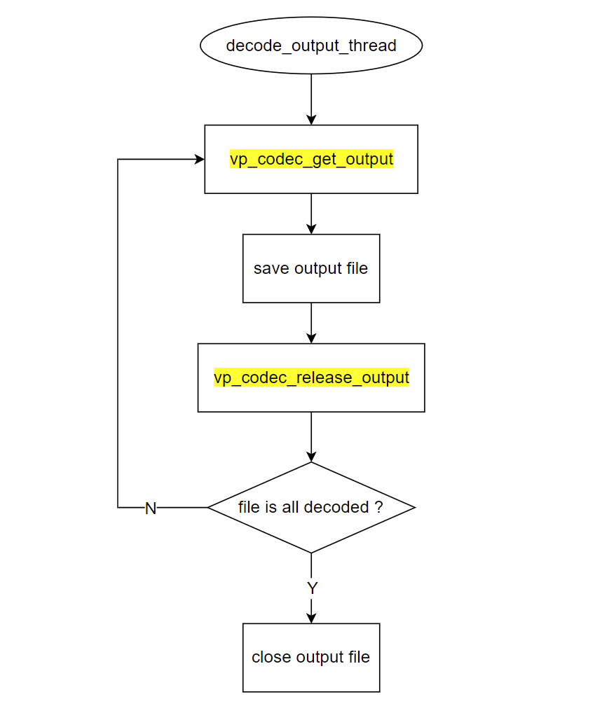

Hardware Decoding Thread
Hardware decoding thread: Reads decoded data from the hardware decoder via MediaCodec framework functions and writes it to a file.
sample_codec_decode_hardware_decoder

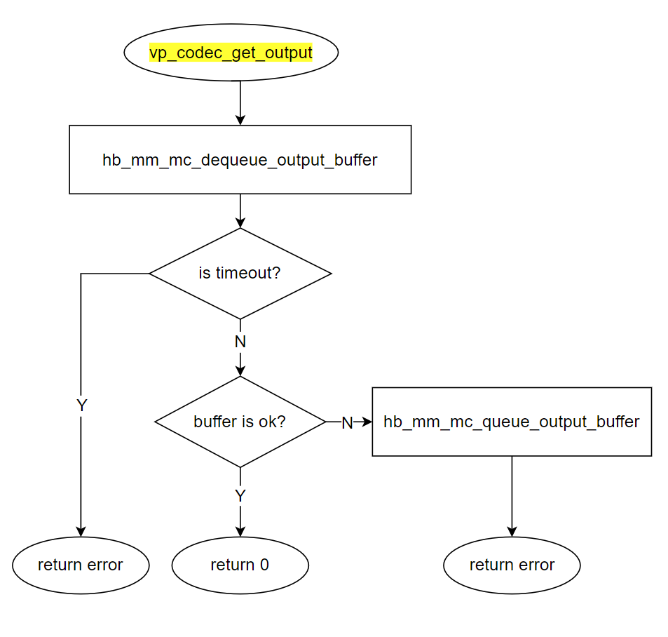

In the hardware decoding thread diagram, vp_codec_get_output (text background in yellow) calls MediaCodec framework functions to retrieve the output buffer. The process is as follows:
sample_codec_decode_get_output

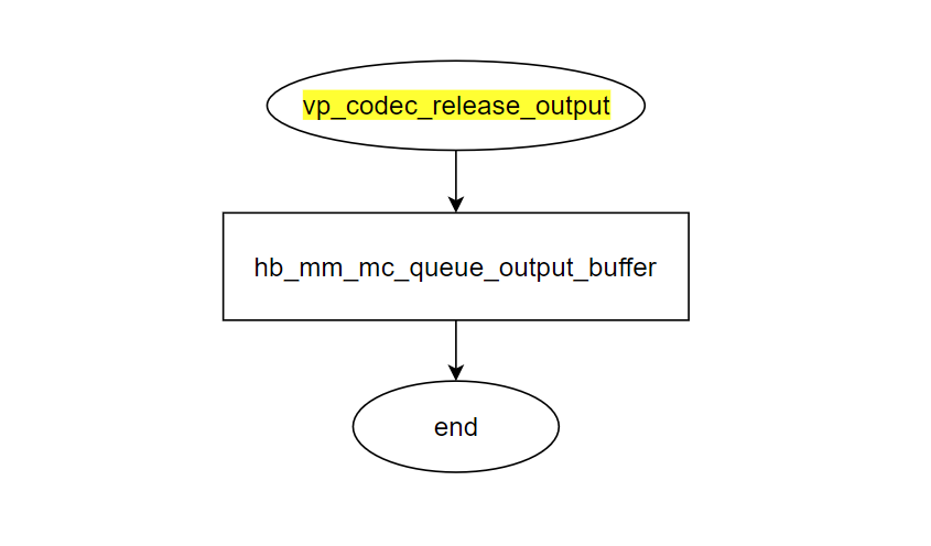

In the hardware decoding thread diagram, vp_codec_release_output (text background in yellow) calls MediaCodec framework functions to release the output buffer. The process is as follows:
sample_codec_decode_release_output
