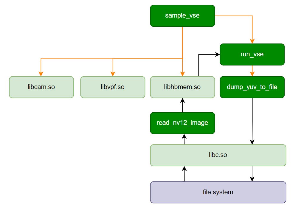

sample_vse primarily depends on libcam.so libvpf.so libhbmem.so. It reads YUV files into memory allocated by HBM and passes them to the VSE channels for scaling (up or down). Finally, the processed YUV data is dumped to the file system.

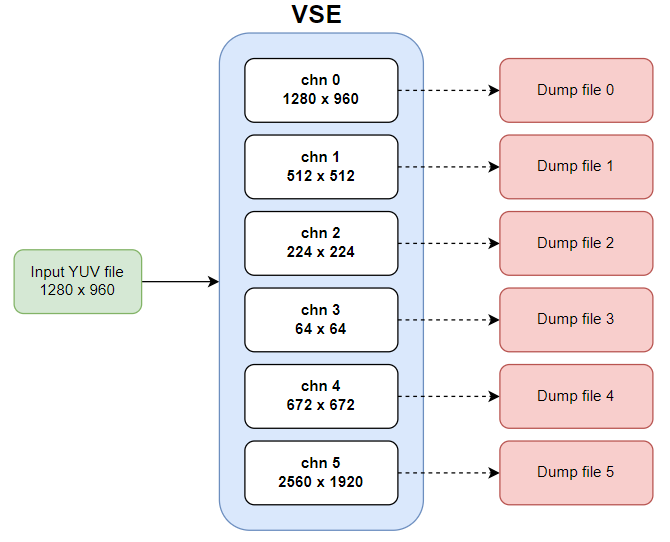

The sample program pipeline is shown below. Only one vflow is created, which contains a single VSE vnode. Six internal channels within the VSE vnode achieve scaling at different resolutions.

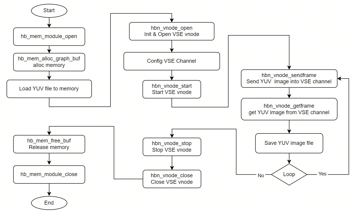

3.4.1.4. API Flow Description

One YUV image is fed into the VSE, and six channels are initialized. Channels 0-4 perform image downscaling, while channel 5 performs upscaling. The processed images are saved as YUV files:
  • Channel 0 outputs the original input resolution: 1280 x 720.
  • Channel 1 outputs a commonly used algorithm resolution with 16-pixel alignment: 512 x 512.
  • Channel 2 outputs a commonly used algorithm resolution without 16-pixel alignment: 224 x 224.
  • Channel 3 outputs a ROI centered on the original image, with width and height each halved. The output image size equals the ROI size, scaled down to the minimum supported resolution: 64 x 64.
  • Channel 4 outputs a commonly used algorithm resolution: 672 x 672.
  • Channel 5 outputs an upscaled image to the maximum supported resolution (note: image can be enlarged up to 4x): 2560 x 1440.

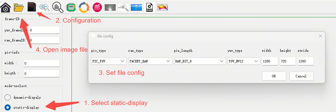

  • Viewing YUV Images
    Please refer to the Hobot Player static image section for image viewing. The image parameter configuration is described as follows: Configure options as shown in the figure below. In file config, pay attention to the settings of pic_type, yuv_type, width, and height. For example, for vse_output_nv12_run0_chn0_1280x720_stride_1280.yuv, the configuration should be (PIC_YUV, YUV_NV12, 1280, 720). vse_hobot_use.png
