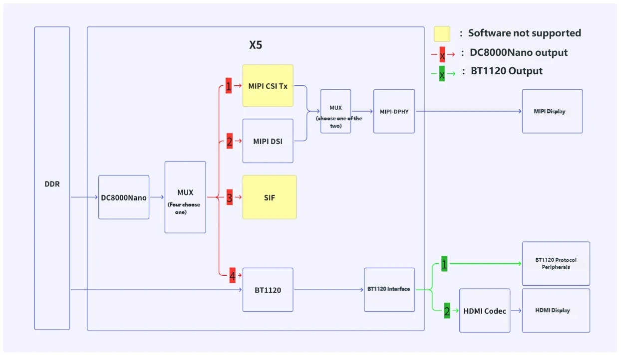

5.11.1.1. Hardware Block Diagram
The Display subsystem consists of the following modules:
  1. MIPI DSI Controller: Implements high-speed data transmission between the SoC and display devices, compliant with the MIPI protocol.
  2. MIPI CSI TX Controller: Implements the device-side CSI-2 protocol. The CSI-2 link protocol specification is part of the communication standard defined by the MIPI Alliance, suitable for chip-to-chip communication in mobile systems.
  3. MIPI D-PHY: The physical layer for both MIPI CSI TX and MIPI DSI.
  4. BT1120: Complies with the ITU-R BT.1120 standard, capable of driving external HDMI devices to achieve 4K display.
  5. DC8000Nano: A high-performance, low-power display processor.
The relationship between these modules is shown in the diagram below:
Block Diagram
In the above diagram, images from DDR can be output to external displays via three paths:
  • Path 1: Data from DDR passes through DC8000Nano, MIPI DSI, and MIPI-DPHY to the MIPI display.
  • Path 2: Data from DDR passes through DC8000Nano and BT1120 to the external display.
  • Path 3: Data from DDR is directly output via BT1120 to the external display.
Note:
  1. DC8000Nano supports four output paths, but the yellow portion is currently not supported by software.
  2. BT1120 output can connect to BT1120 protocol devices or be converted via a bridge chip to other protocols such as HDMI.

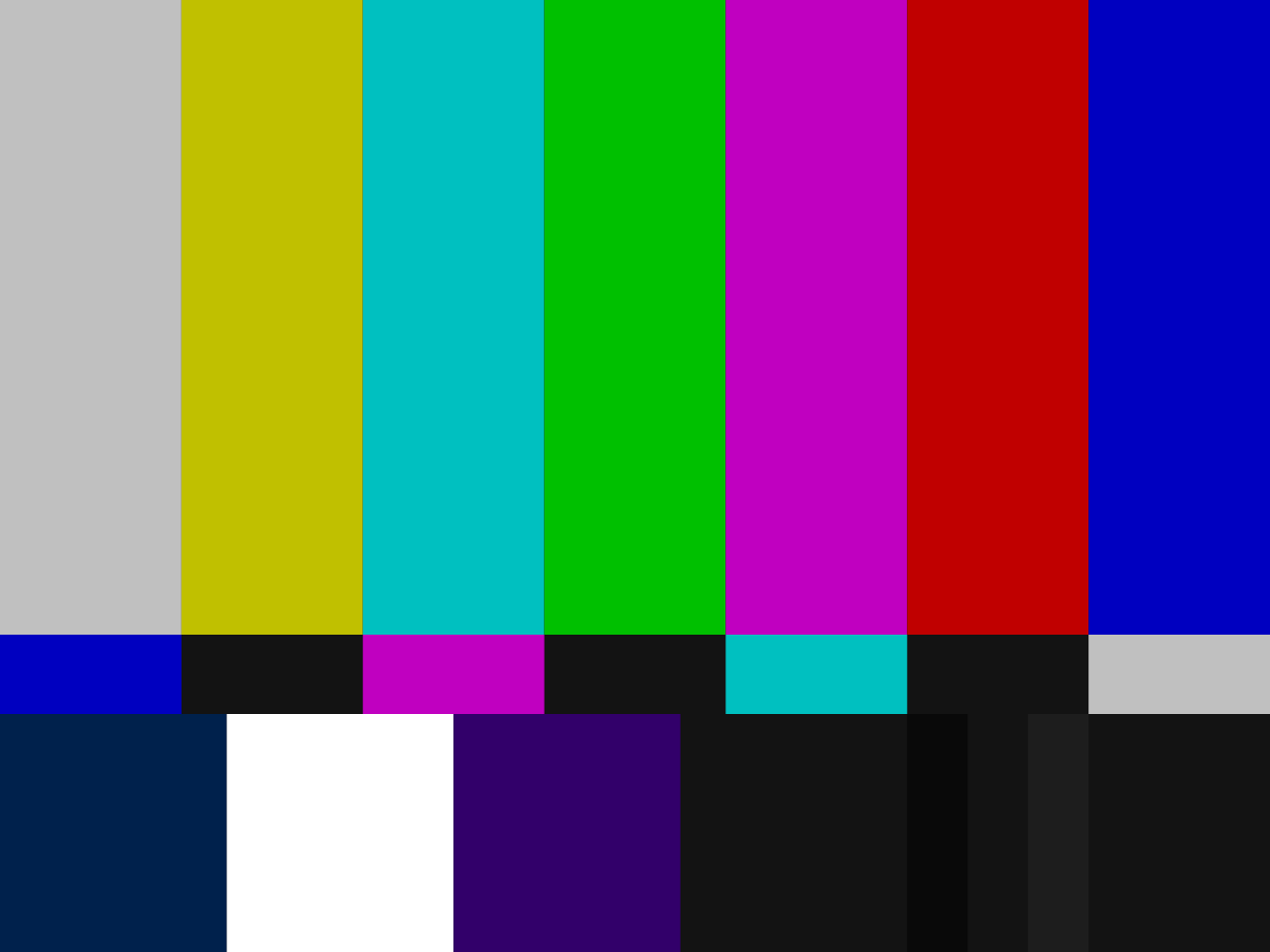

Quick DRM Experience
Based on the information obtained from modetest, we can execute the following command to test HDMI functionality. Before execution, ensure a display supporting 1080P@60Hz mode is connected:
modetest -M vs-drm -a -s 75@31:1920x1080 -P 33@31:1920x1080@NV12
After the command completes, the SMPTE test color bars ECR-1-1978 should appear on the display:
../_images/display_subsystem_smpte_patten.png
