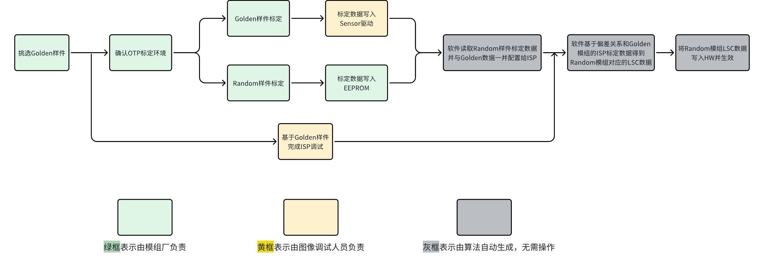

5.15.2. Pipeline Introduction
 Pipeline
Note: For the current LSC OTP solution, the golden data written in the sensor driver is recommended to cover samples from the same module manufacturer with the same module specifications.

Calibration Process
  1. Place the module within 1cm in front of the light source, adjust the module direction so that the optical axis of the module lens is perpendicular to the light source plane. If using an integrating sphere light source, ensure that the module lens can be completely placed inside the integrating sphere through the window.
  2. Set up the module according to the table requirements in Section 3.1, adjust the light source power so that the G value in the center of the image after BLC subtraction is around 400-650, and capture a RAW image.
  3. Import the captured RAW image into the OTP tool, which will calculate 17x17 and 33x33 LSC_table data. For Random samples, write the generated 17x17 LSC_table into the EEPROM; for Golden samples, write the 33x33 LSC_table into the sensor driver. For data generation examples, see Section 5.
  4. After completing the above steps, ask the image tuning engineer to confirm whether the image performance meets expectations. If it does, proceed with batch programming to complete the OTP calibration.

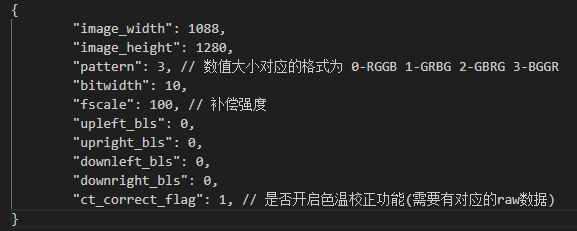

Name the raw image “otp.raw” and modify the parameters in “otp_data.txt”. After completion, run the exe executable file directly.
Parameter Description
ct_correct_flag: Whether to enable the color temperature correction function. If using this function, place std_lsc_otp_1.raw ~ std_lsc_otp_5.raw and ext_lsc_otp_1.raw ~ ext_lsc_otp_5.raw (10 raw data files total) in the same directory as otp.raw. std_lsc_otp_x.raw: 5 random raw images captured under the same color temperature as the Golden data in the sensor driver. ext_lsc_otp_x.raw: 5 random raw images captured under the actual color temperature on the sensor production line. At this point, the EEPROM of the sensor is programmed with OTP data for the corresponding color temperature. The 5 random raw images for the two production lines need to use 5 identical sensors, and the same sensor numbers must correspond one-to-one.

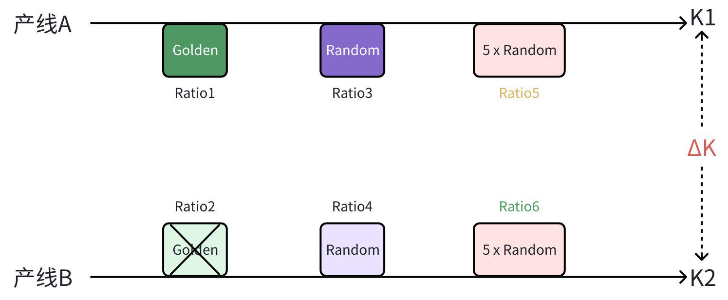

Calibration of Two Production Line Differences
When the module manufacturer has multiple production lines, if there is a deviation in the color temperature used for calibration between different lines. For example, for A light, one is 3000K and the other is 2800K, which will cause the same module to have slightly different programming values when programming OTP under different light sources, ultimately causing LSC result deviation. You can select 5 random modules to calculate the difference between the two production lines.
 Color Temperature Deviation
Calibration steps:
  1. Select 5 random modules.
  2. Under the color temperature of production line A (using production line A as the standard), capture 5 raw data images, and name them std_lsc_otp_1.raw ~ std_lsc_otp_5.raw respectively.
  3. Under the color temperature of production line B, capture raw data of the same 5 modules, and name them ext_lsc_otp_1.raw ~ ext_lsc_otp_5.raw respectively.
  4. Afterwards, when using the tool to generate OTP parameters for a Random module on production line B, set ct_correct_flag to 1, and the tool will automatically apply the difference between the two production lines to the OTP parameters.
Example: When using the tool to generate parameters for production line B, suppose the corresponding color temperature for Golden calibration is TL84. You need to capture 5 random modules under TL84 color temperature on both production line A and production line B, name the files accordingly and place them in the same directory as the tool, then set ct_correct_flag to 1.
Note:
  1. If switching to another production line, the same calibration method must be performed again.
  2. The 5 random modules should be as close as possible to the modules being calibrated. When the difference is too large (e.g., excessive optical center position offset), the corrected data will also have a significant deviation from the ideal data.
