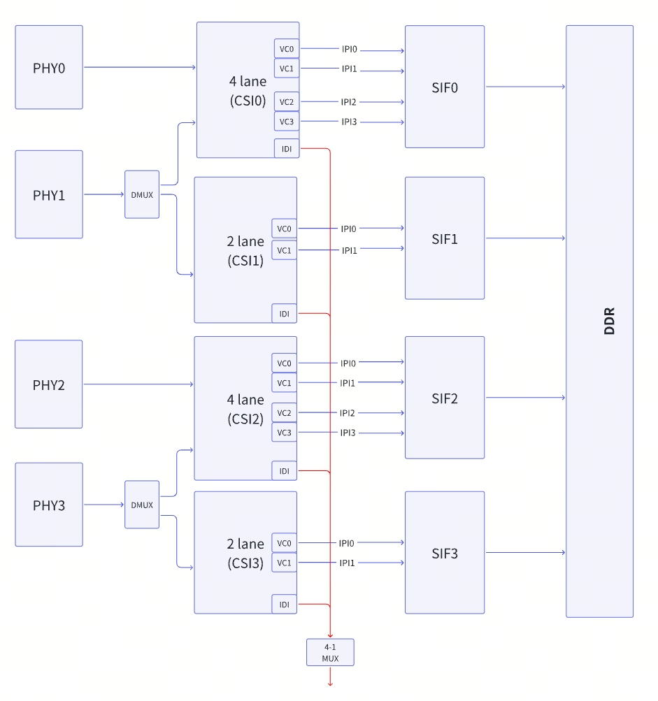

5.5.1.1. Hardware block diagram
Main components
  • MIPI D-PHY (RX): As the physical layer of the MIPI protocol receiver, it supports high-speed serial data transmission.
  • MIPI HOST controller: implements the CSI-2 protocol on the host side and is responsible for receiving data from D-PHY and performing protocol analysis. X5 contains 4 independent HOST instances.
  • IPI (Image Pixel Interface): Image pixel interface. The effective image data parsed by the CSI HOST controller is output to the SIF (Sensor Interface) module through this parallel interface for subsequent processing.
  • IDI (Image Data Interface): Image data interface.
Key Features
  • The chip supports up to 4 independent MIPI HOSTs (CSI0~CSI3), each independently supports up to 2 Lanes
  • MIPI HOST and IPI distribution:
    • HOST0 /HOST2: Each can bind up to 4 IPIs.
    • HOST1 /HOST3: Each can bind up to 2 IPIs.
  • When the Lane splicing function is enabled through DMUX, HOST0 and HOST2 can be configured to use 4 Lanes respectively to obtain higher single-channel bandwidth. Note: Under this configuration, HOST1 and HOST3 will not be able to receive data.
  • The MIPI module connects data to the SIF through the 12-channel IPI interface. Each IPI channel can be bound to an independent virtual channel and used in combination with SerDes. In theory, up to 12 cameras can be connected.
