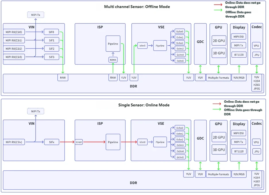

5.1.3.2. Data Interaction
The X5 chip has dedicated data channels built-in that can directly connect the VIN, ISP, and VSE modules, enabling high-speed direct transmission of video data without reading from or writing to DDR, thus saving DDR bandwidth and significantly improving performance.
However, since the hardware resources of ISP and VSE are singular, when multiple Camera Sensors are connected, processing must be done through time-division multiplexing, requiring video data to be cached via DDR.
Depending on whether data transfer relies on DDR buffering, the data interaction between hardware acceleration units can be divided into two modes:
  1. Offline Mode (shown as green arrows in the diagram): Data is transferred via DDR. The upstream module writes data to DDR, and the downstream module reads from DDR. This mode supports scenarios with multiple Camera Sensors.
  2. Online Mode (shown as red arrows in the diagram): Data is directly passed from the upstream module to the downstream module without reading from or writing to DDR, significantly enhancing performance. However, this mode is only applicable to single Camera Sensor scenarios.
Note: In multi-camera sensor scenarios, ISP to VSE supports online processing, and it is recommended to use online mode (effectively reducing DDR bandwidth).
The following diagram illustrates two usage scenarios: multiple Camera Sensors and single Camera Sensor:
Block Diagram
Summary:
  • VIN: Includes 4 MIPI RX and 4 SIFs
    • MIPI RX: Connects to one MIPI interface Camera Sensor
    • SIF: Corresponds one-to-one with MIPI interface, forwards data frames received via MIPI to downstream ISP or directly writes to DDR
  • ISP: Has 4 input ports, supports connection with 4 SIFs. Since ISP has only one hardware Pipeline, when multiple Camera Sensors are connected, ISP writes data to DDR and time-shares the Pipeline
    • In single Camera Sensor scenarios, the connection from VIN to ISP: Online mode is preferred; Offline mode is also supported
    • In multiple Camera Sensor scenarios, the connection from VIN to ISP: Offline mode is preferred;
    • Note: When an HDR sensor is connected, the VIN-ISP connection must use online mode. Since online mode exclusively occupies the ISP resource, only 1 stream is supported.
  • VSE: Has only one input port and one hardware unit, supports 6 output channels, each channel supports different scaling and cropping sizes, supports OSD functionality to overlay text or color blocks on images
    • In single Camera Sensor scenarios, the connection from ISP to VSE: Online mode is preferred; Offline mode is supported
    • In multiple Camera Sensor scenarios, the connection from ISP to VSE: Online mode is also preferred (supports multi-channel Online); Offline mode is also supported
  • Other modules: Support only Offline mode
    • Display: Reads data from DDR and outputs via MIPI DSI/BT1120 to display devices, or via MIPI Tx to another MIPI Host device
    • GDC, 2DGPU, 3DGPU, VPU, JPU: Read data from DDR, process it, and write back to DDR

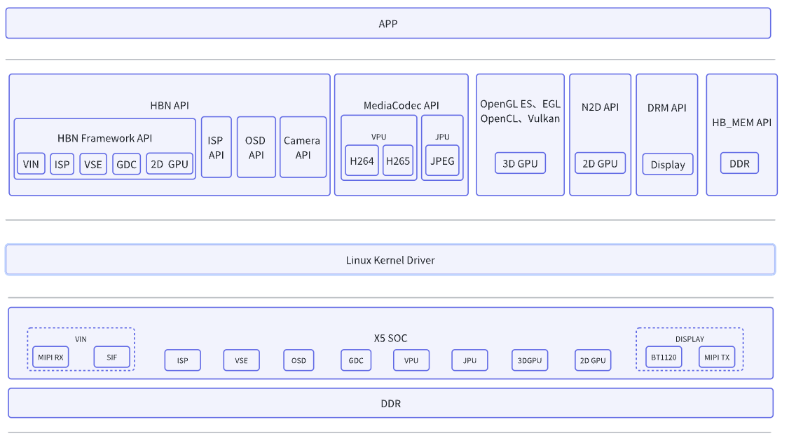

5.1.4. Software Aspect
5.1.4.1. Framework
Block Diagram
The following describes the function of each API from left to right:
  1. HBN API: Includes HBN Framework API, ISP API, OSD API, Camera API, covering all modules in the camera capture pipeline
    • HBN Framework API: The core software framework of the multimedia system
      Treats each module as a node (vnode), connecting modules to form a pipeline (vflow)
      Currently covers VIN, ISP, VSE, GDC, 2DGPU; see HBN Framework Interface Specification for details
    • ISP API: Used to dynamically configure and retrieve ISP module parameters; see Image Quality ISP for details
      Static parameter configuration and data flow of the ISP module are implemented in HBN Framework
    • OSD API: Used to create and configure the OSD module. Not covered by HBN Framework API, but can be attached to VSE node channels via interfaces
      See Region Processing OSD for details
    • Camera API: Used to configure Camera Sensor. Not covered by HBN Framework API, but can be attached to VIN nodes via interfaces
      See Video Input Camera for details
  2. MediaCodec API: Controls VPU and JPU modules to achieve H.264, H.265, JPEG encoding/decoding functions; see Video Codec MediaCodec for details
  3. OpenGL ES, EGL, OpenCL, Vulkan: Interfaces for 3DGPU, standard 3DGPU frameworks; see 3DGPU for details
  4. N2D API: Interface for 2DGPU; see 2DGPU for details. Some functions are integrated into the HBN framework; use of N2D API is recommended
  5. DRM API: Interface for video display module; see Video Output Display for details
  6. HB_MEM API: Enables management of large physically contiguous memory blocks in user space; see Memory Management Hbmem for details
    • Enables video frame data buffering: Memory used by all hardware acceleration units and DMA modules must be physically contiguous
    • Enables video frame data transfer: Based on dmabuf at the lower level, enables direct transfer of image data between different kernel drivers and between kernel and user space
