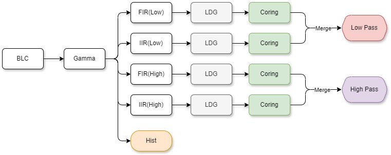

Auto-focus achieves its goal by analyzing image contrast and automatically adjusting the camera lens. The statistical information for the auto-focus algorithm is provided by the AFM module within the ISP. The AFM module calculates the image sharpness value FV (Focus Value) through built-in filters that perform convolution on RAW data. The AFM module’s statistics position is at the end of the RAW domain.
The AFM module contains FIR and IIR high-pass and low-pass filters. The FIR high-pass filter result and the IIR high-pass filter result are fused, and the low-pass filter results are fused together, ultimately outputting two groups of statistics: high-pass and low-pass. The statistics area consists of a fixed number of 15x15 zones, and the overall statistics area size is configurable.

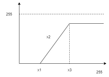

The coring function eliminates noise in low-light areas to increase sharpness. Pixel values below a certain threshold are clipped according to the coring curve. The first parameter x1: if input x < x1, then y = 0. The second parameter x2: if x1 < x < x2, then y = (x - x1) * x2 / 16. The third parameter x3: the slope of the linear mapping stage. The default parameters are as follows, representing a mapping slope of 1 in the range 32 to 230.

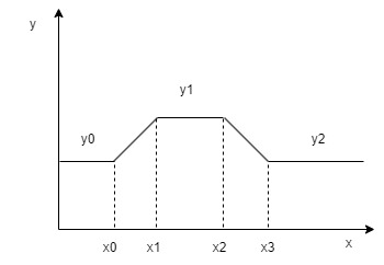

Level Dependent Gain (LDG) adjusts sharpness according to pixel values. It increases low pixel values and reduces high pixel values according to the LDG curve. LDG is applied after the IIR filter and FIR filter.
Taking the high-pass IIR filter as an example, iirHighPassY[0~2]: the Y-axis of the LDG curve for high-pass IIR filtering, representing the amplification factor for input x, i.e., 1.0 means y = x * 1, 2.0 means y = 2 * x. iirHighPassX[0~3]: the X-axis of the LDG curve for high-pass IIR filtering, corresponding to x[0~3] in the figure, representing the numerical range for determining input x. Different ranges determine the mapped amplification slope.

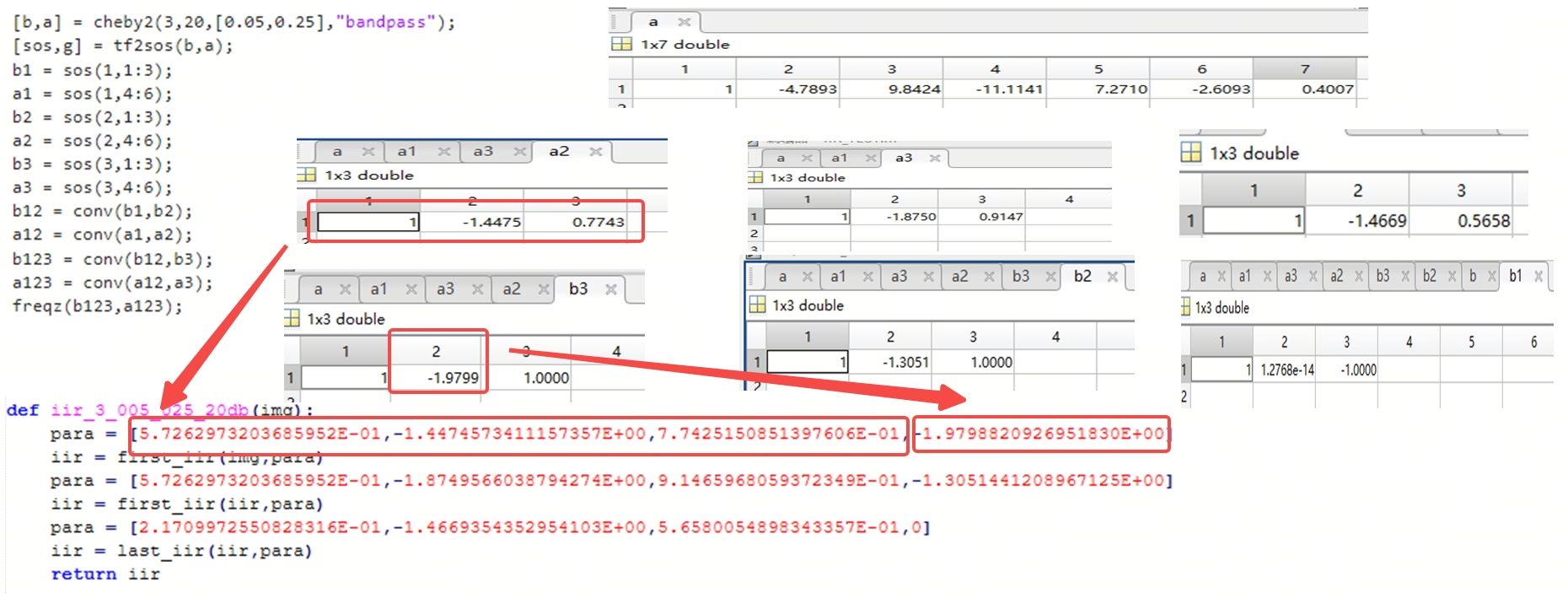

5.16.10. IIR Parameter Generation Steps Reference
The interface uses a Chebyshev Type II filter, with the first parameter being 3rd order and the last parameter being “bandpass”. These two parameters cannot be changed. Then use tf2sos to decompose it into 2nd order. The correspondence between the resulting parameters and the JSON parameters is as follows:
  1. The three parameters of a2 correspond to the first three parameters of the first column in JSON, and the second parameter of b3 corresponds to the fourth parameter of the first column in JSON.
  2. The three parameters of a3 correspond to the first three parameters of the second column in JSON, and the second parameter of b2 corresponds to the fourth parameter of the second column in JSON.
  3. The three parameters of a1 correspond to the first three parameters of the third column in JSON, and the second parameter of b1 corresponds to the fourth parameter of the third column in JSON.
