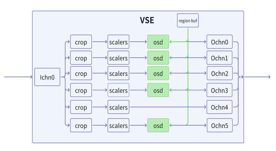

  1. The input channel (Ichn0) of VSE receives data from two sources: one via VFLOW, and the other through recirculation.
  2. The region buffer is created via hbn_rgn_create, and then attached to a specified VSE channel using hbn_rgn_attach_to_chn.
  3. After binding the OSD to a specific VSE output channel (Ochnx), the OSD hardware automatically overlays the region buffer data onto the video frames processed by VSE.
  4. VSE output channel 4 (Ochn4) does not support hardware OSD and defaults to NEON-based software implementation for OSD overlay.
  5. When more than 4 regions are used on a VSE output channel, the extra regions beyond 4 are processed using software with NEON instructions.

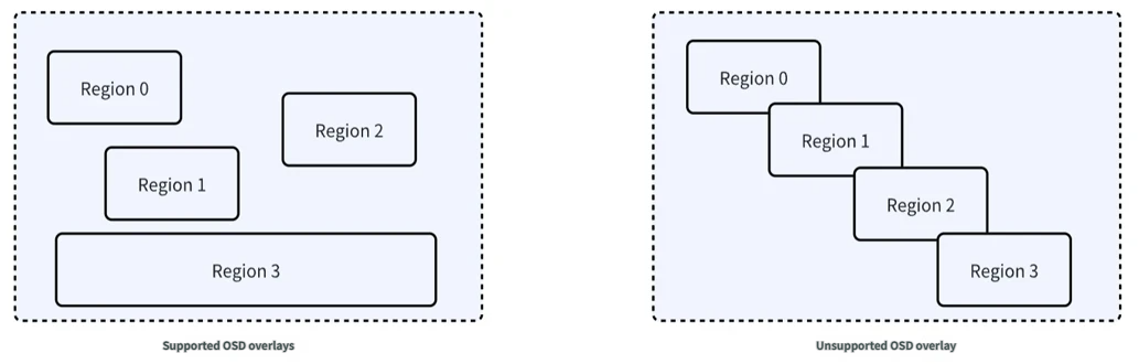

Region Limitations: Each VSE channel supports up to 4 non-overlapping OSD regions in hardware (i.e., the 4 Regions must not overlap vertically). Below are example diagrams:
The left image shows supported OSD region overlay methods; the right image shows unsupported methods.
