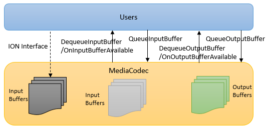

Input and Output Buffer Management
MediaCodec buffers include input and output buffers. There are two cases for the source of input buffers:
  1. Internal input buffer mode: Input source comes from memory allocated internally by MediaCodec via the hbmem interface
  2. External input buffer mode: Input source comes from output memory of other modules, which must also be allocated via the hbmem interface, such as memory output from the VSE module
Notes:
  • The source of input buffers is controlled by the external_frame_buf member in the mc_video_codec_enc_params_t structure
  • The specific source of input buffers can be any physically contiguous memory, such as memory output from the hbn framework. For specific examples, refer to the source code of sunrise_camera.
Internal Input Buffer Mode
Users do not need to manage buffer allocation. They only need to perform a dequeue operation before processing to obtain a free buffer, and then perform a queue operation to return the buffer after processing. As shown in the diagram below:
Block Diagram
External Input Buffer Mode
The purpose of external input buffer mode is to reduce copy operations of input buffers. For example:
When the output buffer from VSE is used for encoding, this buffer is allocated internally by VSE via the hbmem interface and can be directly used as the input buffer for MediaCodec.
Note: Even when users use external input buffers, they still need to perform a dequeue operation to obtain queue information, assign values to the information in the queue (mainly virtual and physical addresses), and then perform a queue operation.

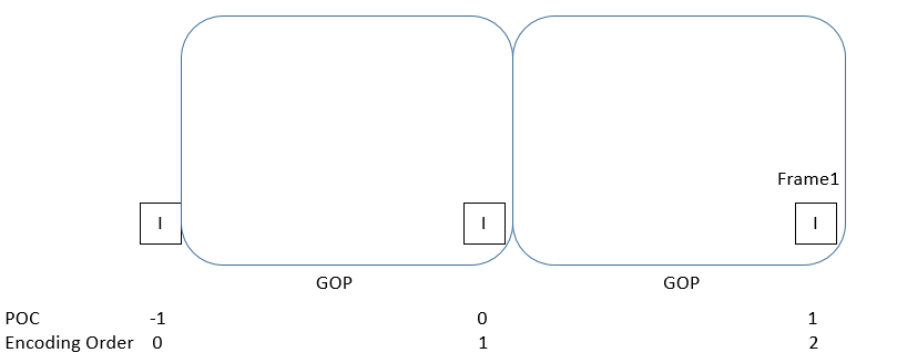

1 I Yes 1 I0-I1-I2 … 1 1 -

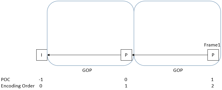

9 P Yes 1 P0 1 2 -
GOP Preset 1
  • Contains only I-frames, no inter-frame references;
  • Low latency;
Block Diagram Block Diagram
GOP Preset 9
  • Contains only I-frames and P-frames;
  • P-frames reference one forward reference frame;
  • Low latency;

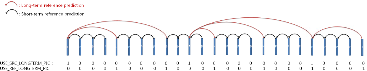

Long-term Reference Frames
Users can specify the long-term reference frame mode:
  1. Mode definition: hb_mm_mc_set_longterm_ref_mode
  2. Reference example: hb_mm_mc_get_longterm_ref_mode_demo
Block Diagram

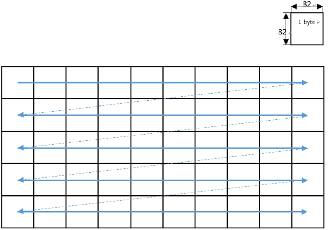

ROI
ROI encoding implementation is similar to QPMAP, requiring users to set QP values for each block in raster scan order, as shown in the diagram below:
Block Diagram
In H.264 encoding, each block is 16x16 pixels, while in H.265 encoding, block size extends to 32x32 pixels. In the ROI (Region of Interest) map, each QP (Quantization Parameter) value occupies 1 byte, with values ranging from 0 to 51.
ROI encoding can work with CBR and AVBR. When CBR or AVBR is disabled, the actual QP value for each block region equals the value specified in the ROI map. When CBR or AVBR is enabled, the actual value for each block region is determined by the following formula:
QP(i) = MQP(i) + RQP(i) - ROIAvgQP
Where MQP is the value from the ROI map, RQP is the value obtained from internal rate control of the encoder, and ROIAvgQP is the average QP value in the ROI map.
For sample code, please refer to: hb_mm_mc_get_longterm_ref_mode

5.12.4.14. hb_mm_mc_queue_input_buffer
【Function Declaration】
hb_s32 hb_mm_mc_queue_input_buffer(media_codec_context_t *context,
media_codec_buffer_t *buffer, hb_s32 timeout)
【Parameter Description】
  • [IN] media_codec_context_t *context: The context specifying the codec type
  • [IN] media_codec_buffer_t *buffer: Input buffer information
  • [IN] hb_s32 timeout: Timeout duration (in milliseconds)
【Return Value】
  • 0: Operation succeeded
  • HB_MEDIA_ERR_UNKNOWN: Unknown error
  • HB_MEDIA_ERR_OPERATION_NOT_ALLOWED: Operation not allowed
  • HB_MEDIA_ERR_INVALID_INSTANCE: Invalid instance
  • HB_MEDIA_ERR_INVALID_PARAMS: Invalid parameters
  • HB_MEDIA_ERR_INVALID_BUFFER: Invalid buffer
  • HB_MEDIA_ERR_WAIT_TIMEOUT: Wait timeout
【Function Description】
Queues the input buffer for processing by MediaCodec.
【Example Code】

mc_video_longterm_ref_mode_t *params)
  • [IN] media_codec_context_t *context: Context specifying the codec type
  • [OUT] mc_video_longterm_ref_mode_t *params: Parameters for long-term reference frame mode
【Return Value】
Get parameters of the long-term reference frame mode, applicable for H264/H265.
