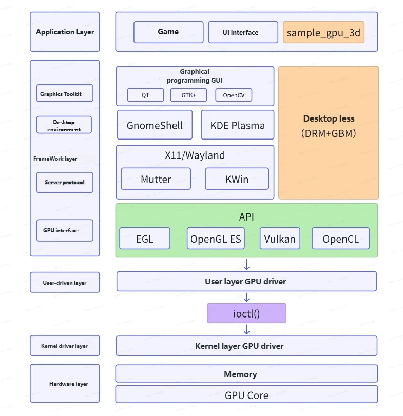

The 3D GPU framework is illustrated in the figure below:
Note: The X5 BSP does not default to porting a desktop system. GPU rendering effects can be implemented using DRM and GBM (as shown by the yellow section in the Framework layer).
gpu_3d_descript_framework
The following describes each layer individually (from bottom to top):
  1. Hardware Layer: The GPU Core is the actual GPU hardware, responsible for accelerating 3D image processing. The rendered output can be stored in DDR.
  2. Kernel Driver Layer: In X5, the GPU driver is not integrated with DRM but instead provides interfaces upward through the ioctl interface of a character device driver.
  3. User-Space Driver Layer: By encapsulating the ioctl interface, this layer enables interaction between the GPU interface layer and the driver layer.
  4. Framework Layer: Contains four sub-layers:
    • GPU Interface Layer (green background): Includes four standard APIs: EGL, OpenGL ES, Vulkan, and OpenCL. Detailed explanations will be provided later.
    • Server Protocol Layer: Common display server protocols include Wayland and X11. Wayland is a successor to X11. Common implementations of the Wayland protocol include Mutter and KWin.
    • Desktop Environment: GnomeShell and KDE are both modern desktop environments based on the Wayland protocol, responsible for user interaction interfaces.
      • GnomeShell is based on Mutter (a specific implementation of the Wayland protocol).
      • KDE is based on KWin (a specific implementation of the Wayland protocol).
    • Graphics Toolkit: GTK and Qt are two different GUI toolkits that provide developers with graphical controls and interface construction tools.
  5. Application Layer: There are two scenarios for application layer implementation:
    • Case 1: With a desktop environment, the application layer can use various graphics libraries to develop complex games and UI interfaces.
    • Case 2: Without a desktop environment (yellow background in the diagram: sample_gpu_3d), the application layer directly calls GPU interfaces and uses DRM and GBM to display GPU-rendered images.
