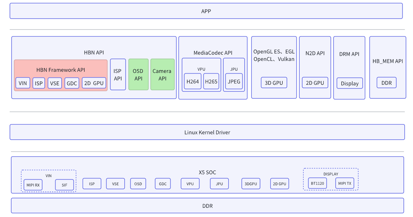

5.2.1. Overview
The HBN framework is marked in red in the multimedia system software architecture diagram and covers most modules in the Camera Sensor capture pipeline, including VIN, ISP, VSE, GDC, and N2D.
The Camera API and OSD API (shown in green in the diagram) are not included within the HBN framework, but they can be attached to the HBN framework via corresponding attach functions.
In summary, the HBN framework encompasses all modules in the Camera Sensor capture pipeline and provides simple and flexible APIs.

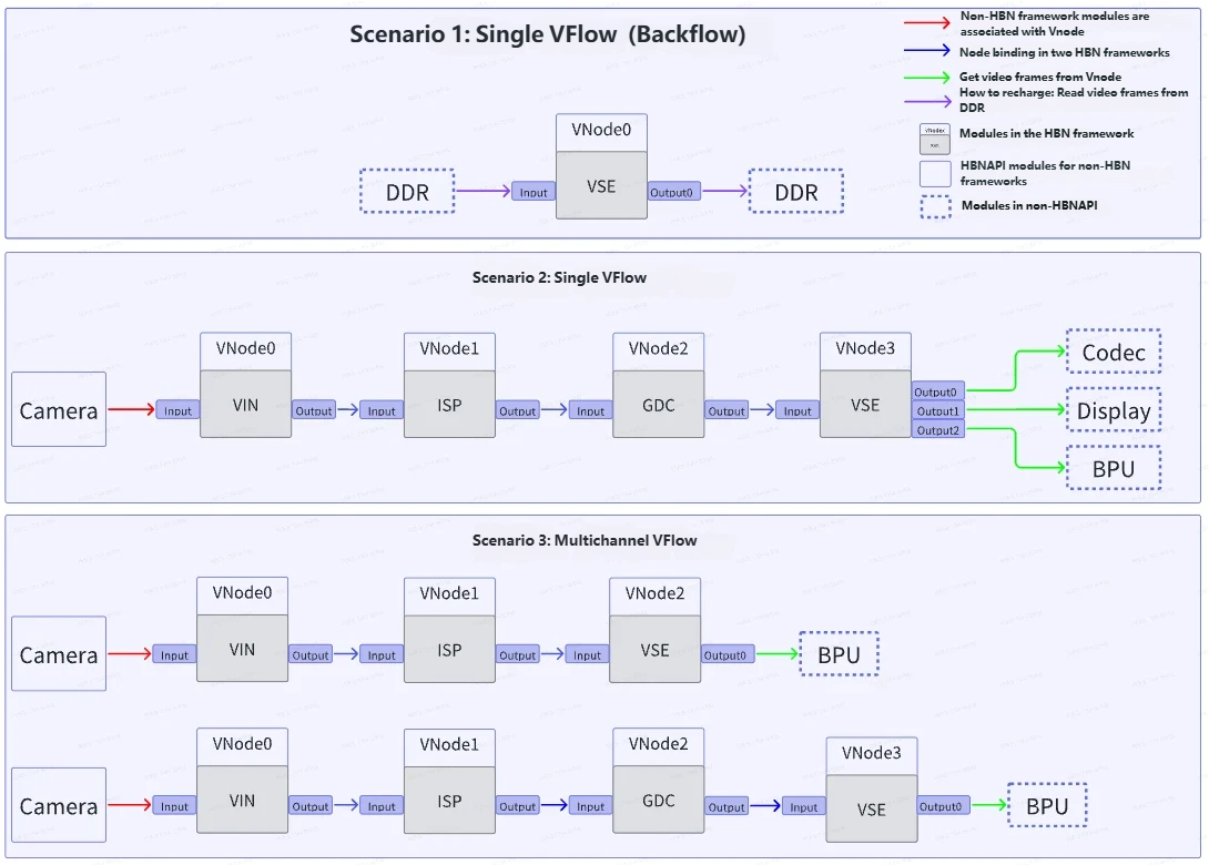

The figure below shows examples of vflow in three scenarios (Recirculation in Scenario 1 means the data source comes from DDR):
Block Diagram
  1. Scenario 1: Single vflow (recirculation)
    • Scenario description: Video frames come from DDR (e.g., reading a video file into DDR), and VSE is used to scale the video frames
    • Data source: The data source is not included in the vflow; video frames from DDR must be actively fed into the vflow within a thread
    • The vflow must contain at least one vnode, and can contain multiple. When there is only one node, it does not need to be bound to the vflow. When multiple vnode nodes exist and need to be connected, they must be bound to the vflow
    • VSE, GDC, ISP, and N2D all support recirculation mode
  2. Scenario 2: Single vflow
    • Scenario description: One Camera is connected, passing through VIN, ISP, GDC, and VSE. Three output channels are generated at VSE, processed as follows:
      • Channel 0: Sent to CODEC for encoding
      • Channel 1: Sent to Display for rendering
      • Channel 2: Sent to BPU for inference
    • Data source: Camera Sensor connected via MIPI interface
    • The data source is included in the vflow. After the vflow is started, the HBN framework automatically schedules data flow transmission, requiring no developer intervention
    • After the vflow starts, video frames can be continuously retrieved from the end node and passed to acceleration units outside the HBN API, such as the devices in the dashed box in the figure (Codec, Display, BPU)
  3. Scenario 3: Multiple vflows
    • Scenario description: Two Cameras are connected, each passing through different processing pipelines
    • Data source: Each vflow connects one Camera
    • Two vflows are used to complete the capture of two video pipelines
    • The two vflows are completely independent

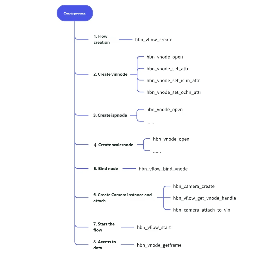

5.2.5. API Call Flow
5.2.5.1. Creation Flow
API Creation Flow

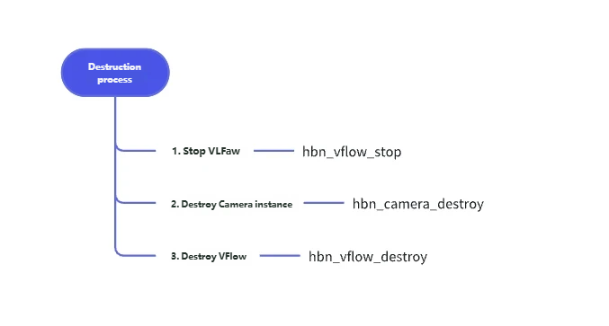

5.2.5.2. Destruction Flow
The destruction flow is the reverse of the creation flow, but note the following:
API Destruction Flow

5.2.6.22. hbn_vflow_create
【Function Declaration】
hobot_status hbn_vflow_create(hbn_vflow_handle_t *vflow_fd)
【Parameter Description】
  • [OUT] hbn_vflow_handle_t *vflow_fd: vflow handle;
【Return Value】
【Function Description】
Create a vflow and return the vflow handle.
【Notes】
None
5.2.6.23. hbn_vflow_destroy
void hbn_vflow_destroy(hbn_vflow_handle_t vflow_fd)
  • [IN] hbn_vflow_handle_t *vflow_fd: vflow handle;
【Return Value】
None
Destroy a vflow based on the provided vflow handle.
【Notes】
None
5.2.6.24. hbn_vflow_add_vnode
hobot_status hbn_vflow_add_vnode(hbn_vflow_handle_t vflow_fd, hbn_vnode_handle_t vnode_fd)
  • [IN] hbn_vnode_handle_t vnode_fd: The vnode handle of the module;
【Return Value】
Add a module to the vflow for management.
【Notes】
None
5.2.6.25. hbn_vflow_bind_vnode
hobot_status hbn_vflow_bind_vnode(hbn_vflow_handle_t vflow_fd, hbn_vnode_handle_t src_vnode_fd, uint32_t out_chn, hbn_vnode_handle_t dst_vnode_fd, uint32_t in_chn)
  • [IN] hbn_vnode_handle_t src_vnode_fd: Source module’s vnode handle;
  • [IN] uint32_t out_chn: Output channel ID of the source module. See channel IDs in: Module Channel Description
  • [IN] hbn_vnode_handle_t dst_vnode_fd: Destination module’s vnode handle;
  • [IN] uint32_t in_chn: Input channel ID of the destination module. See channel IDs in: Module Channel Description
【Return Value】
Bind two modules together. After binding, data frames from the src_vnode_fd module will automatically flow to the dst_vnode_fd module.
【Notes】
The flow must be created and the modules must be opened.

5.2.6.27. hbn_vflow_start
hobot_status hbn_vflow_start(hbn_vflow_handle_t vflow_fd)
  • [IN] hbn_vflow_handle_t vflow_fd: vflow handle;
【Return Value】
Start a vflow. All vnodes contained within the vflow will be started.
【Notes】
Module vnode needs to be added to vflow in advance.
5.2.6.28. hbn_vflow_stop
hobot_status hbn_vflow_stop(hbn_vflow_handle_t vflow_fd)
【Return Value】
Stop a vflow. All vnodes contained in the vflow will be stopped.
【Notes】
Should be used in pair with hbn_vflow_start.

5.2.6.30. hbn_vflow_create_cfg
hobot_status hbn_vflow_create_cfg(const char *cfg_file, hbn_vflow_handle_t *vflow_fd)
  • [IN] const char *cfg_file: configuration file path;
  • [OUT] hbn_vflow_handle_t *vflow_fd: pointer to vflow handle array, which may contain multiple vflows;
【Return Value】
Create a vflow containing vnodes and their binding relationships from a configuration file.
Operations inside the interface include: creating vflow, creating vnode, adding vnode to vflow, and binding vnodes.
【Notes】
None
