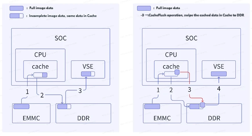

Cache Flush
Cache flush writes data cached in Cache back to DDR.
Example scenario: Reading video frames from eMMC into DDR and then handing over to VSE for processing.
  1. Left diagram: Without calling Cache flush
  2. Right diagram: With Cache flush called at the appropriate time (hb_mem_flush_buf)
Block Diagram
Explanation of left diagram (cache consistency issue exists):
  • Step 1: CPU reads video data from eMMC, data passes through Cache during transfer
  • Step 2: Video data is stored in DDR. However, after reading completes, some data may remain in Cache and not fully written to DDR
  • Step 3: VSE reads video data from DDR for processing, but due to incomplete data (some still in Cache), the processed result is incorrect
Explanation of right diagram (cache consistency issue resolved):
  • Step 1: Same as left
  • Step 2: Same as left
  • Step 3: Call Cache flush interface hb_mem_flush_buf to write Cache data back to DDR
  • Step 4: VSE reads video data from DDR and processes it, now able to access complete video data

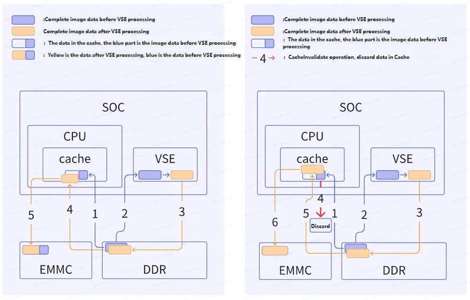

Cache Invalidate
Cache invalidation discards already-cached DDR data in Cache, marking it as invalid (miss).
Subsequent DDR accesses will not use old data in Cache but will force a read from DDR to get the latest data.
Example scenario: VSE reads video data from DDR, processes it, and saves it to eMMC:
  1. Left diagram: Without calling Cache invalidate
  2. Right diagram: With Cache invalidate called at the appropriate time (hb_mem_invalidate_buf)
Block Diagram
  • Step 1: CPU reads video data from DDR and performs algorithm processing; Cache now holds some DDR data
  • Step 2: VSE reads video data from DDR
  • Step 3: VSE internally overlays text and writes the result back to DDR
  • Step 4: CPU continues reading video data from DDR. Since VSE wrote new data in Step 3, but Cache still holds old data from Step 1,
    CPU only reads data not present in Cache
  • Step 5: CPU writes the read data to eMMC. Since only partial new data was read in Step 4, the data written to eMMC is incorrect.
  • Step 3: Same as left
  • Step 4: Call Cache invalidate interface hb_mem_invalidate_buf to discard Cache data and mark it as invalid
  • Step 5: CPU reads video data from DDR. Since old Cache data was discarded in Step 4, CPU reads all the latest video data from DDR
  • Step 6: CPU writes the read data to eMMC. Since all data read in Step 5 is up-to-date, the data written to eMMC is correct.

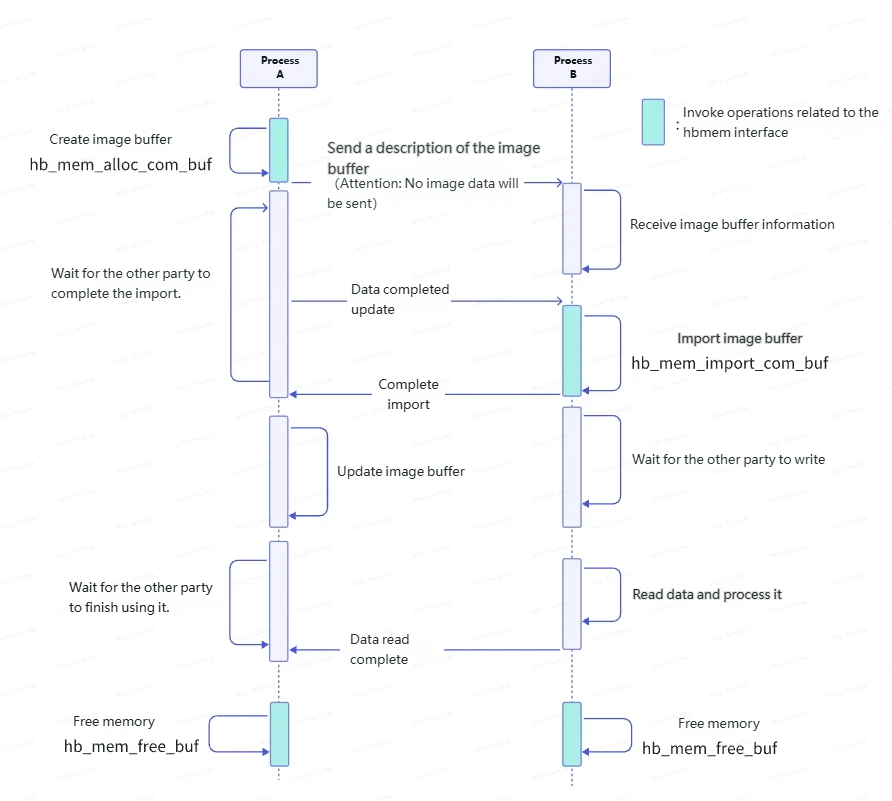

5.4.1.2. Memory Sharing
Memory sharing module interfaces enable safe memory sharing among multiple threads/processes. Usage flow:
  1. Users can directly pass the structure corresponding to the allocated memory unit to another thread or process
  2. The receiving process imports the structure using the hb_mem_import_xxx interface (see table below), achieving safe buffer sharing.
Corresponding structures and interfaces for memory allocation units are:
  1. Contiguous memory block: hb_mem_common_buf_t
  2. Graphic buffer: hb_mem_graphic_buf_t
  3. Graphic buffer group: hb_mem_graphic_buf_group_t
Memory Type Structure hb_mem_import_xxx Interface
Contiguous Memory hb_mem_common_buf_t hb_mem_import_com_buf
Graphic Buffer hb_mem_graphic_buf_t hb_mem_import_graph_buf
Graphic Buffer Group hb_mem_graphic_buf_group_t hb_mem_import_graph_buf_group
The diagram below illustrates memory sharing between multiple processes (using hb_mem_common_buf_t as an example):
Block Diagram

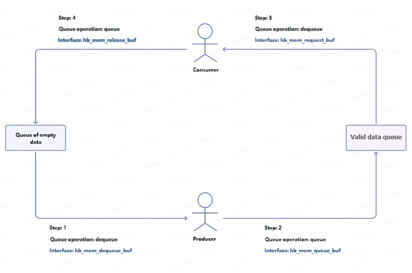

5.4.1.3. Memory Queue Management
The memory queue management module provides a general-purpose queue mechanism supporting data flow between producers and consumers.
Internally, the module maintains two queues: empty data queue and valid data queue. Data flows between producer and consumer via these two queues:
Steps:
  1. Producer gets an item from the empty data queue and fills it with valid data
  2. Producer stores the filled item into the valid data queue
  3. Consumer gets an item from the valid data queue and reads its valid data
  4. Consumer returns the processed item back to the empty data queue
Block Diagram

Invalidate the buffer associated with fd. When the allocated buffer has the attribute HB_MEM_USAGE_CACHED (see: hbmem Memory Allocation Attributes), it indicates that the buffer is cacheable. This operation must be performed by the user before reading from the buffer.
【Example Code】

Flush the buffer associated with fd. When the allocated buffer has the attribute HB_MEM_USAGE_CACHED (see: hbmem Memory Allocation Attributes), it indicates that the buffer is cacheable. This operation must be performed by the user after writing to the buffer;
【Example Code】
