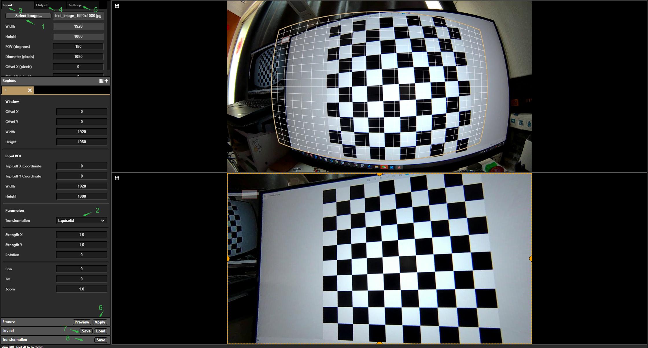

Using the GDC Tool generally involves the following steps: image-20250107-164759.png
The green arrows in the above figure correspond to the steps listed below.
  1. After successfully logging into the web interface, upload the prepared image captured by the sensor. Before uploading, convert the captured YUV image to JPG format.
    Prepare JPG Image: Use ffmpeg to convert the YUV file obtained from the sensor into a JPG image for upload. Example command:
    ffmpeg -s 1920x1080 -pix_fmt yuv420p -i handle_100197_isp_chn0_1920x1080_stride_1920_frameid_0_ts_2411352368066.yuv  output.jpg
  2. Confirm the transformation mode based on the use case. Set Transformation to the corresponding mode. If using the Custom mode, prepare and upload the GDC calibration parameter file as well.
  3. Configure GDC parameter information according to the transformation mode, setting Input in the diagram. For details, see section Transformation Mode Parameter Description.
  4. Configure GDC parameter information according to the transformation mode, setting Output in the diagram. For details, see section Transformation Mode Parameter Description.
  5. Configure GDC parameter information according to the transformation mode, setting Settings in the diagram. For details, see section Transformation Mode Parameter Description.
  6. After successfully configuring the GDC parameters, click Preview to view the result and confirm whether it meets expectations.
  7. After confirming the simulation result meets expectations, export the layout.json file for use. Usage instructions can be found in the GDC sample code section sample_gdc.
  8. After confirming the simulation result meets expectations, export the BIN file for use. Usage instructions can be found in the GDC sample code section sample_gdc.
Note: Only one of the BIN or JSON files exported in steps 7 and 8 needs to be used.

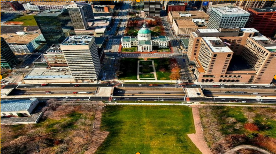

Equisolid Panoramic transformation with maximum grid coverage

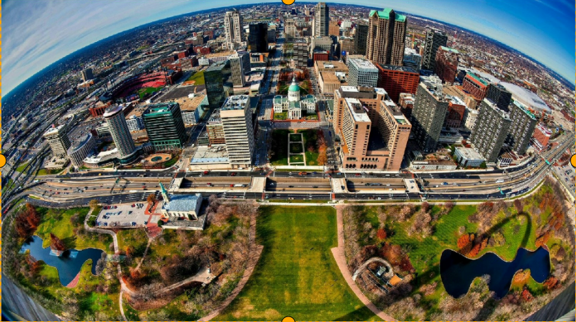

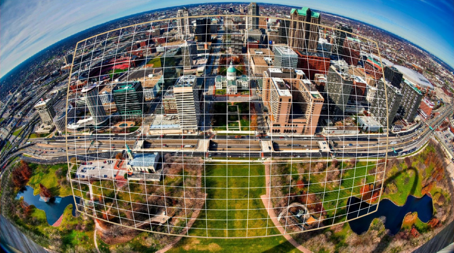

All transformation types have the following three common parameters: Pan, Tilt, Zoom (example: equidistant transformation with input/output resolution 1280x720):
In the following output images, the blue rectangle indicates only the specific parameter is set to that value, while all other parameters in the transformation remain at their default values.

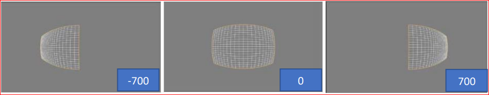

Pan
Horizontal offset (-1280, +1280): Shifts the transformation grid by the given number of pixels horizontally. As shown below:
3-1

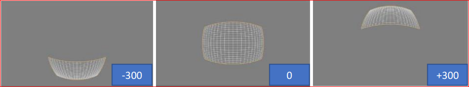

Tilt
Vertical offset (-720, +720): Shifts the transformation grid by the given number of pixels vertically. As shown below:
3-2

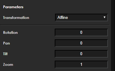

Affine
【Function Description】
Provides linear transformation.
3-4
【Member Description】
Member Meaning
int32_t pan default 0, no change
int32_t tilt default 0, no change
zoom scale transformation output by provided factor
double angle (rotation) 0/90/180/270
Note: The width of input and output dimensions should be aligned to 16 pixels.

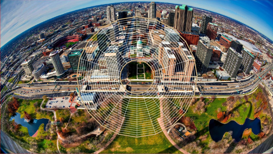

This transformation provides equisolid (panoramic) correction and displays the result as a planar projection.
3-5

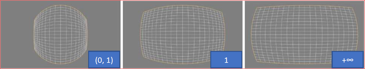

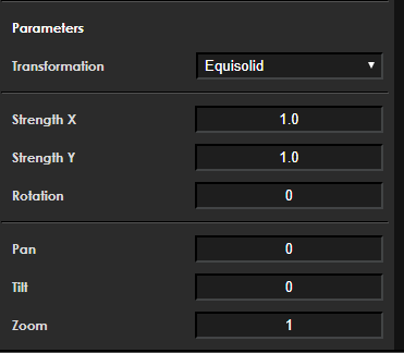

Strength X debugging effect: transformation strength along the X-axis, range (0, +∞). As shown below:
3-6

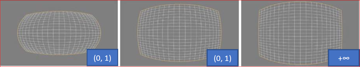

Strength Y debugging effect: transformation strength along the Y-axis, range (0, +∞). As shown below:
3-7

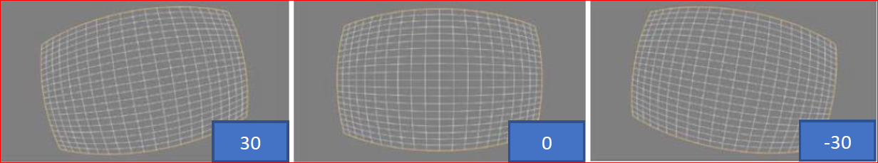

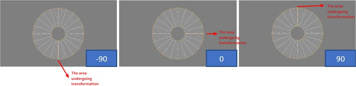

Rotation debugging effect: value range (-180, 180). As shown below:
3-8

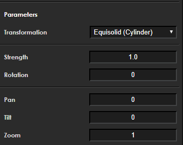

Equisolid (cylinder)
This transformation provides equisolid correction for projecting the result image onto a cylindrical panoramic view from a full fisheye frame.
3-9
Member Meaning
strength transformation strength

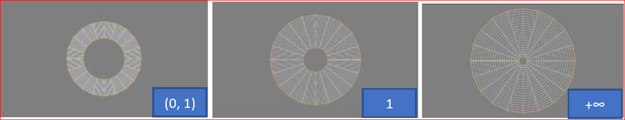

Strength debugging effect: transformation strength (0, +∞). As shown below:
3-10

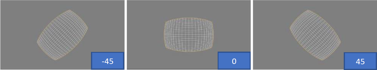

Rotation debugging effect: value range (-180, +180). As shown below:
3-11

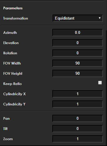

Equidistant
The equidistant transformation includes many parameters that allow it to project to a variety of target planes. This gives users more freedom to select the desired region of the fisheye frame to transform.
3-12
Member Meaning
int32_t pan Horizontal offset of the transformation grid by given number of pixels
int32_t tilt Vertical offset of the transformation grid by given number of pixels
zoom Scale transformation output by provided factor
double angle(rotation) Rotation angle of the image
double elevation Defines the elevation angle of the projection axis, range 0 to 90
double azimuth Defines the azimuth angle of the projection axis. If elevation is 0, azimuth has no visible effect
int32_t keep_ratio When "keep ratio" is enabled, the FOV height parameter is ignored and automatically calculated to maintain equal stretch intensity in horizontal and vertical directions
double FOV_h Describes the size of the output field of view in the horizontal dimension (in degrees). Valid range: 0 to 180
double FOV_w Describes the size of the output field of view in the vertical dimension (in degrees). Valid range: 0 to 180

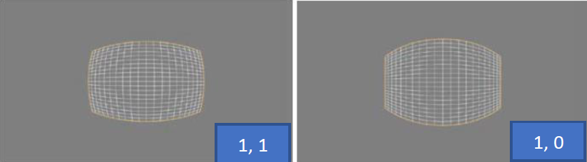

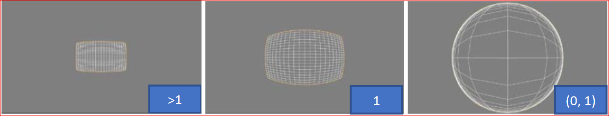

double cylindricity_y Describes the sphericity of the target projection along the Y-axis. Value from 0 to 1, where 1 is spherical. If set to 1 and cylindricity_x is 0, projection forms a cylinder along Y-axis
double cylindricity_x Describes the sphericity of the target projection along the X-axis. Value from 0 to 1, where 1 is spherical. If set to 1 and cylindricity_y is 0, projection forms a cylinder along X-axis
Note:
Normal field of view is approximately 90 degrees. For transformations with cylindricity (see below) equal to "0", FOV width and height values of 180 will cause infinite image stretching.
If both cylindricity_x and cylindricity_y are set to 1, the projection will be spherical. If both are 0, the transformation will be rectangular.

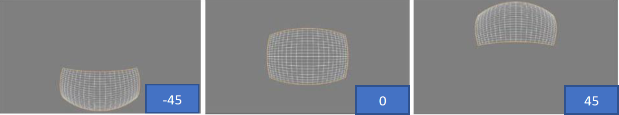

Elevation debugging effect:
3-13

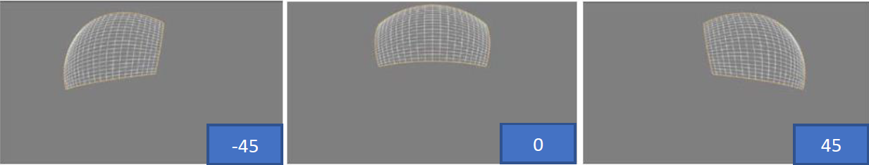

Azimuth debugging effect:
3-14

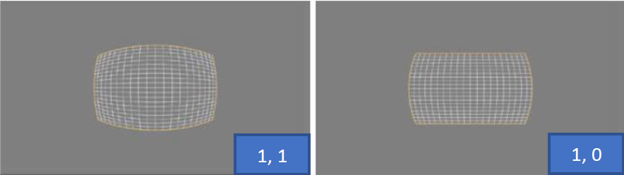

Cylindricity X debugging effect:
Describes the degree of sphericity of the target projection along the X-axis. Value range: 0 to 1, where 1 is spherical. If set to 1 and cylindricity Y is 0, the projection forms a cylinder along the X-axis. As shown below:
3-16
Cylindricity Y debugging effect:
Describes the degree of sphericity of the target projection along the Y-axis. Value range: 0 to 1, where 1 is spherical. If set to 1 and cylindricity X is 0, the projection forms a cylinder along the Y-axis. As shown below:
3-17

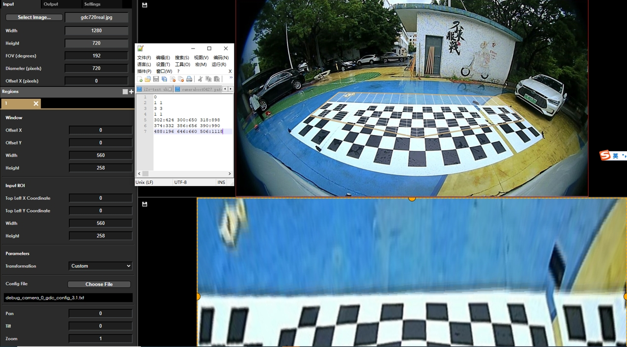

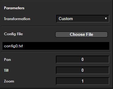

Custom

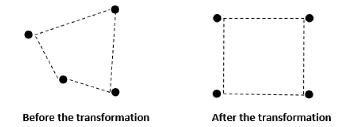

With the Custom transformation, each polygon in the input image is transformed into a square. In other words, any four adjacent input points of any shape become a square after transformation, as shown below. However, the shape and position of the polygons will change after transformation.
3-18
They are used to create transformations that cannot be described by any provided transformation. To correct arbitrary distortions, a special calibration file must be provided to the GDC tool. As shown below:
3-19
Member Meaning
char custom_file[128] Sampling point file name
custom_tranformation_t custom Parsed custom transformation structure

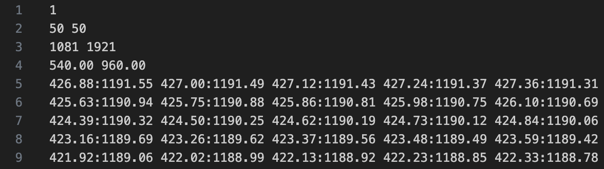

Sampling Point File Explanation
Rules for sampling point files:
  1. The first line enables full tile in pixel calculation: 1 for enable, 0 for disable.
  2. The second line specifies the number of pixels to skip if full tile is enabled; these values must be greater than 0. Smaller numbers result in slower libgdc performance (slower performance means the BIN file generated by libgdc is larger and takes longer to generate).
  3. The third line specifies the number of sampling points in vertical and horizontal directions. The first value Y = 1081 means there are 1081 sampling points vertically, and the second value X = 1921 means there are 1921 sampling points horizontally.
  4. The fourth line specifies the center point of the selected region, typically (Y-1)/2, (X-1)/2.
  5. Sampling points must be non-negative integers or floats, and adjacent rows must not have duplicate sampling points.
e.g. The image below shows a partial data extract. Rows 5 to 9 contain coordinate values of sampling points in the source image, formatted as Y:X. In this example, there are 1081x1921 sampling points.
3-20
  1. Since sampling points must be equidistant, the output image resolution depends on the number of sampling points.
3-21
e.g. Output image Width = 100, Height calculated as 340. Calculation: 100/height = (96-1)/(324-1)

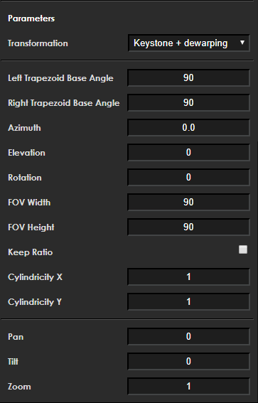

Keystone+dewarping
3-23
Member Meaning
int32_t keep_ratio When "keep ratio" is enabled, FOV height parameter is ignored and automatically calculated to maintain equal stretch intensity
double cylindricity_y Describes the sphericity of the target projection along the Y-axis (range 0 to 1). 1 means spherical. If set to 1 and cylindricity_x is 0, projection forms a cylinder along Y-axis

Custom Mode
  "inputRes": [
    1280, -- Width of input image
    720 -- Height of input image
  "param": {
    "fov": 192, -- Field of view of input image
    "diameter": 720, -- Diameter of input image, controls overall size of transformation grid
    "offsetX": 0, -- Horizontal offset of transformation grid
    "offsetY": 0 -- Vertical offset of transformation grid
  "outputRes": [
    560, -- Width of output image
    258 -- Height of output image
  "transformations": [
      "transformation": "Custom", -- Transformation mode
      "position": [ -- ROI setting of output image
        0, -- Horizontal offset of output image ROI
        0, -- Vertical offset of output image ROI
        560, -- Width of output image ROI, must be ≤ outputRes width
        258 -- Height of output image ROI, must be ≤ outputRes height
      "ptz": [
        0, -- pan parameter
        0, -- tilt parameter
        1 -- zoom parameter
      "roi": { -- Invalid in Custom mode
        "x": 0, -- Invalid in Custom mode
        "y": 0, -- Invalid in Custom mode
        "w": 0, -- Invalid in Custom mode
        "h": 0 -- Invalid in Custom mode
      "param": {
        "customTransformation": "/path_to/camera_0_gdc.txt" -- Path to coordinate file on device
  "mode": "semiplanar420", -- Processing format setting
  "eccMode": "eccDisabled", -- ECC processing mode
  "colourspace": "yuv" -- Data format being processed

Input image with transformation grid:
3-26

Equidistant
Configuration file content:
   "inputRes": [
       1920,
       1080
   "param": {
       "fov": 160,
       "diameter": 1080,
       "offsetX": 0,
       "offsetY": 0
   "outputRes": [
       1920,
       1080
           "transformation": "Universal",
           "position": [
               0,
               0,
               1920,
               1080
           "param": {
               "azimuth": 0,
               "elevation": 0,
               "rotation": 0,
               "fovWidth": 90,
               "fovHeight": 90,
               "keepRatio": 0,
               "cylindricityX": 1,
               "cylindricityY": 1
           "ptz": [
               0,
               0,
           "roi": {
               "x": 0,
               "y": 0,
               "w": 1920,
               "h": 1080
3-30
Output image:
3-31
Custom
Input 1280x720, output 560x258. Configuration file content:
   "inputRes": [
       1280,
       720
   "param": {
       "fov": 192,
       "diameter": 720,
       "offsetX": 0,
       "offsetY": 0
   "outputRes": [
       560,
       258
           "position": [
               0,
               0,
               560,
               258
           "ptz": [
               0,
               0,
           "roi": {
               "x": 0,
               "y": 0,
               "w": 1280,
               "h": 720
           "param": {
               "customTransformation": "/path_to/camera_0_gdc_config_3.1.txt"
3-32
Output image:
3-33

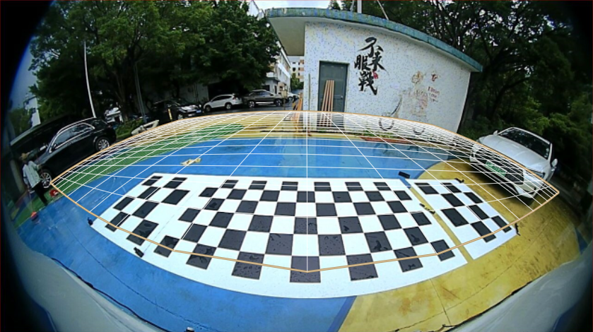

3-34
