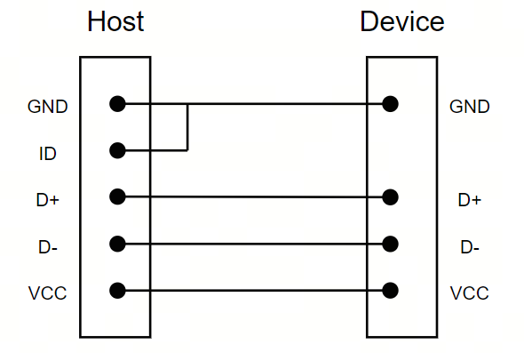

The X5 USB 2.0 enters Host mode by pulling down the USB ID pin (AON_USB2_ID). This can be achieved by connecting a USB OTG cable. The definition of the USB OTG cable is shown below:

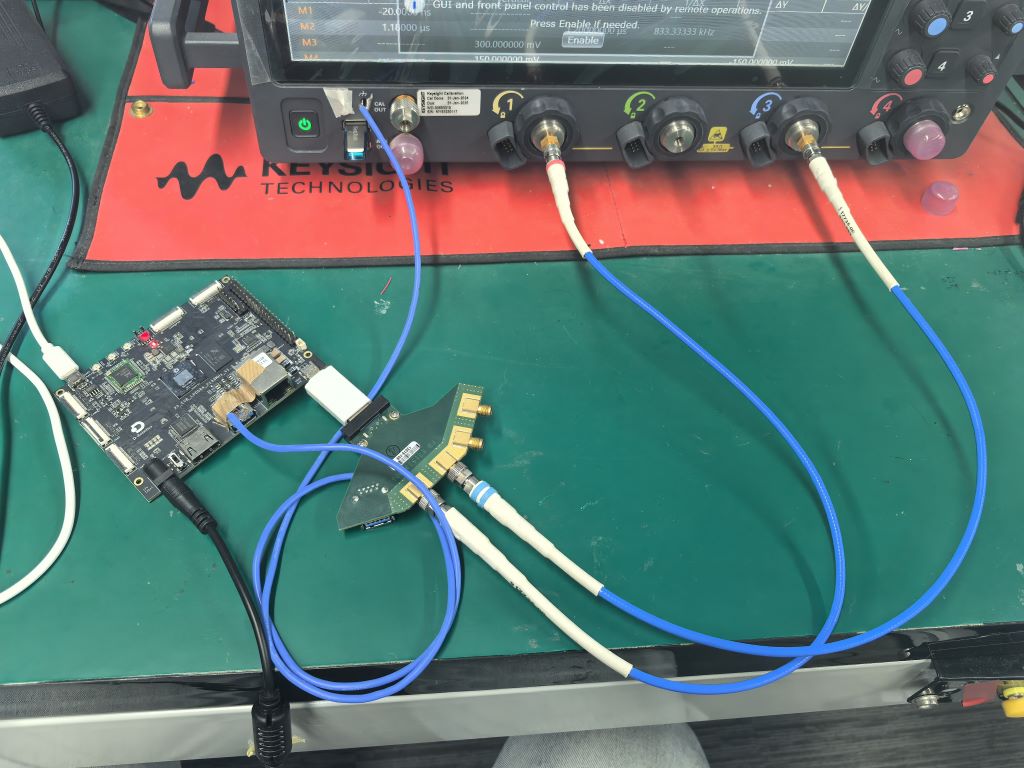

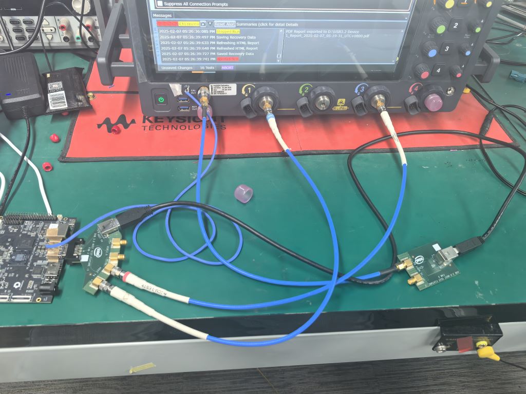

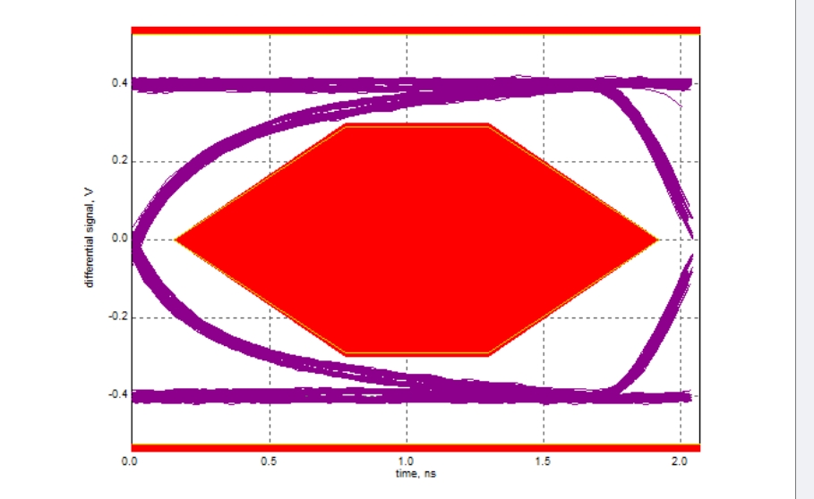

USB Eye Diagram Test
The USB eye diagram test results are shown below:
