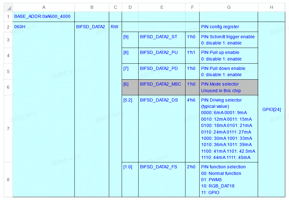

For example, if the board uses BIFSD_DATA2 as the reset pin, where the PHY chip resets on low level, requires at least 10ms reset duration, and becomes accessible 20ms after reset, follow these steps:
  1. According to the reference document 《PL-2501-3-J3 PIN SW Reg-V1.1.xls》, BIFSD_DATA2 corresponds to GPIO[24] (i.e., GPIO1.8, see worksheet PIN Mux List), and its PIN function configuration register is 0xA600_4060.

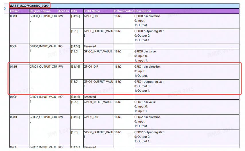

  1. According to 《RM-2501-5-J3 Register Reference Manual-GPIO&PIN-V1.1.pdf》, GPIO group 1 direction and output value configuration register is 0x6000_3018. The upper 16 bits configure direction (bit0 for gpio0, bit1 for gpio1, etc.), and lower 16 bits configure output value.

    // Set GPIO1.8 direction to output
    reg_val = readl(0xA6003018);
    reg_val |= 0x01000000;
    writel(reg_val, 0xA6003018);

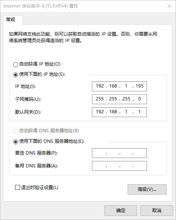

To test network connectivity in U-Boot, connect the X3 Ethernet port directly to a PC’s Ethernet port and set the PC NIC to a fixed IP address, for example:
  • IP Address: 192.168.1.195
  • Subnet Mask: 255.255.255.0
  • Gateway: 192.168.1.1

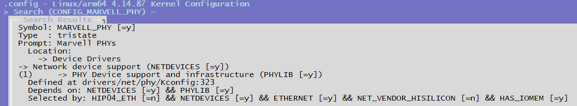

In the kernel, the corresponding PHY build option must also be enabled to compile the PHY driver into the kernel:
CONFIG_MARVELL_PHY=y
