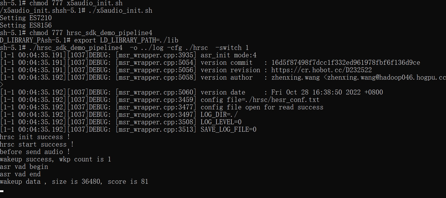

Runtime Result Demonstration
Test result of pipeline4 with log_level set to 3 is shown below:
Test_result

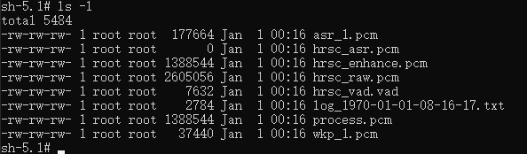

Log and audio saving results are shown below:
log_save
wkp_x.pcm and asr_x.pcm are single-channel wake-word audio and VAD-trimmed ASR audio respectively, where x is the wake-up sequence number.
hrsc_asr.pcm is the saved single-channel ASR audio.
hrsc_enhance.pcm is the three-channel noise-reduced audio, used for voice wake-up.
hrsc_raw.pcm is the four-channel audio. Its content varies depending on the input audio and represents the complete set of audio fed into the algorithm. Audio with fewer than four channels will be padded to four channels. For example, if a single-channel ASR audio is input, the first channel of the raw file contains the input single-channel data, and the remaining three channels are padded with zeros.
hrsc_vad.vad contains VAD flags (0 and 1), used for algorithm performance debugging.
log_xxx.txt is the log file name defined in the log saving configuration, where xxx represents the system timestamp.
process.pcm is the processed audio, i.e., the source audio fed into the algorithm.
