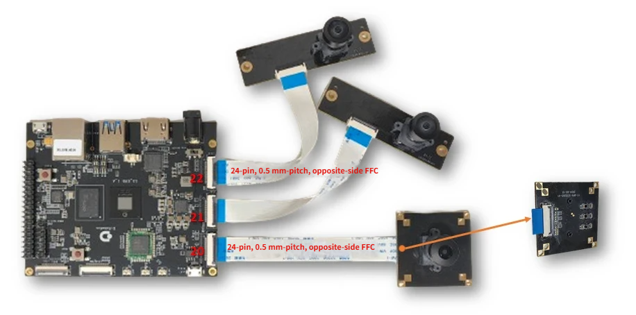

  • Hardware Resources: EVB development board, camera module to be adapted, schematic and PCB.
X5_Camera_Hardware_Resources_EN
The figure above shows the interfaces on the X5 EVB development board. The corresponding hardware IO resources for each interface are listed below:
Interface MIPI CSI Host Max Supported Lanes I2C Bus Reset GPIO LPWM/PWD MCLK
20 MIPI_CSI0&1 4 lanes I2C4 AON_GPIO_PIN0 - 498 LSIO_SPI5_SCLK - lpwm0 LSIO_SPI3_SCLK - mclk0
21 MIPI_CSI2 2 lanes I2C2 AON_GPIO_PIN4 - 502 LSIO_SPI5_SSN - lpwm1 LSIO_SPI3_MISO - mclk2
22 MIPI_CSI3 2 lanes I2C7 LSIO_GPIO1_06 - 353 LSIO_SPI5_MISO - lpwm2 LSIO_SPI3_MOSI - mclk3

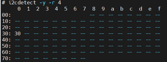

i2cdetect -y -r 4
  • Use i2cdetect to detect the sensor I2C address. If the correct address is detected, as shown below, it indicates the DTS configuration is correct. Otherwise, check the DTS configuration or follow the I2C Communication Failure steps for troubleshooting.
    ../../_images/5-7-3-110.png

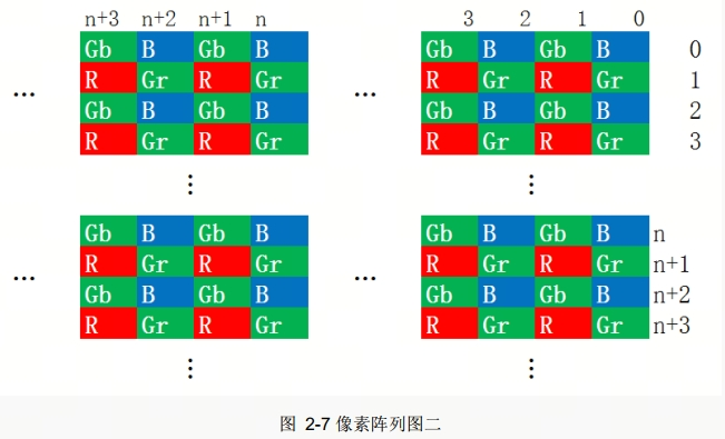

  9. Bayer format: The raw image pixel arrangement mode output by the sensor. Core parameters include bayer_pattern (pixel arrangement type, such as RGGB/RCCC/RIrGB/RGIrB) and bayer_start (starting pixel in RGGB mode, such as R/Gr/Gb/B). Generally described in the sensor spec.
    • In Bayer mode, each pixel on the image sensor has a color filter that only allows specific colors of light to pass through. The filters are arranged in a specific pattern. Taking sc230ai as an example, where bayer_start is B at (0,0):
../../_images/image_20260105-143431.png
