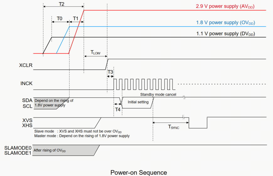

power_on
  1. power_on controls sensor power-up through X5 GPIO, following the spec power-on timing sequence.
  2. sensor_poweron is typically called in sensor_init, only XCLR needs to be controlled.
  3. The power-on sequence is identical for HDR mode and Linear mode. The following is the imx415 power_on implementation:

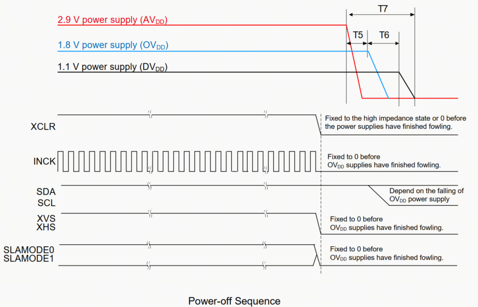

power_off
  1. power_off controls sensor power-down through X5 GPIO, following the spec power-on timing sequence.
  2. sensor_poweroff is typically called in sensor_deinit, only XCLR needs to be controlled. The following is the imx415 power_off implementation:

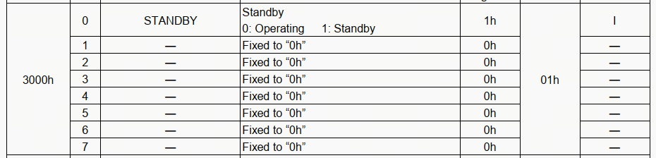

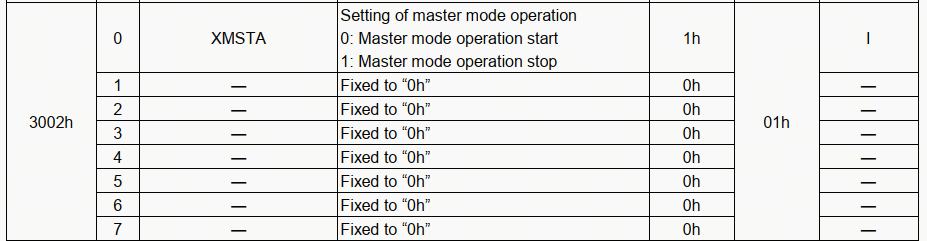

start
  1. start implements sending stream-on registers 0x3000 as 0x00, 0x3002 as 0x00, to enable sensor streaming.
  2. sensor_start is called when the upper layer calls hbn_vflow_start.
  3. HDR mode and Linear mode use the same stream_on registers.

  1. stop implements sending stream-off registers 0x3000 as 0x01, 0x3002 as 0x01, to disable sensor streaming.
  2. sensor_stop is called when the upper layer calls hbn_vflow_stop.
  3. HDR mode and Linear mode use the same stream_off registers.

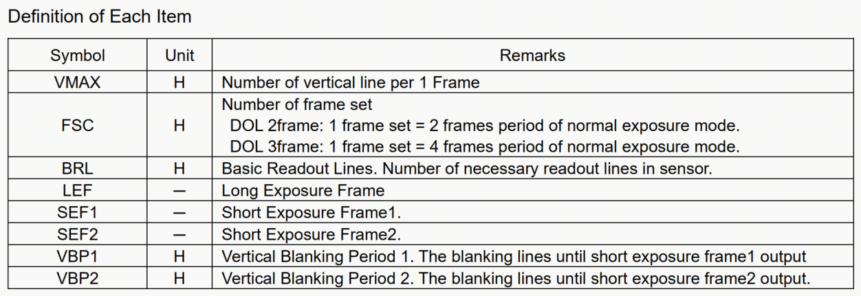

Below are some HDR terminology definitions for imx415:

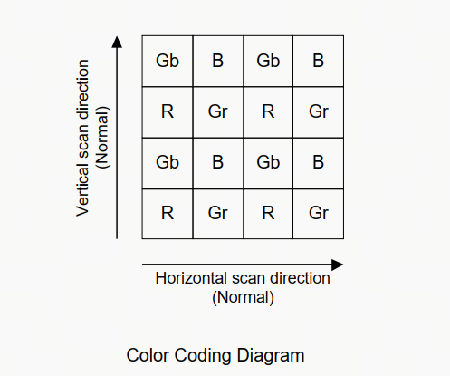

Below is the description of bayer_pattern and bayer_start:
../../_images/screenshot-20260422-221051.png

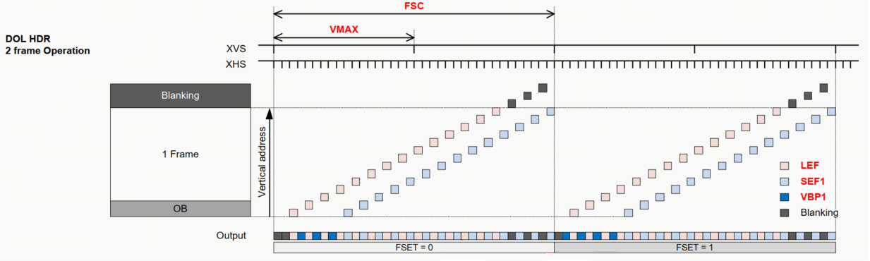

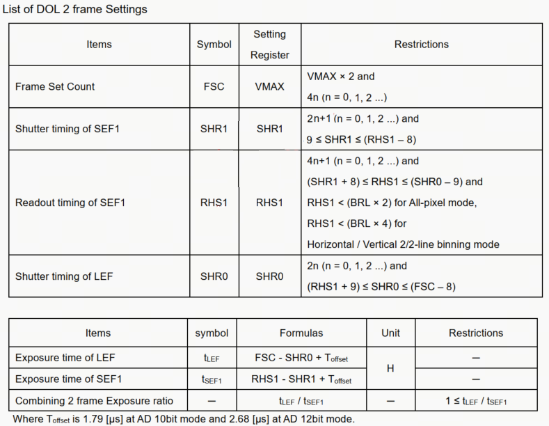

In DOL2 mode, IMX415 needs to alternately output LEF (Long Exposure Frame) and SEF1 (Short Exposure Frame) data within one frame set period. The time occupied is VMAX x 2. ../../_images/screenshot-20260422-163831.png
../../_images/screenshot-20260422-162608.png
In imx415_dol2_data_init, populate the tuning parameters:
  • Need to read VMAX (0x3024-0x3026) and RHS1 (0x3060-0x3062) from the sensor, calculate FSC = VMAX x 2;
  • exposure_time_long_max / exposure_time_max are calculated according to the DOL2 formula in the SPEC;
  • gain_lut uses turning_data.dol2.again_lut
  • Set turning_type = 6.
DOL2 exposure time formula from the figure above:
After consulting the sensor FAE, Toffset can be negligible, therefore:
LEF exposure lines:  t_LEF  = FSC  - SHR0,  FSC = VMAX x 2
SEF1 exposure lines: t_SEF1 = RHS1 - SHR1
Key parameter configuration:
  • lines_per_second = FSC * sensor_info->fps (FSC = VMAX x 2)
  • exposure_time_long_max = FSC - (RHS1 + 9) LEF maximum exposure lines
  • exposure_time_max = RHS1 - 9 SEF1 maximum exposure lines
  • exposure_time_min = 8
  • analog_gain_max = 255 consistent with the maximum gain_lut index
  • digital_gain_max = 0
  • sensor_data_bayer_fill(..., 10, BAYER_START_GB, BAYER_PATTERN_RGGB); sensor_data_bits_fill(..., 12)

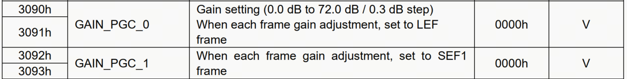

aexp_gain_control
In DOL2 mode, LEF and SEF1 gain need to be controlled separately:
  • again[0] -> LEF gain, written to GAIN_PGC0 (0x3090)
  • again[1] -> SEF1 gain, written to GAIN_PGC1 (0x3092)

                if (again[0] >= sizeof(imx415_gain_lut)/sizeof(uint32_t))
                        again_index = sizeof(imx415_gain_lut)/sizeof(uint32_t) - 1;
                else
                        again_index = again[0];
                if (again[1] >= sizeof(imx415_gain_lut)/sizeof(uint32_t))
                        s_again_index = sizeof(imx415_gain_lut)/sizeof(uint32_t) - 1;
                else
                        s_again_index = again[1];
                again_reg_value = (imx415_gain_lut[again_index] >> 0) & 0xFF;
                s_again_reg_value = (imx415_gain_lut[s_again_index] >> 0) & 0xFF;
                set_gain_registers(info, AGAIN, again_reg_value);
                set_gain_registers(info, S_AGAIN, s_again_reg_value);

aexp_line_control
aexp_line_control in DOL2 mode needs to set both LEF and SEF1 exposure simultaneously, mainly responsible for:
  1. Receiving exposure line counts from the ISP 3A algorithm: line[0] (LEF), line[1] (SEF1)
  2. Converting exposure line counts to SHR0 and SHR1 register values
  3. Performing boundary checks and odd/even alignment
  4. Sending to sensor via i2c
DOL2 Exposure Formula:
SHR0 = FSC  - line[0]     (LEF,  FSC = VMAX x 2)
SHR1 = RHS1 - line[1]     (SEF1)
Constraints: SHR0 is even (2n),    (RHS1 + 9) <= SHR0 <= (FSC - 8)
             SHR1 is odd (2n+1),   9 <= SHR1 <= (RHS1 - 8)
Linear Mode Exposure Formula:
SHR0 = VMAX - line[0]
Constraints: 8 <= SHR0 <= (VMAX - 4)

        } else if (mode == DOL2_M) {
                uint32_t rhs1 = 0, fsc = 0;
                int shr0 = 0, shr1 = 0;
                val_l = hb_vin_i2c_read_reg16_data8(info->bus_num, info->sensor_addr, IMX415_RHS1);
                val_m = hb_vin_i2c_read_reg16_data8(info->bus_num, info->sensor_addr, IMX415_RHS1 + 1);
                val_h = hb_vin_i2c_read_reg16_data8(info->bus_num, info->sensor_addr, IMX415_RHS1 + 2);
                rhs1 = ((val_h & 0x0F) << 16) | (val_m << 8) | val_l;
                fsc = Vmax * 2;
                shr0 = fsc - line[0];
                shr1 = rhs1 - line[1];
                if (shr1 < 9)              shr1 = 9;
                if (shr1 > (int)(rhs1 - 8)) shr1 = rhs1 - 8;
                if (shr0 < (int)(rhs1 + 9)) shr0 = rhs1 + 9;
                if (shr0 > (int)(fsc - 8))   shr0 = fsc - 8;
                shr1 |= 0x01;               // Force SHR1 to odd (2n+1)
                shr0 = (shr0 >> 1) << 1;    // Force SHR0 to even (2n)
