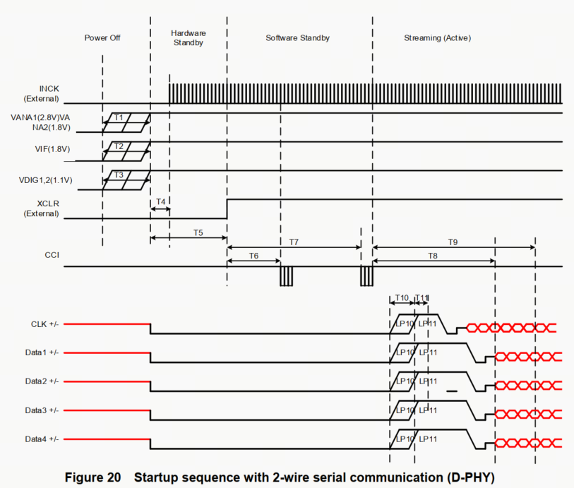

power_on
  1. power_on controls sensor power-on via X5 GPIO, following the spec power-up timing.
  2. sensor_poweron is typically called in sensor_init and only needs to control XCLR. Below is the power_on implementation for imx586:
../../_images/screenshot-20260210-154827.png
static int sensor_poweron(sensor_info_t *sensor_info)
        int gpio, ret = RET_OK;
                                usleep(100 * 1000);  // 100ms
                                if(ret < 0) {
        return ret;

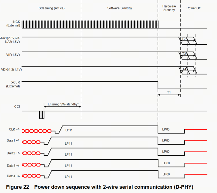

power_off
  1. power_off controls sensor power-off via X5 GPIO, following the spec power-down timing.
  2. sensor_poweroff is typically called in sensor_deinit and only needs to control XCLR. Below is the power_off implementation for imx586:
../../_images/screenshot-20260210-154309.png
static int sensor_poweroff(sensor_info_t *sensor_info)
                                if(ret < 0) {
                                        return -HB_CAM_SENSOR_POWEROFF_FAIL;
        return ret;

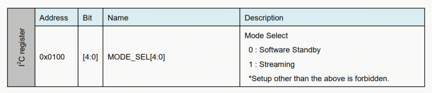

start
  1. start implements sending the stream-on register 0x0100 as 0x01 to make the sensor start streaming.
  2. sensor_start is called when the upper layer calls hbn_vflow_start.
../../_images/screenshot-20260210-204256.png
static int sensor_start(sensor_info_t *sensor_info)
        int ret = RET_OK;
        int setting_size = 0;
        setting_size = sizeof(imx586_stream_on_setting)/sizeof(uint32_t)/2;
        vin_info("%s start normal/linear mode\n", sensor_info->sensor_name);
        ret = vin_write_array(sensor_info->bus_num, sensor_info->sensor_addr, REG_WIDTH,
                setting_size, imx586_stream_on_setting);
        if(ret < 0) {
                vin_err("start %s fail\n", sensor_info->sensor_name);
                return -HB_CAM_I2C_WRITE_FAIL;
        return ret;
stop
  1. stop implements sending the stream-off register 0x0100 as 0x00 to make the sensor stop streaming.
  2. sensor_stop is called when the upper layer calls hbn_vflow_stop

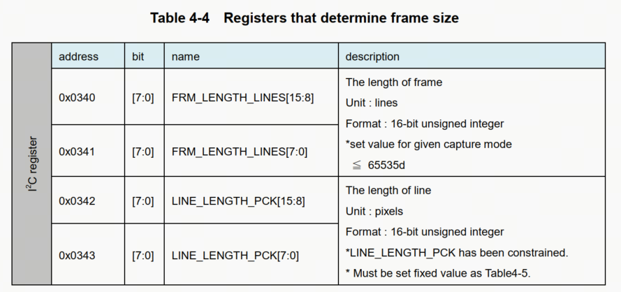

In imx586_linear_data_init, populate the tuning parameters:
  • Read VTS from sensor (registers 0x0340/0x0341), calculate lines_per_second;

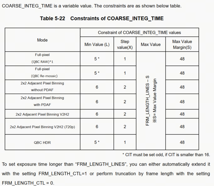

  • exposure_time_max = vts - 48 Documentation specifies FRM_LENGTH_LINES - 48, i.e., VTS - 48
  • analog_gain_max = 160 consistent with gain_lut maximum index, 32x corresponds to 160, refer to Gain index and gain ratio lookup table
  • digital_gain_max = 0 dgain unused, configure 0; if used, refer to analog_gain_max
  • exposure_time_min = 1

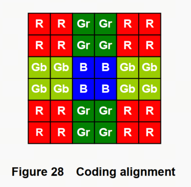

  • sensor_data_bayer_fill(..., 10, BAYER_START_R, BAYER_PATTERN_RGGB); sensor_data_bits_fill(..., 12), BAYER_START at position 0,0 is BAYER_START_R, BAYER_PATTERN is RGGB, raw10 format. sensor_data_bits_fill is only used for PWL mode; configure 12 here

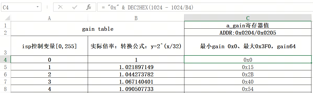

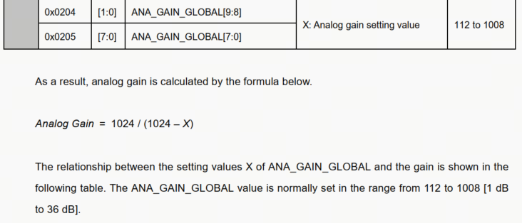

For Sony sensors, gain control generally uses a linear formula. Taking imx586 as an example, you need to derive the register value calculation formula based on the gain ratio. The specific method is as follows:
Reference documentation and gain_table.xlsx:
../../_images/screenshot-20260116-110906.png
../../_images/screenshot-20260116-103726.png
Formula parsing:
"0x" & DEC2HEX(1024 - 1024/B4, 0)
The IMX586 analog gain formula is: Analog Gain = 1024 / (1024 - X)
Where: Analog Gain is the gain ratio (e.g., 2.0x, 4.0x, etc.) X is the value to write to the register (range 112-1008)
Derivation process:
=> 1024 - X = 1024 / Analog Gain
=> X = 1024 - 1024 / Analog Gain
        const uint16_t AGAIN_H = 0x0204;
        const uint16_t AGAIN_L = 0x0205;
        char again_reg_value_h = 0, again_reg_value_l = 0;
        int gain_index = 0;
        if (mode == NORMAL_M) {
                if (again[0] >= sizeof(imx586_gain_lut)/sizeof(uint32_t))
                        gain_index = sizeof(imx586_gain_lut)/sizeof(uint32_t) - 1;
                else
                        gain_index = again[0];
                again_reg_value_h = (imx586_gain_lut[gain_index] >> 8) & 0xFF;
                again_reg_value_l = (imx586_gain_lut[gain_index]) & 0xFF;
                vin_i2c_write8(info->bus_num, 16, info->sensor_addr, AGAIN_H, again_reg_value_h);
                vin_i2c_write8(info->bus_num, 16, info->sensor_addr, AGAIN_L, again_reg_value_l);
        } else {
        return 0;

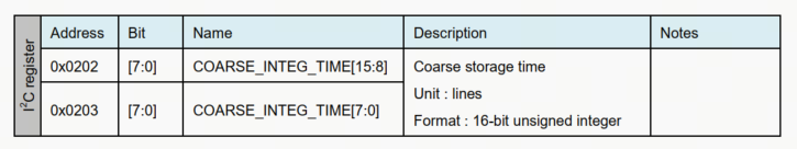

aexp_line_control
The aexp_line_control function primarily implements exposure control, responsible for:
  1. Receiving the exposure line count calculated by the ISP 3A algorithm
  2. Converting the exposure line count to sensor register values
  3. Configuring and sending exposure registers to the sensor via I2C
  4. The exposure registers here are 0x0202, 0x0203.
../../_images/screenshot-20260210-202303.png
        const uint16_t EXP_LINE0 = 0x0202;
        const uint16_t EXP_LINE1 = 0x0203;
        char temp0 = 0, temp1 = 0;
                uint32_t sline = line[0];
                if (sline > 3063) sline = 3063;
                if (sline < 8) sline = 8;
                temp0 = (sline >> 8) & 0xFF;
                vin_i2c_write8(info->bus_num, 16, info->sensor_addr, EXP_LINE0, temp0);
                temp1 = (sline) & 0xFF;
                vin_i2c_write8(info->bus_num, 16, info->sensor_addr, EXP_LINE1, temp1);
        } else {
        return 0;

  • HTS/VTS can be read from registers 0x342/0x343 and 0x340/0x341, or obtained from the sensor FAE, or measured with an oscilloscope. For measurement methods, refer to MIPI parameter determination
