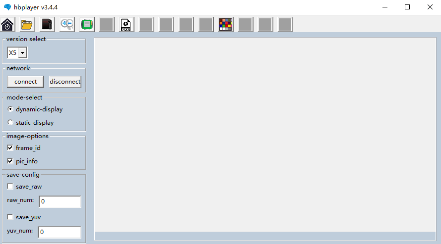

5.17.11.1. hbplayer
hbplayer is a Windows application that sends requests to the host via the HTTP protocol and retrieves image data transmitted from the board. The main functions of this application include:
  • Real-time display of image data
  • Offline display and analysis of image data
hbplayer_main
hbplayer Installation and Configuration

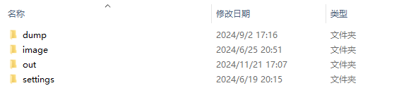

  1. Obtain the x5_hbplayer_v3.4.4.zip package from the software_tools/hobotplayer directory in the SDK delivery package. After decompression, the directory structure is shown in the figure below.
  2. Enter the decompressed path and double-click to run hbplayer.exe under the out directory to open the main page, as shown below:
dir_list

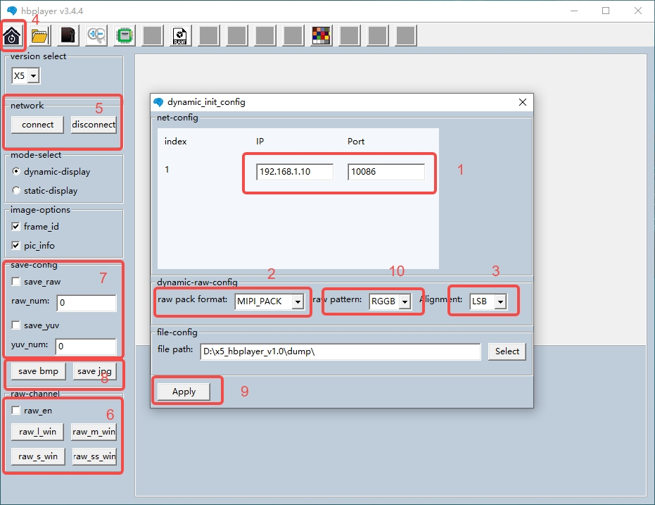

Network Configuration:
  1. Click the icon in the upper-left corner and enter the board’s IP address in the dynamic_init_config dialog box. The board’s IP can be configured and queried by executing ifconfig on the board side. Check the board’s IP address and fill it into the dynamic_init_config input box.
  2. Click Apply to complete the client IP configuration.
hbplayer Main Interface
hbplayer_main2
No. Description Remarks
1 Device IP and port number The port number is generally not modified
2 Set pack mode for raw in online mode NA
3 Configure raw image msb/lsb type msb means alignment to the most significant bit, lsb means alignment to the least significant bit
4 Open configuration page NA
5 Connect / Disconnect network transmission In dynamic-displayer mode, connect to the server on the board side.
6 View raw images, up to dol4 supported Available when transmitting RAW
7 Save raw/yuv image information First set the number to save, then click enable
8 Save yuv image information as bmp/jpg This option supports saving single images; format conversion uses opencv
9 Save configuration information Configuration information must be saved to take effect
10 raw_type type Supports different pattern rggb formats

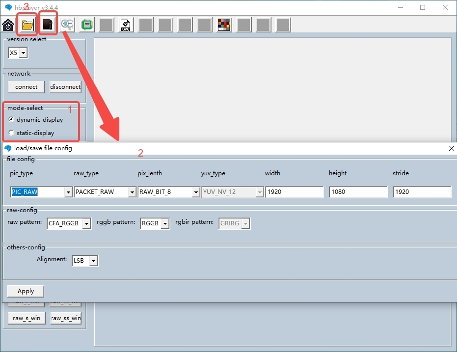

hbplayer Static Image Viewing Function Description
The hbplayer tool supports viewing static images in multiple formats (raw/yuv/bmp/jpg) and provides convenient parameter configuration and operation functions. Below are the operation steps and precautions:
Operation Steps (as shown in the figure below):
  1. Select Functional Module Click icon 1 (static-display) to enter the static image viewing interface.
  2. Configure Image Parameters Click icon 2 (fileconfig) to perform parameter configuration. Fill in the specific parameters of the image (e.g., resolution, format, etc.) as needed, then click Apply to save the configuration.
  3. Select and Display Image Click icon 3, select the image file to view, and the image will be displayed in the interface.
  4. Image Zoom When viewing the image, press Ctrl + mouse wheel to zoom in or out.
Configuration Options Description:
For detailed descriptions of configuration options, refer to the table below to ensure correct parameter input for optimal viewing results.
Precautions:
  • Viewing raw/yuv Images When opening raw or yuv format images, it is necessary to correctly configure the specific image parameters (such as width, height, pixel format, etc.). Incorrect parameters will result in the image failing to open properly or displaying abnormally.
  • raw preview and save_raw Functions To use the raw preview or save_raw functions, ensure the following conditions:
    • tuning_tool has sent raw data.
    • Enable the raw_en function on the hbplayer tool side.
hbplayer_static_config
1 Switch between static image display / dynamic transmission display Static images are supported in static-display mode; data streams are supported in dynamic-display mode.
2 Configure image information to open Only items selectable in the box are supported; incorrect image information will cause abnormal display.
3 Display image size information Open the file to be displayed
To view static parameters, corresponding image parameters must be configured. The image parameter configuration description is shown in the table below.
pic_type This field sets the type of image to be opened
raw_type This field sets whether the raw image is pack or unpack type. Unpack stores one pixel as a uint16_t data type.
yuv_type yuv_nv12
width Image width
height Image height
stride Used for pic_raw, mainly for cases where several nop characters are padded at the end of each row in pic_raw.

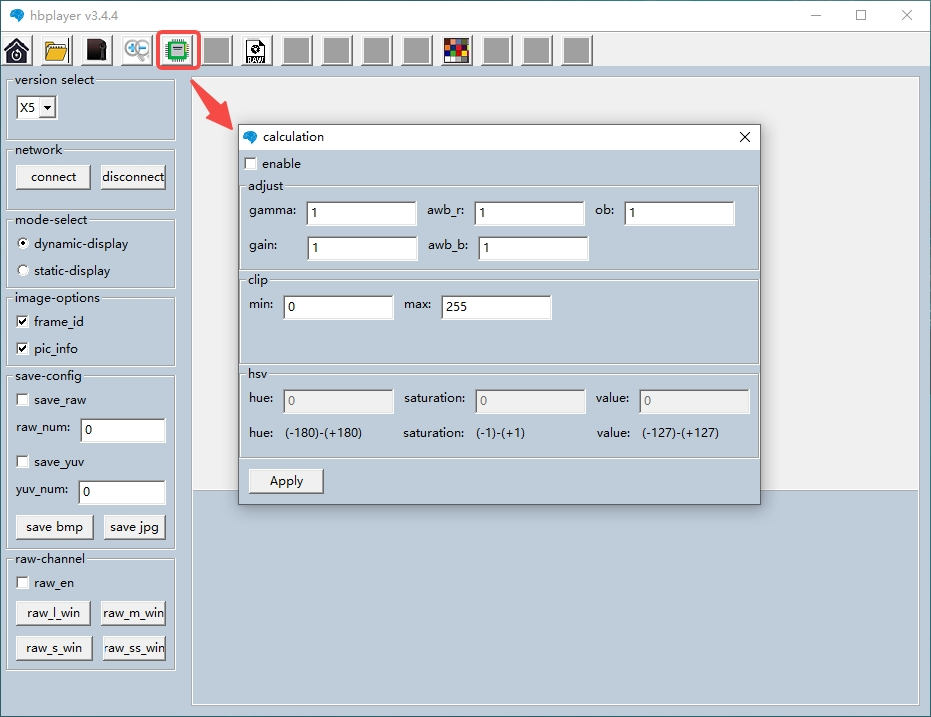

hbplayer supports simple image display adjustment functions when viewing static images. Click the icon to open calculation display and input corresponding parameters, then click enable to perform simple adjustments on the image.
hbplayer_cal
Tips:
  • Image zooming can be achieved using the mouse wheel or the zoom window. It is recommended not to exceed 10x magnification, otherwise image scaling processing may become slow.

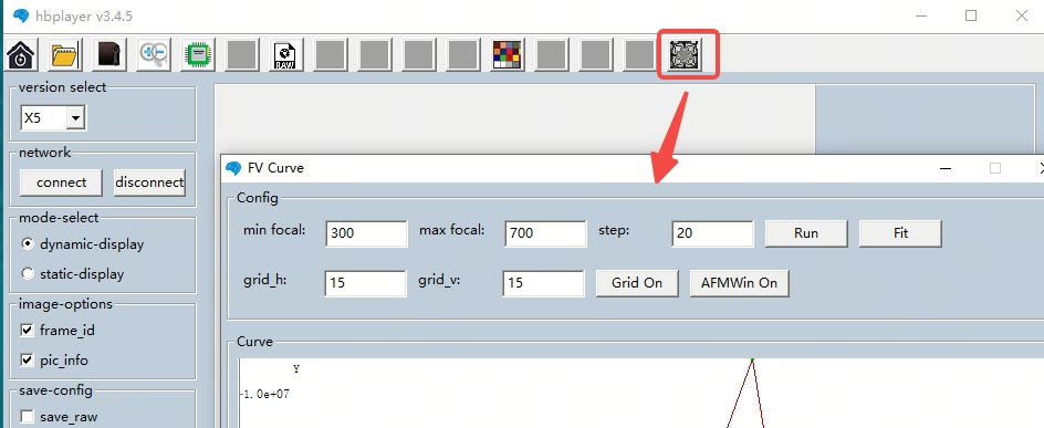

hbplayer FV Curve Function
This function is used to obtain the FV value within the motor position and draw the FV-pos curve. It needs to be used together with the tuning tool.
min focal and max focal correspond to the minimum and maximum values of the motor respectively. step is the sampling interval between min focal and max focal. After configuration, click the Run button to display the FV curve within the corresponding range. The Fit button is for fitting the curve to the window display; each click will fit the curve to the window.
grid_h and grid_v correspond to the number of horizontal and vertical grids respectively. After configuration, click the grid_on button to display the grid on the main interface, which can be used with the AFMV3 function.
The AFMWin ON button corresponds to the AFMV1 window. Click it to display the window position on the image in the main interface.
hbplayer_fv

    1. Connect to X5 hbplayer. By default, tuning_tool sends yuv data to hbplayer. After starting the stream, go to hbplayer and click connect to preview the image in real time. To exit, press 【q】 then Enter.
    dir_list
