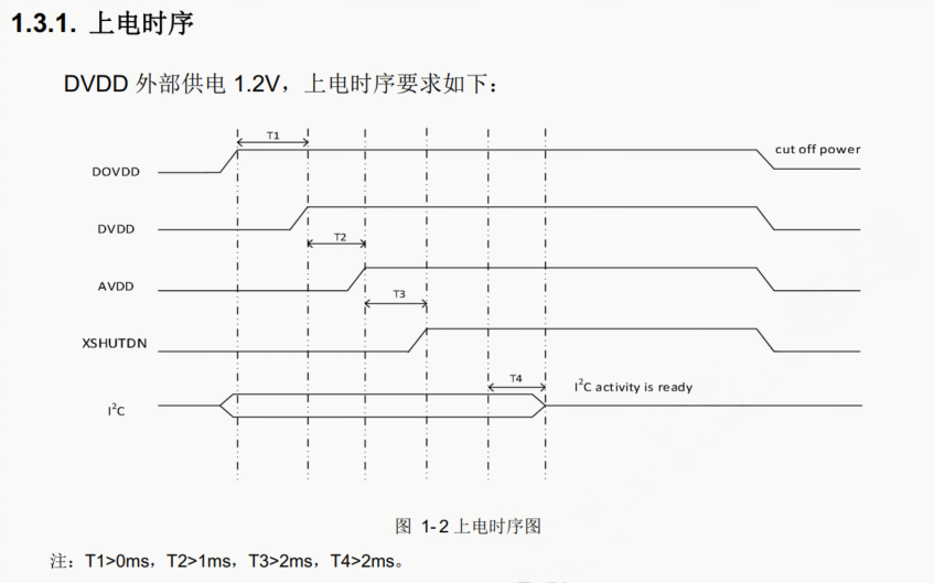

power_on
  1. power_on controls sensor power-on via X5 GPIO, following the spec power-up timing.
  2. sensor_poweron is typically called in sensor_init and only needs to control XSHUTDN. Below is the power_on implementation for sc132gs:
../../_images/screenshot-20260210-145501.png
int sensor_poweron(sensor_info_t *sensor_info)
        int gpio, ret = RET_OK;
                                usleep(1 * 100 * 1000);  // 100ms
                                if(ret < 0) {
                                usleep(100 * 1000);  // 100ms
        return ret;
power_off
  1. power_off controls sensor power-off via X5 GPIO, following the spec power-down timing.
  2. sensor_poweroff is typically called in sensor_deinit and only needs to control XSHUTDN. Below is the power_off implementation for sc132gs:
int sensor_poweroff(sensor_info_t *sensor_info)
                                if(ret < 0) {
                                        return -1;
        return ret;

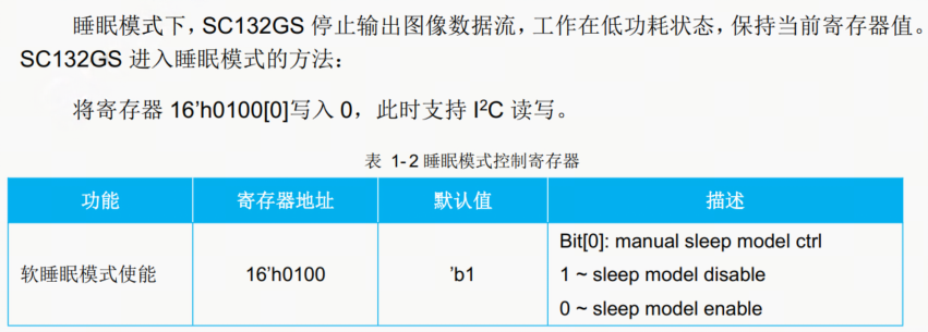

start
  1. start implements sending the stream-on register 0x0100 as 0x01 to make the sensor start streaming.
  2. sensor_start is called when the upper layer calls hbn_vflow_start.
../../_images/screenshot-20260210-204357.png
int sensor_start(sensor_info_t *sensor_info)
        int ret = RET_OK;
        int setting_size = 0;
        switch(sensor_info->sensor_mode) {
        case NORMAL_M:
        case SLAVE_M:
                setting_size = sizeof(sc132gs_stream_on_setting)/sizeof(uint32_t)/2;
                vin_info(" start linear mode, sensor_name %s, setting_size = %d\n", sensor_info->sensor_name, setting_size);
                                setting_size, sc132gs_stream_on_setting);
                if(ret < 0) {
                        vin_err("start %s fail\n", sensor_info->sensor_name);
                        return ret;
                break;
        return ret;
stop
  1. stop implements sending the stream-off register 0x0100 as 0x00 to make the sensor stop streaming.
  2. sensor_stop is called when the upper layer calls hbn_vflow_stop

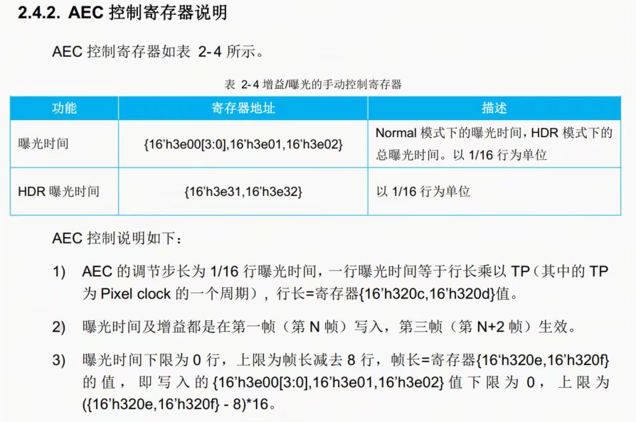

  • Read VTS from sensor (registers 0x320e/0x320f), calculate lines_per_second;
  • exposure_time_max/min, analog_gain_max, digital_gain_max;
  • Populate bayer (sensor_data_bayer_fill, sensor_data_bits_fill);
  • Set stream_ctrl; copy again_lut from sc132gs_setting.h (sc132gs_gain_lut) to turning_data.normal.again_lut, then submit via ioctl.
Key parameter configuration:
  • exposure_time_max = vts - 8 Documentation specifies FRM_LENGTH_LINES - 8, i.e., VTS - 8
  • analog_gain_max = 156 consistent with gain_lut maximum index, 29.34x corresponds to 156, refer to Gain index and gain ratio lookup table
  • digital_gain_max = 159 consistent with gain_lut maximum index, 31.3x corresponds to 159, refer to Gain index and gain ratio lookup table
  • exposure_time_min = 1 Default minimum configuration is 1; no restriction in spec

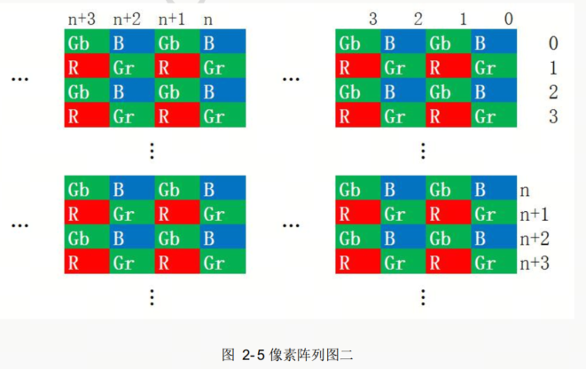

  • sensor_data_bayer_fill(..., 10, BAYER_START_B, BAYER_PATTERN_RGGB); sensor_data_bits_fill(..., 12), BAYER_START at position 0,0 is BAYER_START_B, BAYER_PATTERN is RGGB, raw10 format. sensor_data_bits_fill is only used for PWL mode; configure 12 here

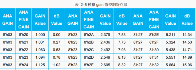

aexp_gain_control
  • For SmartSens sensors, gain control generally uses discrete steps + fine adjustment. Lookup tables are typically the fastest approach; fill in again_lut and dgain_lut directly from the table (no need to use gain_table.xlsx), which is convenient and efficient.
  • SmartSens uses again + dgain dual LUT, with registers AGAIN 0x3e08/0x3e09 and DGAIN 0x3e06/0x3e07. Look up the table based on the again[0]/dgain[0] index from the ISP.
Reference documentation:
../../_images/screenshot-20260116-103909.png
        const uint16_t AGAIN_LOW = 0x3e08;
        const uint16_t AGAIN_HIGH = 0x3e09;
        const uint16_t DGAIN_LOW = 0x3e06;
        const uint16_t DGAIN_HIGH = 0x3e07;
        char ana_gain = 0, ana_fine_gain = 0;
        char dig_gain = 0, dig_fine_gain = 0;
        int again_index = 0, dgain_index = 0;
        if (mode == NORMAL_M || mode == DOL2_M) {
                if (again[0] >= sizeof(sc132gs_gain_lut)/sizeof(uint32_t))
                        again_index = sizeof(sc132gs_gain_lut)/sizeof(uint32_t) - 1;
                else
                        again_index = again[0];
                if (dgain[0] >= sizeof(sc132gs_dgain_lut)/sizeof(uint32_t))
                        dgain_index = sizeof(sc132gs_dgain_lut)/sizeof(uint32_t) - 1;
                else
                        dgain_index = dgain[0];
                ana_gain = (sc132gs_gain_lut[again_index] >> 8) & 0xFF;
                ana_fine_gain = sc132gs_gain_lut[again_index] & 0xFF;
                dig_gain = (sc132gs_dgain_lut[dgain_index] >> 8) & 0xFF;
                dig_fine_gain = sc132gs_dgain_lut[dgain_index] & 0xFF;
                vin_i2c_write8(info->bus_num, 16, info->sensor_addr, AGAIN_LOW, ana_gain);
                vin_i2c_write8(info->bus_num, 16, info->sensor_addr, AGAIN_HIGH, ana_fine_gain);
                vin_i2c_write8(info->bus_num, 16, info->sensor_addr, DGAIN_LOW, dig_gain);
                vin_i2c_write8(info->bus_num, 16, info->sensor_addr, DGAIN_HIGH, dig_fine_gain);
                if (mode == DOL2_M) {
                        vin_i2c_write8(info->bus_num, 16, info->sensor_addr, 0x3e12, ana_gain);
                        vin_i2c_write8(info->bus_num, 16, info->sensor_addr, 0x3e13, ana_fine_gain);
                        vin_i2c_write8(info->bus_num, 16, info->sensor_addr, 0x3e10, dig_gain);
                        vin_i2c_write8(info->bus_num, 16, info->sensor_addr, 0x3e11, dig_fine_gain);
        } else {
        return 0;
aexp_line_control
The aexp_line_control function primarily implements exposure control, responsible for:
  1. Receiving the exposure line count calculated by the ISP 3A algorithm
  2. Converting the exposure line count to sensor register values
  3. Configuring and sending exposure registers to the sensor via I2C
  4. The exposure registers here are 0x3e00, 0x3e01, 0x3e02.
static int sc132gs_ae_set(uint32_t bus, uint32_t addr, uint32_t line)
        const uint16_t EXP_LINE0 = 0x3e00;
        const uint16_t EXP_LINE1 = 0x3e01;
        const uint16_t EXP_LINE2 = 0x3e02;
        uint32_t sline = line;
        if (sline >= 2560) sline = 2560;
        temp0 = (sline & 0xF000) >> 12;
        temp1 = (sline & 0x0FF0) >> 4;
        temp2 = (sline & 0x000F) << 4;
        vin_i2c_write8(bus, 16, addr, EXP_LINE0, temp0);
        vin_i2c_write8(bus, 16, addr, EXP_LINE1, temp1);
        vin_i2c_write8(bus, 16, addr, EXP_LINE2, temp2);
        return 0;
        uint32_t val;
        if (mode == NORMAL_M) {
                val = line[0];
                sc132gs_ae_set(info->bus_num, info->sensor_addr, val);
        } else {
        return 0;
