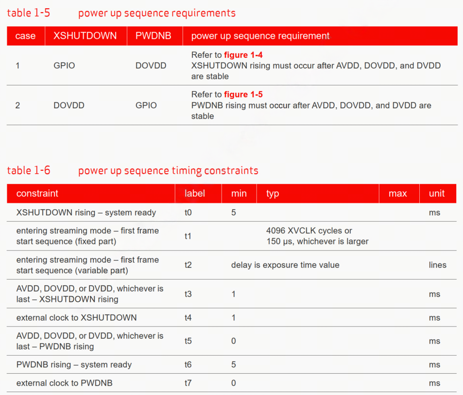

power_on
  1. power_on controls sensor power-on via X5 GPIO, following the spec power-up timing.
  2. sensor_poweron is typically called in sensor_init and only needs to control XSHUTDOWN. Below is the power_on implementation for os08c10:

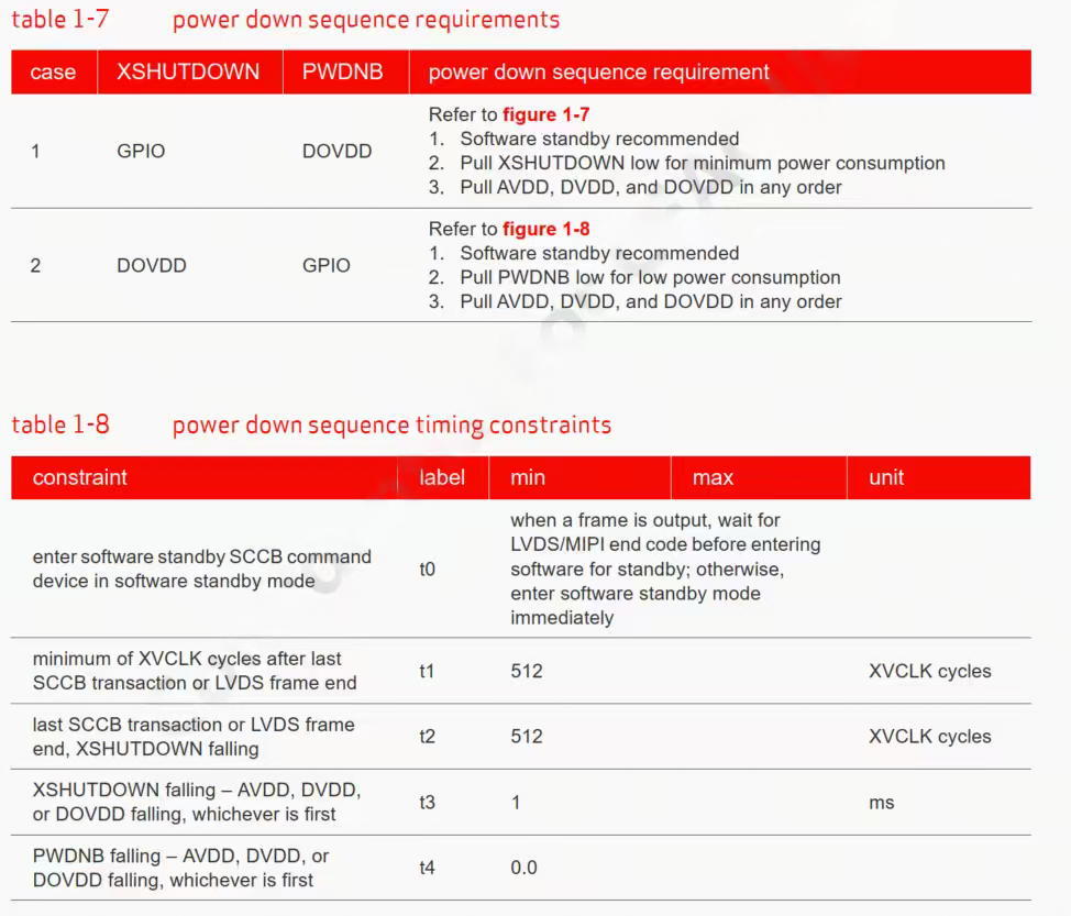

power_off
  1. power_off controls sensor power-off via X5 GPIO, following the spec power-down timing.
  2. sensor_poweroff is typically called in sensor_deinit and only needs to control XSHUTDOWN. Below is the power_off implementation for os08c10:

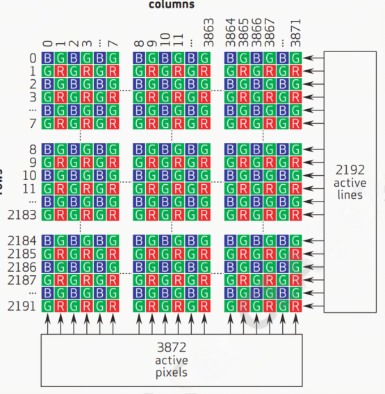

  • Read VTS from sensor (registers 0x380e/0x380f), calculate lines_per_second;
  • exposure_time_max/min, analog_gain_max, digital_gain_max;
  • Populate bayer (sensor_data_bayer_fill, sensor_data_bits_fill);

  • sensor_data_bayer_fill(..., 12, BAYER_START_B, BAYER_PATTERN_RGGB); sensor_data_bits_fill(..., 12), BAYER_START at position 0,0 is BAYER_START_B, BAYER_PATTERN is RGGB, raw12 format. sensor_data_bits_fill is only used for PWL mode; configure 12 here

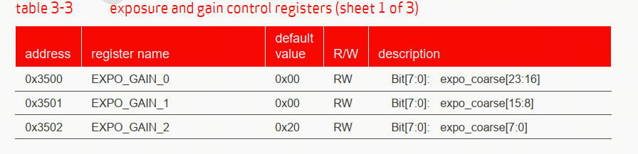

aexp_line_control
The aexp_line_control function primarily implements exposure control, responsible for:
  1. Receiving the exposure line count calculated by the ISP 3A algorithm
  2. Converting the exposure line count to sensor register values
  3. Configuring and sending exposure registers to the sensor via I2C
  4. The exposure registers here are 0x3500, 0x3501, 0x3502.

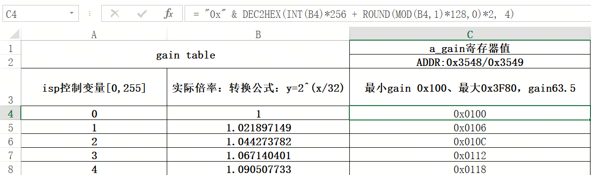

aexp_gain_control:
The aexp_gain_control function primarily implements gain control, responsible for:
  1. Receiving the gain index value calculated by the ISP 3A algorithm
  2. Looking up the gain_lut table to find the sensor register value based on the gain index
  3. Configuring and sending gain registers to the sensor via I2C
  4. gain_lut generally needs to be configured according to the spec.
For OmniVision sensors, gain control generally uses an integer + fractional linear combination. Taking os08c10 as an example, you need to derive the register value calculation formula based on the gain ratio. The specific method is as follows:
Reference documentation and gain_table.xlsx:
../../_images/screenshot-20260116-103406.png
../../_images/screenshot-20260116-103426.png
../../_images/screenshot-20260116-103530.png
= "0x" & DEC2HEX(INT(B4)*256 + ROUND(MOD(B4,1)*128,0)*2, 4)
Formula explanation:
INT(B4): Get the integer part
MOD(B4,1): Get the fractional part (equivalent to B4-INT(B4))
*128: Convert to 1/128 units
ROUND(...,0): Round to integer
*2: Left shift by 1 bit (because it needs to be placed in the upper 7 bits)
*256: Shift integer part to high byte
DEC2HEX(...,4): Convert to 4-digit hexadecimal
