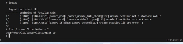

Sensor Sensor library check or load error Sensor library check or load error

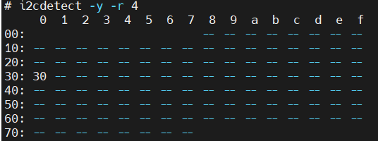

Use the i2cdetect command to detect the bus ID. If the sensor on the I2C bus can be detected, it indicates the sensor is properly connected, as shown below:

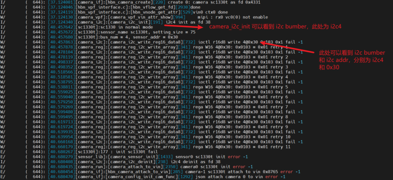

Through logcat, you can see sensor init error and I2C communication failure related logs:
../../_images/5-7-3-3.png

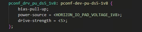

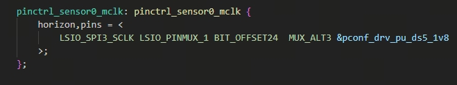

How to modify MCLK drive current

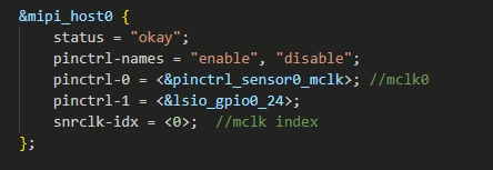

  • MCLK defaults to GPIO pin. When snrclk is enabled or a camera program is running, the MIPI driver will select the MCLK function pin via pinctrl.
    ../../_images/image_20260104-222310.png
  • To adjust MCLK drive current, modify the driver-strength of the corresponding MCLK pin.
    ../../_images/image_20260104-222322.png
    ../../_images/image_20260104-222335.png

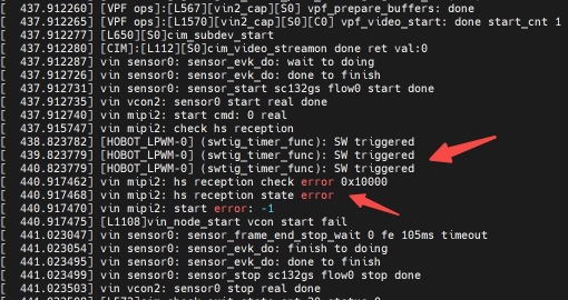

Unable to enter HS, MIPI start error
MIPI unable to enter HS mode may have several possible causes:
../../_images/5-7-3-4.jpg

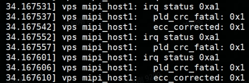

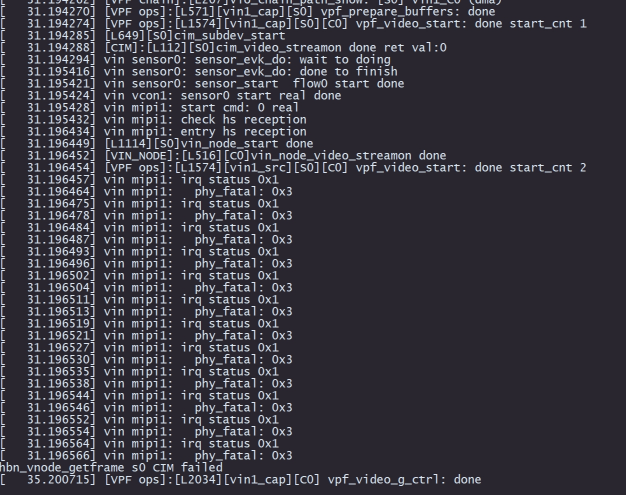

MIPI error
MIPI PHY Fatal Error
../../_images/5-7-3-5.png
MIPI PHY fatal error is a physical layer error, indicating transmission issues between the sensor and X5 MIPI PHY. Possible causes are as follows:
  1. MIPI clock configuration is incorrect, see MIPI parameter determination
  2. MIPI settle configuration is incorrect, see MIPI parameter determination

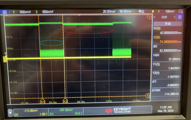

  2. Oscilloscope measurement:
    • If the sensor spec does not provide this information, actual measurement on the MIPI data pins is required. A typical oscilloscope measurement is shown below:
../../_images/5-7-3-8.png
  • Blue circle indicates valid signal: 32ms; red circle indicates blanking signal, duration: 68ms; total duration: 100ms
  • Image height is 1080, so transmitting 1080 pixels takes 32ms. Including blanking pixels, framelength can be calculated as:
  • framelength = 1080 * 100 / 32 = 3375

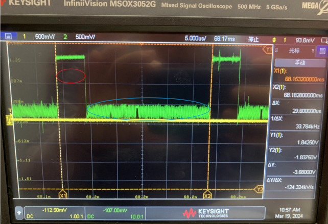

../../_images/5-7-3-9.png
  • Blue circle shows one line of valid data signal, duration: 24.2us; red circle shows blanking signal, duration: 5.4us; total duration: 24.2 + 5.4 = 29.6us
  • Image width is 1920, so transmitting 1920 pixels takes 24.2us. Including blanking pixels, linelength can be calculated as:
  • linelength = 1920 * 29.6 / 24.2 = 2348

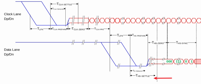

Settle
Definition:
  • Settle is a concept defined in the MIPI protocol. A brief introduction to the settle signal:
    ../../_images/5-7-3-10.png
  • When MIPI transitions from LP to HS state, a transient pulse may appear on the hardware signal
  • The MIPI receiver needs to delay for the settle time to avoid this pulse before enabling data reception
  • The SETTLE value consists of the prepare phase and part of the zero signal, as shown above

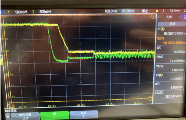

  • Use an oscilloscope to capture the transition from LP to HS on the MIPI data lane (both D+ and D- lanes must be measured simultaneously). Measure the settle duration from the waveform directly. A typical oscilloscope measurement is shown below:
    ../../_images/5-7-3-11.png
    • Blue circle: hs-prepare = 14ns
    • Red circle: hs-zero = 154ns
    • Unit Interval (UI) = 1s / (MIPI physical single-lane clock / 2) = 1s / (405M / 2) = 4.94 ns
    • min = prepare / UI = 14 / 4.94 = 3 UI
    • max = (prepare + zero) / UI = (154 + 14) / 4.94 = 34 UI
    • settle = (min + max) / 2 = 19 UI

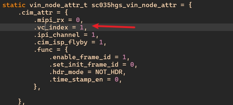

How to configure multiple VC sensor modules on the same HOST RX
Prerequisites:
  • The MIPI TX side (sensor module side) needs to send data through different virtual channels
  • For example: VC0 sends sensor0 data, VC1 sends sensor1 data
Configuration Steps:

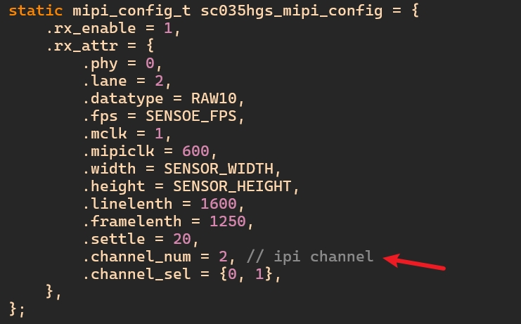

1. MIPI configuration of corresponding channel_num and channel_sel
../../_images/image_20260104-224622.png
2. VIN configuration of corresponding vc_index
../../_images/image_20260104-224638.png
3. Multi-VC output configuration:
  • If multiple VC outputs are needed, configure multiple pipelines
  • Each pipeline is configured with the corresponding vc_index separately
Sensor library check error indicates an issue with the sensor driver
../../_images/5-7-3-6.jpg
Possible Causes:
1. Compilation issue:
  • Sensor compiled incorrectly or not compiled properly before being pushed to the board for loading
2. Framework issue:
  • Compiled correctly but not written according to the HBN framework
  • The sensor driver must be written following the sensor driver file addition rules

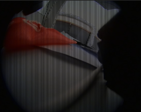

Dumped image has vertical stripe artifacts
The image exhibits regular black vertical stripes. The log and image are shown below:
../../_images/image_20260105-132939.png
../../_images/image_20260105-133227.png
Cause:
  1. The P/N of one DATA LANE group is reversed
  2. MIPI data is split by byte to each lane for transmission, then reassembled and parsed
  3. Any DATA LANE issue will result in a CRC error
  4. If only one LANE has reversed connections, the image will show regular vertical stripes (one abnormal byte value every few bytes)
Solution:
  • Check hardware connections and confirm that the DATA LANE P/N connections are correct

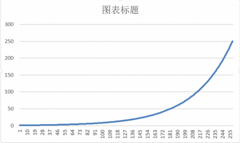

5.17.7.7. Gain index and gain ratio lookup table
  1. The ISP (Image Signal Processor) 3A (Auto Exposure/Auto White Balance/Auto Focus) algorithms need to control the sensor’s gain. However, ISP and sensor use different gain representations:
  2. ISP gain is expressed as a ratio (e.g., 1x, 2x, 4x, 255x), and converts the ratio to an index value of 0-255 that is passed to the sensor driver
The conversion formula is as follows: x = 32 * log2(gain)
Below is the lookup table for gain index and ISP gain ratio:
Index (x) Gain Ratio Index (x) Gain Ratio Index (x) Gain Ratio Index (x) Gain Ratio
0 1.000 64 4.000 128 16.000 192 64.000
1 1.022 65 4.088 129 16.350 193 65.401
2 1.044 66 4.177 130 16.708 194 66.834
3 1.067 67 4.269 131 17.074 195 68.297
4 1.091 68 4.362 132 17.448 196 69.792
5 1.114 69 4.458 133 17.830 197 71.321
6 1.139 70 4.555 134 18.221 198 72.882
7 1.164 71 4.655 135 18.620 199 74.478
8 1.189 72 4.757 136 19.027 200 76.109
9 1.215 73 4.861 137 19.444 201 77.776
10 1.242 74 4.967 138 19.870 202 79.479
11 1.269 75 5.076 139 20.305 203 81.219
12 1.297 76 5.187 140 20.749 204 82.998
13 1.325 77 5.301 141 21.204 205 84.815
14 1.354 78 5.417 142 21.668 206 86.672
15 1.384 79 5.536 143 22.143 207 88.570
16 1.414 80 5.657 144 22.627 208 90.510
17 1.445 81 5.781 145 23.123 209 92.492
18 1.477 82 5.907 146 23.629 210 94.517
19 1.509 83 6.037 147 24.147 211 96.587
20 1.542 84 6.169 148 24.675 212 98.701
21 1.576 85 6.304 149 25.216 213 100.863
22 1.610 86 6.442 150 25.768 214 103.071
23 1.646 87 6.583 151 26.332 215 105.328
24 1.682 88 6.727 152 26.909 216 107.635
25 1.719 89 6.874 153 27.498 217 109.992
26 1.756 90 7.025 154 28.100 218 112.400
27 1.795 91 7.179 155 28.715 219 114.861
28 1.834 92 7.336 156 29.344 220 117.377
29 1.874 93 7.497 157 29.987 221 119.947
30 1.915 94 7.661 158 30.643 222 122.573
31 1.957 95 7.829 159 31.314 223 125.257
32 2.000 96 8.000 160 32.000 224 128.000
33 2.044 97 8.175 161 32.701 225 130.803
34 2.089 98 8.354 162 33.417 226 133.667
35 2.134 99 8.537 163 34.148 227 136.594
36 2.181 100 8.724 164 34.896 228 139.585
37 2.229 101 8.915 165 35.660 229 142.642
38 2.278 102 9.110 166 36.441 230 145.765
39 2.327 103 9.310 167 37.239 231 148.957
40 2.378 104 9.514 168 38.055 232 152.219
41 2.430 105 9.722 169 38.888 233 155.552
42 2.484 106 9.935 170 39.739 234 158.958
43 2.538 107 10.152 171 40.610 235 162.439
44 2.594 108 10.375 172 41.499 236 165.995
45 2.650 109 10.602 173 42.408 237 169.630
46 2.709 110 10.834 174 43.336 238 173.345
47 2.768 111 11.071 175 44.285 239 177.140
48 2.828 112 11.314 176 45.255 240 181.019
49 2.890 113 11.561 177 46.246 241 184.983
50 2.954 114 11.815 178 47.258 242 189.034
51 3.018 115 12.073 179 48.293 243 193.173
52 3.084 116 12.338 180 49.351 244 197.403
53 3.152 117 12.608 181 50.431 245 201.726
54 3.221 118 12.884 182 51.536 246 206.143
55 3.292 119 13.166 183 52.664 247 210.657
56 3.364 120 13.454 184 53.817 248 215.269
57 3.437 121 13.749 185 54.996 249 219.983
58 3.513 122 14.050 186 56.200 250 224.800
59 3.589 123 14.358 187 57.431 251 229.723
60 3.668 124 14.672 188 58.688 252 234.753
61 3.748 125 14.993 189 59.973 253 239.893
62 3.830 126 15.322 190 61.287 254 245.146
63 3.914 127 15.657 191 62.629 255 250.514
../../_images/image_16431638886864.png

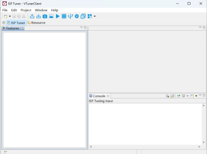

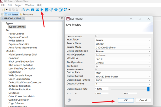

  1. Open the tuning tool “VTunerClient” on the PC
../../_images/5-7-3-12.png

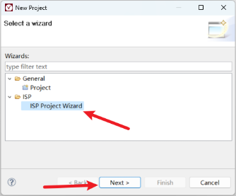

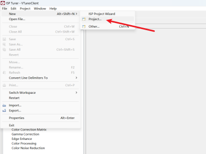

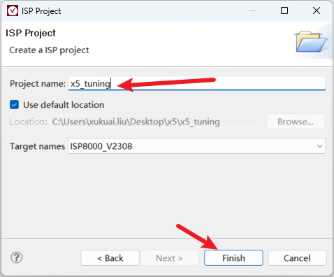

  1. Create a new project
../../_images/5-7-3-13.png
../../_images/5-7-3-14.png
../../_images/5-7-3-15.png

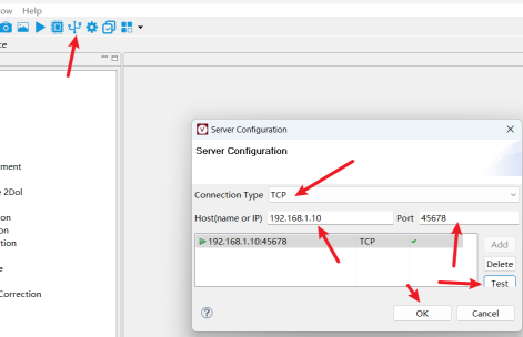

  1. Connect to the board via TCP
../../_images/5-7-3-16.png
Note: The IP address and port number are fixed. Enter them exactly as shown in the screenshot. Click the Test button; a green checkmark appearing after TCP indicates a successful connection. Then click the OK button.
  1. Connect the project
../../_images/5-7-3-17.png
This is simply connecting to the tuning tool. You may select any sensor name here. For actual tuning, create a new sensor option in your project based on the isp_sensor.json file in the project folder. After completing the above steps, the connection is established, and ISP tuning engineers can begin adjusting sensor performance.

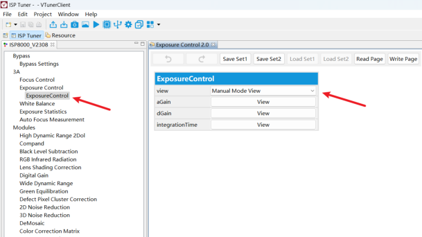

  2. Switch AE mode to Manual for observation and control of the adjustment process.

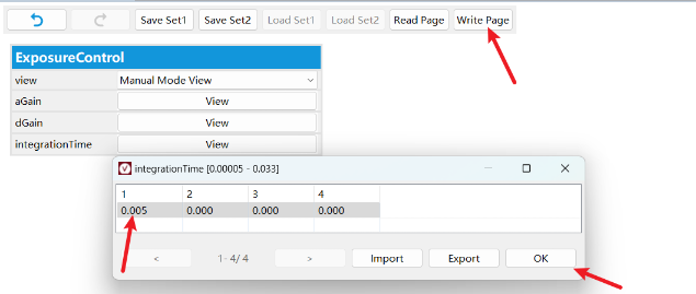

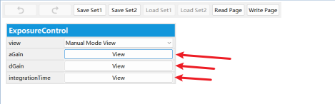

../../_images/5-7-3-18.png

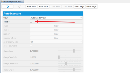

If the Manual Mode View UI appears grayed out, first enter Auto Mode View, click the Disable button, then switch to Manual Mode View:
../../_images/5-7-3-19.png ../../_images/5-7-3-20.png
Set aGain, dGain, and integrationTime values manually for verification. For example, set exposure time to 5ms (remember to click Write Page):
../../_images/5-7-3-21.png
Then verify through sensor driver logging (you need to add logging yourself) or use the i2ctransfer tool to check sensor register values, confirming that the register values written to the sensor comply with the spec requirements.
