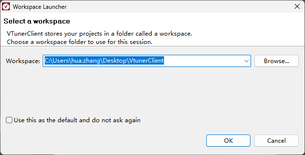

Launching the VTunerClient Workspace
Prerequisites
Ensure VTunerClient has been installed according to the instructions in Installing VTunerClient.
Steps
  1. Launch VTunerClient
    1. If you are using a Linux system, run ./ide/vtunerclient<version> in the terminal.
    2. If you are using a Windows system, use one of the following methods:
      1. Select Start > X5 > VTunerClient <version>.
  2. Double-click the VTunerClient shortcut on the desktop. In the pop-up “Workspace Launcher” dialog box, select a workspace and click “OK”.
    1. If the selected workspace does not exist, it will be created automatically. As shown below:
../../../_images/image2.png
Launch Outcome
• The VTunerClient workspace has been created.
• By default, the workspace displays in the Resource view.

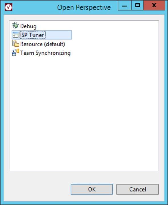

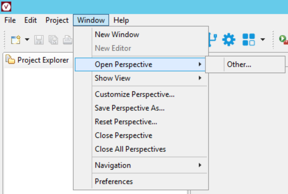

  1. In the top menu bar, select Window > Open Perspective > Other.
../../../_images/image3.png
Figure 3.1‑1 Select Window > Open Perspective > Other
  1. In the pop-up “Open Perspective” window, select “ISP Tuner”, then click “OK”. Alternatively, double-click “ISP Tuner”.
../../../_images/image4.jpeg
Figure 3.1‑2 Select ISP Tuner Perspective
Outcome
The VTunerClient workspace has been switched to the ISP Tuner view.

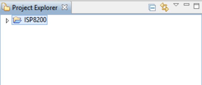

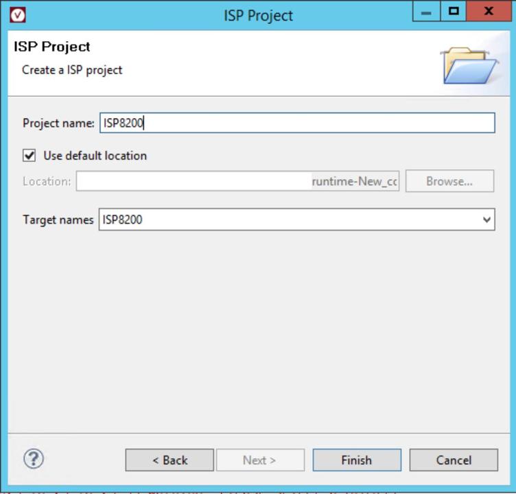

Creating an ISP Project
This section describes how to create an ISP project. Each ISP project contains a set of settings for ISP tuner features.
Prerequisites
Ensure the VTunerClient workspace is displayed in the ISP Tuner view, as described in Switching to ISP Tuner View.
Steps

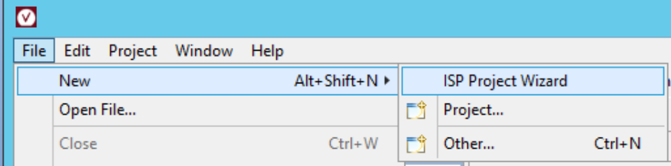

  1. In the top menu bar, select File > New > Project.
../../../_images/image5.png
Figure 3.1‑3 Select File > New > Project
  1. In the pop-up “New Project” window, select ISP > ISP Project Wizard, then click “Next”. The ISP project window will appear.
../../../_images/image6.jpeg
Figure 3.1‑4 Example of Creating an ISP Project
  1. In the “Project name” text box, enter the name of the project to be created. Project names can only contain letters, numbers, and underscores. Other special characters are not supported.
  2. To create the project in the default location, select the “Use default location option”. To customize the target location, clear this option, click “Browse” to the right of Location, and select the desired location.
  3. From the “Target names” drop-down list, select a tuning template.
  4. Click “Finish” to create the project.
Outcome
• The ISP project has been created and listed in the project resource browser view.
• A folder with the same name as the project has been created at the specified location.

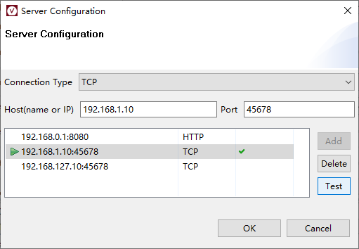

  1. In the toolbar, click ../../../_images/image7.png. The Server Configuration dialog box will appear.
../../../_images/image9.png
Figure 3.1‑5 Establishing Connection Between Tuning Server and VTunerClient via HTTP/TCP
  1. From the “Connection Type” drop-down list, select the protocol to be used between VTunerClient and Tuning Server.
For supported protocols, refer to Client-Server Connection Protocol.
  1. If the connection type is set to TCP, perform the following steps:
    1. In the “Host (name or IP)” and “Port” text boxes, enter the board-side IP address and port number of the Tuning Server. The port number is “45678”.
    2. Click “Add” to add the Tuning Server to the host list.
      1. If an exclamation mark (!) appears to the right of the host information, access to the Tuning Server has failed. In this case, troubleshoot the connection error and retry.
      2. If a green checkmark (√) appears to the right of the host information, the Tuning Server is accessible.
  2. Click “OK” to complete the configuration.
Outcome
The host address of the Tuning Server is displayed in the status bar of the VTunerClient workspace. The indicator light shows whether the host is accessible.
  1. A green indicator light indicates the Tuning Server is accessible.
  2. A red indicator light indicates the Tuning Server is not accessible.

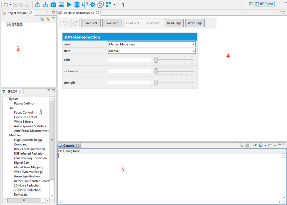

ISP Tuner View
The ISP Tuner view contains the following components required for tuning ISP features, as shown in Figure 3.2‑1.
../../../_images/image12.png
Figure 3.2‑1 Main Page of ISP Tuner Tool

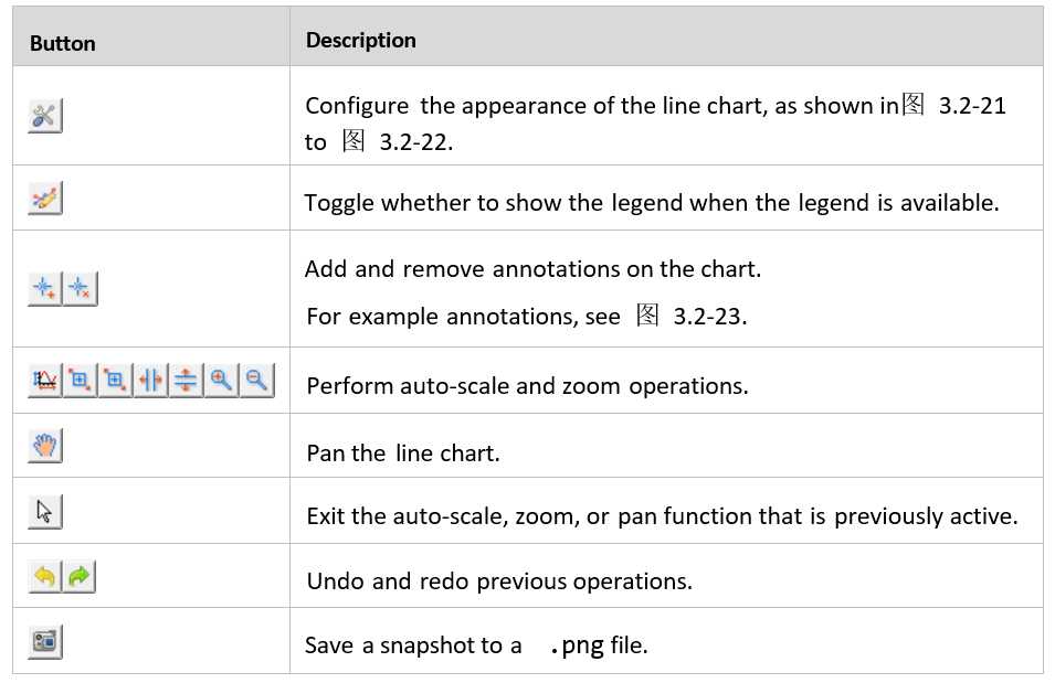

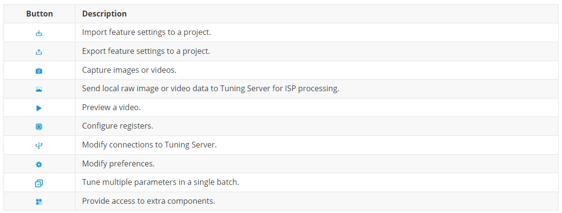

Toolbar
The table describes key buttons in the toolbar of the ISP Tuner view (Area 1 in Figure 3.2‑1)
image-20240906145347244
Table 3.2‑1 Description of Key Functions in ISP Tuner View

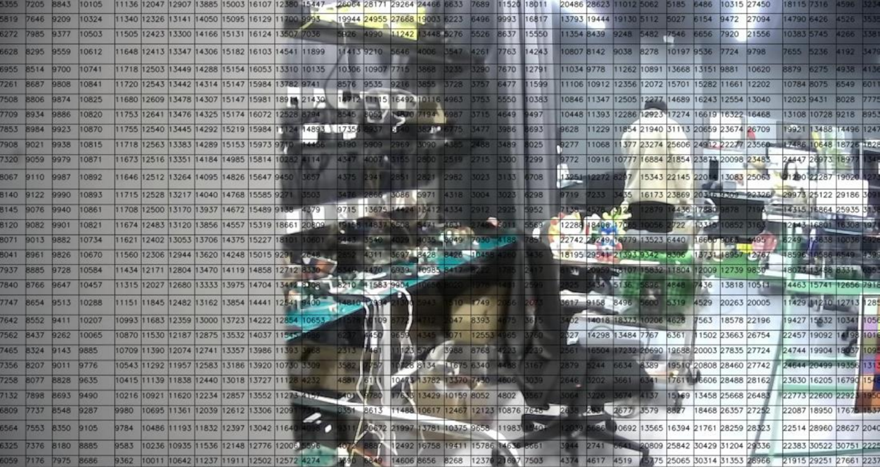

Statistics Window Grid
The AWB tool provides a window to display the dumped image, divided into a 32x32 grid corresponding to the 32x32 statistical elements, as shown in Figure 3.2‑2.
../../../_images/image24.png
Figure 3.2‑2 32x32 Blocks Window

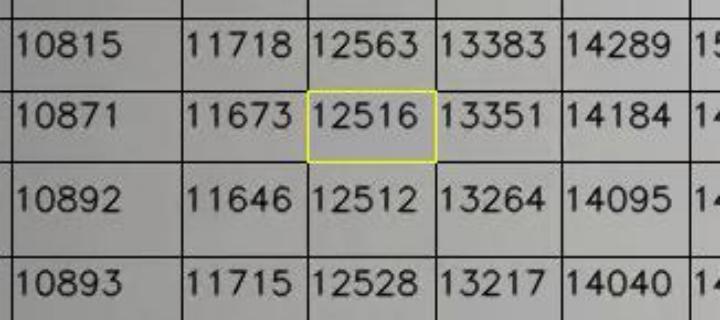

  • You can select a block to display its local information in the AWB statistics window. Only one block can be selected at a time.
  • After selection, the block is highlighted with a yellow border, as shown in Figure 3.2‑3.
../../../_images/image25.jpeg
Figure 3.2‑3 Block Selection
  • The corresponding white point in the AWB statistics window is also highlighted in yellow, as shown in Figure 3.2‑3.
  • You can click the selected block again to deselect it. The number in each block represents the average value of the selected item in the AWB statistics window.

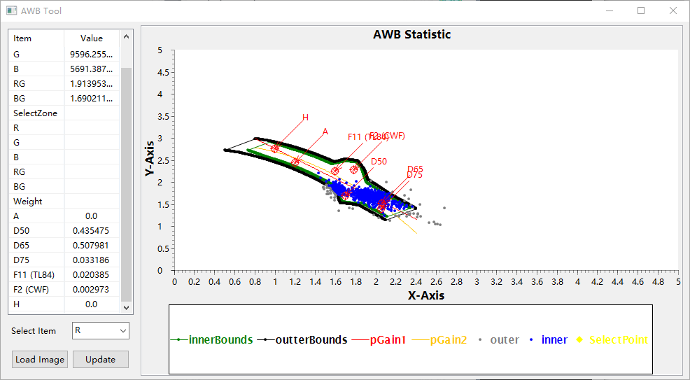

AWB Statistics Window
The AWB tool provides a window to display statistics. Only white points participating in AWB statistics are counted.
AWB Statistic includes a table and a chart.
  1. The table consists of the following sections: Global, SelectZone, and Weight. Each value in the table represents the average value for the corresponding channel.
    1. Global lists statistics for the entire image.
    2. SelectZone lists statistics for the block selected in the block window. If no block is selected, the SelectZone section remains empty.
    3. Weight lists the weights of light sources. The sum of all weights must equal 1. If all weights are 0, ensure that the AWB module is enabled.
To display only the information of interest, you can select an option from the Select Item dropdown list.
To refresh the table and chart, click the “Update” button. However, all previous changes will be discarded after refreshing.
The image shown in Figure 3.2‑2 can be imported via the “Load Image” function for convenient reference to each statistical block’s data results.
  1. The figure below, Figure 3.2‑4, illustrates the distribution of white points and light sources.
If the AWB module supports the confidenceThreshold parameter, you can adjust the size of each light source by dragging its circle. This will update and send the new confidenceThreshold to the Tuning Server, possibly causing changes in the image and statistics. When adjusting the size of light sources, note the following constraints:
  1. The circles of any two light sources must not intersect.
  2. The adjusted circle size must not be smaller than the initial size.
../../../_images/image26.png
Figure 3.2‑4 AWB Statistic Window

Table 3.2‑2 describes the views available in ISP Tuner.
Button Description
Project Explorer
Main page of ISP Tuner tool (No. 2)
Lists the projects in the current workspace.
Features
Main page of ISP Tuner tool (No. 3)
Lists the feature modules that can be tuned for the project selected in the Project Explorer view. The label of this view varies with the tuning template of the selected project.
Details
Main page of ISP Tuner tool (No. 4)
Shows the settings of the feature module selected in the Features view. The label of this view varies with the selected module.
Console
Main page of ISP Tuner tool (No. 5)
Prints logs in real time.
Table 3.2‑2 Views in the ISP Tuner Perspective
Project Resource Preview
The Project Resource view provides a hierarchical view of the projects in the current workspace, as shown in Figure 3.2‑5.
../../../_images/image27.jpeg
Figure 3.2‑5 Project Explorer View

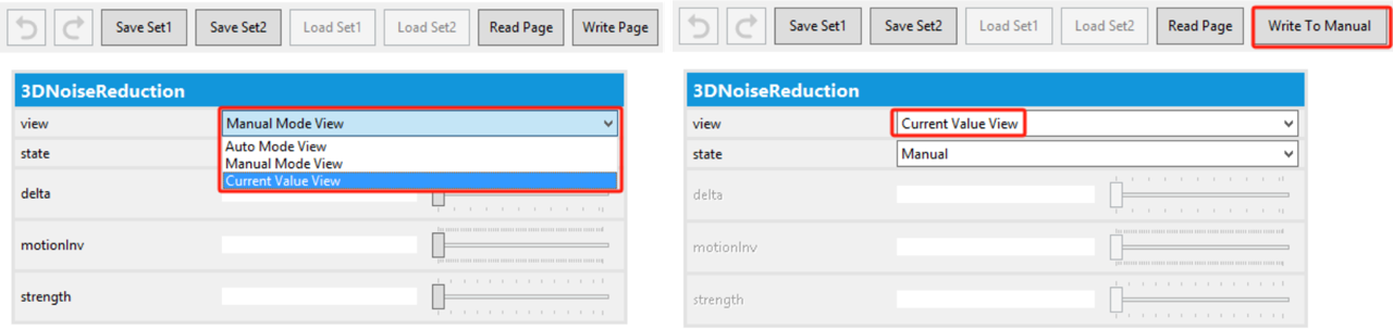

Control Bar
The Module Details view provides a control bar at the top. The buttons in the control bar are described in Table 3.2‑3.
../../../_images/image30.jpeg
Figure 3.2‑8 Example Control Bar with the Write Page Button in the Details View
../../../_images/image31.jpeg
Figure 3.2‑9 Example Control Bar with the Write To Manual Button in the Details View
Button Name
(Undo) Undo or redo an action. The undo/redo function is supported for each module separately. For each module, you can undo and redo a maximum of 10 updates. Note: New updates are stored at the end of the history, with intermediate steps if necessary. For
(Redo) example, the initial value of Strength is 0, and is then sequentially changed to 2, 4, 6, and 8. Clicking the Undo button repeatedly until the value is set back to 2 enables both the Undo and Redo button, as we can track backward to 0 and forward to 4, 6, and 8. At this point, if Strength is set to 5, this update is added to the end of the history, after an intermediate record 8 -> 2. The redo button is then disabled because the last step has been reached, and the Undo button can track backward as 5 -> 2 -> 8 -> 6 -> 4 -> 2 -> 0.
Save Set1 Save the parameter settings in the current view to asset1.
Save Set2 Save the parameter settings in the current view to asset2.
Load Set1 Load parameter settings from set1.
Load Set2 Load parameter settings from set2.
Read Page Read all the settings of the parameters in the current view from the Tuning Server.
Write Page Write all the parameter settings in the current view to the Tuning Server.
Table 3.2‑3 Control Bar Buttons in the Details View
Note: The “Write To Manual” function requires selecting the “Current Value View” option in the specific module’s View section. This button will then appear on the tool side. This function is useful for debugging, allowing the current Auto-mode parameters to be written into Manual mode, enabling troubleshooting and issue localization by modifying fewer Manual parameters.

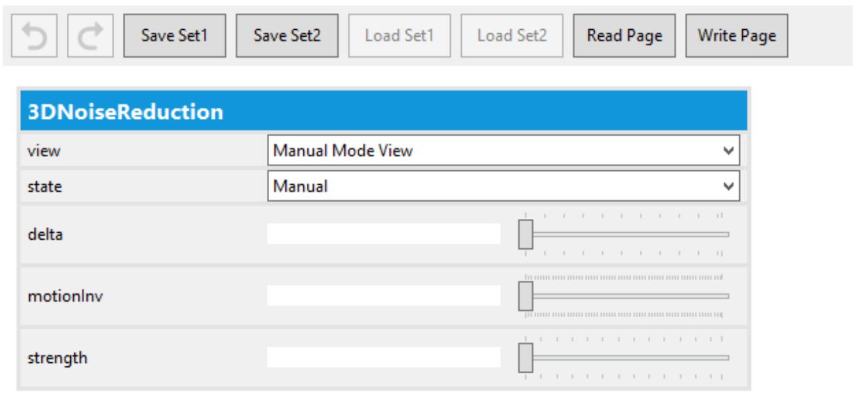

The parameter details support five types of parameters: Boolean, Integer/Float, Option, Matrix, and Curve. The controls used to configure each parameter type vary.
Boolean Parameters
Each Boolean parameter is configured by selecting or clearing a checkbox, as shown in Figure 3.2‑10.
../../../_images/image34.jpeg
Figure 3.2‑10 Boolean Parameter Example
Integer/Float Parameters
Each integer/float parameter is configured by entering a value in the text box or dragging the slider on the right, as shown in Figure 3.2‑11. Once the slider is dragged, the value in the text box updates accordingly, and vice versa.
The supported value range is displayed as a tooltip when you hover over the slider, with the left and right endpoints representing the minimum and maximum values, respectively.
../../../_images/image35.jpeg
Figure 3.2‑11 Integer/Float Parameter Example
Option Parameters
Each option parameter is configured by selecting a value from a dropdown list, as shown in Figure 3.2‑12.
../../../_images/image36.jpeg
Figure 3.2‑12 Option Parameter Example
Option: view
If the feature module provides a view option, it can be used to switch between Manual Mode View, Auto Mode View, and Current Value View, as follows:
  1. If Manual Mode View is selected, the Details view displays manual configuration parameters.
  2. If Auto Mode View is selected, the Details view displays automatic configuration parameters.
  3. If Current Value View is selected, the Details view displays the effective values of the module after interpolation in Auto mode.
The Current Value View is read-only. However, you can click the “Write To Manual” button in the control bar to assign the values in the current view to the manual parameters on the Tuning Server.
../../../_images/image37.png
Figure 3.2‑13 Examples of Option view

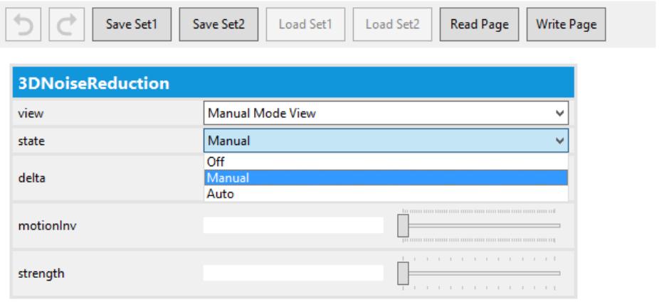

Option: state
If the feature module provides a state option, it can be used to enable or disable the module, as follows:
  1. If Manual is selected, the module operates in manual mode. Only the manual mode view is editable.
  2. If Auto is selected, the module operates in auto mode. Only the auto mode view is editable.
  3. If Off is selected, the module is disabled.
../../../_images/image38.jpeg
Figure 3.2‑14 Example of Option state

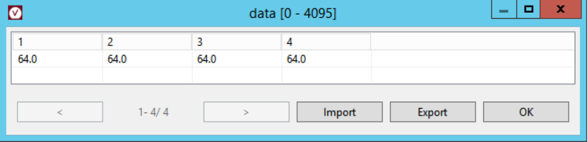

Numeric Matrix Parameters
Each numeric matrix parameter provides a “View” button. Clicking it opens a table window for editing the matrix, as shown in Figure 3.2‑15 and Figure 3.2‑16. Matrices with dimensions greater than two are represented in JSON format within the table.
The numeric matrix parameter window includes:
  1. Parameter name, also used as the table name.
  2. Value range for each cell.
../../../_images/image39.jpeg
Figure 3.2‑15 Matrix Parameter Example
../../../_images/image40.png
Figure 3.2‑16 Table for Editing a Matrix Parameter

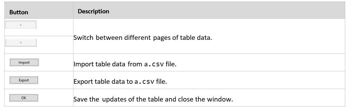

In the table, the first row contains column headers. The buttons at the bottom are described in Table 3.2‑4.
image-20240906150638282
Table 3.2‑4 Buttons in a Table Window

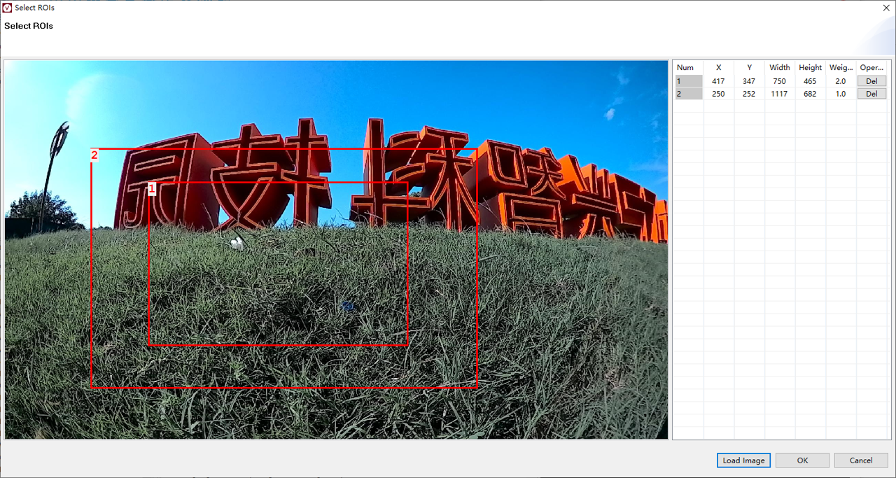

ROI Matrix Parameters
Each ROI matrix parameter provides a “View” button. Clicking it opens a dialog for specifying Regions of Interest (ROI), as shown in Figure 3.2‑17 (the new tool loads YUV data into the client on the lower right).
  1. To add an ROI, select a region in the image.
The ROI information, including coordinates, width, height, and weight, is automatically added to the table on the right.
  1. To modify the weight of an ROI, double-click and edit the corresponding cell.
  2. To delete a selected ROI, click the “Del” button in the corresponding row.
  3. To save updates and exit, click “OK”.

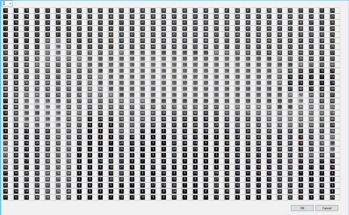

Note: The preview dump import function is not yet supported. You can manually dump sample images and import them into the Select ROIs interface to assist in annotating ROI areas. Without importing, a pure white blank image will be displayed. This feature depends on sensor information settings described in Section 3.4.2.
../../../_images/image47.png
Figure 3.2‑17 Window for Editing an ROI Matrix Parameter
Color Matrix Parameters
Each color matrix parameter provides a “View” button. Clicking it opens a dialog to display statistics in a grayscale table, as shown in Figure 3.2‑18. The number in each cell represents the statistic, with 0 displayed as black and 255 as white.
For exposure statistics, the matrix size can be 25x25, 32x32, or others, depending on hardware statistics.
The dropdown list in the upper-left corner provides four options, each representing a channel. The color matrix displays statistics for the selected channel. Changing the channel updates the color matrix, which may take some time.
../../../_images/image48.png
Figure 3.2‑18 Example of Color Matrix Window

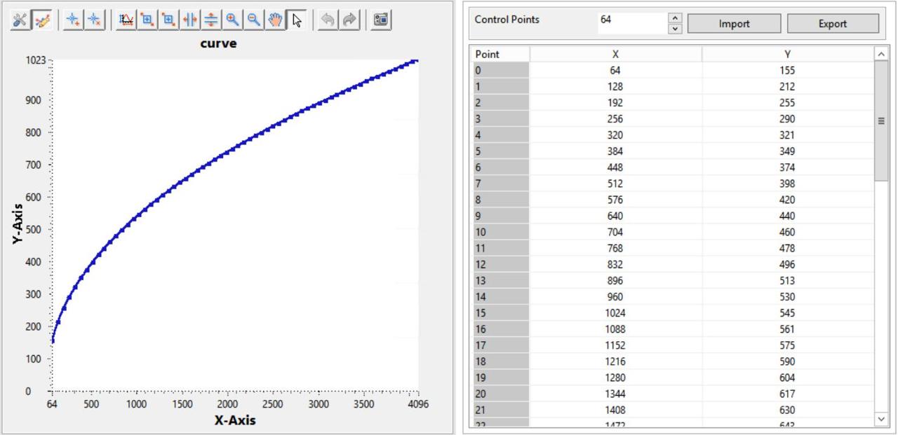

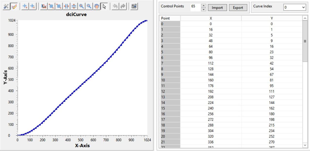

Curve Parameters
Each curve parameter is configured using a line chart and a 2D matrix table, as shown in Figure 3.2‑19. Each row in the table specifies the coordinates of a control point on the chart. The matrix can be edited by dragging control points on the line chart or modifying coordinates in the matrix table. The number of control points is configurable, ranging from 3 to the actual number of points on the curve.
Note: Control points are used to configure the curve. Modifying the number of control points does not change the actual number of points on the curve. The line chart displays control points rather than actual points for easier configuration.
Each curve can be generated from an imported .csv file. The Y-values of the curve control points can be exported to a .csv file.
../../../_images/image49.jpeg
Figure 3.2‑19 Curve Parameter Example
For curve parameters in auto mode, a curve index option is provided above the table, as shown in Figure 3.2‑20. The curve index option controls the gain applied to the curve. You can select an index to switch between different gains and then further edit the matrix.
../../../_images/image50.jpeg
Figure 3.2‑20 Example of Curve Parameter in Auto Mode

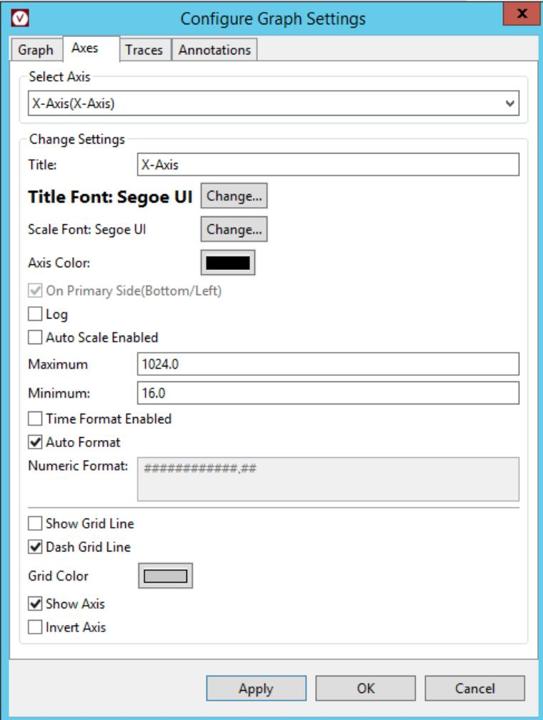

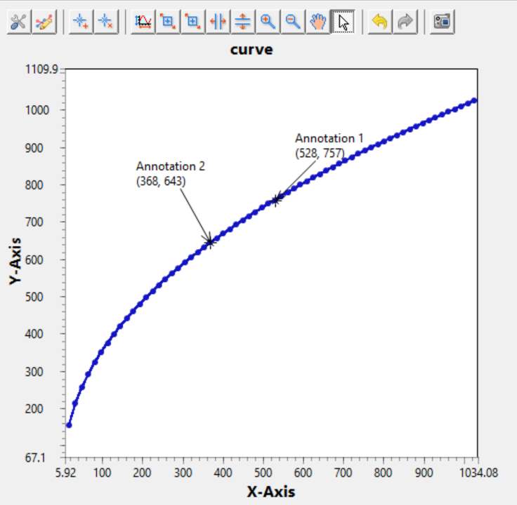

Toolbar Above the Line Chart
A toolbar is located at the top of the chart. The buttons in the toolbar are described in Table 3.2‑5.
image-20240906150704203
Table 3.2‑5 Toolbar Buttons Above a Line Chart

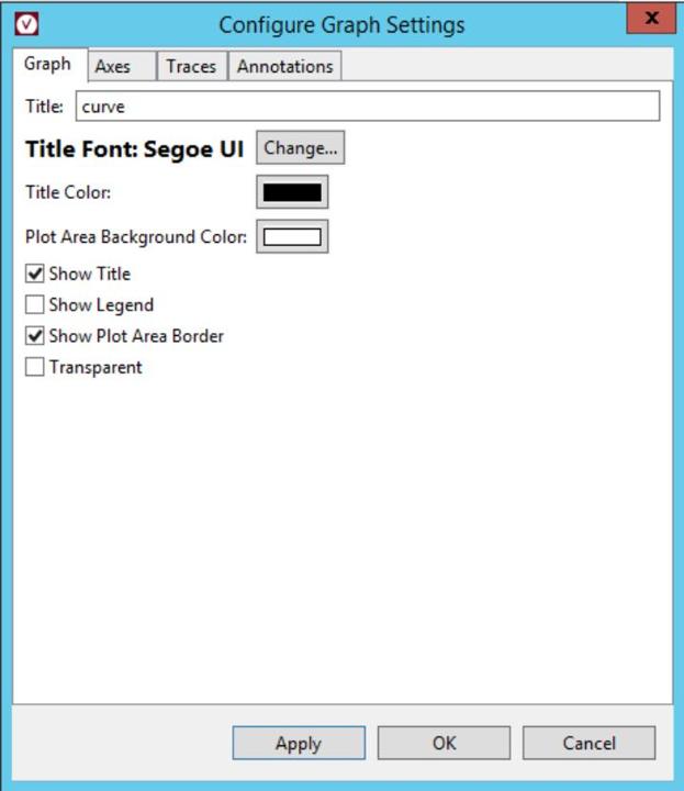

../../../_images/image59.jpeg../../../_images/image60.jpeg
Figure 3.2‑21 Configure Graph Settings > Graph&Axes

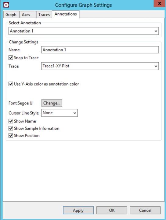

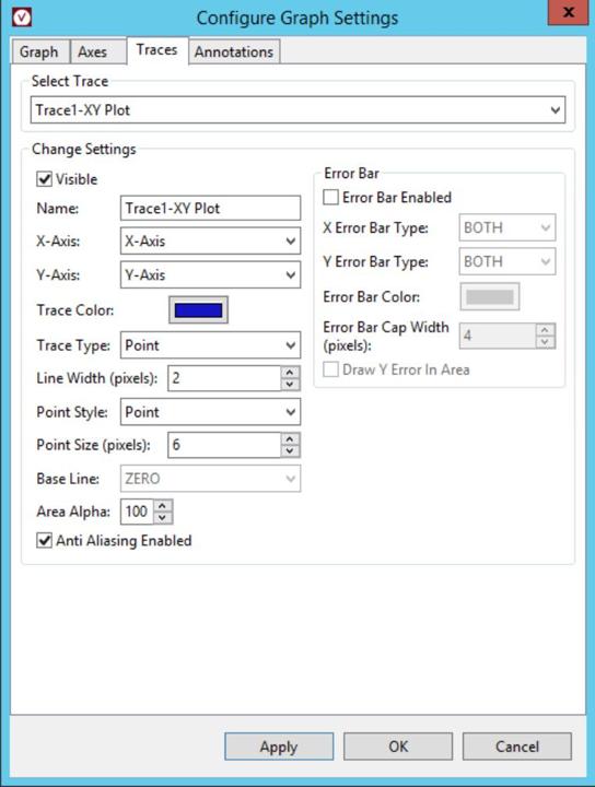

../../../_images/image61.jpeg../../../_images/image62.jpeg
../../../_images/image63.png
Figure 3.2‑22 Configure Graph Settings > Traces&Annotation
Figure 3.2‑23 Annotation Examples

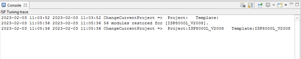

Console View
The Console view displays all interaction messages between VTunerClient and the Tuning Server, as well as runtime error and warning messages, as shown in Figure 3.2‑25.
../../../_images/image65.png
Figure 3.2‑25 Console View Example

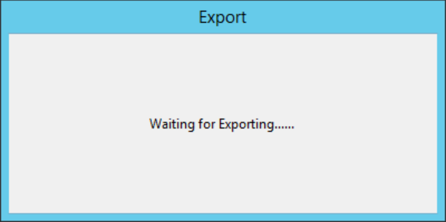

  1. The Export dialog appears during the export process. A message indicating whether the export was successful will then be displayed in the dialog.
../../../_images/image68.png
Figure 3.3‑2 Export Dialog

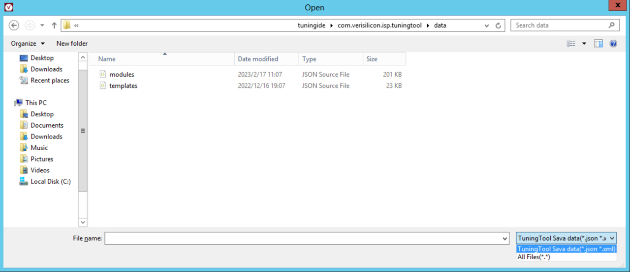

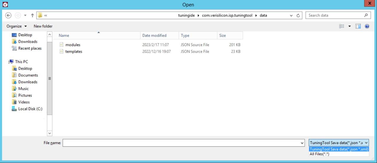

  1. In the toolbar, click ../../../_images/image69.png.
  2. In the pop-up Open window, select the .json file to import, then click “OK”.
../../../_images/image70.jpeg
Figure 3.3‑3 Selecting a JSON File

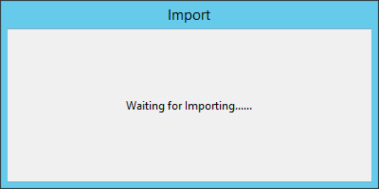

The import process displays an import dialog. A message indicating whether the import was successful will then be shown in the dialog.
../../../_images/image71.png
Figure 3.3‑4 Import Dialog

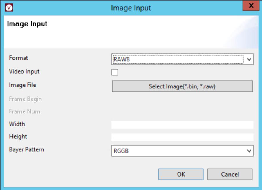

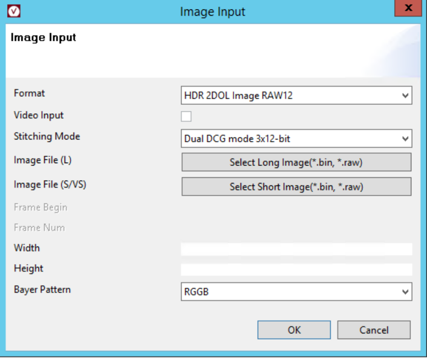

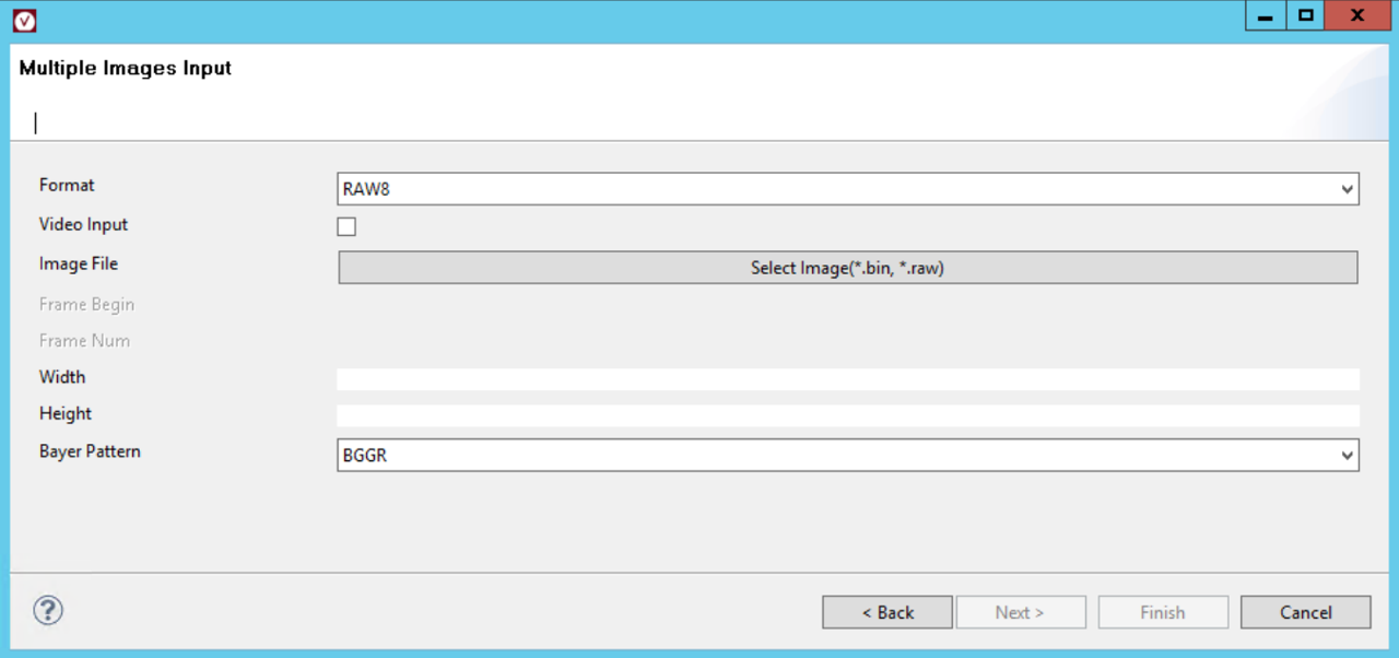

  1. In the toolbar, click ../../../_images/image72.png.
In the pop-up Image Input dialog, specify the following information:
../../../_images/image73.jpeg
Figure 3.3‑5 Image Input Dialog When a Normal Raw Format Is Selected
../../../_images/image74.png
Figure 3.3‑6 Image Input Dialog When an HDR Raw Format Is Selected
  1. From the “Format” dropdown list, select either “Normal Raw” or “HDR” format.
  2. Click “Video Input” and select a raw image or video file.
    1. If the checkbox is selected, video input is required.
    2. If the checkbox is cleared, image input is required.
  3. If “Normal Raw” format is selected from the Format dropdown list, click the “Image File” button to the right of “Select Image”, and select an image or video based on the “Video Input” setting.
  4. If “HDR” format is selected from the Format dropdown list, configure the HDR mode as follows:
    1. From the Stitching Mode dropdown list, select the stitching mode before composition.
    2. To the right of each image file parameter, click the “Select Image” button, and select an image or video based on the “Video Input” setting.
  5. If the “Video Input” checkbox is selected, perform the following steps:
    1. Enter the ID of the starting frame in the “Frame Begin” text box.
    2. Enter the number of frames in the “Frame Num” text box.
  6. Enter the input width and height in the “Width” and “Height” text boxes, respectively.
  7. From the Bayer Pattern dropdown list, select the input Bayer pattern.
  8. Click “OK”.
Outcome
The Tuning Server processes the sent image or video data.

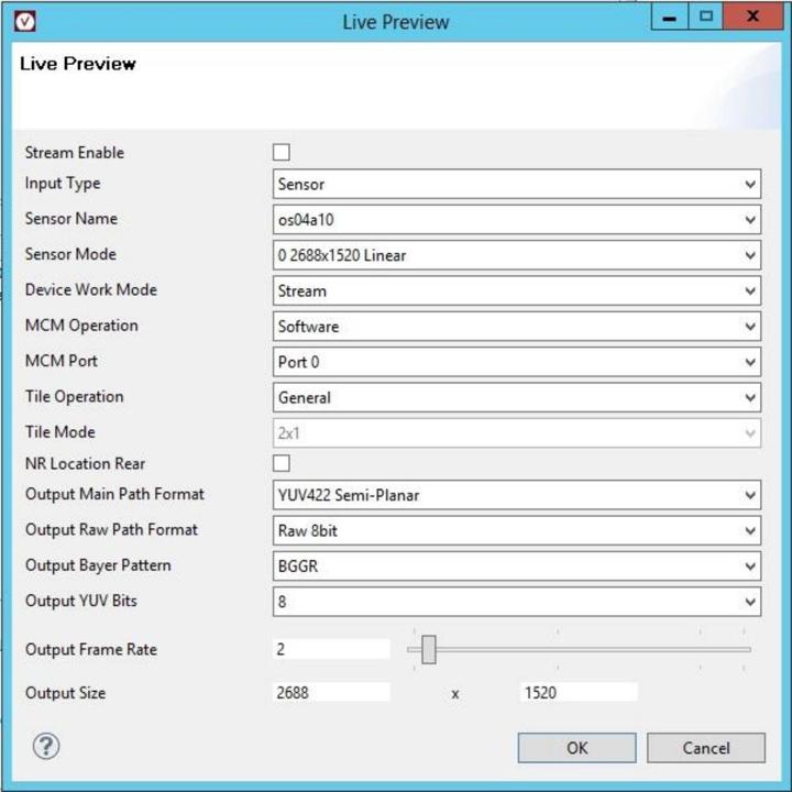

  1. In the toolbar, click ../../../_images/image75.png.
In the pop-up Live Preview dialog, specify the following information:
Note: Currently, only the “Input Type” and “Sensor Name” fields need to be configured; other fields can be ignored (the preview function uses a third-party tool Hbplayer instead, which will be introduced later). Also, regardless of whether real-time preview is needed, these two checkboxes are required for functional adjustments.
../../../_images/image76.jpeg
Figure 3.3‑7 Configuring Live Video Preview
  1. From the “Input Type” dropdown list, select the type to input to the Tuning Server.
    1. If RDMA is selected, the ISP uses linear raw data as input. Then, “Sensor Name” and “Sensor Mode” become non-editable.
    2. If Retiming is selected, the ISP uses HDR image data as input. Then, “Stitch HDR” must be selected from the “Sensor Mode” dropdown list.
    3. If “Sensor” is selected, the ISP uses sensor input information.
  2. From the “Sensor Name” dropdown list, select the sensor that matches the setup. For instructions, see Section 3.4.2, Customize Sensor Information.

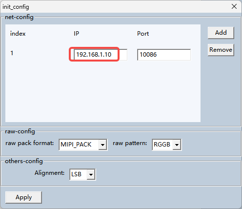

  1. Click the menu bar in Hbplayer ../../../_images/image77.png.
  2. Set the board’s IP address (if RAW images are to be displayed, set the corresponding format below)
../../../_images/image78.png
Figure 3.3‑8 Hbplayer Connection

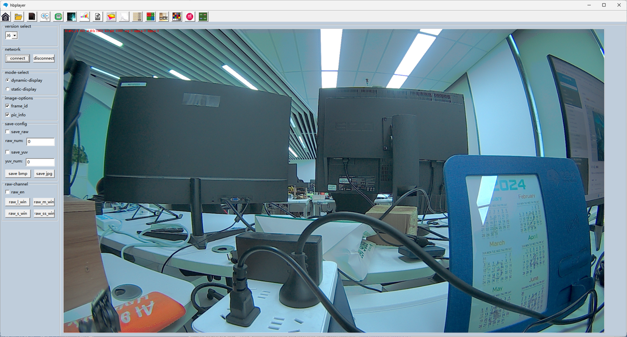

  1. On the main page, select J6 in Version Select.
  2. Click connect under network on the main page to view the real-time drawing, as shown in Figure 3.3‑9.
../../../_images/image79.png
Figure 3.3‑9 Hbplayer view
Note: Hbplayer receives YUV data sent from the board via network and performs software decoding for real-time display; high-resolution images may suffer frame drops due to bandwidth limitations.

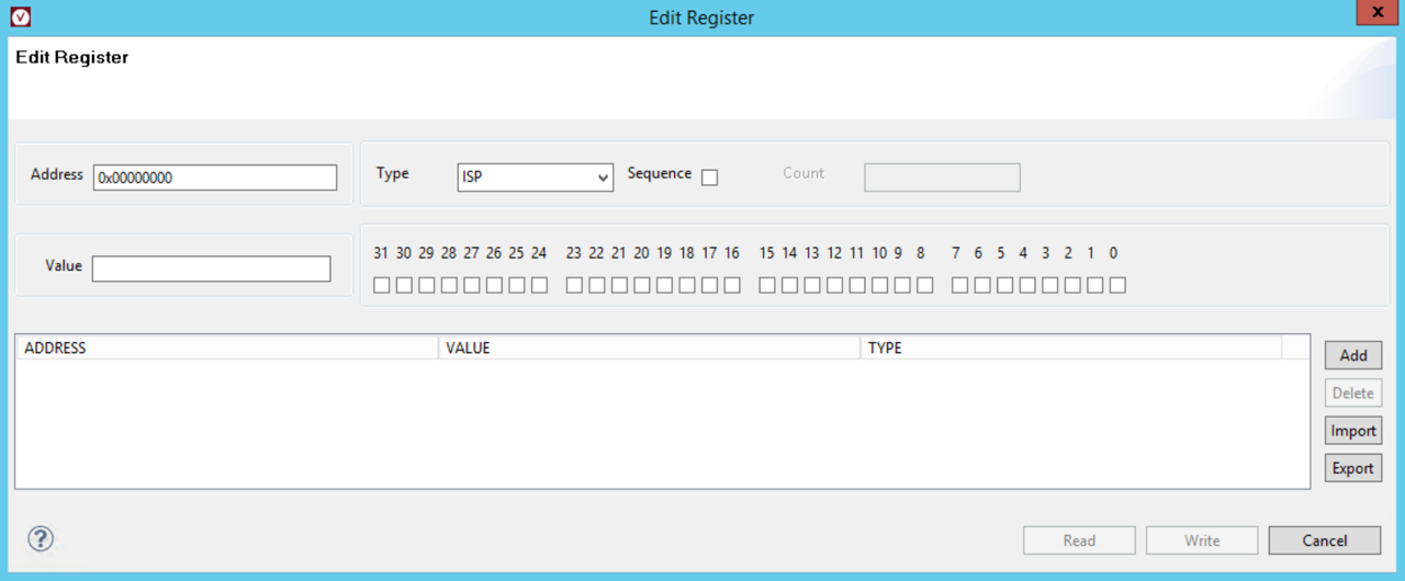

Operation Steps
  1. In the toolbar, click ../../../_images/image80.png.
The Edit Register page for registers will then appear.
../../../_images/image81.png
Figure 3.3‑10 Edit Register
● Important: Settings must strictly follow the requirements listed in the Software Accessible Register Document provided in the hardware release package.
  1. In the “Address” text box, enter the address of the target register to be edited.
  2. From the “Type” dropdown list, select whether to edit ISP registers or sensor registers.
  3. If editing consecutive registers, select the “Sequence” checkbox.
  4. If the “Sequence” checkbox is selected, enter the number of consecutive registers to be edited starting from the specified address.
  5. In the “Value” text box, enter the new value for the register, or select/clear the corresponding checkboxes for each register bit on the right.
  6. Click “Add” to add the register setting to the table. Adding fails if the address is unspecified or already exists in the table.
Alternatively, click Export to export the table to a .csv file, edit it, and then click “Import” to import it.
  1. (Optional) In the table, select a record and click “Delete” to remove it from the table.
  2. (Optional) Repeat steps 2 to 8 to edit the table to include all required register settings.
  3. Click “Write” to update the Tuning Server with all register settings in the table. To query the values of registers in the table, click “Read”. The query results will overwrite the “VALUE” column in the table.
Operation Result

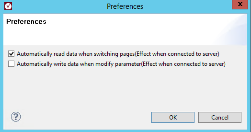

This section describes how to configure VTunerClient preferences.
Prerequisites
Ensure that the VTunerClient workstation is connected to the service and the board.
Operation Steps
  1. In the toolbar, click ../../../_images/image83.png.
The following page will appear.
../../../_images/image84.png
Figure 3.3‑12 Configuring Preferences
  1. Select or clear “Automatically read data when switching pages” to control whether data is automatically read from the Tuning Server when switching pages and used to update parameter information.
  2. Select or clear “Automatically write data when modify parameter” to control whether data is automatically written to the Tuning Server when adjusting parameter modules.
  3. Click “OK”.

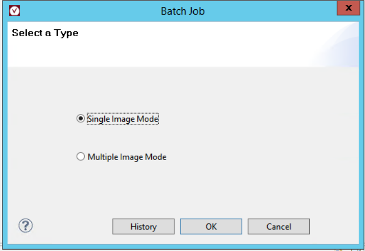

Operation Procedure
  1. On the toolbar, click ../../../_images/image85.png.
The batch job dialog appears.
../../../_images/image86.png
Figure 3.3‑13 Selecting a Mode for a Batch Job
  1. Select Single Image Mode and click OK.

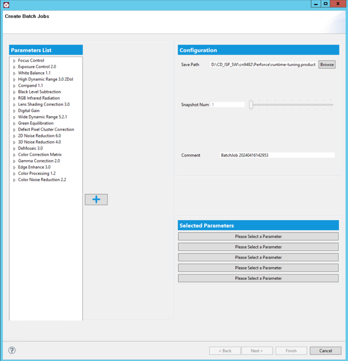

A wizard page appears to guide you through creating a batch job.

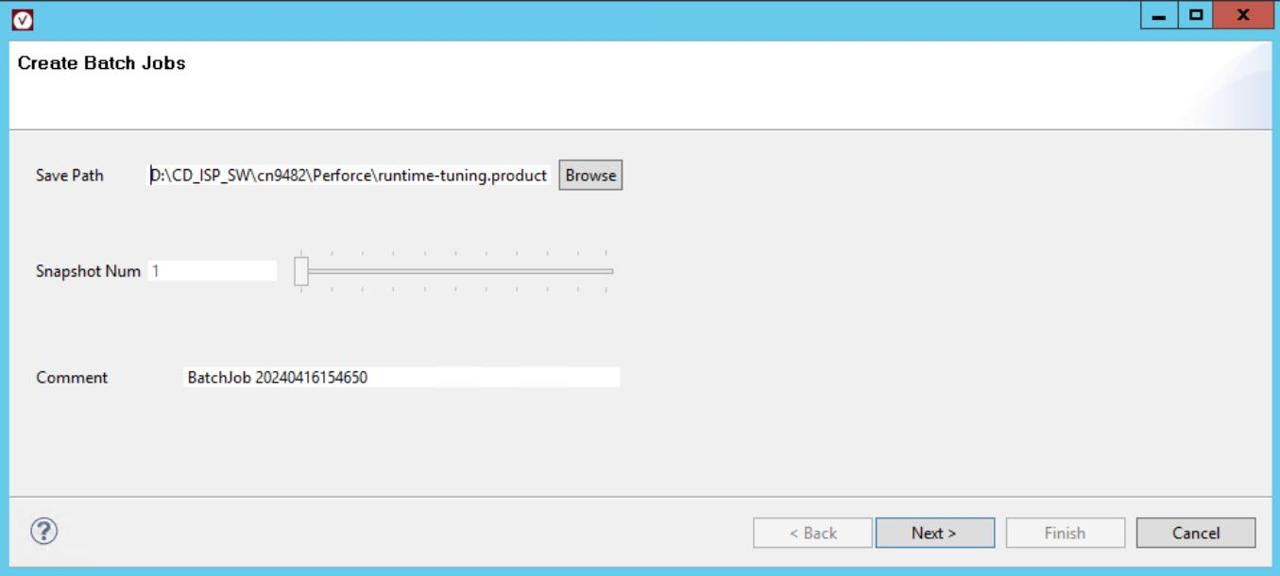

../../../_images/image87.png
Figure 3.3‑14 Creating a Batch Job in Single-Image Mode
  1. In the “Configurations” section, configure basic settings for the batch job and click Next.
    1. To the right of “Save Path”, click “Browse” and select the directory where you want to save tuning results.
    2. In the “Comment” text box, enter a comment for the batch job.
Note: Snapshot count indicates the number of images you want to capture for each tuning task and is fixed at 1 in single-image mode.
  1. In the “Parameters List” section, select the parameters to adjust and click ../../../_images/image88.jpeg to add them to the “Selected Parameters” section.
Alternatively, double-click parameters to add them to the “Selected Parameters” section.
You must select at least one parameter. Up to five parameters can be selected.
Only root nodes in the “Parameters List” section can be added to the “Selected Parameters” section.
Note: All parameters prefixed with AUTO will not appear in the “Parameters List” section and are not applicable for batch tuning.

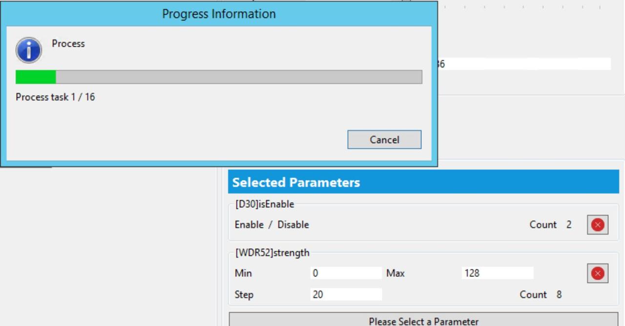

  1. In the “Selected Parameters” section, adjust and verify the selected parameters for tuning the input image.
For each parameter section, Count indicates the number of candidate parameter values. Ensure the Count value is greater than or equal to 1.
Parameter sections vary depending on parameter type. For details, refer to Parameter Types for Batch Tuning.
../../../_images/image89.jpeg
Figure 3.3‑15 Example of the Selected Parameters Section
  1. Click the “Next” button to create the batch job.
A unique ID is then assigned to the batch job. Additionally, a progress bar appears showing the progress of job creation.
When tuning video dumped from a sensor, the preview video may change during processing. However, after the batch job completes, it will revert to its original state.
../../../_images/image90.jpeg
Figure 3.3‑16 Progress Bar for Creating a Batch Job
  1. Wait for the batch job to complete.

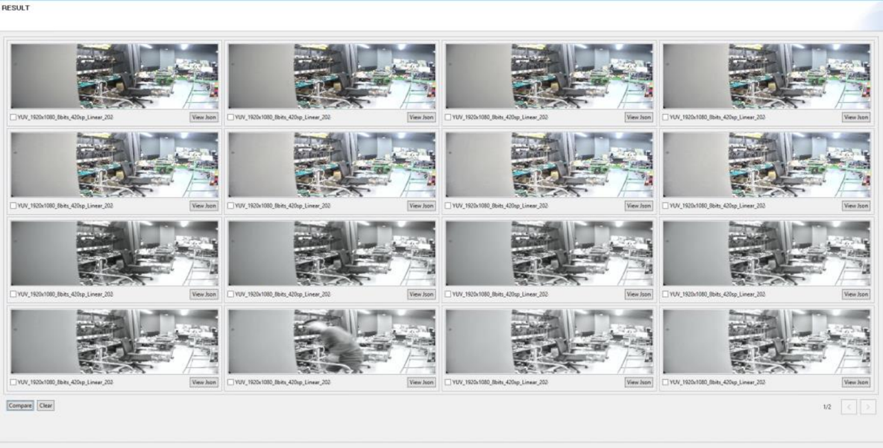

Operation Result
  • A result display page appears showing result images for each tuning task in the batch job, as shown in Figure 3.3‑17.
  • Result images from the batch tuning are saved in .jpg format to the directory specified by “Save Path”.
  • All parameters adjusted in the batch job are restored to the values applied before the job ran. The preview image also reverts to its state prior to the batch job.
../../../_images/image91.png
Figure 3.3‑17 Example of Batch Job Results

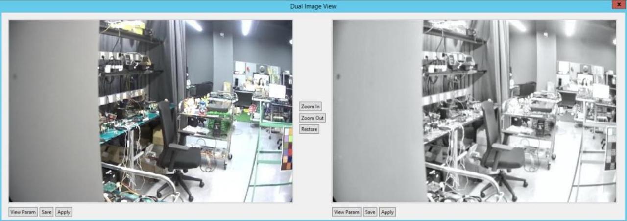

  • To compare two result images, check the checkbox before the image names and click “Compare” at the lower-left corner.
../../../_images/image92.jpeg
Figure 3.3‑18 Example of Dual Image View Dialog
You can click the “Clear” button to deselect all images.

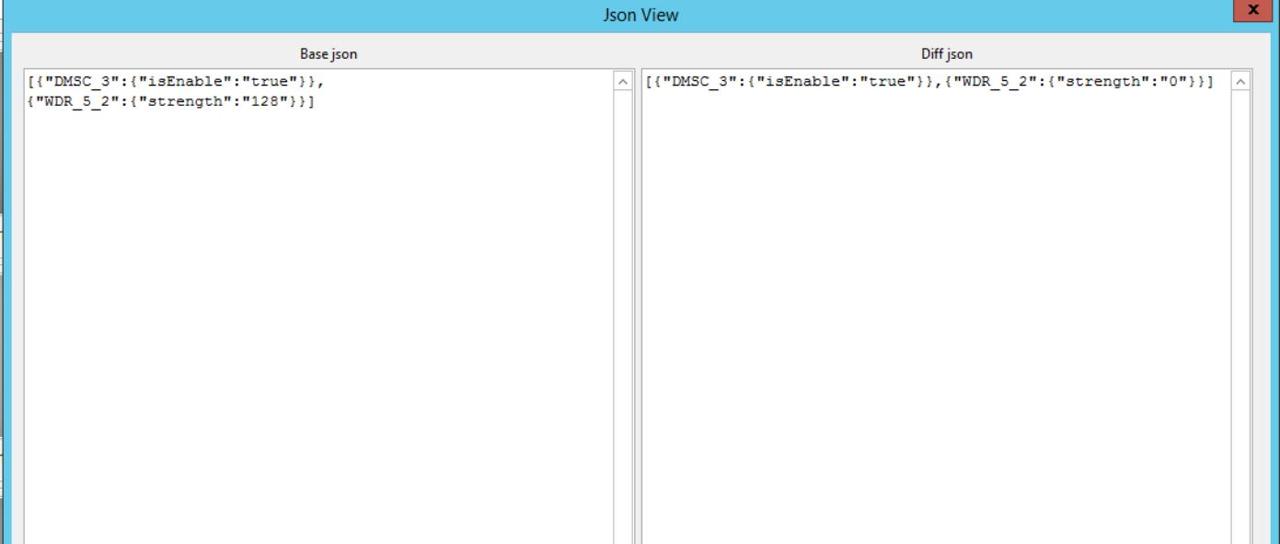

  • To view the original and adjusted JSON configuration scripts for the selected parameters, click “View JSON”. In the pop-up JSON view dialog:
    • Base json refers to the JSON configuration script applied before running the batch job.
    • Diff json refers to the JSON configuration script applied during the batch job.
Other parameters are not included in these JSON configuration scripts. For information on the complete original JSON configuration script, refer to the BaseJson file in the workspace.
../../../_images/image93.jpeg
Figure 3.3‑19 Example of Json View

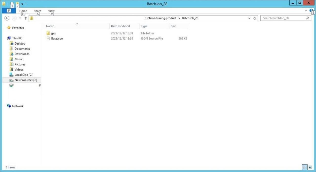

../../../_images/image94.jpeg
Figure 3.3‑20 Example of BaseJson File and Captured Images for a Batch Job

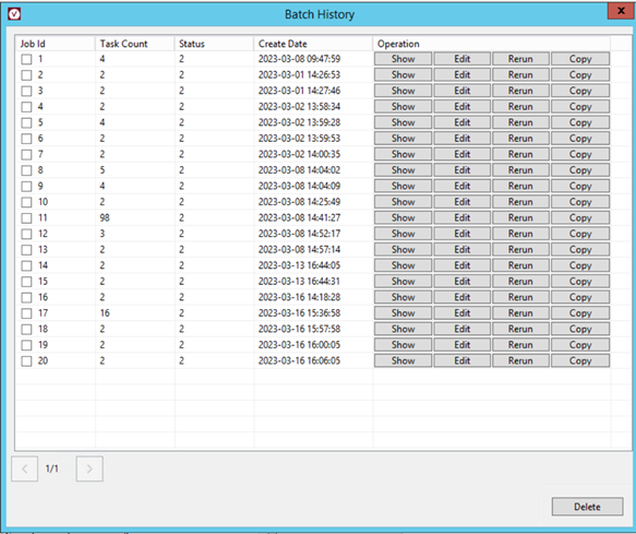

For information on managing historical batch jobs, refer to Section 3.3.8.3, Managing Archived Batch Jobs.

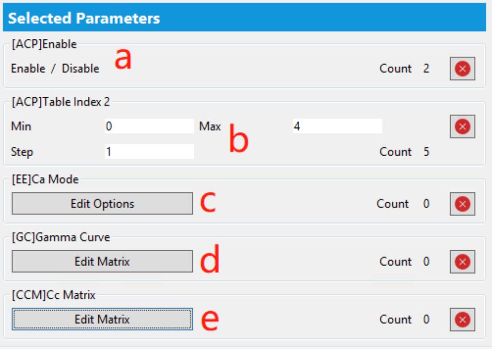

In batch tuning under single-image mode, available configurations for each parameter vary by type. For example sections of each parameter type, see Figure 3.3‑15.
The following parameter types are available for batch tuning:
  • Boolean Parameters (a in Figure 3.3‑15)
Candidate values for boolean parameters are fixed as true and false.
  • Integer or Floating-Point Parameters (b in Figure 3.3‑15)
For integer or floating-point parameters, you can specify minimum value, maximum value, and step size, which together define the candidate value list. Both minimum and maximum values are included in the candidate list.
  • Option Parameters (c in Figure 3.3‑15)
Click the “Edit Options” button to edit option parameters. All selected items are treated as candidate values. At least one option must be selected for each option-type parameter.
../../../_images/image95.jpeg
Figure 3.3‑21 Example of Editing an Options Parameter

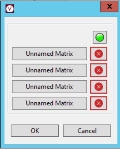

  • Matrix and Curve Parameters (d and e in Figure 3.3‑15)
Curves are treated as the same parameter type as matrices. The difference is that matrix parameter values are one-dimensional, while curve parameter values are two-dimensional.
Click the “Edit Matrix” button to edit matrix or curve parameters.
  • To add a matrix value, click the green icon in the upper-right corner. The matrix value is named “Unnamed Matrix” by default.
Note: After clicking the green icon, a read request to add the matrix value is sent to the Tuning Server. If the read operation fails, clicking the green icon may have no effect.
  • To edit a matrix value, click its name.
  • To remove a matrix value, click the red icon to the right of the matrix value name.
../../../_images/image96.jpeg
Figure 3.3‑22 Example of Editing a Matrix Parameter

Figure 3.3‑23 Selecting a Mode for a Batch Job
  1. Select Multi-Image Mode and click OK.
A dialog appears to guide you in creating a batch job.
../../../_images/image99.jpeg
Figure 3.3‑24 Configuring Image Capture for a Multi-Image Batch Job
  1. In the Create Batch Jobs step, specify basic information for the batch job as follows and click Next.
Note: Snapshot Num indicates the number of images you want to dump for each tuning task and is fixed at 1 in single-image mode.
  1. In the Multiple Images Input step, specify input image information and click Next.
For information on parameters in this step, refer to Section 3.3.2, Inject Raw Images into Tuning Server.
../../../_images/image100.png
Figure 3.3‑25 Specifying Input Image Information for a Multi-Image Batch Job

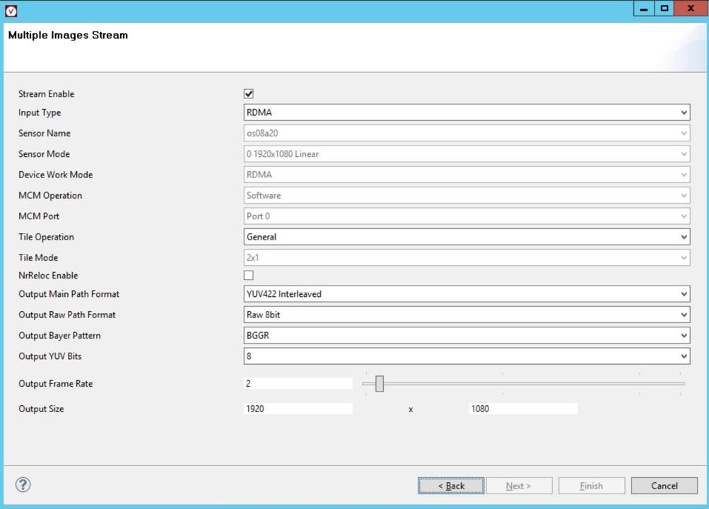

  1. In the Multiple Images Input step, configure the stream and click Finish.
../../../_images/image101.jpeg
Figure 3.3‑26 Configuring the Stream for a Multi-Image Batch Job
For information on parameters in this step, refer to Configure Real-Time Preview.
Operation Result
  • Result images from tuning tasks in the batch are saved in .jpg format to the directory specified by “Save Path”.

  1. Click the “History” button.
The Batch History dialog appears, displaying a table listing batch jobs archived in the database. The table includes job details such as job ID, number of tasks in the job, job status, and job creation time.
Possible values for job status include:
  • 0: Created but not started
  • 1: Started but not completed
  • 2: Completed
../../../_images/image104.png
Figure 3.3‑28 Example of Batch History Dialog
  1. Manage batch jobs as follows:
    1. To view results of batch jobs with non-zero status, click “Show” in the “Operation” column.
    2. To view and edit the configuration of a batch job and run it as a new job, click “Edit” in the “Operation” column.
The new job is assigned a new ID. Its status value is initialized to 1 and changes to 2 upon completion.
3) To run a batch job as a new job without changing its configuration, click "**Rerun**" in the "**Operation**" column. The new job is assigned a new ID. Its status value is initialized to 1 and changes to 2 upon completion.
4) To copy a batch job as a new job without running it, click "**Copy**" in the "**Operation**" column.
The new job is assigned a new ID. Its status value is 0.
5) To delete a batch job, select the corresponding checkbox in the "**Job Id**" column and click "**Delete**" at the lower-right corner.
After deletion, the tuning results of the batch job are also deleted.
Note: For multi-image batch jobs, the “Edit”, “Rerun”, and “Copy” buttons are unavailable.

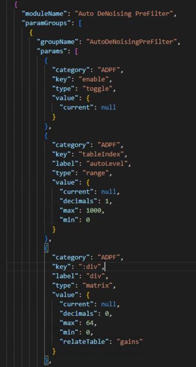

  1. (Recommended) Back up the isp_modules.json file in the working directory.
  2. Open and edit the isp_modules.json file to:
    1. Remove certain modules or parameters.
    2. Modify the display order of modules or parameters.
    3. Modify the display names of modules, groups, or parameters.
    4. Group some parameters into a new module.
    5. Collaborate with the Tuning Server to add modules or parameters.
../../../_images/image105.jpeg
Figure 3.4‑1 isp_modules.json Example
In the isp_modules.json file:
  1. moduleName defines the name of the module.
  2. paramGroups includes an array where each item defines a parameter group.
  3. params includes an array where each item defines a set of parameters within a group.
  4. label is the parameter name displayed on the workstation.> If no label is specified, the workbench will display the value of the key.
  5. type defines the parameter type.
For more information, see Section 3.2.4.2, Parameter Types.
  1. Delete and recreate the existing project to activate the custom settings.

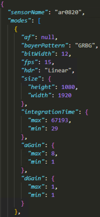

  1. (Recommended) Back up the isp_sensor.json file in the working directory.
  2. Open and edit the isp_sensor.json file.
In the isp_sensor.json file:
  1. sensorName defines the name of the sensor. It is recommended to use the same sensor name as on the Tuning Server side.
  2. Mode contains an array where each item defines a sensor mode.
  3. af indicates whether the sensor supports the PDAF or CDAF module.
  4. bayerPattern indicates the output Bayer pattern.
  5. bitWidth indicates the bit depth of the output format.
  6. fps indicates the output frame rate.
  7. hdr indicates the linear/HDR mode.
Valid values: Linear, Native HDR, and Stitch HDR.
  1. size indicates the output resolution in pixels.
  2. integrationTime indicates the time required to expose a certain number of rows, in microseconds. The number of measured rows depends on the sensor configuration.
  3. aGain indicates the analog gain.
  4. dGain indicates the digital gain.
