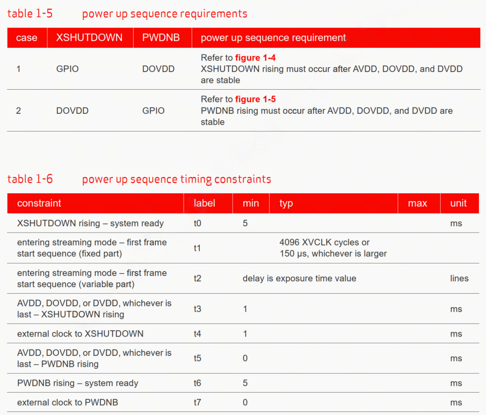

power_on
  2. sensor_poweron 一般在 sensor_init 中调用,只需要控制 XSHUTDOWN 即可,以下为 os08c10 power_on的代码实现:
../../_images/screenshot-20260210-145220.png
int sensor_poweron(sensor_info_t *sensor_info)
        int gpio, ret = RET_OK;
                                usleep(100 * 1000);  // 100ms
                                if(ret < 0) {
        return ret;

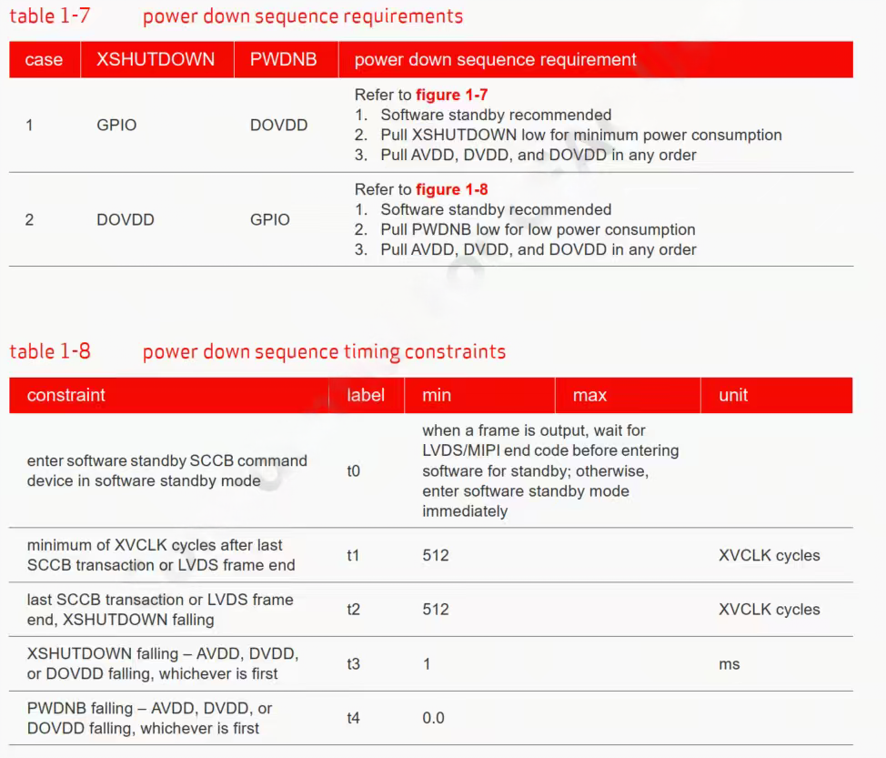

power_off
  2. sensor_poweroff 一般在 sensor_deinit 中调用,只需要控制 XSHUTDOWN 即可,以下为 os08c10 power_off 的代码实现:
../../_images/screenshot-20260210-145247.png
int sensor_poweroff(sensor_info_t *sensor_info)
                                if(ret < 0) {
                                        return -1;
        return ret;

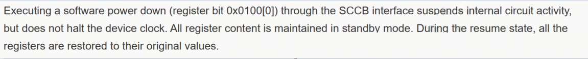

start
  1. start 实现下发开流寄存器0x0100 为0x01,使 sensor 出流。
  2. sensor_start 调用时机为 上层调用 hbn_vflow_start。
../../_images/screenshot-20260210-205236.png
int sensor_start(sensor_info_t *sensor_info)
        int ret = RET_OK;
        int setting_size = 0;
        pr_debug("os08c10 sensor start\n");
        setting_size = sizeof(os08c10_2lane_stream_on_setting) / sizeof(uint32_t) / 2;
                        setting_size, os08c10_2lane_stream_on_setting);
        if (ret < 0) {
                pr_err("start %s fail\n", sensor_info->sensor_name);
                return ret;
        return ret;

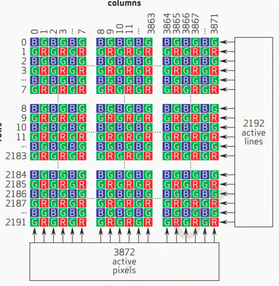

  • sensor_data_bayer_fill(..., 12, BAYER_START_B, BAYER_PATTERN_RGGB);sensor_data_bits_fill(..., 12),0,0位置BAYER_START是 BAYER_START_B,BAYER_PATTERN是RGGB,raw12格式,sensor_data_bits_fill pwl mode 才会用到,这里配置12即可

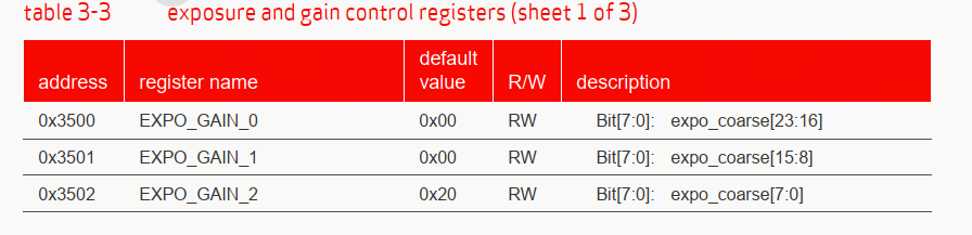

aexp_line_control
aexp_line_control这个函数是主要实现了曝光的控制,主要负责:
  1. 接收ISP 3A算法计算的下发的曝光的行数
  2. 将曝光的行数转换为sensor寄存器值
  3. 配置通过i2c下发给sensor 曝光寄存器
  4. 这里曝光寄存器为 0x3500、0x3501、0x3502。
../../_images/screenshot-20260210-130940.png
        const uint16_t EXP_LINE0 = 0x3500;
        const uint16_t EXP_LINE1 = 0x3501;
        const uint16_t EXP_LINE2 = 0x3502;
        if (mode == NORMAL_M) {
                uint32_t sline = line[0];
                if (sline > 2314) sline = 2314;
                if (sline < 8) sline = 8;
                temp0 = (sline >> 16) & 0xFF;
                vin_i2c_write8(info->bus_num, 16, info->sensor_addr, EXP_LINE0, temp0);
                temp1 = (sline >> 8) & 0x0F;
                vin_i2c_write8(info->bus_num, 16, info->sensor_addr, EXP_LINE1, temp1);
                temp2 = (sline) & 0xFF;
                vin_i2c_write8(info->bus_num, 16, info->sensor_addr, EXP_LINE2, temp2);
        } else {
        return 0;

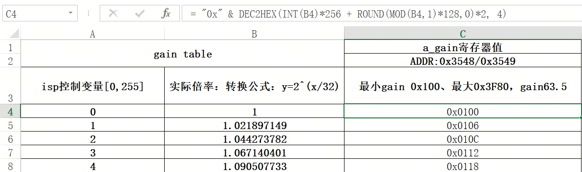

对于 OmniVision 的sensor gain控制一般以整数+小数线性组合,以 os08c10 为例,需要根据增益倍数推导寄存器值计算公式,具体方式如下:
参考文档和gain_table.xlsx:
../../_images/screenshot-20260116-103406.png
../../_images/screenshot-20260116-103426.png
../../_images/screenshot-20260116-103530.png
= "0x" & DEC2HEX(INT(B4)*256 + ROUND(MOD(B4,1)*128,0)*2, 4)
公式解释:
INT(B4):获取整数部分
MOD(B4,1):获取小数部分(等价于 B4-INT(B4))
*128:转换为 1/128 单位
ROUND(...,0):四舍五入到整数
*2:左移1位(因为要放在高7位)
*256:整数部分移到高字节
DEC2HEX(...,4):转换为4位十六进制
