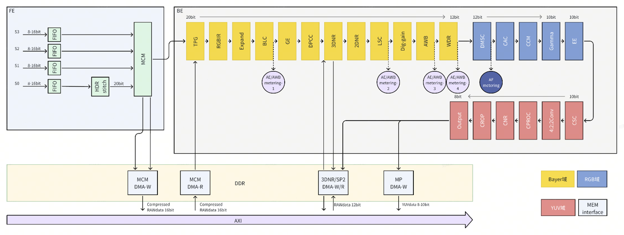

ISP Pipeline
../../../_images/image21.png
Figure 1.2‑1 Algorithm Module Flowchart
In the diagram, modules with yellow backgrounds represent processing in the RAW domain, those with red backgrounds represent processing in the RGB domain, those with blue backgrounds represent processing in the YUV domain, and light purple sections represent AE/AWB statistical calculations. The four positions indicated by dashed lines are optional statistical locations for AE/AWB, which can be switched according to actual needs.

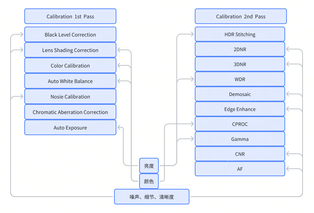

The ISP parameter calibration process mainly consists of three phases:
  • Phase 1: Confirm that the CMOS sensor can be correctly initialized to obtain accurate RAW information and perform characteristic parameter configuration;
  • Phase 2: Optimize and debug ISP-related algorithm modules based on sensor characteristics;
  • Phase 3: Systematic testing and evaluation, comprehensive system-level debugging to meet image quality requirements across various scenarios.

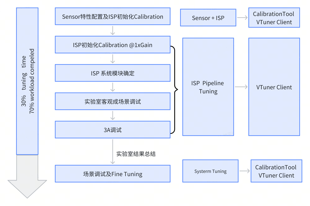

Figure 2.1-1 shows the flowchart of the three debugging phases.
../../../_images/image38.png
Figure 2.1‑1 ISP Tuning Process

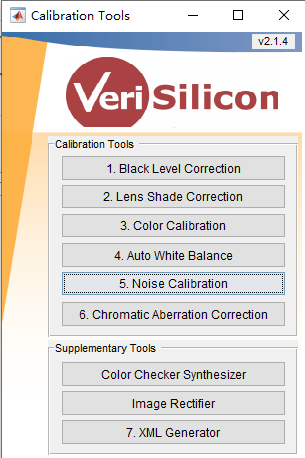

Tuning Tools (Calibration Tool/VTunerClient)
Horizon X5 ISP uses two tools to assist in effect debugging: static calibration tool Calibration Tool and dynamic debugging tool VTunerClient.
Calibration Tool
The Calibration Tool is used to generate a static calibration file, which is needed during parameter integration and is generally named sensorName.json or sensorName.xml. This file contains tuning parameters related to the lens and sensor, such as black level, shading lookup tables, and parameters open for tuning in the AWB algorithm.
The primary goal of Phase 1 tuning is to calibrate and obtain the static calibration file using the Calibration Tool. This tool may also be used in later phases to correct previous calibration errors or issues.
../../../_images/image52.png
Figure 2.2‑1 Calibration Tool Main Interface
When using the Calibration Tool, modules can be calibrated sequentially according to the numbers on the interface, or individual modules can be run separately for parameter calibration. After calibration, the corresponding static calibration file is generated via XML Generator.

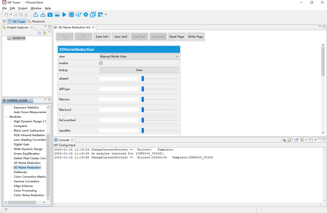

VTunerClient
VTunerClient can be used to modify effect parameters of each module, with the effect changes displayed in real-time on the frame shown by the Hobotplayer tool. On the VTunerClient debugging interface, effect parameters are categorized by functional modules, allowing parameter modifications within the corresponding module. After importing the effect file calibrated by the Calibration Tool, VTunerClient adjusts the parameters of the corresponding modules. After debugging, the current debugging parameters can be saved as a .json file. The VTunerClient interface is shown in Figure 2.2‑2.
../../../_images/image610.png
Figure 2.2‑2 VTunerClient Debugging Interface

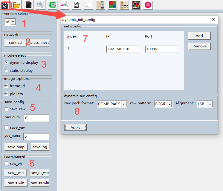

Hobotplayer
Hobotplayer is a tool for real-time display of device frame, also used to save image data in different formats such as RAW, YUV, BMP, JPG. The Hobotplayer interface is shown in Figure 2.2‑3, with page parameter descriptions in Table 2.2-2. After setting the correct device IP and port in Init_config, click the connect button in the left function panel to view the data stream. To dump raw data, check raw_en, enter a natural number greater than 0 in the raw_num field, then check the save_raw box.
../../../_images/image710.png
Figure 2.2‑3 Hobotplayer Interface
Module Function Description
version select (part 1 in Figure 2.2 3) Select platform Select corresponding platform
network (part 2 in Figure 2.2 3) Network connect/disconnect -
mode-select (part 3 in Figure 2.2 3) Switch between network transmission/static display Select dynamic-display for real-time data stream, select static-display to open static data
image-options (part 4 in Figure 2.2 3) Display image information and frame number -
save-config (part 5 in Figure 2.2 3) Save raw or yuv Enter a number in the raw_num/yuv_num field first, then check save_raw/save_yuv to save
raw-channel (part 6 in Figure 2.2 3) Display raw image by channel Raw image can be seen after checking raw_en, usually using raw_l_win
init_config (part 7 in Figure 2.2 3) Configure network and port number Development board network IP
Apply (part 8 in Figure 2.2 3) Confirm configuration -
Table 2.2‑2 Hobotplayer Initial Configuration Interface Description

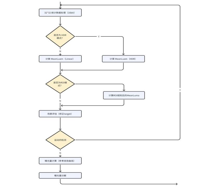

The following figure shows the AE processing flowchart:
../../../_images/image8.jpeg
Figure 3.1‑1 AE Processing Flowchart

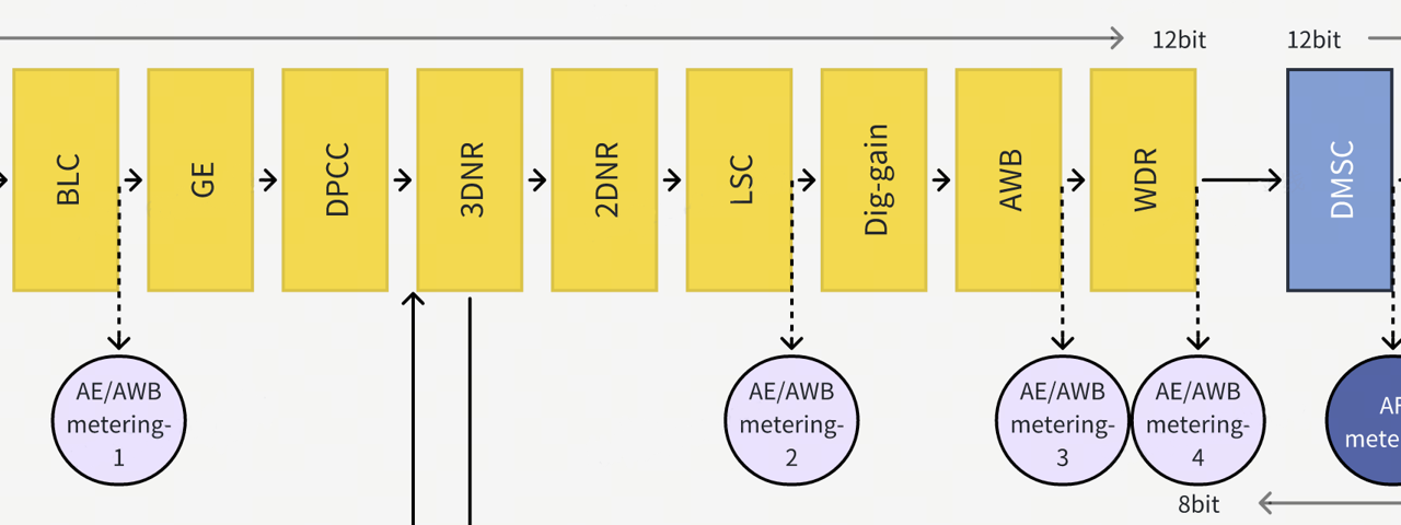

There are four statistical positions for AE in the pipeline, as shown in Figure 3.1-2.
../../../_images/image910.png
Figure 3.1‑2 AE Statistical Data Nodes

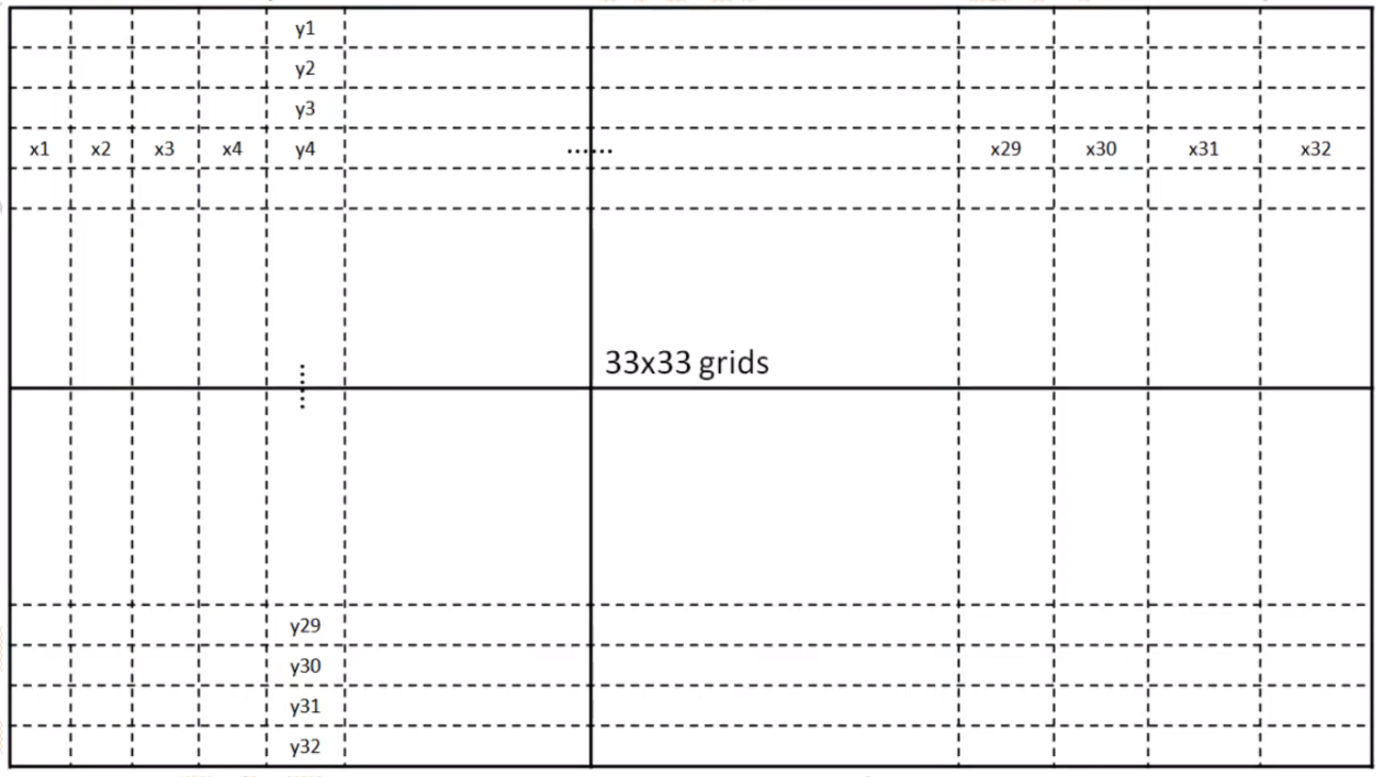

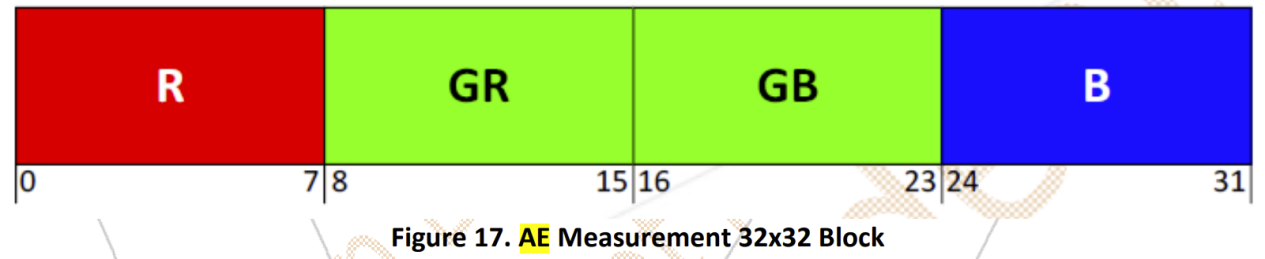

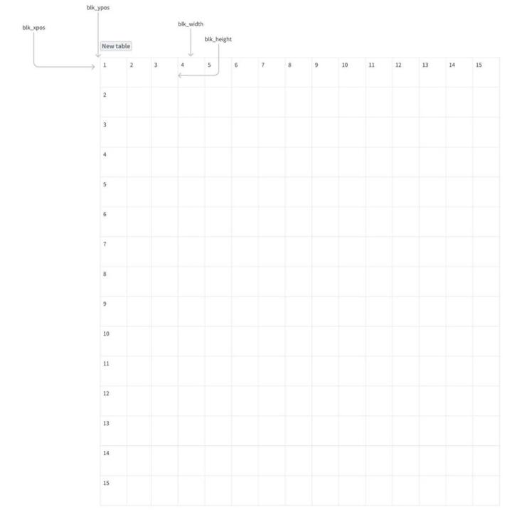

The general statistical module for ISP auto-exposure control divides the entire image into 32×32 blocks and calculates the average value for each channel (R, GR, GB, B). These averages are output as statistical data used to implement auto-exposure.
For each sub-block within the 32×32 statistical array, one 32-bit statistical data is output, containing average values for R, GR, GB, and B channels. The data structure of the statistical data is shown below. For HDR mode sensors, during statistical data processing, each block’s luminance value is multiplied by the HDR ratio.
../../../_images/image101.png
Figure 3.1‑3 AE/AWB Statistical Data Storage Format

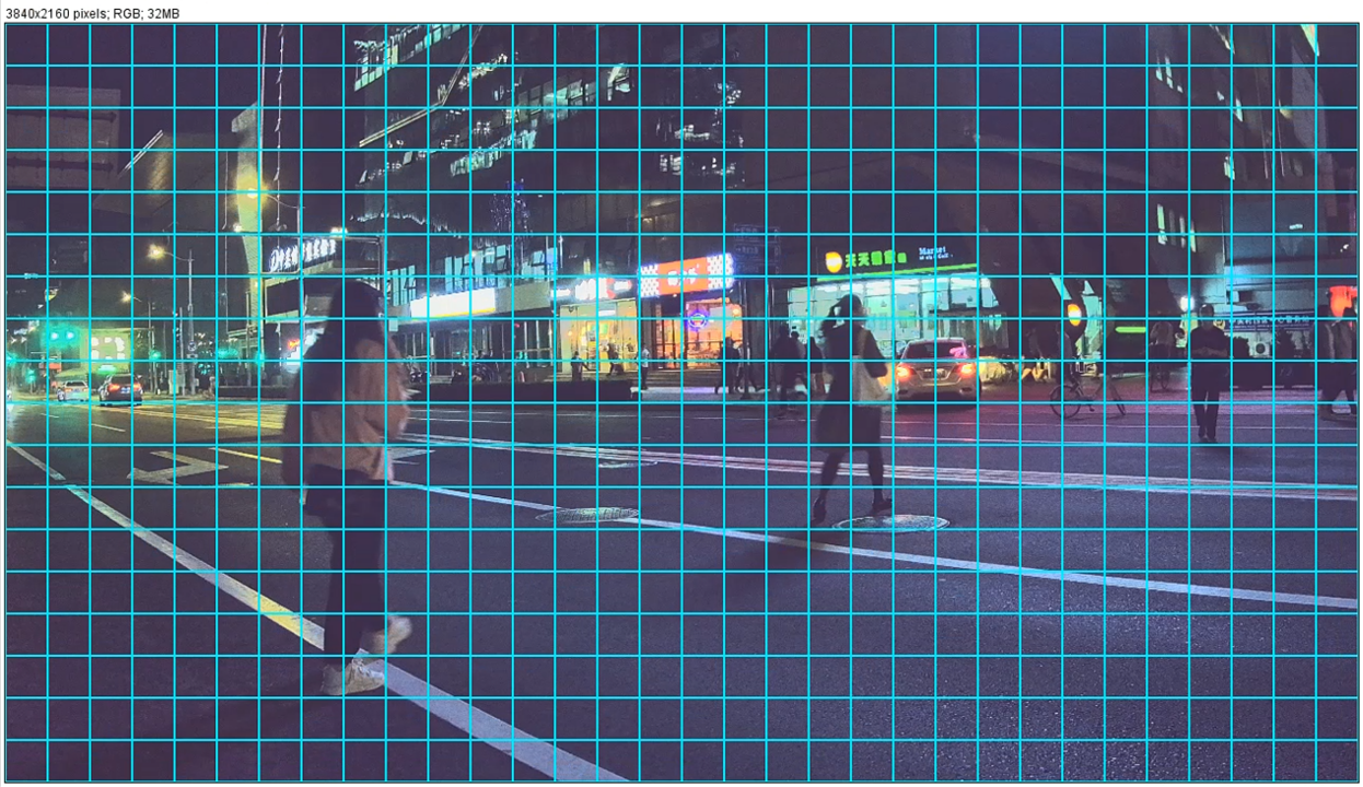

Taking a 3840x2160 resolution image in linear mode as an example, the distribution of 32×32 windows in the image is shown below:
../../../_images/image11.png

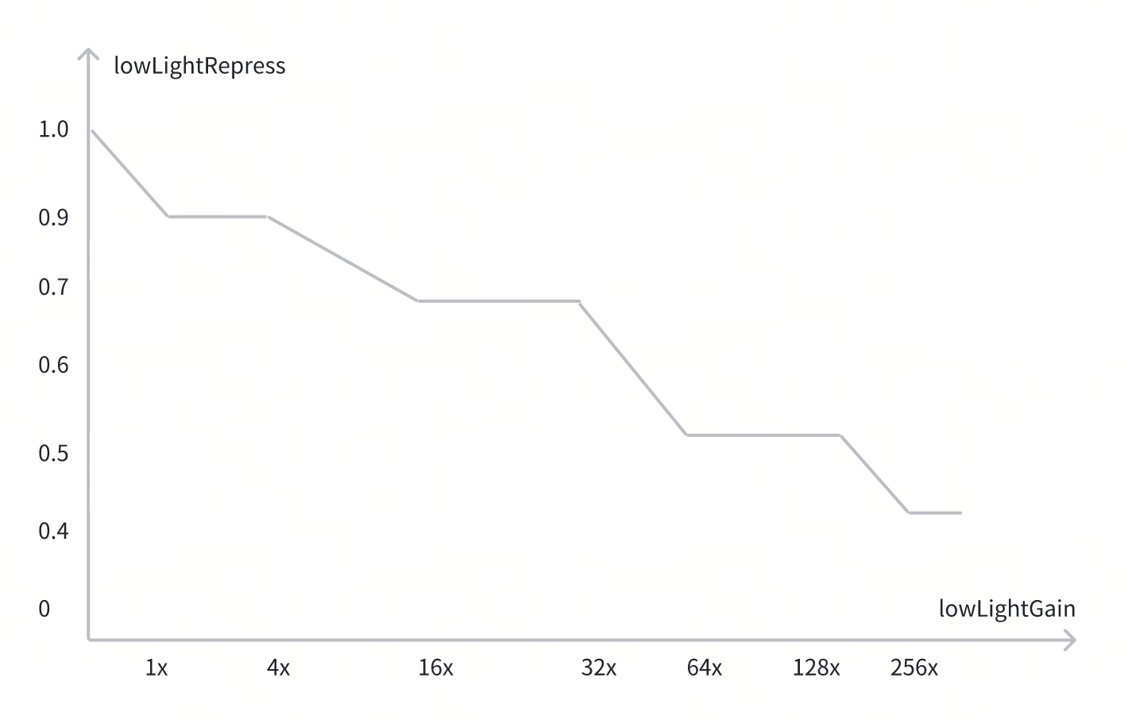

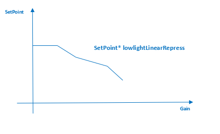

Low-Light Scene Compensation
The current frame’s low-light level depends on the frame’s exposure. The greater the exposure, the darker the illumination conditions, and the more the setpoint needs to be compressed.
Photos taken under low-light conditions often have more noise. If the setpoint is too large, the AE-adjusted image will be brighter, and noise will be amplified. Therefore, for lower ambient brightness, the setpoint should be appropriately compressed. AE supports dynamically adjusting the convergence target value in HDR/Linear modes under dark conditions to optimize image performance. The debugging methods for both modes are similar. The form of AE convergence target value changes under dark conditions after dynamic adjustment is shown in the figure below (using Linear mode as an example).
../../../_images/image122.png

../../../_images/image135.png
Figure 3.1‑5 Relationship between target value in low-light scenes and Gain

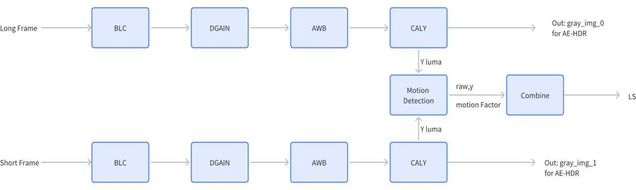

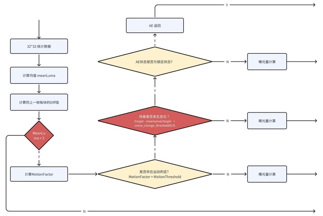

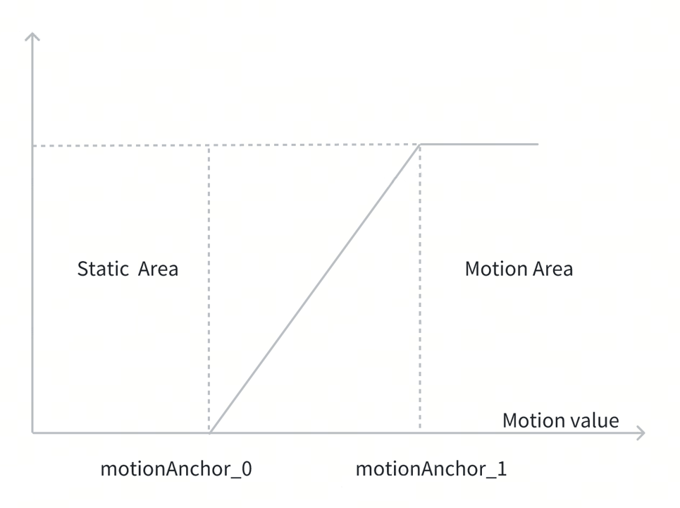

Motion Detection
Motion detection is an important function in the auto-exposure (AE) algorithm, especially when there are drastic changes in ambient brightness or rapid camera movement, to prevent exposure jitter caused by overly rapid environmental changes. The specific process is as follows:
  • When ambient brightness or camera position changes rapidly, if the system detects that the brightness change between consecutive frames exceeds a preset threshold (motionThreshold), it judges that the scene is changing rapidly, and AE enters a “lock” state, temporarily locking the current exposure settings.
  • Once the environment stabilizes, AE exits the “lock” state and resumes adaptive exposure adjustment to adapt to the new ambient brightness.
Users can adjust parameters of the AE algorithm according to their needs, such as adjusting the sensitivity of exposure lock or the speed of exposure adjustment. The AE motion detection processing flow is shown in the figure below.
../../../_images/image15.jpeg
Figure 3.1‑7 AE Motion Detection Processing Flow
Key parameters for AE motion detection are listed in the table below, Table 3.1-7.
Parameter Type Range Description Default Value
motionFilter Float (0,1) The damping factor when calculating motion vectors. The larger the value is, the more likely the current frame is considered to be in motion. This parameter controls the cumulative calculation of motion vectors. A greater value of motionFilter means the change of motion vectors is smoother but less timely updated. This may result in the case where the motion amplitude of the current frame is significant, but is not detected by the motion detection functionality. 0.5
motionThreshold Float (0,1) The threshold for determining whether the system is in motion. When the motion vector exceeds this threshold, the current frame is considered to be in motion. This parameter determines the sensitivity of motion detection. You can reduce its value to improve the sensitivity. A more sensitive motion detection means that even slight movement of objects in the image during exposure time will be considered as motion. 0.7
Table 3.1‑7 AE Motion Detection Control Parameters

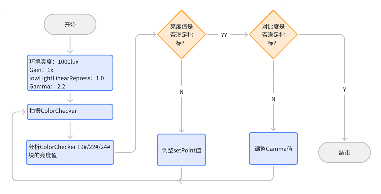

Tuning Procedure
The tuning procedure is illustrated in Figure 3.1‑5:
../../../_images/image161.png
Figure 3.1‑8 Flowchart of AE Phase Two

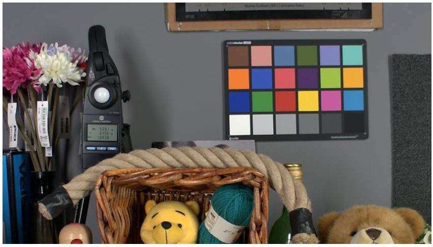

Check the initial AE performance in a laboratory environment. Place a ColorChecker chart under 1500 lux illumination, ensuring that the ColorChecker occupies 30% ~ 50% of the image (as shown below). Capture an image and analyze the grayscale values using Imatest’s ColorChecker function, or manually analyze the grayscale patches using Adobe Photoshop or GIMP.
../../../_images/image171.png
Figure 3.1‑9 ColorChecker Coverage

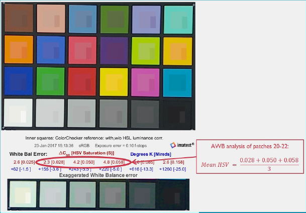

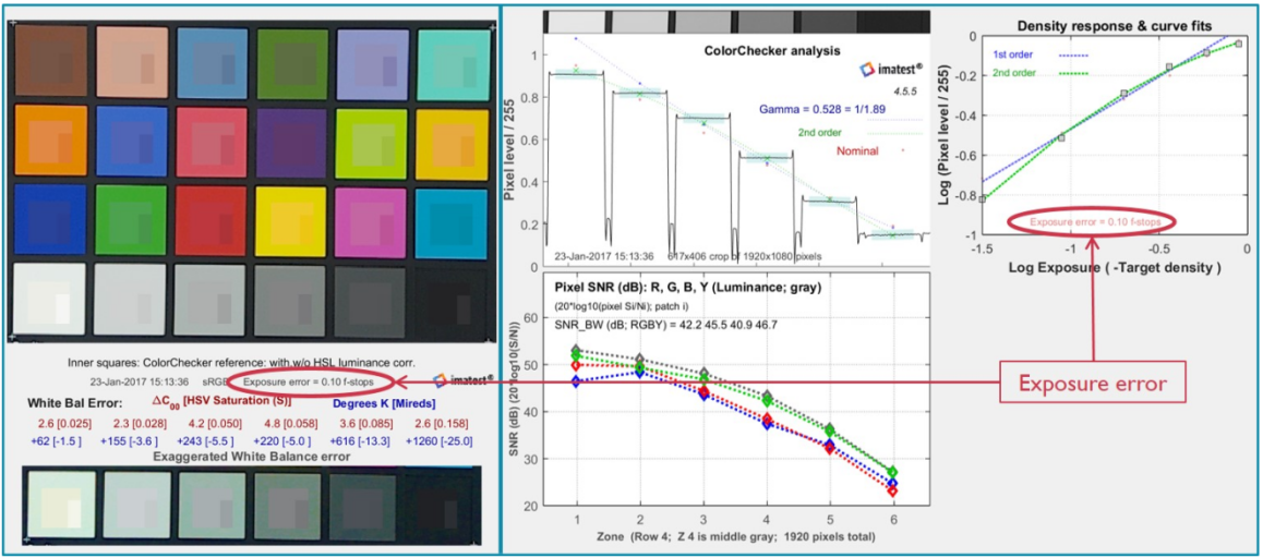

  • Analysis using Imatest:
Imatest outputs measurement metrics such as exposure error, density response, and curve fit. f-stop values within the range of -0.25 to 0.25 are acceptable. It is recommended that the measured f-stop value falls between -0.1 and 0.
../../../_images/image18.png
Figure 3.1‑10 Exposure Measurement Metrics

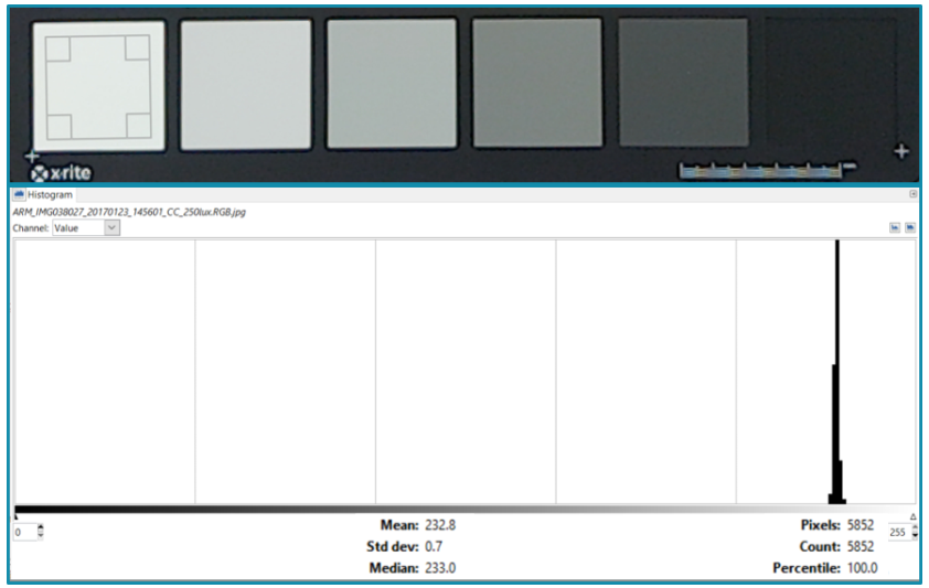

  • Analysis using Photoshop or GIMP:
Use the ROI selection tool to select a portion of each gray patch on the ColorChecker. After defining the region for each patch, use the intensity/luminance histogram to calculate the mean pixel value of the selected area.
../../../_images/image191.png
Figure 3.1‑11 Measurement of Gray Patch Pixel Mean
For an 8-bit histogram, the acceptable range of mean pixel values for each gray patch is shown in the following table. Generally, it is desirable for the measured average gray patch pixel value to be within ±10 of the ideal value. Ideally, the image should be slightly underexposed, with a deviation from the ideal value between -5 and 0.
Patch Number Ideal Value Minimum Maximum
19 240 230 250
22 122 112 132
24 40 30 50
Table 3.1‑11 Recommended Values for ColorChecker Gray Patches
Note: Patch 22 represents the value of 18% gray.

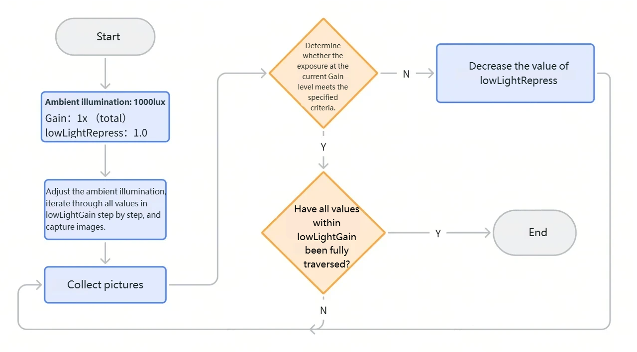

Fine tuning AE phase three
Subjective Tuning in Real-Scene Laboratory Environment
After completing phase one and phase two AE tuning, subjective tuning for phase three can be conducted in a real-scene light box environment. During this phase, exposure can be increased or decreased based on requirements or preferences. The primary goal is to realistically reproduce real-world scenes and improve the subjective quality of output images. Under low-light conditions, balancing clarity and noise becomes especially critical. AE tuning should be application-driven, as the entire camera system must align with practical usage scenarios—mobile phones, surveillance, and industrial cameras each have unique requirements.
Phase three tuning mainly involves two LUTs: LowLightLinearGain and LowLightLinearRepress. These two LUTs enable dynamic adjustment of the AE target brightness under different illumination levels. The main tuning procedure is shown in Figure 3.1‑9.
../../../_images/image201.png
Figure 3.1‑12 AE Phase Three Tuning Flow
First, conduct validation testing in a real-scene light box. The light box should simulate real environments as closely as possible and include image test charts, objects with various colors, and different textures. Brightness can be controlled using adjustable light sources, covering a wide illumination range, typically categorized into high brightness (above 3000 lux), medium brightness (100–3000 lux), and low brightness (0–100 lux). At each brightness level, capture images and analyze the current exposure using tools from phase two (Imatest, Photoshop, and GIMP) to confirm whether the exposure falls within the acceptable range.
Seven nodes were created to define different illumination ranges, but this is insufficient. Further validation of AE performance across various illumination levels is required. For each illumination level, use Imatest/Photoshop/GIMP to analyze the luminance values of each gray patch. If values still fall outside the desired exposure range during testing, repeat the calibration steps. During optimization, it is impossible to satisfy all scenarios simultaneously, and parameter or node overlap and conflicts may occur. In such cases, trade-offs must be made based on specific requirements.
Note: When adjusting AE parameters, to avoid altering previously calibrated lookup table entries, adjustments should be made incrementally (by illumination level or gain step). In phase three, tuning should begin with the lowest system gain settings affecting all related parameters, not just the AE module. Then, incrementally increase the gain and adjust all related system parameters accordingly.

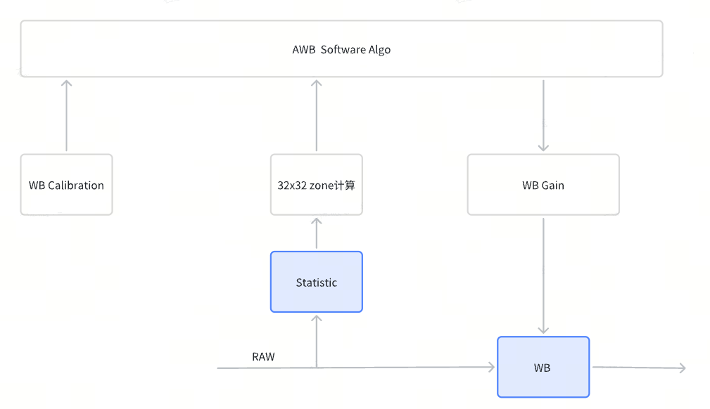

The Auto-White Balance (AWB) module automatically adjusts the image’s white balance. AWB operates in the RAW domain. When enabled, the ISP hardware divides the frame into 32×32 blocks. The AWB algorithm calculates corresponding Rgain and Bgain values based on hardware statistics, forming a calibrated color temperature curve from the 32×32 block data. The AWB algorithm assumes the presence of “near-white” pixels in the image. It measures the distance between each block’s (R_Gain, B_Gain) and calibrated light source points. The two closest light sources are selected as primary and secondary sources. Block weights are then determined. Finally, the overall AWB gain is the weighted average of R and B gains across all blocks.
The AWB system block diagram is shown below:
../../../_images/image211.png
Figure 3.2‑1 AWB Processing Flow

Statistics
The AWB Statistics module divides the entire frame into 32×32 sub-blocks and computes the average values of R, Gr, Gb, and B Bayer pixels in each block. The RAW data source can be set to one of the following: Expand, LSC, AWB Gain, or WDR.
Figure 3.2‑2 AWB Statistics Node

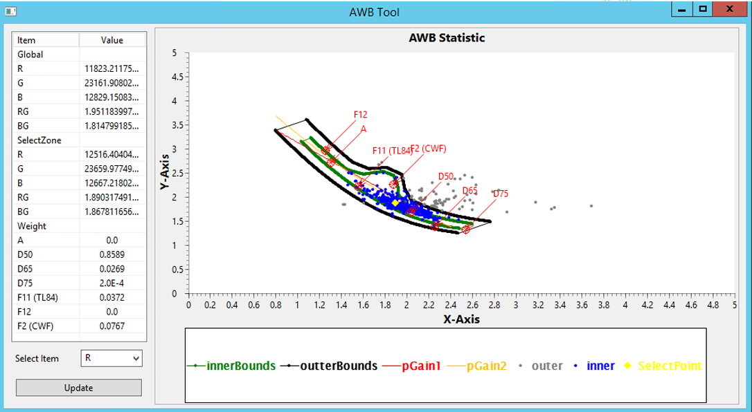

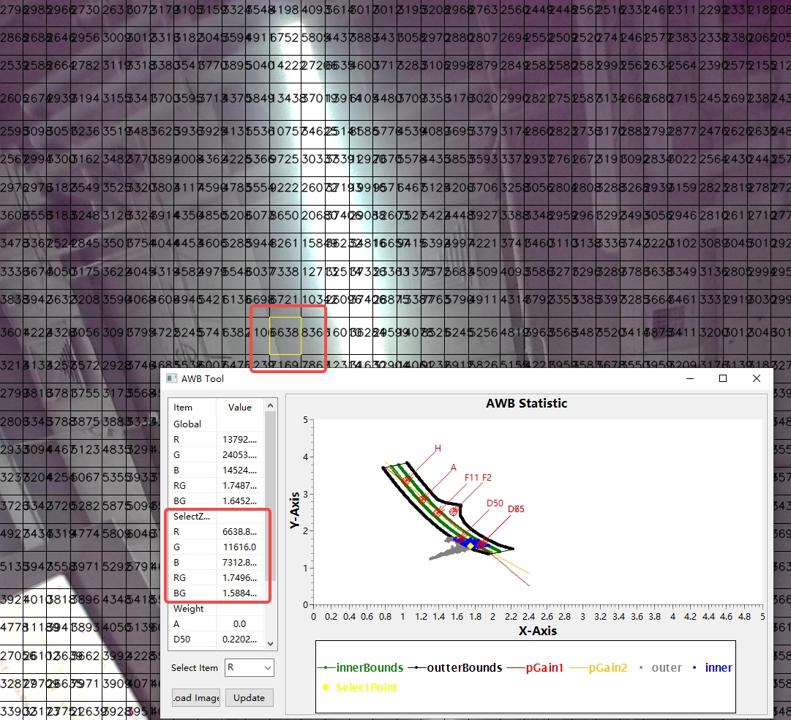

  1. In a scene with color cast issues, capture a BMP/JPG image using hobotplayer.
  2. Keep the shooting position unchanged, open the AWB tool in vtuner, and click the Load Image button to import the captured BMP/JPG image.
  3. In the AWB tool window, click on the solid-color region in the image. The corresponding statistical point will appear on the AWB scatter plot (see yellow point in figure below). The Rgain/Bgain values of the point will be displayed on the left side of the AWB tool.
  4. Set confoundPositionCustom:confoundPositionEnable to true, input the Rgain/Bgain values of the solid-color region into confoundPositionCustom:rg/bg, initially set confoundPositionCustom:weight to 0, and adjust confoundPositionCustom:threshold while observing white balance recovery. Be careful not to cover standard light source calibration points, which could affect normal scene WB. A value less than 0.5 is generally recommended. If correction is too strong, slightly increase weight or decrease threshold to normalize WB.
  5. If WB is not fully corrected, subtract multiple statistical points by repeating step 4 until all necessary regions are covered.
    20240904-151916
Figure 3.2‑3 Obtaining Statistical Point Data via AWB Tool

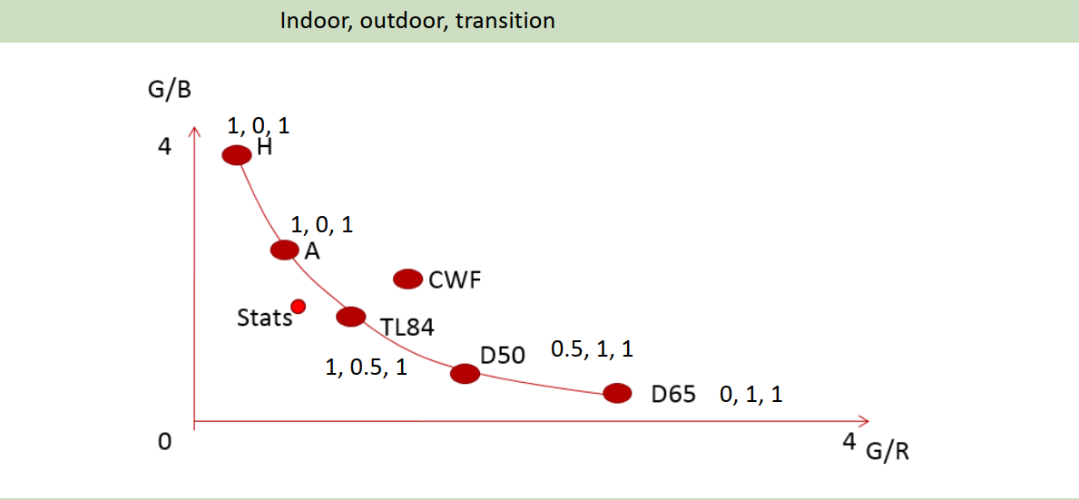

Light Source Probability
Light source probability assigns 18 exposure levels (represented as gain multiples) to each light source (D65, D50, D75, CWF, TL84, A, or F12), stored in the 18 elements of the brightnessLevel[18] array in ascending order. Each light source has a probability at each exposure level, which affects the weight of the block’s R and B gains.
The light source order corresponds to the color temperature order during AWB calibration. To adjust the probability of a light source within a specific exposure range, first locate the corresponding group of probability parameters based on the light source order in the calibration file exported by the Calibration Tool, then modify the weight value for the desired exposure range. A higher weight increases the contribution of that light source’s (R_Gain, B_Gain) values in AWB statistics under that brightness level.
Relevant parameters are listed in the table below.
lightWeightLevelEnable bool {true, false} Whether to enable light source probability to adjust the weights of (R_Gain, B_Gain) values of image blocks under different light sources based on current frame brightness. Set to true to enable. false
brightnessLevel float[18] [0, 17] Exposure values of a light source. Array index represents exposure level. 1
weight float[18] [0, 17] Light source probability. Increasing the j-th element (j = 0 to 17) in a light source’s weight array effectively increases the likelihood of detecting that source at brightnesslevel[j]. 1
Table 3.2‑4 Light Source Probability Parameters

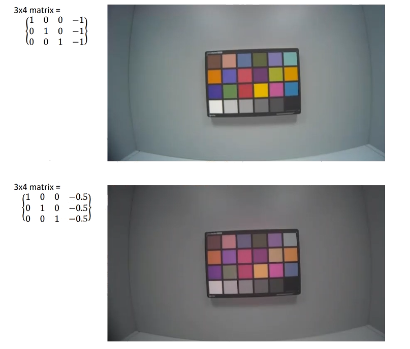

useCcoffset bool {true, false} Whether to add offsets to the color correction matrix (CCM). true
useCcmatrix bool {true, false} Whether to use CCM for further color correction. true

Tuning during phase one
Pre-tuning Preparation
Parameter name Description
Black level Tuned
Lens shading Tuned
CCM Tuned
GAMMA Tuned
Manual exposure -0.25 < exposure error < 0.25 (f-stops). Can be verified via Imatest.
Table 3.2‑11 AWB Phase One Preparation Conditions
Calibration images
Figure 3.2‑4 AWB Calibration Backboard Image
The CalibrationTool is used to collect RAW data of ColorChecker and light box walls under standard light boxes with different color temperatures for WB calibration. Refer to the “X5-Calibration Tool User Guide” for detailed calibration procedures. Calibration calculations on RAW images at different color temperatures are used to calibrate the Planckian curve.
Capture RAW data of gray cards or light box walls under as many color temperatures as possible, as listed in the table below. D50 and CWF sources are essential, and at least five light sources should be included to ensure algorithm coverage across more scenes.
Note: Use a color meter (e.g., Minolta CL-200A) to record color temperature values when capturing RAW data.

Tuning verification using Imatest
Run the ColorChecker image using the Colorcheck option in Imatest. This generates a series of color charts for analysis. Extract the HSV (Hue, Saturation, Value) of patches 20–22 and compute their average.
Additionally, refer to the numerical values to assess AWB performance. Final results depend on image sensor quality and customer requirements.
../../../_images/image241.png
Figure 3.2‑5 Imatest Color Analysis Window
AWB quality 6,500K (HSV) 4,000K (HSV) 2,700K (HSV)
Great <0.025 <0.035 <0.030
Good 0.025–0.050 0.035–0.060 0.030–0.065
Fair 0.050–0.100 0.060–0.110 0.065–0.160
Poor >0.100 >0.110 >0.160
Table 3.2‑13 AWB HSV Data Reference

During gain compensation, the AWB algorithm generates a gain value for each color channel to render gray objects as neutral gray. Before final AWB application, the preference gain module can adjust the final compensation gains to achieve better or subjectively preferred color tints. Each channel uses an 8-bit precision gain value, and three CCT values are used to divide the color temperature range. Default gain is 256 for all color temperatures.
Temperature Weight
In AWB parameter configuration, custom weights can be assigned to different color temperatures. The figure below shows an example of weight settings.
Figure 3.2‑6 AWB Color Temperature Weight Settings
AWB verify
Refer to the “VTunerTool User Manual” for instructions on verifying image white balance performance using calibrated AWB data.
../../../_images/image262.png
Figure 3.2‑7 AWB Verify Example

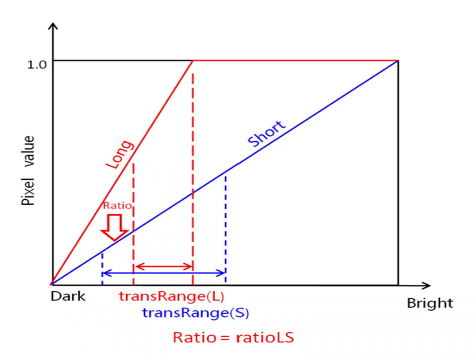

In HDR Stitch linear mode, the long exposure frame can be combined into the short exposure frame, or vice versa.
For example, a base frame is called Fbase, and an exposure frame to be combined is called Fin. Fbase and Fin are combined using a weighting factor W and exposure ratio R, calculated as follows:
image-20240905205937117
In dual-frame HDR fusion, two different combination modes exist, reflected in two different configurations in actual combine parameters.
Linear Combination
In linear mode, the longer exposure can be merged into the shorter one, or vice versa. For convenience, assume the base frame is B and the exposure frame to be merged is E. Two important parameters affect the result: ratio and transmission range. If Deghost is enabled, Motion_factor is added. The ratio multiplies E; if B is the shorter frame, the ratio is less than 1 (represented as 12-bit fractional). Otherwise, it is an 8-bit integer with 4-bit fractional part.
Non-linear Combination
Used when merging short exposure into long exposure data, especially when there is a large sensitivity gap. Short exposure noise is high, and saturation levels cannot be mixed on a linear scale.
../../../_images/image281.png
Figure 3.3‑2 HDR Combine Processing Illustration
The following table explains HDR Combine parameters.
bypassSelect int [0,2] 0: outputs only long frames. 1: outputs only short frames. 2: outputs only very short frames. 0
colorWeight int[3] [0,255] The color weights, in format [stitchColorWeight0, stitchColorWeight1, stitchColorWeight2] where: l stitchColorWeight0: the weight for the channel with the greatest value l stitchColorWeight1: the weight for the channels with in-between values l stitchColorWeight2: the weight for the channel with the smallest value The weights must meet the following requirement:stitchColorWeight0 + stitchColorWeight1× 2+ stitchColorWeight2= 256 The greater the stitchColorWeight0, the easier it is to combine short frames at the saturation point of the corresponding channel. If the short-frame noise is very large, stitchColorWeight0 can be reduced and the other weights can be increased. For noise reduction, this parameter has a lower priority than transRange. [255,0,1]
stitchingMode int [0,1] 0: linear stitching mode. 1: non-linear stitching mode. 0
baseFrame int [0,1] 0: based on S frames. 1: based on L frames. 0
ratio float[2] [1.0,256.0] The exposure ratios, in the following format: [long/short, short/very short]. [16.0,16.0]
transRange float[4][2] [0.0,1.1] The start and end values of each composite interval, where two frames overlap. The value must be in the following format: [[L+S_ref(L)_start, L+S_ref(L)_end], [LS+VS_ref(LS)_start, LS+VS_ref(LS)_end],[L+S_ref(S)_start, L+S+ref(S)_end],[LS+VS_ref(VS)_start, LS+VS_ref(VS)_end]]. If the pixels of the reference frame are lower than the start value, the composite frame pixels are longer frames. If the pixels of the reference frame are higher than the end value, the composite frame pixels are short frames. If the pixels of the reference frame are within the interval, the composite frame pixels are a fusion of the long and short frames. [[0.2, 0.9], [0.0, 0.9], [0.95, 1.0], [0, 0.1]]
Table 3.3‑3 HDR Combine Parameter Description

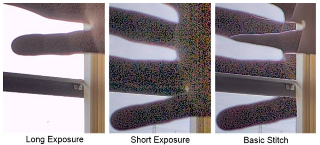

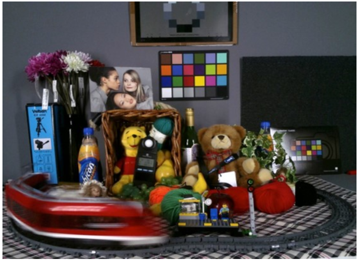

Since short-exposure and long-exposure frames are captured at different times, ghosting artifacts may appear in the merged image if there are moving objects in the scene. Therefore, a motion detection function is added. The motion detection should identify moving regions and replace them with short-exposure images. Because the sensor is linear, L should equal ratioLS*S; otherwise, motion artifacts may occur. The pixel motion degree is marked by Motion_factor and used in multi-exposure merging calculations.
../../../_images/image291.png
Figure 3.3‑3 Example of Motion Artifacts
The Deghost module adjusts the lower threshold and the lower threshold for dark regions based on the relationship between motionValue and motionFactor.

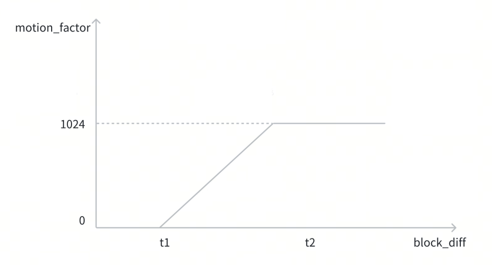

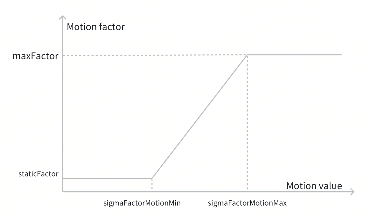

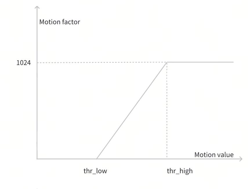

MotionDetection
The motion detection assumption is based on a linear sensor. The long frame should satisfy the criterion of ratio * short frame; otherwise, motion may exist. In the algorithm, a motion value is calculated as the difference between the long frame and ratio * short frame. Then, a normalized range defined by motion lower threshold and motion upper threshold is used to compute the motion factor, which estimates whether motion exists.
There are two criteria for determining motion:
  1. Threshold-based detection. Below the lower threshold, the value is set to 0; above the upper threshold, it is set to 1024. Areas below thr_low are considered static; areas above thr_high are considered moving.
  2. Replacement for dark regions. Some areas in the short frame may be too dark, causing deviations from the linear relationship in static regions. Or, the brightness values in very dark areas are too low to provide useful information, so even if a region is moving, short-exposure data cannot be used to replace it.
../../../_images/image301.png
Figure 3.3‑4 Motion Factor Curve

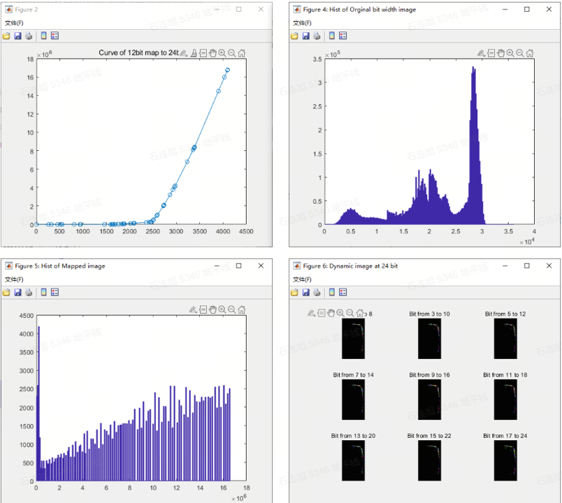

Tuning Theory
In the Expand Curve, X and Y represent the nodes of the input-output curve. Internally, these values are stored in two RAM tables, one for X and one for Y, each containing 64 entries. Each memory row can be individually addressed via the ISP_COMPAND_EXPAND_x_ADDR register, and its value can be read or written using the ISP_COMPAND_EXPAND_x_WRITE_DATA register. The table below shows example curve parameters for the compand module.
../../../_images/image311.png
Figure 3.4‑1 Compand Module Curve Diagram
Relevant tuning parameters are as follows:

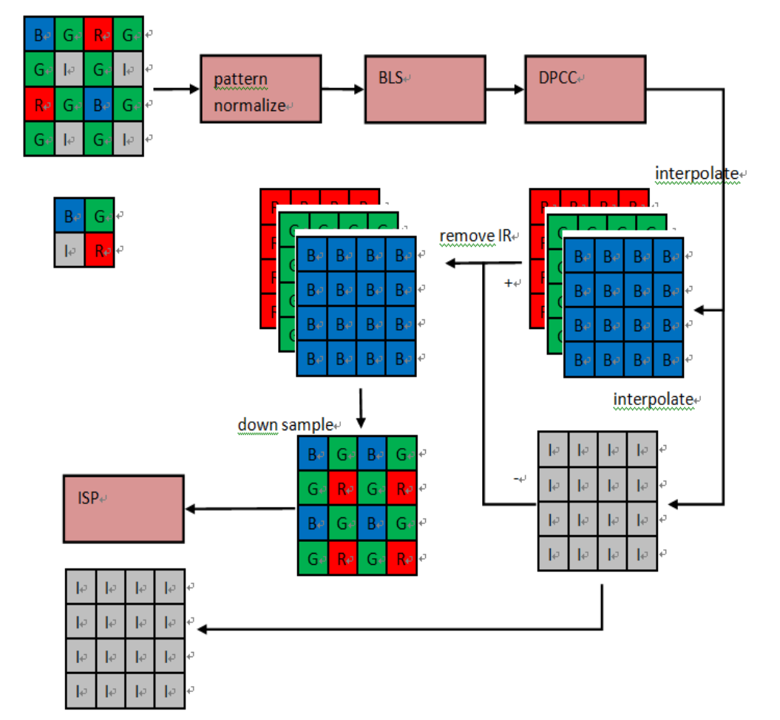

RGB Infrared Radiation
Overview
The RGBIR module processes 4x4 RGBIR data patterns. It converts RGBIR data into RGB Bayer data and IR data for subsequent ISP pipeline processing.
The tuning process is as follows:
  • Phase One: Use VTunerClient to calibrate the IR component.
  • Phase Two: Adjust the IR component subtraction ratio in highlight regions.
  • Phase Three: Adjust backend ISP pipeline module parameters, using the same method as for RGGB pattern mode.
Tuning Theory
Traditional CMOS image sensors use the Bayer pattern as the color filter array (CFA). Pixel color information is determined by specific wavelengths of light. RGB-IR technology uses an RGB-IR CFA, modifying some pixels in the Bayer format to IR pixels that only allow infrared light to pass through.
When processing RGB-IR data, the 4x4 RGBIR pattern must be restored to RGGB pattern, and the IR channel must be extracted for subsequent processing. The internal processing of the RGBIR module functions like a small pipeline, including the following functions:
  • Pattern normalization
  • Black level subtraction (BLS)
  • DPCC RGBIR (defect pixel correction)
  • Denoise and upscale IR channel to full resolution
  • Interpolate G channel to full resolution
  • Interpolate B&R channels at R&B&G positions
  • Remove IR component
  • Downsample to RGB Bayer
  • Revert to normal RGB
The RGBIR pipeline can be represented as shown in Figure 3.6‑1.
../../../_images/image321.png
Figure 3.6‑1 RGBIR Processing Flowchart
The parameters used for RGBIR pattern tuning are listed below.
enable bool {true, false} Enable the RGBIR module. false
irThreshold int [0,4095] Infrared channel de-saturation curve. 4095
lThreshold int [0,4095] Remove IR. When light > I_threshold_start, the weight curve drops, gets smaller. When light > I_threshold_end, weight = 0 4095
dpccTh[4] Int[4] [0, 65535] DPCC abs(center_pixel - avg) > th as defect point, 0~4095, 4095 as not DPCC [4095, 4095,4095, 4095]
dpccMidTh[4] Int[4] [0, 65535] FFF000 [4095, 4095,4095, 4095]
ccMatrix[12] float[12] [-4.0, 4.0] 3*4 color conversion matrix [1.0, 0.0, 0.0, 0.0, 0.0, 1.0, 0.0, 0.0, 0.0, 0.0, 1.0, 0.0]
gain[3] float[3] [0.0, 4.0] WB gain [1.0, 1.0, 1.0]
Table 3.6‑1 RGBIR Tuning Parameters

For example, the calculation for removing the IR component from the original R channel is:
image-20240905210224880
The last column of the 3x4 matrix determines the IR subtraction ratio. Different subtraction ratios result in different visual effects, as shown in Figure 3.6‑3.
../../../_images/image341.png
Figure 3.6‑3 RGBIR IR Removal Comparison with Different Configurations

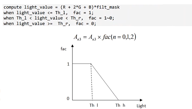

Highlight IR Desaturation
When processing color-saturated regions, such as skies or highlights, directly applying the original matrix may cause color shifts because the changes in each color channel in saturated regions are not linear.
By setting thresholds Th_l and Th_h, the system determines whether the current region is oversaturated based on brightness. The IR coefficients in the R/G/B channels of the matrix are adjusted to reduce the proportion of IR component removal, thereby weakening the IR value and avoiding issues caused by oversaturation.
The processing flow for saturated and transition regions is as follows:
../../../_images/image351.png
Figure 3.6‑4 RGBIR Highlight Processing Flowchart

To improve correction accuracy, the image is divided into 32 regions in both x and y dimensions. The figure below illustrates the lens shading correction region layout.
../../../_images/image361.png
Figure 3.7‑1 LSC Region Division
Each region’s coordinates are programmable. Additionally, the lens shading correction parameters for each region and each color component are programmable. Each coordinate applies to each color component.
Within each sector, the correction function F(x,y) is expressed as a bilinear interpolation between discrete correction values at its four edges. This interpolation is performed in real-time by hardware during image processing.

  1. Place the camera in a studio environment, preferably with gray flat areas at the corners. Ensure the current gain is 1x, which typically yields the best shading performance with minimal corner noise. Thus, shading strength can be set to maximum at this gain level. At high gain and low ambient brightness, assess corner noise and determine shading strength using the method described above.
../../../_images/image372.png
Figure 3.7‑2 ISP Gain 0, 1000 lux Scene

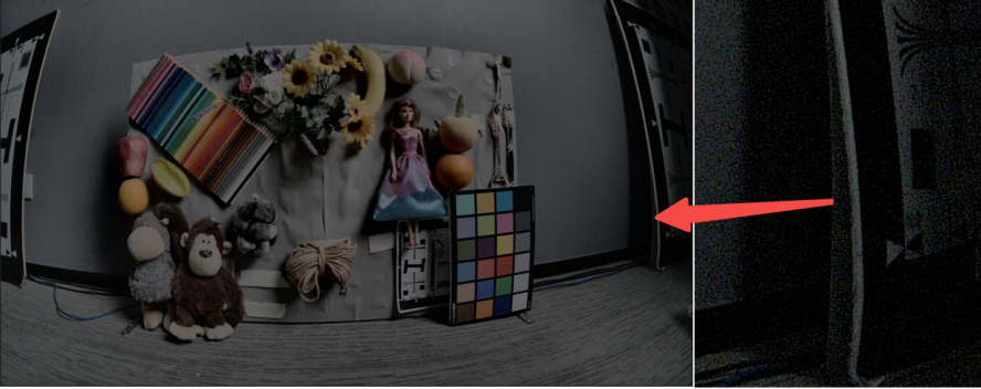

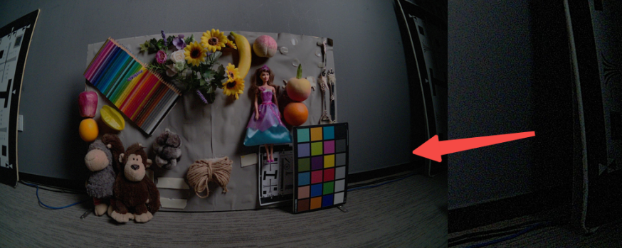

For example, in a 500 lux scene, gain is approximately 3x. At this point, noise begins to increase, so slightly reducing shading strength for gain 3 is acceptable.
../../../_images/image391.png
Figure 3.7‑4 ISP Max Gain, 20 lux – Max Strength
../../../_images/image402.png
Figure 3.7‑5 Max Gain – Low Strength
Under 20 lux low-light conditions, maximum gain is often reached. Figure 3.7‑4 shows the image with maximum shading correction strength, while Figure 3.7‑5 shows the result after appropriately reducing shading strength. Reducing shading strength reduces image noise, though corner brightness decreases slightly. However, object information in the scene remains visible. During tuning, a trade-off between corner brightness and noise performance should be made based on actual requirements to achieve optimal image quality.

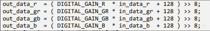

Digital Gain is primarily used to increase image brightness. The input pixel value is multiplied by the gain value to produce the Digital Gain output. Each color component of the input RGB Bayer data is multiplied by the corresponding gain value in the DIGITAL_GAIN_x register. A gain value of 256 corresponds to a factor of 1.0, so the product of the color component and gain is right-shifted by 8 bits (rounded).
Tuning Theory
Calculation method for Digital Gain:
../../../_images/image411.png
Figure 3.8‑1 Digital Gain Calculation Method

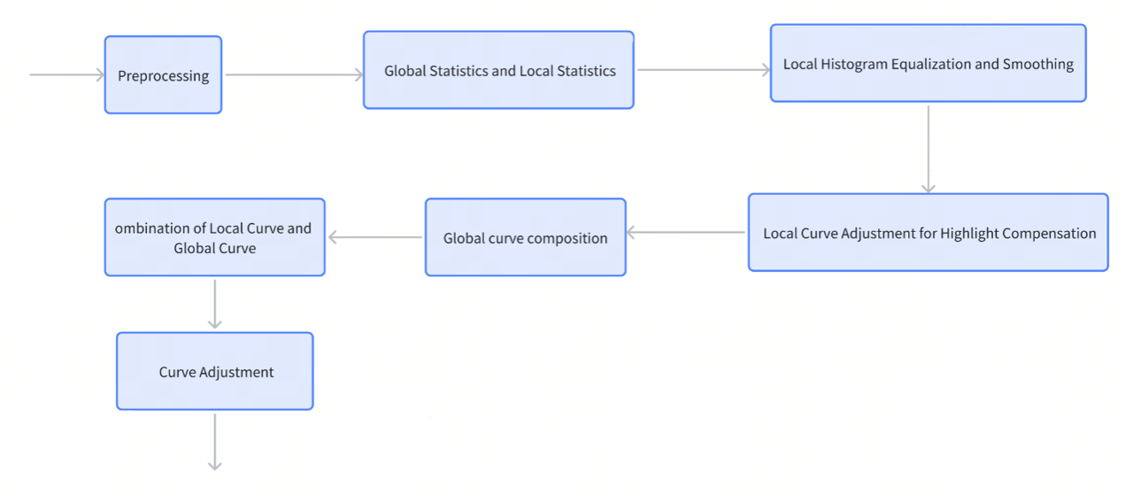

General data processing flow:
../../../_images/image421.png
Figure 3.9‑1 WDR Processing Flowchart

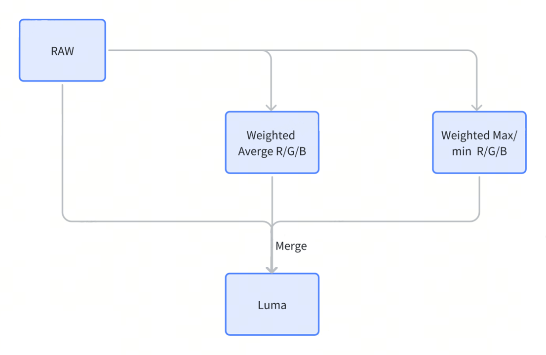

  1. Luma Value Calculation. The first step in preprocessing is calculating the luma (brightness) value. This involves the following sub-steps:
  1. Using a 3x3 pixel window, first calculate the weighted average of red (R), green (G), and blue (B) values.
  2. Calculate the weighted sum of the maximum and minimum R/G/B values.
  3. Combine the above two results with the input raw data to obtain the final luma value.
  1. Pre-Gamma Mapping. Apply pre-gamma mapping and the low_strength module to further process the luma value. Pre-Gamma LUT is a lookup table with 65 bins used to expand grayscale values, making them more dispersed and enhancing the image’s dynamic range. Low_Strength is a configurable parameter used to control brightness in dark areas. A higher value results in richer brightness information in dark regions, increasing overall brightness.

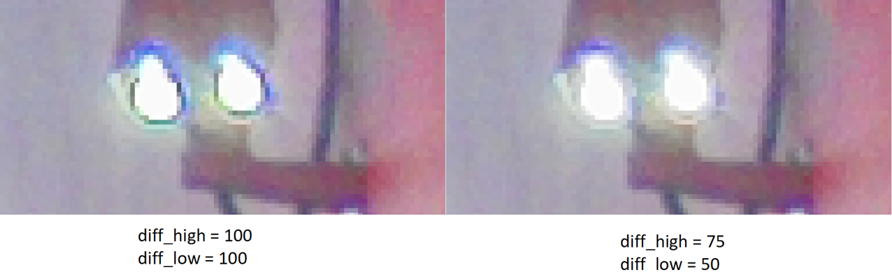

Additionally, WDR can moderately suppress high-contrast edges in the image. When edge contrast exceeds the set threshold diffHigh, the edge is softened to reduce contrast. Edges with contrast below diffLow are left unchanged. Edges with contrast between diffHigh and diffLow are interpolated and optimized.
../../../_images/image472.png
Figure 3.8‑6 WDR High-Contrast Edge Suppression
WDR curve adjustment parameters are listed in the table below:
degamma double (0,3.0] The factor of degamma curve The higher the value, the darker the image. false
maxGain int [0,128] Maximum of WDR gain 128
| minGain | int | [0,4096] | Minimum of WDR gain | 1 | | diffHigh | float | [0,100] | The threshold for detecting high contrast edges where the detected high contrast edges will become lighter in color. The higher the value, the fewer high-contrast edges are detected. | 100 | | diffLow | float | [0,100] | The threshold for detecting low contrast edges where the detected low contrast edges will become lighter in color. The higher the value, the fewer low-contrast edges are detected. | 100 | | satRange | float | [0,1] | Strength of saturation reduction | 0 | | satThrGainDown | int | [0,256] | The threshold used to determine pixels that need to be desaturated. The higher the value, the fewer dark pixels are desaturated. | 1 | | satThrGainUp | int | [0,256] | Refer to previous row. (This function can be used to reduce dark color noise and dark abnormal colors.) | 16 | | wdrRgbCoef | Int[3] | [0,128] | [weight_r, weight_g, weight_b] weight_r + weight_g + weight_b = 128 | [38,75,15] |

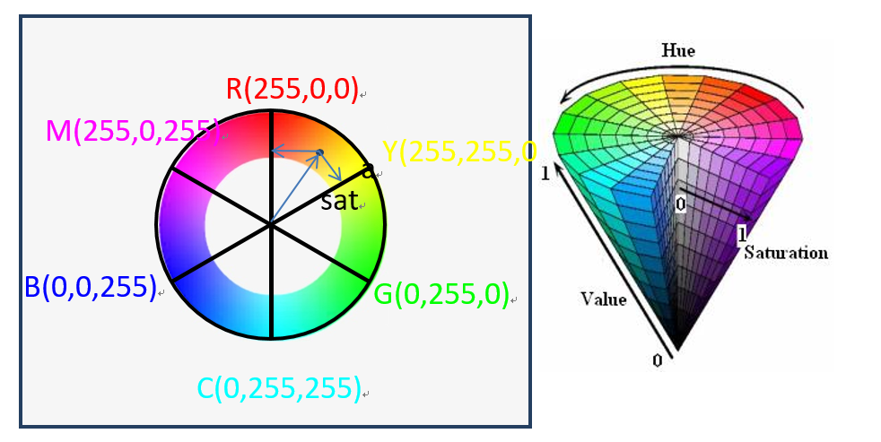

Halo Color Fading
This function operates in the HSV color space and primarily adjusts individual pixel saturation by tuning saturation thresholds and parameters for six pure colors (red, green, blue, yellow, cyan, magenta). These six pure colors divide the entire color space into six intervals. If a pixel falls within a certain interval, it will be adjusted only based on its two adjacent hue parameters. As shown in Figure 3.9‑7, only the R and Y parameters are effective at point a.
image-20240905210927110
Figure 3.9‑7 WDR Preprocessing Diagram
lightEnable int {0,1} 0: Halo color fading function disable 1: Halo color fading function enable 0
lightSatLothr int [0,255] The low threshold of the saturation. pixel_sat ≤ lothr: the pixel is at low saturation, no need to desaturate. lothr < pixel_sat ≤ hithr: transition interval pixel_sat > hithr: the pixel is at high saturation, need to desaturate. 64
lightSatHithr int [0,255] The high threshold of the saturation. 128
lightRedThrLog[4] float[4] [0.0,20.0] Red threshold, monotonically increasing Logarithmic domain (same below) [0,0,0,0]
lightGreenThrLog[4] float[4] [0.0,20.0] Green threshold, monotonically increasing [0,0,0,0]
lightBlueThrLog[4] float[4] [0.0,20.0] Blue threshold, monotonically increasing [0,0,0,0]
lightYellowThrLog[4] float[4] [0.0,20.0] Yellow threshold, monotonically increasing [0,0,0,0]
lightCyanThrLog[4] float[4] [0.0,20.0] Cyan threshold, monotonically increasing [0,0,0,0]
lightMagentaThrLog[4] float[4] [0.0,20.0] Magenta threshold, monotonically increasing [0,0,0,0]
Table 3.9‑6 WDR Halo Color Fading Tuning Parameters

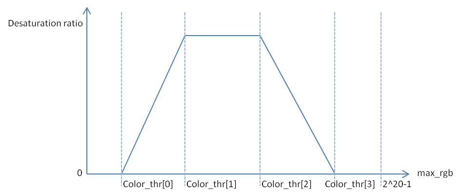

When a pixel’s saturation reaches the adjustment threshold, its adjacent pure color parameters are also considered. Each hue is divided into five segments:
  • pixel_value <= thr[0]: desaturation ratio is zero, used to protect low-saturation pixels.
  • thr[0] < pixel_value <= thr[1]: the larger the pixel value, the greater the desaturation ratio, used for transition to eliminate purple fringing.
  • thr[1] < pixel_value <= thr[2]: desaturation ratio is 1, used to reduce saturation.
  • thr[2] < pixel_value <= thr[3]: the larger the pixel value, the smaller the desaturation ratio; used to increase halo color attenuation, creating a color absorption effect.
  • pixel_value > thr[3]: desaturation ratio is zero, used to protect the color at the center of the light source.
To maintain color monotonicity, color_thr[0] and color_thr[1] are typically set to 0. However, if this function is used to reduce purple fringing, color_thr[2] and color_thr[3] should be set to the maximum value (20).
Figure 3.9‑8 WDR Highlight Color Suppression Schematic

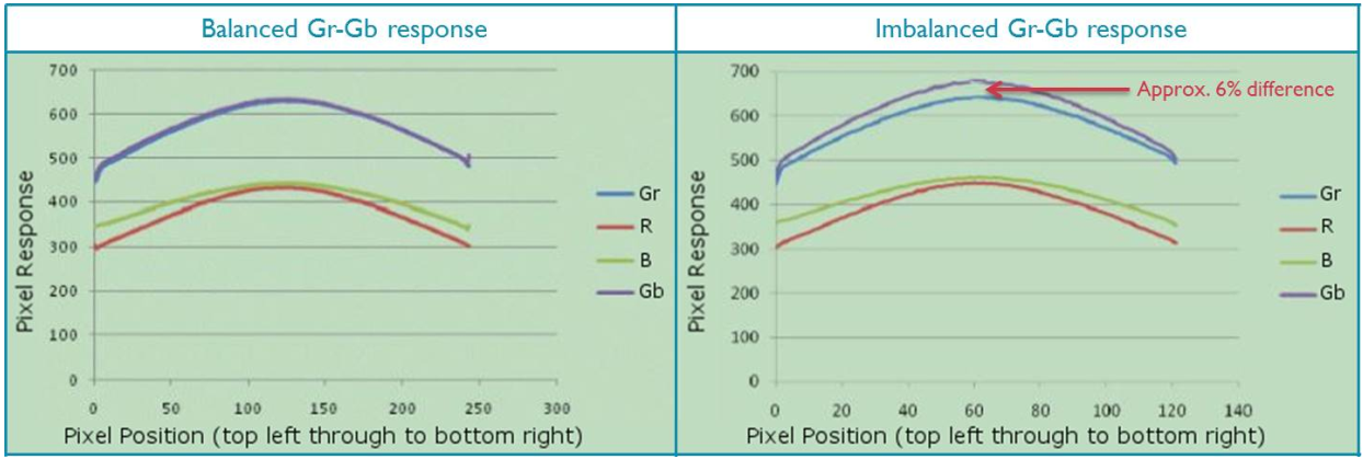

The GE module is designed to balance the differences between adjacent gr and gb pixels in the original Bayer format and correct imbalances between the two pixels. Correcting imbalances can reduce checkerboard patterns or other similar artifacts generated by the demosaic interpolation algorithm, and can also improve false color performance in the demosaic algorithm. Figure 3.10‑1 illustrates how imbalances are identified:
../../../_images/image511.png
Figure 3.10‑1 GrGb Imbalance Schematic
Modern sensors rarely exhibit Green imbalance, meaning the default Green equalization values are generally acceptable. Older or lower-quality sensors may require tuning.
Regardless, the GE module requires validation, and the process is as follows:

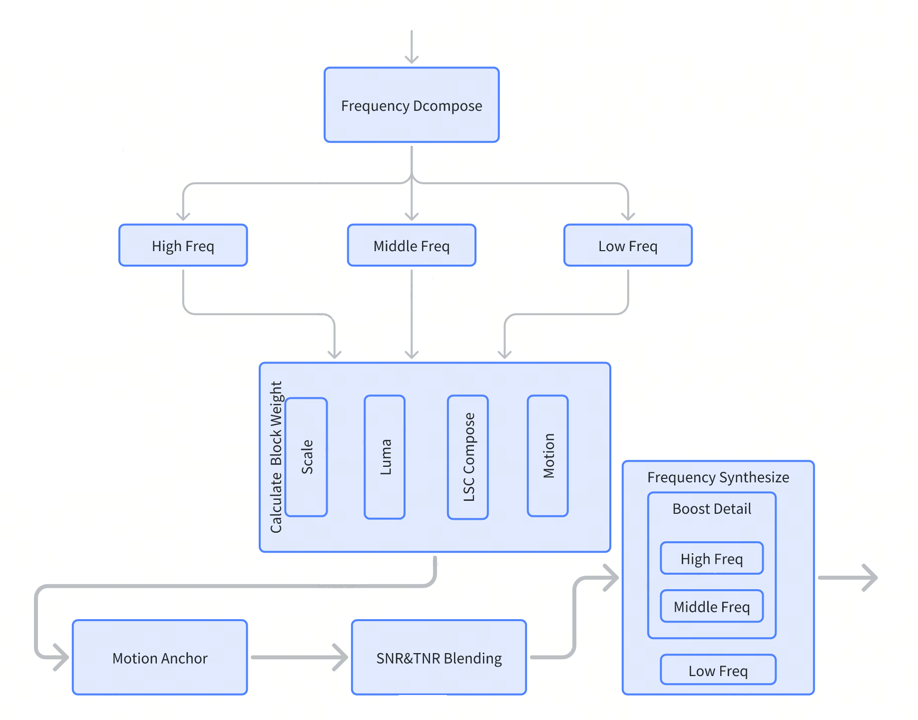

2D Noise Reduction (2DNR) module is used to reduce spatial noise in RAW images. It is a key component of the ISP, significantly improving image quality, especially for images captured under low-light conditions. The 2DNR module performs filtering at three layers — high, medium, and low — and outputs the final result.
2DNR can be divided into four main functions: filtering processing, detail enhancement, Luma control, and motion blending.
The general tuning process is as follows:
  • Phase one: no adjustment required.
  • Phase two: adjust 2DNR parameters in a real lab environment.
  • Phase three: fine-tune 2DNR parameters for different real-world scenarios to achieve optimal performance across all conditions. This phase mainly adjusts 2DNR configuration parameters under different gain values.
Tuning Theory
NLM Processing
This module uses the Non-Local Means (NLM) algorithm to search within a large search window for pixel groups with features similar to the current pixel. By computing the weighted average of these points and using a Gaussian-like weighting function to accumulate all similar pixel blocks, it effectively eliminates random noise in the original pixel blocks, thereby significantly improving the Signal-to-Noise Ratio (SNR) of the image.
During 2DNR processing, to maximize algorithm performance, the camera’s noise profile must be used. During objective calibration, the noise profile must be accurately calibrated under different gain conditions. This is crucial to ensure the algorithm can properly adjust its processing strategy according to actual noise levels to optimize image quality. Additional NR TOOL usage instructions are provided.
2DNR processing flowchart:

staticFactor[3] float[3] [0.01, 1.0] The sigma ratio of fully static regions for each layer. If this parameter is set to 0.1, it means 0.1 × moving_sigma is applied to fully static pixels. It helps keep fine details in the background. [0.1, 0.1, 0.1]
sigmaFactorMul[3] float[3] [0.1, 10.0] The factor that adjusts the decreasing speed of SNR sigma from moving to static for each layer. A greater value of this parameter leads to stronger denoising effects in previously moving regions. [1.0, 1.0, 1.0]

motionAnchorX Parameter Description:
The motionAnchorX parameter is used to distinguish whether a pixel is in a static or moving state during image enhancement (boosting). This parameter includes two key thresholds: motionAnchorX[0] and motionAnchorX[1].
../../../_images/image541.png
Figure 3.12‑2 2DNR MotionAnchor Function Schematic
When a pixel’s motion value is less than motionAnchorX[0], it is considered static. During boosting, the following static-state boosting parameters are used:
  • Static detail threshold (static detail thresh)
  • Static detail boost threshold (static detail boost thresh)
  • Static detail boost (static detail boost)
  • Static detail clip threshold (static detail clip thresh)
When a pixel’s motion value is greater than motionAnchorX[1], it is considered moving. During boosting, the following motion-state boosting parameters are used:
  • Moving detail threshold (moving detail thresh)
  • Moving detail boost threshold (moving detail boost thresh)
  • Moving detail boost (moving detail boost)
  • Moving detail clip threshold (moving detail clip thresh)
For pixels with motion values between motionAnchorX[0] and motionAnchorX[1], their threshold, boost threshold, boost, and clip threshold parameters are calculated via interpolation based on the static and motion parameter sets.

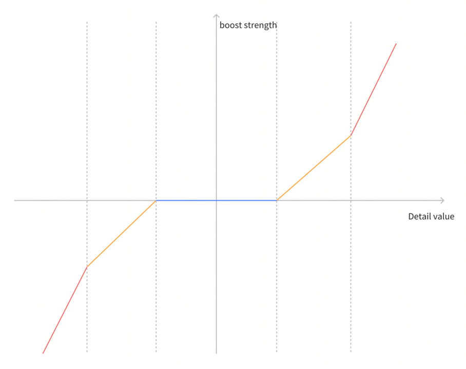

Frequency synthesis (Frequency Synthesis) is performed based on the pixel’s boosting parameters, as follows:
  • If abs(detail) < threshold, output (out) = coarse layer.
  • If abs(detail) > threshold and abs(detail) < boosting threshold, output (out) = coarse layer + detail layer.
  • If abs(detail) > boosting threshold, output (out) = coarse layer + detail layer × boost factor, but not exceeding max boosting value.

../../../_images/image55.png
Figure 3.12‑3 2DNR Static&Motion Detail Boost Schematic

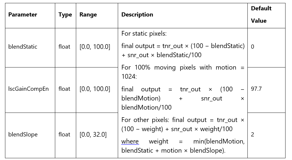

2DNR and 3DNR Blending
While the 2DNR algorithm effectively removes noise, it may also lead to loss of image detail. To balance noise reduction and detail preservation, the algorithm applies different weights to 2DNR based on whether a region is static or moving. Each pixel’s weight is determined by its local motion factor and adjusted via a motion control curve.
../../../_images/image56.png
Figure 3.12‑4 Relationship between 2DNR and MotionFactor
Local SNR standard deviation adjustment: Adjust the local SNR standard deviation based on pixel motion via the motion control curve. A higher motionFactorCurveY value indicates weaker SNR denoising. When set to 128, it corresponds to a multiplier of 1.0 — no enhancement or reduction in denoising.
Processing of static region pixels:
image-20240905211226800
Processing of fully moving region pixels:
image-20240905211237042
Processing of pixels between static and moving regions:
image-20240905211408713
../../../_images/image57.png
Figure 3.12‑5 Static&Motion 2DNR Blending Schematic
image-20240905211448961
Table 3.12‑4 2DNR&3DNR Blending Tuning Parameters

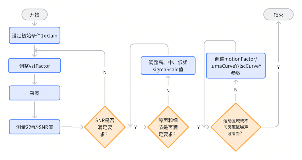

The general 2DNR tuning flowchart is shown in Figure 3.12‑6. To tune 2DNR to meet requirements, process and analyze a large number of images with different content, detail levels, and brightness, making both objective and subjective evaluations. Generally, under low gain, use smaller 2DNR threshold values to preserve texture and detail; under high gain, increase the 2DNR threshold to achieve better noise reduction.
../../../_images/image581.png
Figure 3.12‑6 2DNR Tuning Flowchart

  • If motion < sigmaFactorMotionMin, motion_factor = staticFactor.
  • If motion > sigmaFactorMotionMax, motion_factor = 64.
  • Otherwise, motion_factor = LUT lookup(snr_motion_curve, motion_frame[i,j]) × sigma_factor_mul

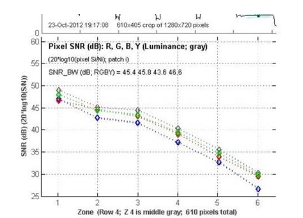

  1. Set Enable to 0 to disable the 2DNR module and capture a real-world image containing a ColorChecker at Total Gain 1x.
  2. Use Imatest to analyze the SNR value of Patch22 (the fourth point in the figure below). This value will serve as the reference SNR after enabling 2DNR. Adjust 2DNR parameters based on SNR as follows:
../../../_images/image59.png
Figure 3.12‑7 Imatest ColorChecker SNR Output
  1. Set Enable to 1, observe and verify image quality. Carefully examine changes in texture details and SNR before and after.
  2. If the required SNR is not met, readjust vstFactor until the desired SNR requirement is satisfied.
  3. After the SNR basically meets the requirements, further evaluate whether the noise and detail performance in the image meet the requirements. If not, adjust the sigmaScale values corresponding to the high, medium, and low frequency domains.
  4. Observe whether the noise levels in different brightness regions, from center to corner regions, and in motion areas meet the requirements. If not, adjust the values of lumaCurve, motionFacCurve, and lscCurveY until the requirements are met.
  5. Adjust the environmental brightness to different Gain multiples, and repeat steps 2)–4) to fine-tune the 2DNR parameters.

The data in Table 3.12-7 can be used as reference SNR values. Figure 3.12‑8 shows the actual effect when SNR > 40. From the image, it can be seen that both noise and texture are well preserved.
../../../_images/image601.png
Figure 3.12‑8 Real-scene illustration of 2DNR tuning
D65 1x gain condition reference Halogen lamp, system maximum Gain
Good: 40 - 50 Good: 25-35
Fair: 35 - 40 Fair: 15 - 25
Poor: < 35 Poor: < 15
Table 3.12‑7 Target SNR values

3DNR module parameters are included in the “2D Noise Reduction” section of VTunerClient. Detailed descriptions of tuning parameters are provided in the table below.
enable int [0,1] 0: bypasses 3DNR v4. 1: enables 3DNR v4. 0
tnrEn int [0,1] 0: bypasses temporal noise reduction (TNR). 1: enables TNR. 1
nlmEn int [0,1] 0: bypasses spatial noise reduction (SNR). 1: enables SNR 1
motionDilateEn int [0,1] 0: disables motion dilation. 1: enables motion dilation. 0
gaussBlurEn int [0,1] 0: disables Gaussian blur before motion detection. 1: enables Gaussian blur before motion detection. 0
noiseModelEn int [0,1] 0: disables the noise model curve. 1: enables the noise model curve. 1
inputBits int {20,24} The bit depth of the noise model curve. 20
noisemodelA double [0.1, 100] The slope of the noise model curve. This parameter is calibration data used to calculate the noise curve by the driver. 0.3
noisemodelB double [0.1, 10000] The offset of the noise model curve. This parameter is calibration data used to calculate the noise curve by the driver. 1.5
Table 3.13‑1 Basic Configuration Parameters of 3DNR

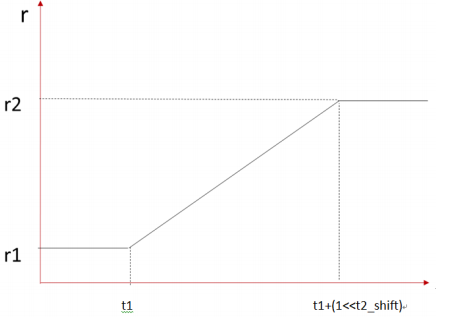

Classify image regions’ motion status using two key parameters, “t1” and “t2”. Parameter “t1” defines the threshold for completely static status, while the difference (t2 - t1) defines the transition zone between motion and static.
The value of “t1” is obtained via interpolation from tnrLumaCurveY. Increasing “t1” causes more areas to be classified as static, reducing the area classified as fully moving.
The value of (t2 - t1) is interpolated from tnrMotionSlopeY. A smaller (t2 - t1) narrows the transition zone, making the boundary between motion and static areas clearer.
These two parameters are crucial for motion detection accuracy and final image quality. Users should adjust t1 and (t2 - t1) based on actual image content and desired processing effects.
image-20240905211817148
Figure 3.13‑3 3DNR Motion Detection Processing Flowchart

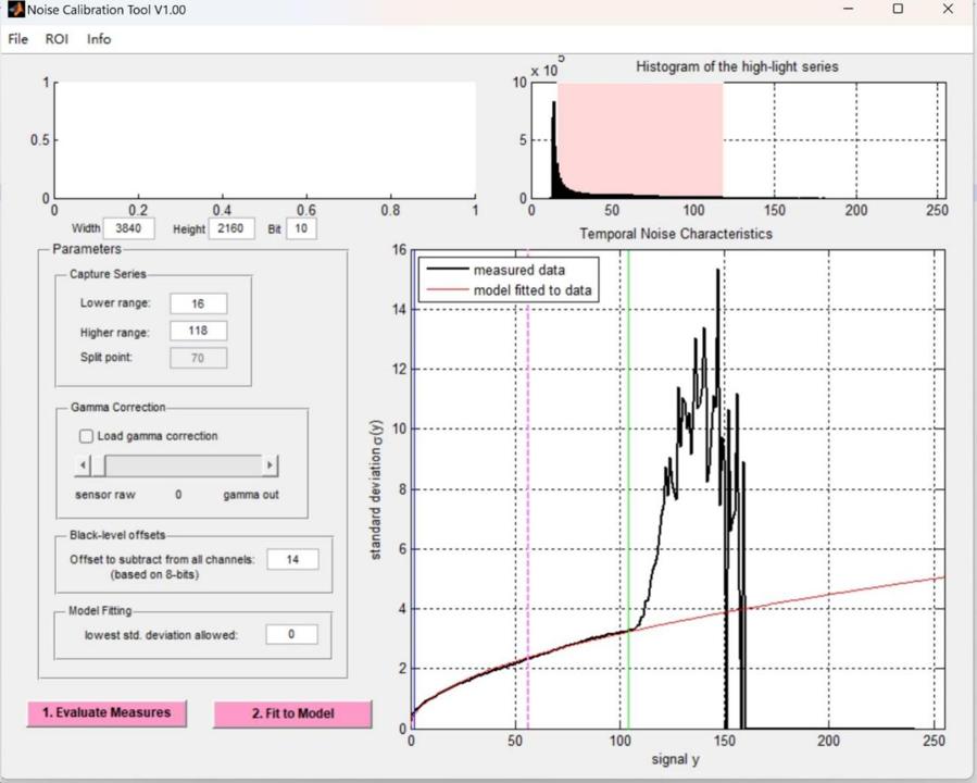

NoiseProfile
NoiseProfile reflects the noise level of the module at different brightness levels under various gain settings, estimated by a static calibration tool from input RAW sequences.
The RAW input for calibration should cover flat areas with a certain dynamic range of pixel distribution, better reflecting the module’s inherent noise level under different brightness conditions. The recommended gray card luminance range is 140–160. Refer to the X5-Calibration Tool User Guide for detailed calibration requirements.
C:\Users\hobot\AppData\Roaming\LarkShell\sdk_storage\82c1d3d13abe7e2b8aaa4f8bdfd360b7\resources\images\img_v2_b478d8c6-6595-4bd7-ba7b-069d1e52cf5g.jpg
Figure 3.13‑4 NoiseProfile Calibration Diagram
