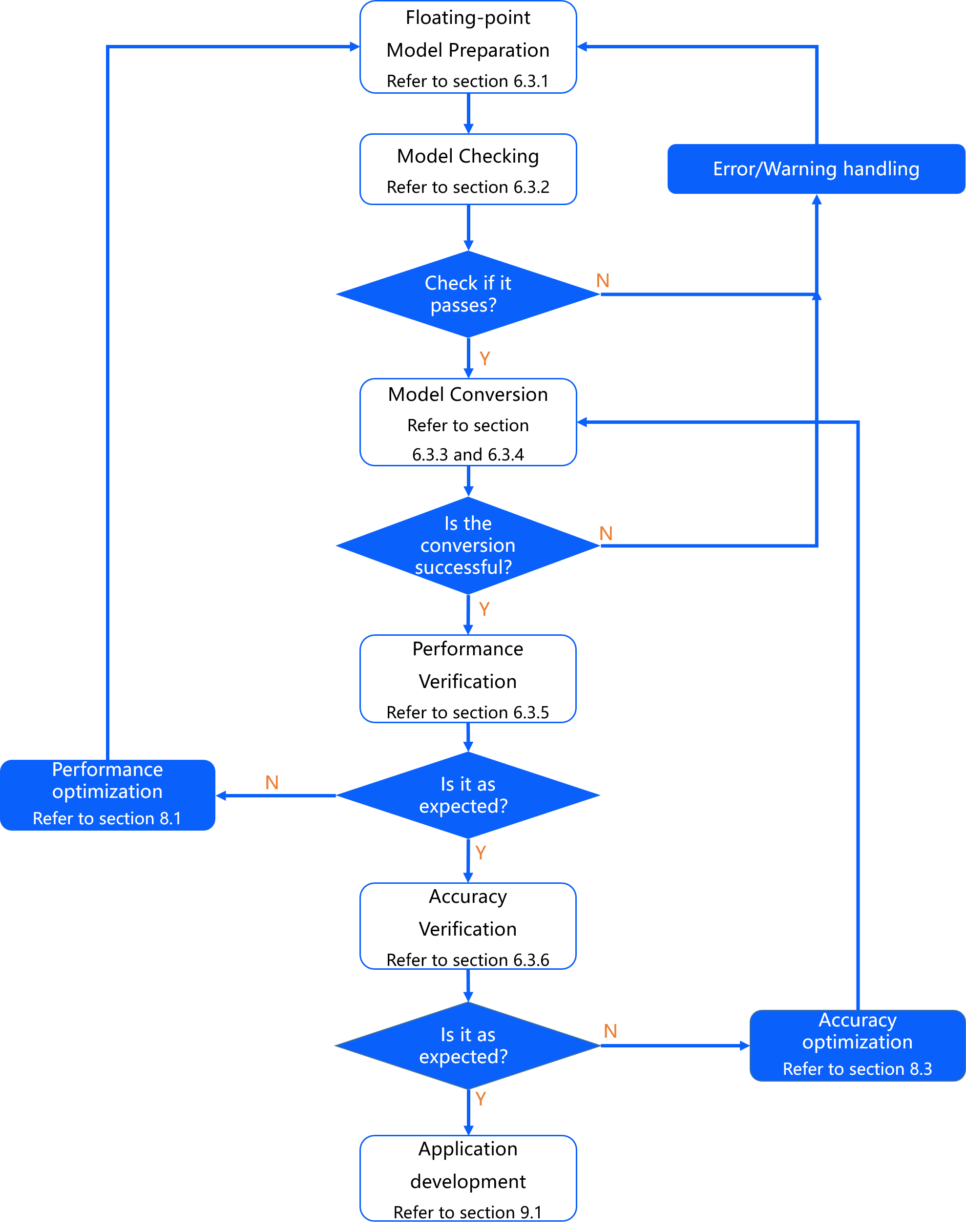

The basic workflow is as follows:
../../../_images/quickstart.png

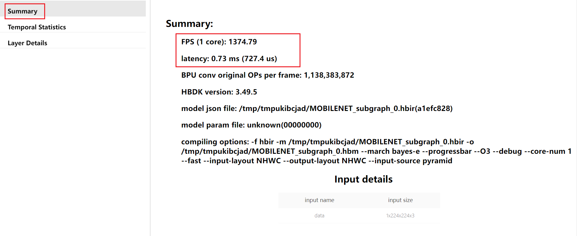

As described in section Model Conversion, after model conversion, HTML and JSON files containing static performance evaluation information for the model will be generated under the working_dir path, both with the same content. But the HTML file is more readable. The following is the HTML file generated by the MobileNet-v1 model conversion, where:
  • The Summary tab provides the performance of the BPU part of the model predicted by the compiler (excluding CPU operator performance prediction).

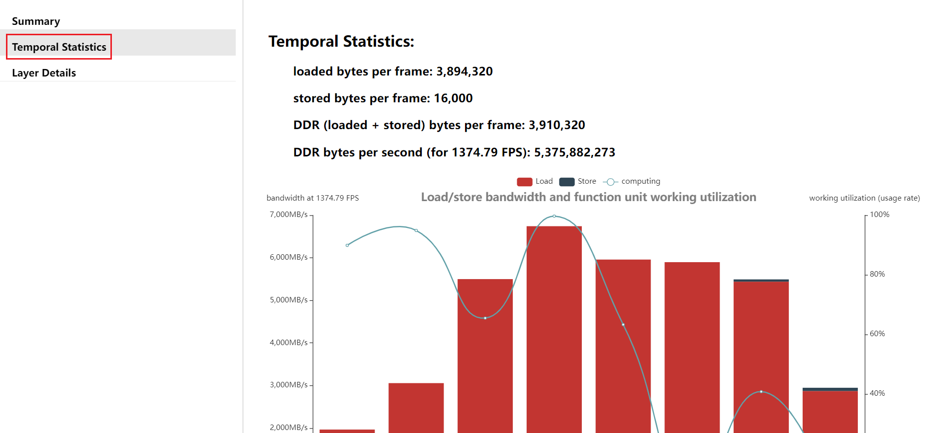

  • The Temporal Statistics tab provides the bandwidth usage of the model during the inference time of one frame.
../../../_images/temporal_statistics_tab.png

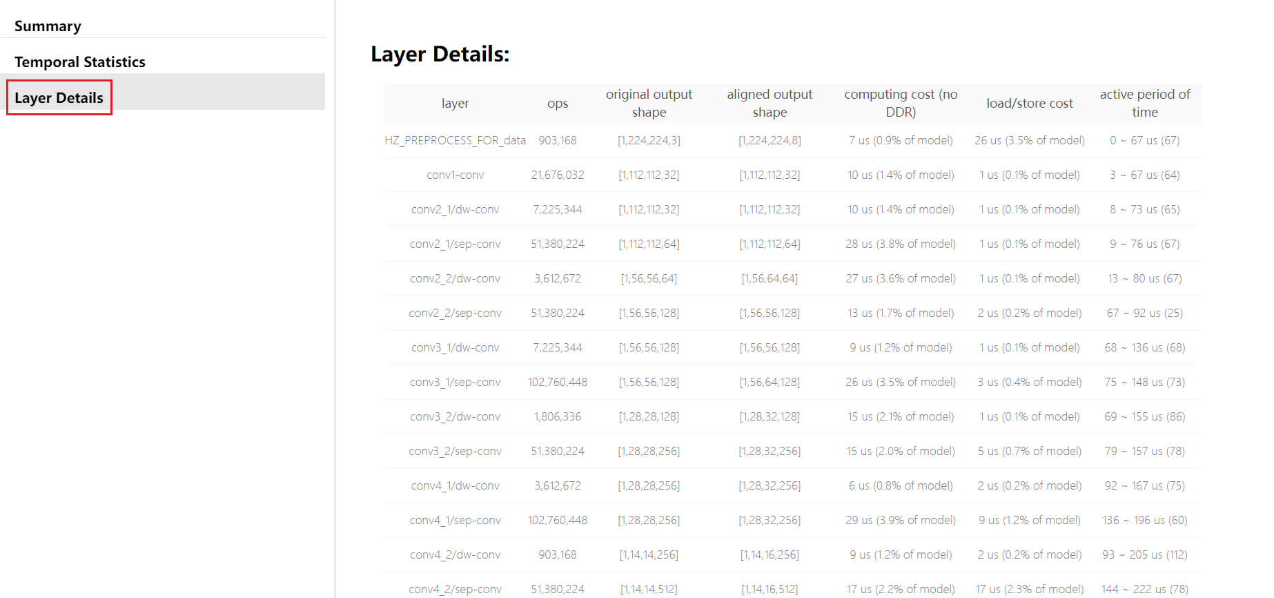

  • The Layer Details tab provides the computation amount, original op output shape, aligned op output shape, computation time, data handling time and the active time period of the compiled layer (does not represent the execution time of the layer, usually multiple layers alternate/execute in parallel) of each layer of BPU operators.
../../../_images/layer_details_tab.png
