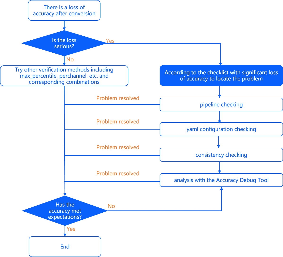

3.After trying 1 and 2, if the accuracy still does not meet expectations, try further attempts using the accuracy debug tool we provide.
The workflow chart of accuracy loss solution is shown as below:
../../../_images/accuracy_problem.png
