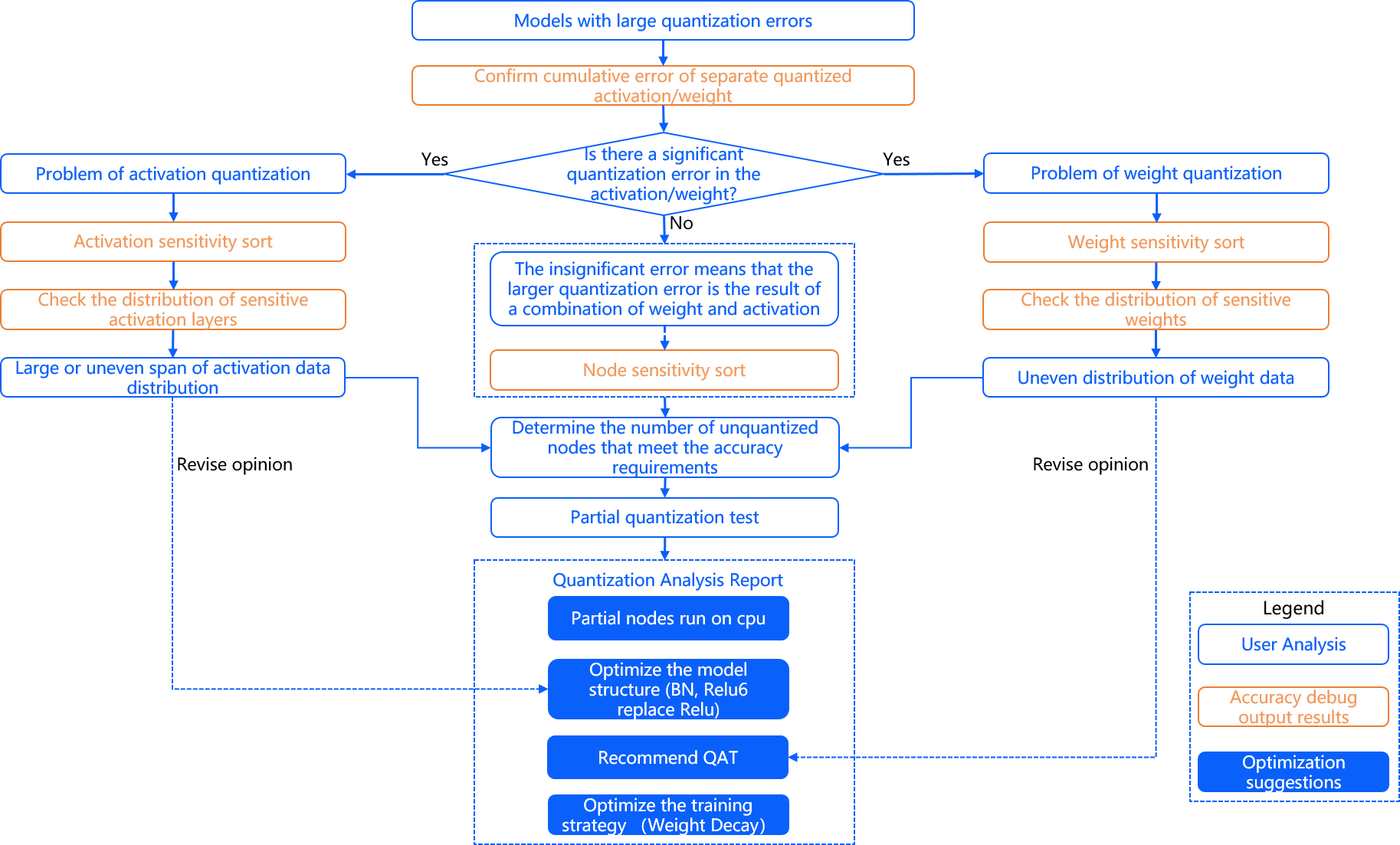

The overall process is shown as the follow:
../../../../_images/accuracy_debug_process.png

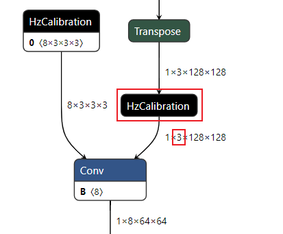

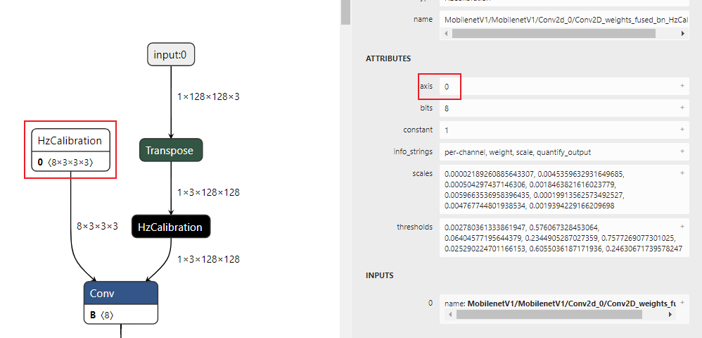

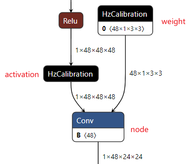

Calibration model (calibrated_model.onnx) interpretation
The calibration model is an intermediate product obtained by the model transformation tool chain by taking the floating point model after structural optimization, calculating the quantization parameters corresponding to each node from the calibration data and saving them in the calibration node. The main feature of the calibration model is that the model contains calibration nodes with the node type HzCalibration. These calibration nodes are divided into two main categories: activation calibration nodes and weight calibration nodes .
The input of activation calibration node is the output of the previous node of the current node, and the input data is quantized and inverse quantized based on the quantization parameters (scales and thresholds) saved in the current activation calibration node and then output.
The input of weight calibration node is the original floating point weights of the model, and the input original floating point weights are quantized and inverse quantized based on the quantization parameters (scales and thresholds) saved in the current weight calibration node and then output.
In addition to the above calibration nodes, other nodes in the calibration model are called general nodes by the accuracy debug tool. The types of general nodes are: Conv, Mul, Add, etc.
../../../../_images/debug_node.png

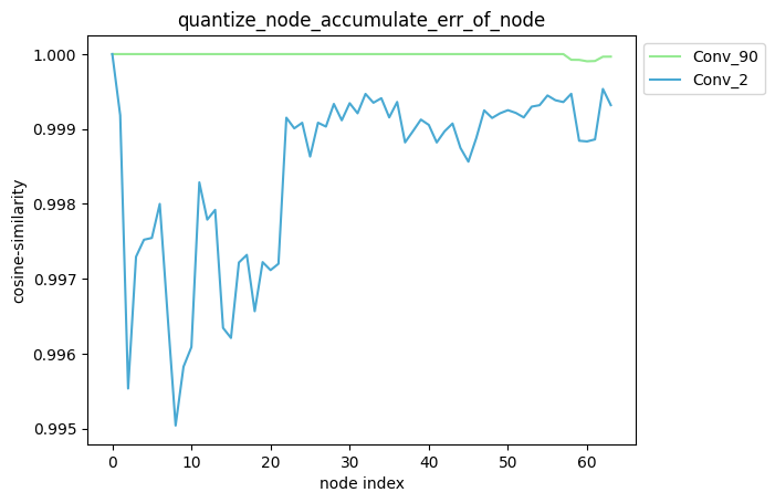

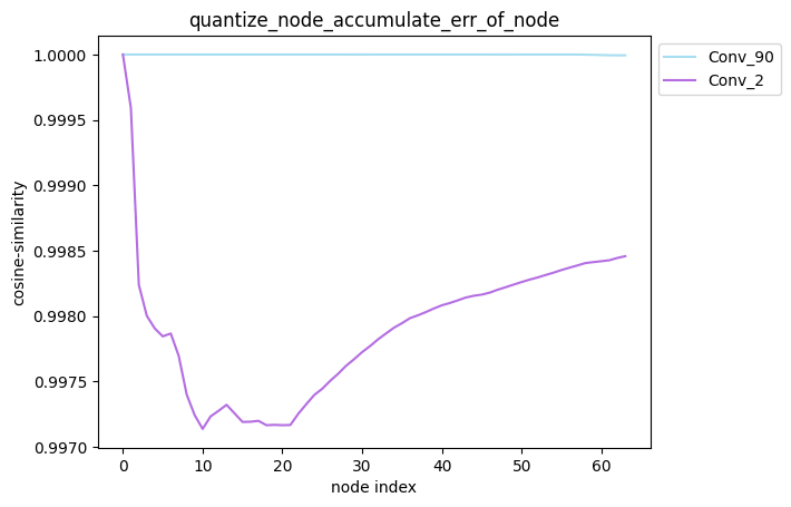

1.Specify the node to quantify the cumulative error test:
  • Specify single-node quantization
Configuration method: quantize_node=[‘Conv_2’, ‘Conv_90’], quantize_node is single list.
API Usage:
# Import the debug module
import horizon_nn.quantizer.debugger as dbg
dbg.plot_acc_error(
        save_dir='./',
        calibrated_data='./calibration_data/',
        model_or_file='./calibrated_model.onnx',
        quantize_node=['Conv_2', 'Conv_90'],
        metric='cosine-similarity',
        average_mode=False)
Command Line Usage:
hmct-debugger plot-acc-error calibrated_model.onnx calibrated_data -q ['Conv_2','Conv_90']
Description: When quantize_node is a single list, for the quantize_node you set, quantize the nodes in the quantize_node separately and keep the other nodes in the model unquantized to get the corresponding model, and then calculate the error between the output of each node in the model and the output of the corresponding node in the floating-point model, and get the corresponding cumulative error curve.
When average_mode = False:
../../../../_images/average_mode_false_1.png
When average_mode = True:
../../../../_images/average_mode_true_1.png

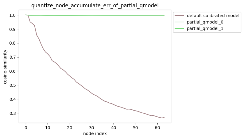

  • Specify multiple nodes for quantization
Configuration method: quantize_node=[[‘Conv_2’], [‘Conv_2’, ‘Conv_90’]],quantize_node is nested list.
API Usage:
dbg.plot_acc_error(
        save_dir='./',
        quantize_node=[['Conv_2'], ['Conv_2', 'Conv_90']],
        average_mode=False)
Command Line Usage:
hmct-debugger plot-acc-error calibrated_model.onnx calibration_data -q [['Conv_2'],['Conv_2','Conv_90']]
Description: When quantize_node is a nested list, for the quantize_node you set, quantize the nodes specified for each single list in the quantize_node separately and keep the other nodes in the model unquantized to get the corresponding model, then calculate the error between the output of each node in the model and the output of the corresponding node in the floating-point model, and get the corresponding cumulative error curve.
  • partial_qmodel_0: Only quantize the Conv_2 node, the rest of the nodes are not quantized;
  • partial_qmodel_1: Only the Conv_2 and Conv_90 nodes are quantified, and the rest of the nodes are not quantified.
../../../../_images/new_average_mode_false_1.png
../../../../_images/new_average_mode_true_1.png

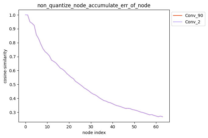

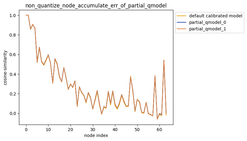

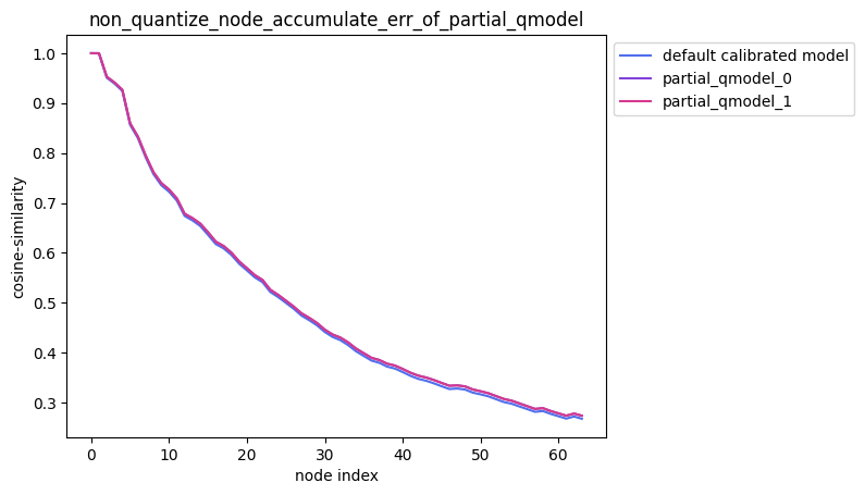

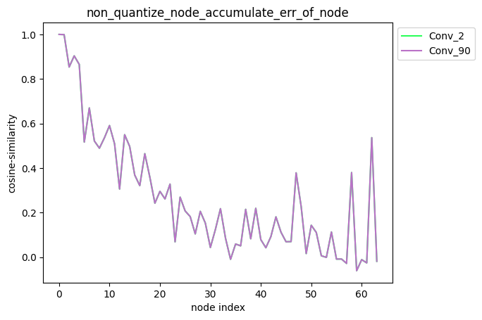

2.Cumulative error test after unquantizing some nodes of the model
  • Specify single node not quantified
Configuration method: non_quantize_node=[‘Conv_2’, ‘Conv_90’],non_quantize_node is single list.
API Usage:
dbg.plot_acc_error(
        save_dir='./',
        non_quantize_node=['Conv_2', 'Conv_90'],
        average_mode=True)
Command Line Usage:
hmct-debugger plot-acc-error calibrated_model.onnx calibration_data -nq ['Conv_2','Conv_90'] -a True
Description: When the non_quantize_node is a single list, for the non_quantize_node you set, unquantize each node in the non_quantize_node separately while keeping all other nodes quantized, and then get the corresponding model, calculate the error between the output of each node in the model and the output of the corresponding node in the floating-point model, and get the corresponding cumulative error curve.
../../../../_images/average_mode_false_2.png
../../../../_images/average_mode_true_2.png
  • Specify multiple nodes not to quantize
Configuration method: non_quantize_node=[[‘Conv_2’], [‘Conv_2’, ‘Conv_90’]],non_quantize_node is nested list.
API Usage:
dbg.plot_acc_error(
        save_dir='./',
        non_quantize_node=[['Conv_2'], ['Conv_2', 'Conv_90']],
        average_mode=False)
Command Line Usage:
hmct-debugger plot-acc-error calibrated_model.onnx calibration_data -nq [['Conv_2'],['Conv_2','Conv_90']]

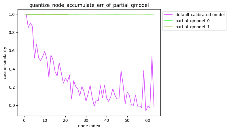

Description: When non_quantize_node is a nested list, for the non_quantize_node you set, do not quantize each node specified in the non_quantize_node and keep all the other nodes in the model quantized, and get the corresponding model, then calculate the error between the output of each node in the model and the output of the corresponding node in the floating-point model, and get the corresponding cumulative error curve.
  • partial_qmodel_0: No quantization of Conv_2 nodes and quantization of the remaining nodes;
  • partial_qmodel_1: No quantization of Conv_2 and Conv_90 nodes, and quantization of the rest of the nodes.
../../../../_images/new_average_mode_false_2.png
../../../../_images/new_average_mode_true_2.png

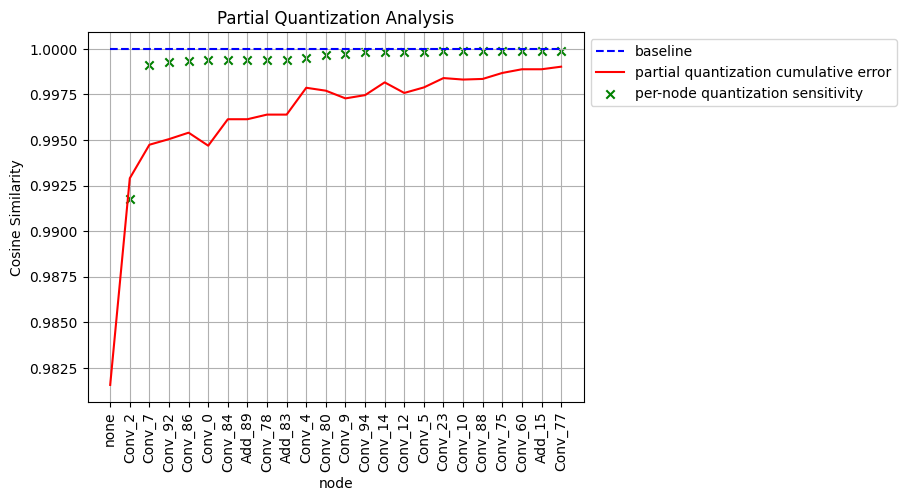

Test skills:
When testing the accuracy of partial quantification, you may compare the accuracy of multiple sets of quantified strategies in order of quantified sensitivity, in which case you can refer to the following usage:
# First, use the quantization sensitivity sorting function to obtain the quantization sensitivity sorting of the nodes in the model
node_message = dbg.get_sensitivity_of_nodes(
        metrics='cosine-similarity',
        output_node=None,
        node_type='node',
        verbose=False,
        interested_nodes=None)
# node_message is a dictionary type, and its key value is the node name
nodes = list(node_message.keys())
# Specify the unquantized nodes by nodes, which can be easily used
dbg.plot_acc_error(
        save_dir='./',
        non_quantize_node=[nodes[:1], nodes[:2]],
        average_mode=True)

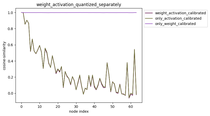

3.Activation weights are quantified separately
Configuration method: quantize_node=[‘weight’,’activation’].
API Usage:
dbg.plot_acc_error(
        save_dir='./',
        quantize_node=['weight', 'activation'],
        average_mode=False)
Command Line Usage:
hmct-debugger plot-acc-error calibrated_model.onnx calibration_data -q ['weight','activation']
Description: The quantize_node can also be specified directly as ‘weight’ or ‘activation’.
  • quantize_node = [‘weight’]: Quantify weights, not activation.
  • quantize_node = [‘activation’]: Quantify activation, not weights.
  • quantize_node = [‘weight’, ‘activation’]: Weights and activations are quantified separately.
../../../../_images/weight_activation_quantized.png
Note

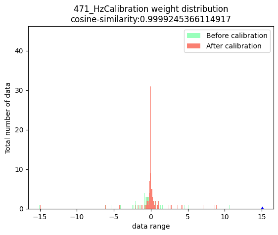

DESCRIPTIONS: Required, specify the nodes to be analyzed. If the node type in nodes_list is:
  • Weights calibration node: plots the data distribution of the original weights and the weights after calibration.
  • Activate calibration nodes: Plot the input data distribution of activated calibration nodes.
  • Common node: Plot the output data distribution of this node before and after quantization, and also plot the error distribution between the two.
Note: nodes_list is a list type, a series of nodes can be specified, and all three types of nodes can be specified at the same time.
required
dbg.plot_distribution(
        save_dir: str,
        model_or_file: ModelProto or str,
        calibrated_data: str or CalibrationDataSet,
        nodes_list: List[str] or str)
Analysis results presentation:
API Usage:
        save_dir='./',
        calibrated_data='./calibration_data',
        nodes_list=['317_HzCalibration', # Activation Node
                    '471_HzCalibration', # Weight Node
                    'Conv_2']) # Common Node
Command Line Usage:
hmct-debugger plot-distribution calibrated_model.onnx calibration_data -n ['317_HzCalibration','471_HzCalibration','Conv_2']

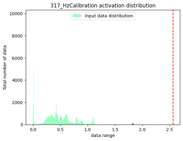

When node_type = ‘node_output’:
../../../../_images/node_output.png
When node_type = ‘weight’:
../../../../_images/weight.png
When node_type = ‘activation’:
../../../../_images/activation.png
Note
In the above three pictures, the blue triangle indicates that the maximum value of the absolute data. The red dashed line indicates that the maximum calibration threshold.

API Usage:
dbg.sensitivity_analysis(model_or_file='calibrated_model.onnx',
                         calibrated_data='calibration_data',
                         pick_threshold=0.9999,
                         data_num=1,
                         sensitive_nodes=[])
Command Line Usage:
hmct-debugger sensitivity-analysis calibrated_model.onnx calibration_data
../../../../_images/partial_quantization.png
In the figure:
  • Blue dashed line: baseline, i.e., the cosine similarity of the floating point model output to itself, is 1.
  • Green cross: Quantize only the current node to get a partially quantized model, and compute the similarity between the partially quantized model and the final output of the floating-point model.
  • Red solid line: without quantizing the current node and all nodes before the current node, the similarity between the partially quantized model and the floating-point model is calculated. For example, the similarity value of Conv_92 in the above figure is around 0.995, indicating that the cosine similarity between the final output of the partially quantized model and the floating-point model is around 0.995 when we unquantize the nodes of Conv_2, Conv_7, and Conv_92, and keep all the rest of the nodes quantized to get the partially quantized model. The first none of the horizontal coordinates, in the red solid line, means calibrated_model.

runall Process:
../../../../_images/runall.png

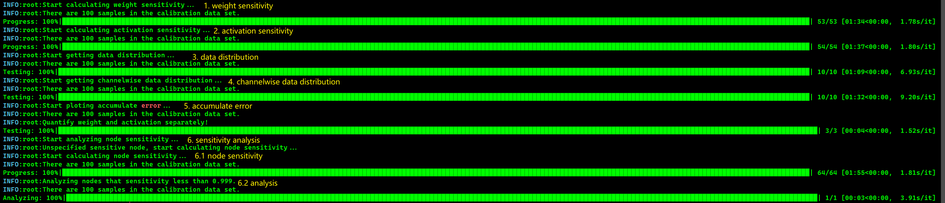

When all parameters are left as default, the tool performs the following functions in sequence:
  • STEP1 and STEP2: Obtain the quantization sensitivity of the weight calibration node and activation calibration node, respectively.
  • STEP3: Based on the results of STEP1 and STEP2, take the TOP5 of the weight calibration nodes and the TOP5 of the activation calibration nodes to plot their data distribution, respectively.

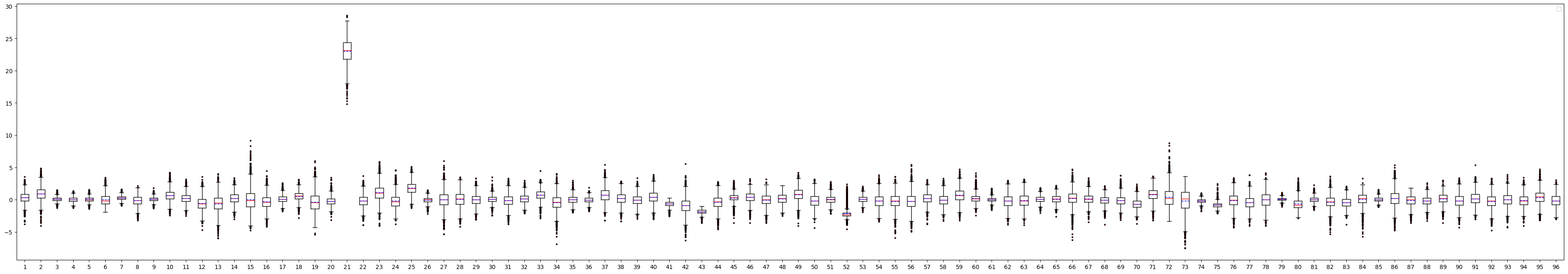

  • STEP4: For the nodes obtained in STEP3, draw box-and-line plots of their inter-channel data distribution, respectively.
  • STEP5: Plot the cumulative error curves for quantizing only the weights and only the activations, respectively.
  • STEP6: Partial quantization and single-node quantization accuracy analysis for sensitive nodes. Since the example in the figure does not specify sensitive_nodes, the debug tool needs to calculate the quantization sensitivity of common nodes by itself and select nodes with sensitivity less than the specified pick_threshold for testing and analysis.
When node_type='node' is specified, the tool will get the top5 nodes and find the calibration nodes corresponding to each node separately, and get the data distribution and box line diagram of the calibration nodes.
