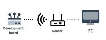

Performance test diagram:
image-20241212-152024
