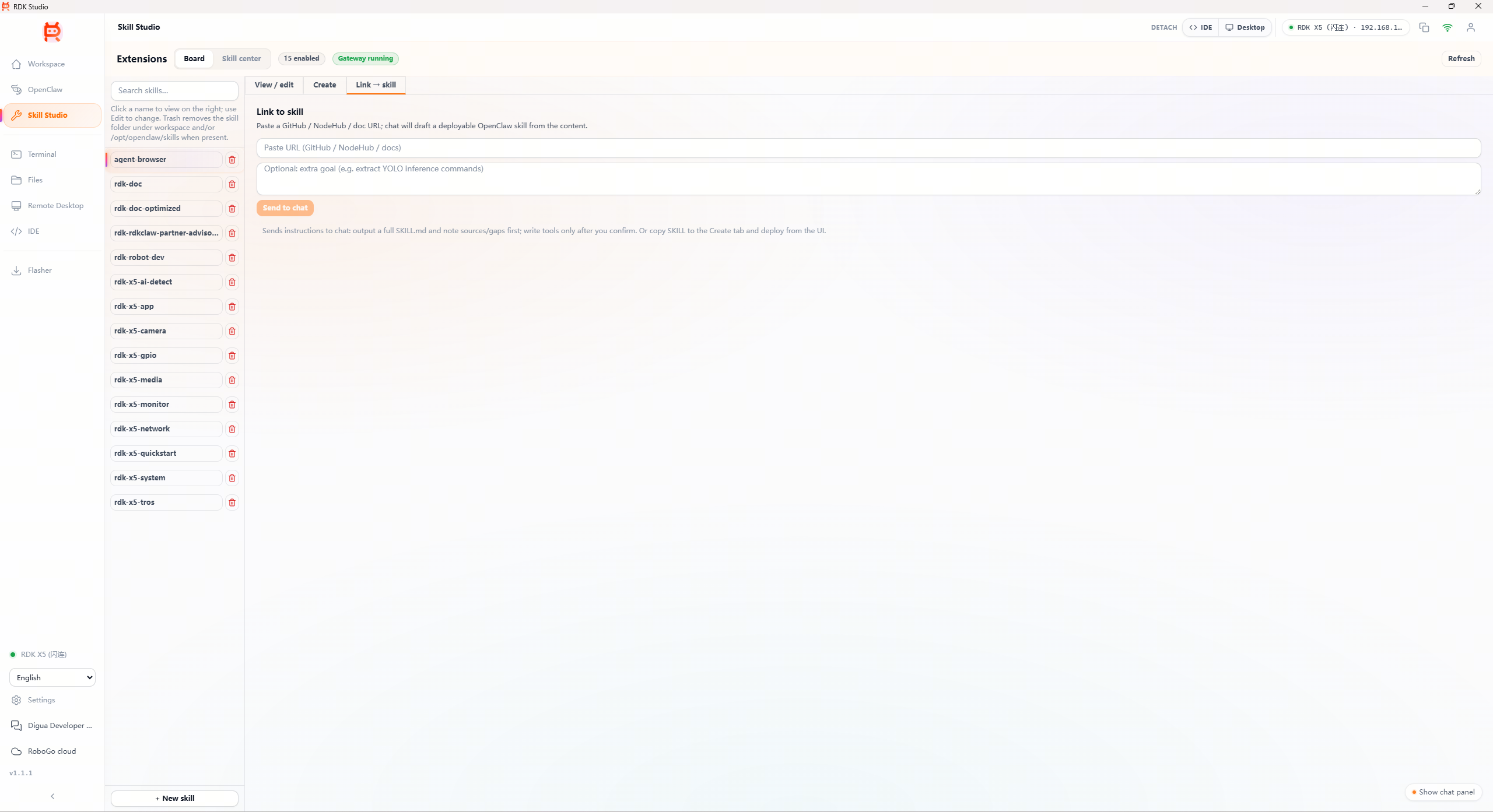

URL-to-skill form: paste GitHub / NodeHub / documentation URL, add target description, and use two-stage AI assistance to convert into SKILL.md

URL Import Workflow
Convert any external content into a skill:
StepAction
1Go to Skill Workshop → Skill Center → Link
2Paste the URL; Studio automatically detects the source type
3Provide a goal description: "I want AI to learn X"
4Select applicable device models (X3 / X5 / S100 / Generic)
5AI fetches content from the URL and converts it into SKILL.md
6Refine in the editor
7Install locally or deploy to the device
Source Recognition
SourceRecognition RuleAI Processing Method
GitHub RepositoryURL contains github.com/...Fetches README + repository structure, extracts key commands and workflows
NodeHub CaseURL contains developer.d-robotics.cc/nodehubFetches case documentation and execution instructions
General Web Page or BlogDefaultExtracts HTML body text and pulls out technical content
GitHub and NodeHub sources benefit from dedicated parsing logic, typically yielding more accurate results than generic web pages. The conversion quality for generic web pages (e.g., blog posts) depends heavily on content structure.
Limitations of URL Import
LimitationDescription
Excessively Long ContentWeb pages over 50 KB may be truncated or fail to convert
Interactive ElementsContent requiring JavaScript rendering may be lost
Anti-Scraping MechanismsSome websites block scraping requests
Videos or ImagesOnly textual descriptions are extracted; video or image content cannot be interpreted
If URL import fails, manually copy the web content locally, organize it into a proper SKILL.md file yourself, and submit it via Skill Workshop → Create.
