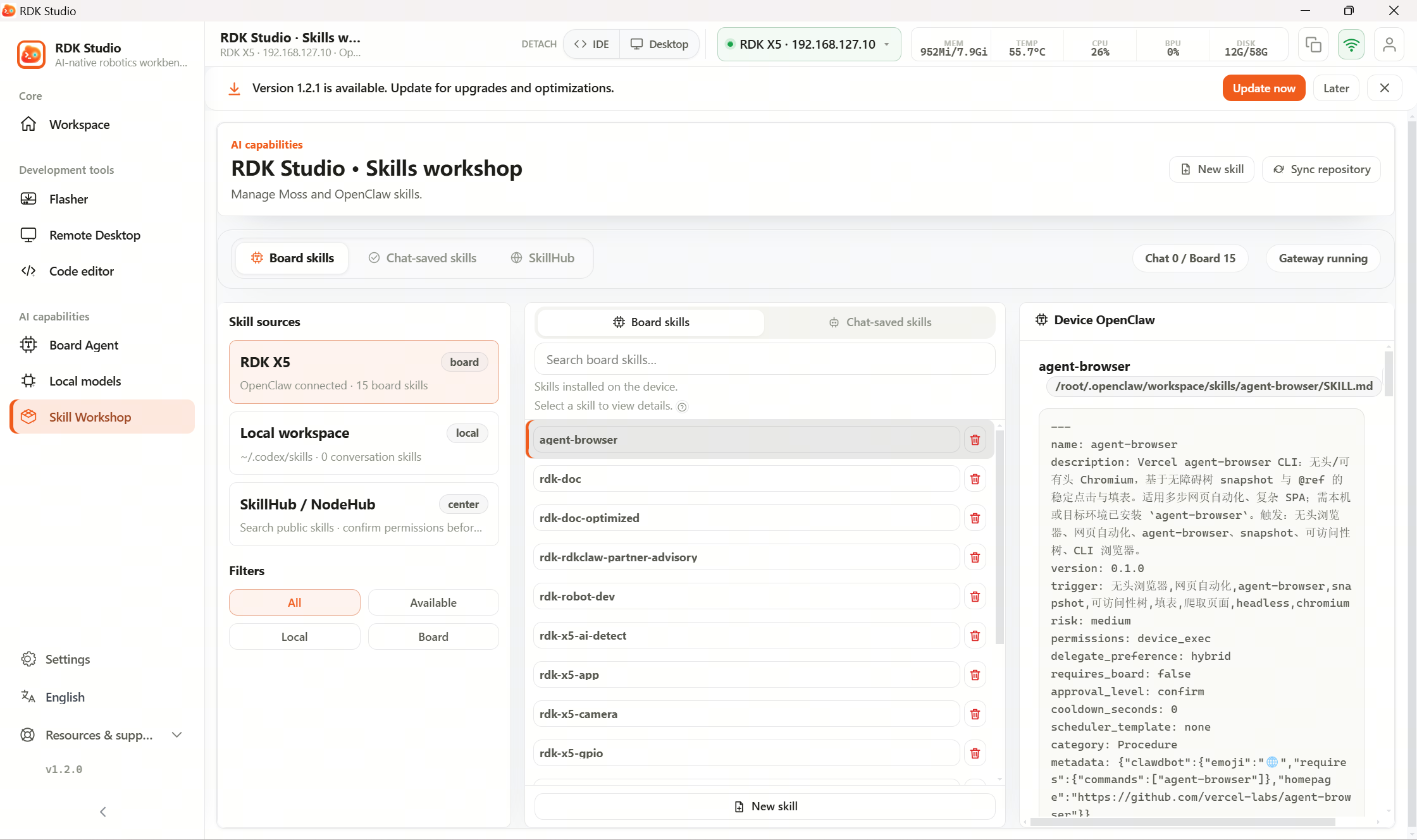

Skill Marketplace (SkillHub): Left-side toggle between SkillHub / On-device skills, top search bar, and skill detail preview on the right

Search and Preview
ActionPath
Keyword SearchSkill Workshop → Skill Center → ClawHub Community → Top search bar
Browse by CategoryLeft-side category navigation
View Skill DetailsClick skill name → Full SKILL.md content and frontmatter displayed on the right
