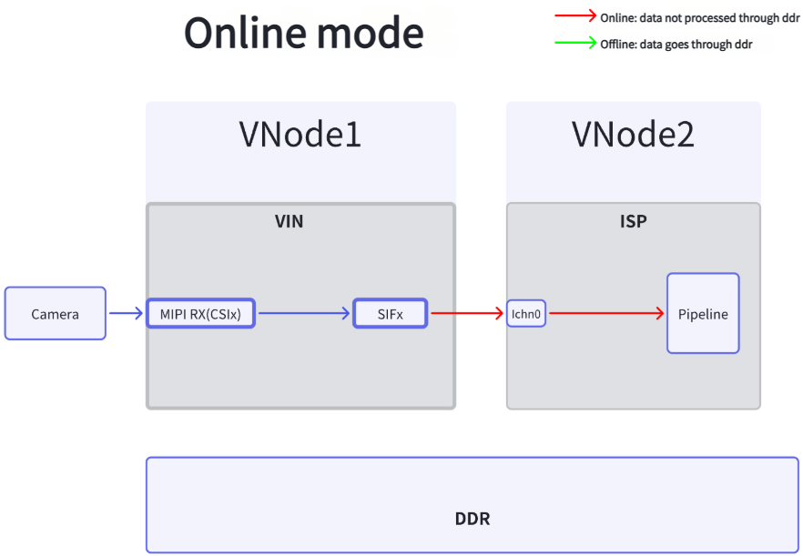

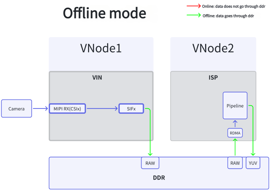

5.6.1.1. VIN Use Cases
VIN supports both Offline and Online connections to the ISP module, where the ISP module’s Pipeline is time-division multiplexed.
Offline Mode: Camera connects to ISP via VIN in Offline mode.
Online Mode: Camera connects to ISP via VIN in Online mode.
5.6.1.2. Scenario Recommendations
For single Camera Sensor scenarios: prefer Online mode for the connection from VIN to ISP; Offline mode is also supported.
For multi-camera Sensor scenarios: only Offline mode is supported for the connection from VIN to ISP.
Note: When an HDR sensor is connected, the VIN-ISP connection must use online mode. Since online mode exclusively occupies the ISP resource, only 1 stream is supported.
