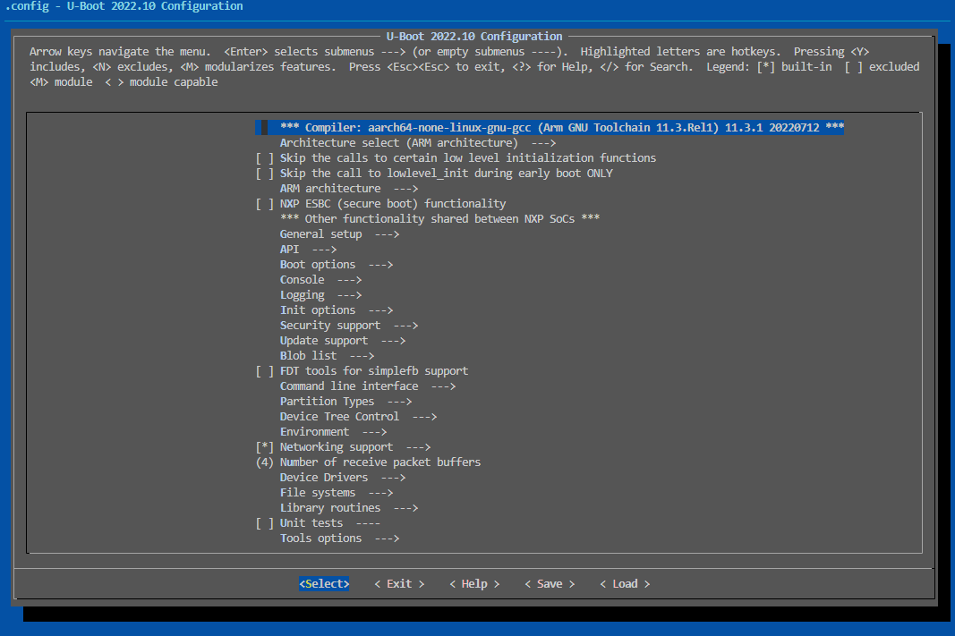

In this platform, the U-Boot configuration file is uboot/configs/hobot_x5_soc_defconfig. Use the following command to configure U-Boot options:
./bd.sh uboot menuconfig
This command automatically uses the U-Boot configuration file defined in the board-level configuration. After configuration, it automatically performs savedefconfig and saves the changes. For detailed instructions, refer to the Configuring U-Boot Option Parameters section.
Upon successful execution, this command opens the U-Boot graphical configuration interface, where you can interactively configure options:
uboot_config
In this interface, you can disable unnecessary features or commands based on requirements to reduce the U-Boot image size.

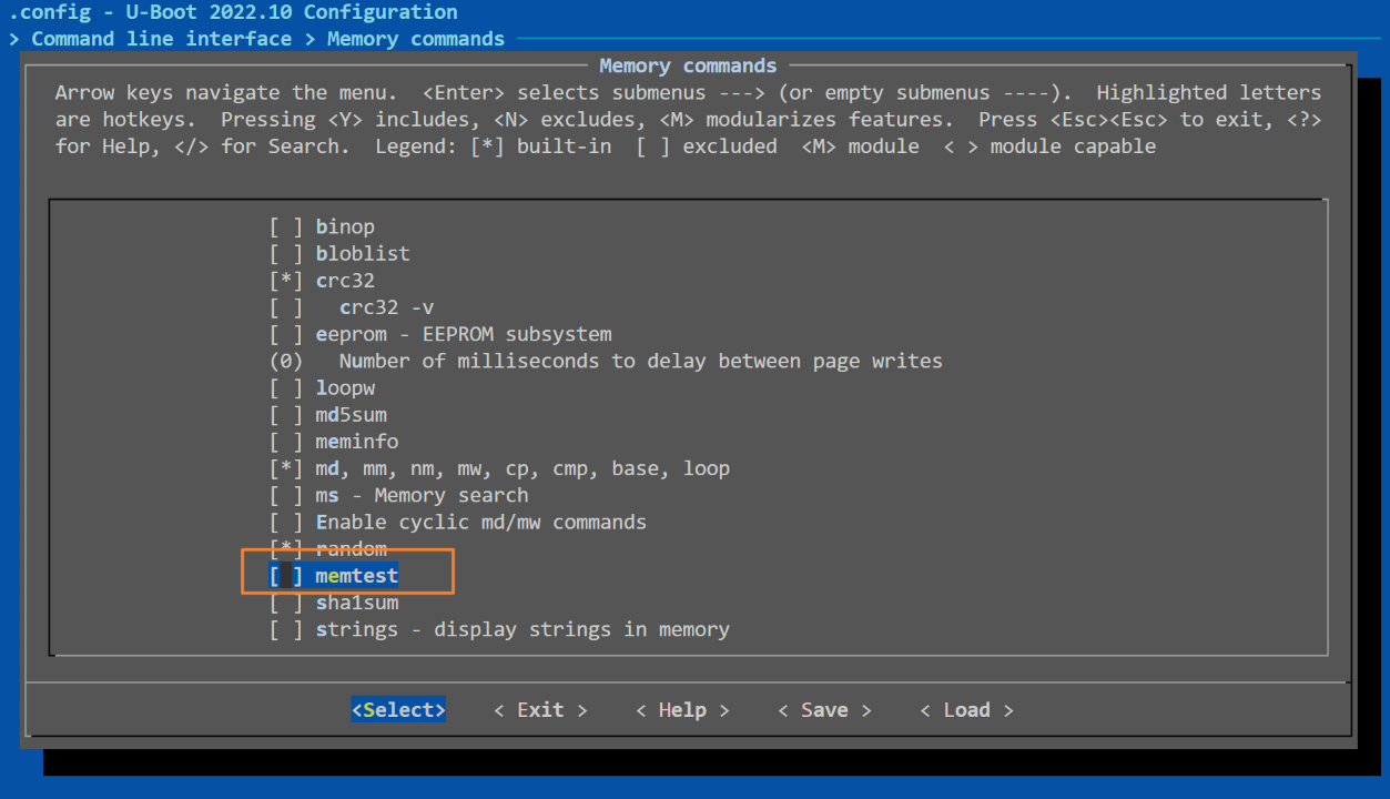

  • Disable unnecessary commands
    For example, if the memtest command is not needed, it can be disabled by unchecking it in the menuconfig interface:
    memtest_cmd

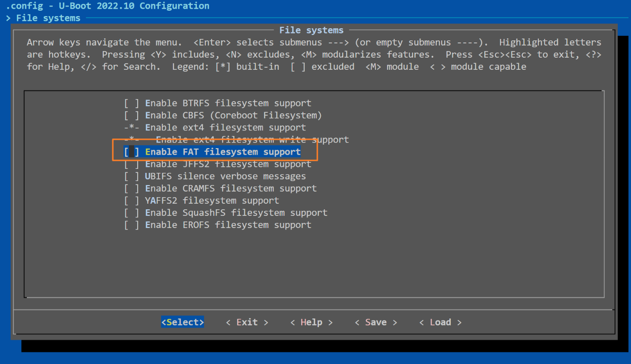

  • Disable filesystem support
    If certain filesystems (e.g., FAT, ext4) are not required, their support can be disabled by unselecting related options. For example, to disable FAT filesystem support:
    FAT_FS

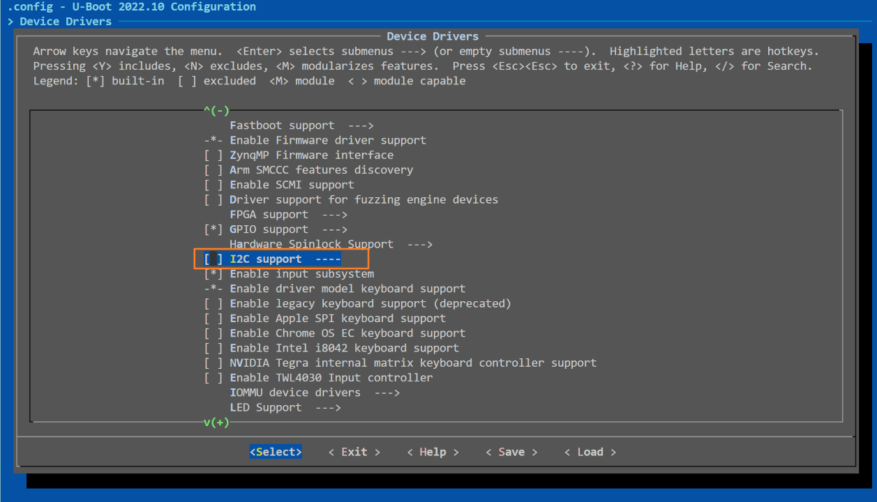

  • Disable unnecessary hardware drivers
    If I2C device support is not needed, disable the I2C driver by unchecking I2C support in the menuconfig interface:
    I2C_CONFIG

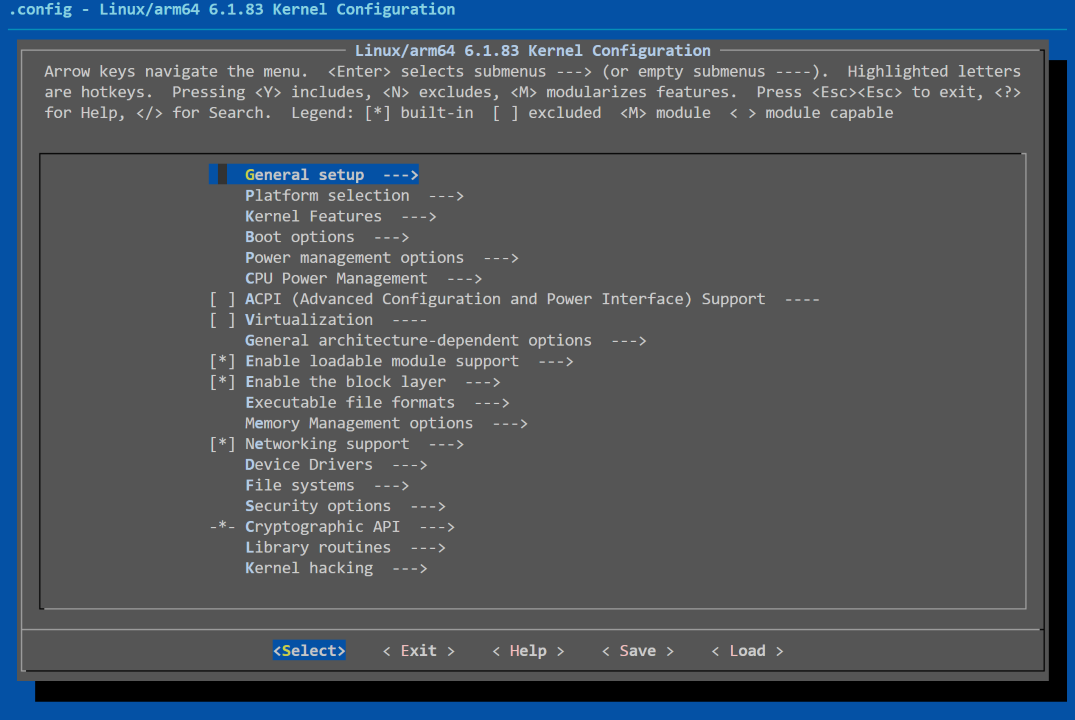

Similar to the U-Boot configuration process, this platform provides a command for configuring kernel options:
./bd.sh boot menuconfig
For detailed explanation of this command, refer to the Configuring Kernel Option Parameters section. Upon successful execution, the command opens the kernel’s graphical configuration interface, allowing interactive configuration and removal of unnecessary modules:
kernel_config
The process of removing unnecessary features or drivers in the Linux kernel menuconfig interface is similar to that of U-Boot. The key to kernel trimming lies in accurately identifying removable components without affecting system functionality. After completing the settings in the menuconfig interface, select Exit, and choose Yes when prompted to save changes to the .config file (on this platform, typically kernel/arch/arm64/configs/hobot_x5_soc_defconfig).

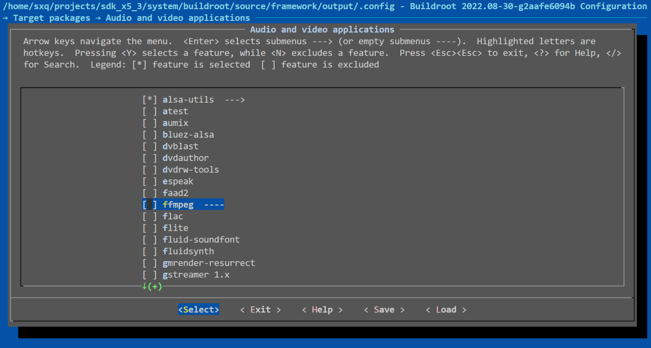

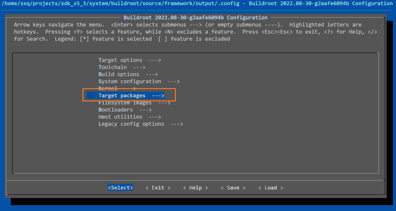

Run the following command in the system/buildroot/source directory to remove unnecessary applications and libraries:
./build.sh menuconfig x5_system_defconfig
Enter the menuconfig interface for configuration:
buildroot_packages
All application packages in the root filesystem are located under the target packages directory and can be modified as needed. For example, to disable the ffmpeg package, simply uncheck the ffmpeg option in this menu:
buildroot_ffmpeg
After completing configuration in the menuconfig interface, select Exit and choose Yes to save changes to the .config file (on this platform: system/buildroot/source/configs/x5_system_defconfig).

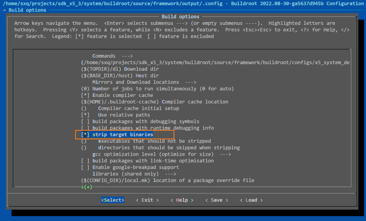

Additionally, strip removes symbol and debug information from binaries and libraries, significantly reducing space usage. This platform enables the Buildroot strip option by default:
buildroot_strip
This setting uses the strip command to remove debug symbols from binaries and libraries in the target filesystem, saving space. Debug symbols are needed for local debugging but not for remote debugging.

BR2_TOOLCHAIN_EXTERNAL_HEADERS_4_20=y
BR2_TOOLCHAIN_EXTERNAL_CUSTOM_GLIBC=y
# BR2_TOOLCHAIN_EXTERNAL_INET_RPC is not set
BR2_TOOLCHAIN_EXTERNAL_CXX=y
BR2_CCACHE=y
# BR2_PIC_PIE is not set
BR2_SSP_NONE=y
BR2_RELRO_NONE=y
BR2_FORTIFY_SOURCE_NONE=y
BR2_INIT_SYSV=y
BR2_ROOTFS_DEVICE_CREATION_DYNAMIC_EUDEV=y
BR2_ROOTFS_MERGED_USR=y
BR2_TARGET_GENERIC_ROOT_PASSWD="root"
BR2_SYSTEM_BIN_SH_BASH=y
BR2_SYSTEM_DEFAULT_PATH="/bin:/sbin:/usr/bin:/usr/sbin"
BR2_PACKAGE_FFMPEG=y
BR2_PACKAGE_FFMPEG_ENCODERS=""
BR2_PACKAGE_FFMPEG_DECODERS=""
BR2_PACKAGE_FFMPEG_MUXERS=""
BR2_PACKAGE_FFMPEG_DEMUXERS=""
BR2_PACKAGE_FFMPEG_PARSERS=""
BR2_PACKAGE_FFMPEG_BSFS=""
BR2_PACKAGE_FFMPEG_PROTOCOLS=""
BR2_PACKAGE_FFMPEG_FILTERS=""
# BR2_PACKAGE_FFMPEG_INDEVS is not set
# BR2_PACKAGE_FFMPEG_OUTDEVS is not set
BR2_PACKAGE_FFMPEG_EXTRACONF=" --disable-everything --enable-gray --enable-safe-bitstream-reader --enable-encoder=adpcm_g726le --enable-encoder=flac  --enable-encoder=pcm_alaw --enable-encoder=pcm_mulaw --enable-encoder=adpcm_ima_wav --enable-encoder=srt --enable-encoder=subrip  --enable-encoder=text  --enable-encoder=movtext --enable-encoder=ass    --enable-decoder=adpcm_g726le   --enable-decoder=flac           --enable-decoder=pcm_alaw      --enable-decoder=pcm_mulaw       --enable-decoder=adpcm_ima_wav  --enable-decoder=h264   --enable-decoder=hevc   --enable-decoder=mjpeg  --enable-muxer=adts     --enable-muxer=mpegts   --enable-muxer=rtsp     --enable-muxer=rtp      --enable-muxer=avi      --enable-muxer=flv      --enable-muxer=hls      --enable-muxer=mp4      --enable-muxer=flac --enable-demuxer=flac --enable-demuxer=aac --enable-demuxer=mpegts  --enable-demuxer=h264 --enable-demuxer=hevc --enable-demuxer=mjpeg --enable-demuxer=image2  --enable-demuxer=mov --enable-demuxer=rtsp --enable-demuxer=hls  --enable-demuxer=rtp --enable-demuxer=flv --enable-demuxer=mpegps --enable-demuxer=mpegtsraw --enable-demuxer=mpegvideo --enable-parser=h264 --enable-parser=hevc --enable-parser=aac --enable-parser=flac --enable-parser=mjpeg --enable-parser=mpeg4video --enable-parser=mpegvideo --enable-parser=mpegaudio --enable-bsf=h264_mp4toannexb --enable-bsf=aac_adtstoasc --enable-bsf=null --enable-bsf=extract_extradata --enable-protocol=file --enable-protocol=http --enable-protocol=rtp --enable-protocol=rtmpts --enable-protocol=https --enable-protocol=hls --enable-protocol=data --disable-armv5te --disable-armv6 --disable-mmx --disable-optimizations --disable-asm "
BR2_PACKAGE_BZIP2=y
BR2_PACKAGE_MEMSTAT=y
BR2_PACKAGE_MTD=y
BR2_PACKAGE_EUDEV_RULES_GEN=y
# BR2_PACKAGE_EUDEV_ENABLE_HWDB is not set
BR2_PACKAGE_I2C_TOOLS=y
BR2_PACKAGE_TINYALSA=y
BR2_PACKAGE_MINIZIP_ZLIB=y
BR2_PACKAGE_LIBKCAPI=y
BR2_PACKAGE_LIBKCAPI_ENCAPP=y
BR2_PACKAGE_LIBKCAPI_HASHER=y
BR2_PACKAGE_LIBKCAPI_RNGAPP=y
BR2_PACKAGE_LIBOPENSSL_BIN=y
BR2_PACKAGE_LIBOPENSSL_ENGINES=y
BR2_PACKAGE_LIBGPIOD=y
BR2_PACKAGE_LIBGPIOD_TOOLS=y
BR2_PACKAGE_CJSON=y
BR2_PACKAGE_JSONCPP=y
BR2_PACKAGE_LIBEVENT=y
BR2_PACKAGE_LRZSZ=y
BR2_PACKAGE_NET_TOOLS=y
BR2_PACKAGE_OPENSSH=y
BR2_PACKAGE_OPTEE_CLIENT=y
# BR2_PACKAGE_OPTEE_CLIENT_RPMB_EMU is not set
BR2_PACKAGE_SYSKLOGD=y
BR2_PACKAGE_TAR=y
BR2_PACKAGE_UTIL_LINUX_LIBUUID=y
Replace the content of the BSP package’s system/buildroot/source/configs/x5_system_defconfig file with the above.
Minimal Kernel Configuration
Below is the minimal kernel configuration:
CONFIG_WERROR=y
# CONFIG_LOCALVERSION_AUTO is not set
CONFIG_SYSVIPC=y
CONFIG_POSIX_MQUEUE=y
CONFIG_AUDIT=y
CONFIG_NO_HZ_IDLE=y
CONFIG_HIGH_RES_TIMERS=y
CONFIG_PREEMPT=y
CONFIG_IRQ_TIME_ACCOUNTING=y
CONFIG_BSD_PROCESS_ACCT=y
CONFIG_BSD_PROCESS_ACCT_V3=y
CONFIG_TASKSTATS=y
CONFIG_TASK_XACCT=y
CONFIG_TASK_IO_ACCOUNTING=y
CONFIG_IKCONFIG=y
CONFIG_IKCONFIG_PROC=y
CONFIG_MEMCG=y
CONFIG_BLK_CGROUP=y
CONFIG_CGROUP_PIDS=y
CONFIG_CGROUP_HUGETLB=y
CONFIG_CPUSETS=y
CONFIG_CGROUP_DEVICE=y
CONFIG_CGROUP_CPUACCT=y
CONFIG_CGROUP_PERF=y
CONFIG_NAMESPACES=y
CONFIG_USER_NS=y
CONFIG_SCHED_AUTOGROUP=y
CONFIG_BLK_DEV_INITRD=y
# CONFIG_RD_BZIP2 is not set
# CONFIG_RD_LZMA is not set
# CONFIG_RD_XZ is not set
# CONFIG_RD_LZO is not set
# CONFIG_RD_ZSTD is not set
CONFIG_KALLSYMS_ALL=y
CONFIG_EMBEDDED=y
CONFIG_PROFILING=y
CONFIG_ARCH_HOBOT=y
CONFIG_ARCH_HOBOT_X5=y
CONFIG_ARM64_VA_BITS_48=y
CONFIG_SCHED_MC=y
CONFIG_SCHED_SMT=y
CONFIG_NR_CPUS=8
CONFIG_HZ_100=y
CONFIG_PARAVIRT=y
CONFIG_KEXEC_FILE=y
CONFIG_CRASH_DUMP=y
CONFIG_COMPAT=y
CONFIG_RANDOMIZE_BASE=y
CONFIG_HOBOT_BOOT_LZ4=y
CONFIG_PM_DEBUG=y
CONFIG_PM_ADVANCED_DEBUG=y
CONFIG_PM_TEST_SUSPEND=y
CONFIG_CPU_IDLE=y
CONFIG_CPU_FREQ=y
CONFIG_CPU_FREQ_STAT=y
CONFIG_CPU_FREQ_GOV_POWERSAVE=y
CONFIG_CPU_FREQ_GOV_USERSPACE=y
CONFIG_CPU_FREQ_GOV_ONDEMAND=y
CONFIG_CPUFREQ_DT=y
CONFIG_JUMP_LABEL=y
CONFIG_MODULES=y
CONFIG_MODULE_UNLOAD=y
CONFIG_PARTITION_ADVANCED=y
# CONFIG_CORE_DUMP_DEFAULT_ELF_HEADERS is not set
# CONFIG_COMPAT_BRK is not set
CONFIG_PAGE_REPORTING=y
CONFIG_KSM=y
CONFIG_MEMORY_FAILURE=y
CONFIG_CMA=y
CONFIG_NET=y
CONFIG_PACKET=y
CONFIG_PACKET_DIAG=y
CONFIG_UNIX=y
CONFIG_UNIX_DIAG=y
CONFIG_NET_KEY=y
CONFIG_INET=y
CONFIG_IP_MULTICAST=y
CONFIG_IP_PNP=y
CONFIG_IP_PNP_DHCP=y
CONFIG_IP_PNP_BOOTP=y
CONFIG_IP_MROUTE=y
CONFIG_NET_FOU=y
CONFIG_INET_AH=y
CONFIG_INET_ESP=y
CONFIG_INET_IPCOMP=y
CONFIG_INET_UDP_DIAG=y
CONFIG_INET_RAW_DIAG=y
# CONFIG_IPV6 is not set
CONFIG_NETWORK_PHY_TIMESTAMPING=y
CONFIG_NETFILTER=y
CONFIG_VLAN_8021Q=y
CONFIG_NET_SCHED=y
CONFIG_NET_SCH_HTB=y
CONFIG_NET_SCH_HFSC=y
CONFIG_NET_SCH_PRIO=y
CONFIG_NET_SCH_MULTIQ=y
CONFIG_NET_SCH_TBF=y
CONFIG_NET_SCH_CBS=y
CONFIG_NET_SCH_ETF=y
CONFIG_NET_SCH_TAPRIO=y
CONFIG_NET_SCH_MQPRIO=y
CONFIG_NET_SCH_SKBPRIO=y
CONFIG_NET_SCH_INGRESS=y
CONFIG_NET_CLS_U32=y
CONFIG_CLS_U32_MARK=y
CONFIG_NET_CLS_ACT=y
CONFIG_NET_ACT_POLICE=y
CONFIG_NET_ACT_GACT=y
CONFIG_NET_ACT_SKBEDIT=y
CONFIG_DCB=y
CONFIG_NETLINK_DIAG=y
CONFIG_CGROUP_NET_PRIO=y
CONFIG_CGROUP_NET_CLASSID=y
CONFIG_DEVTMPFS=y
CONFIG_DEVTMPFS_MOUNT=y
CONFIG_FW_LOADER_USER_HELPER=y
CONFIG_FW_LOADER_USER_HELPER_FALLBACK=y
# CONFIG_DMIID is not set
CONFIG_EFI_CAPSULE_LOADER=y
CONFIG_EFI_DISABLE_RUNTIME=y
# CONFIG_ARM_SMCCC_SOC_ID is not set
CONFIG_MTD=y
CONFIG_MTD_CMDLINE_PARTS=y
CONFIG_MTD_BLOCK=y
CONFIG_MTD_CFI=y
CONFIG_MTD_CFI_ADV_OPTIONS=y
CONFIG_MTD_CFI_INTELEXT=y
CONFIG_MTD_CFI_AMDSTD=y
CONFIG_MTD_CFI_STAA=y
CONFIG_MTD_PHYSMAP=y
```CONFIG_MTD_PHYSMAP_OF=y
CONFIG_MTD_RAW_NAND=y
CONFIG_MTD_NAND_DENALI_DT=y
CONFIG_MTD_SPI_NAND=y
CONFIG_MTD_UBI=y
CONFIG_MTD_UBI_BLOCK=y
CONFIG_BLK_DEV_LOOP=y
CONFIG_BLK_DEV_RAM=y
CONFIG_BLK_DEV_RAM_SIZE=409600
CONFIG_EEPROM_AT24=y
CONFIG_HOBOT_VIO_N2D=m
CONFIG_SCSI=y
CONFIG_BLK_DEV_SD=y
CONFIG_CHR_DEV_SG=y
CONFIG_SCSI_SCAN_ASYNC=y
CONFIG_NETDEVICES=y
# CONFIG_NET_VENDOR_ALACRITECH is not set
# CONFIG_NET_VENDOR_AMAZON is not set
# CONFIG_NET_VENDOR_AMD is not set
# CONFIG_NET_VENDOR_AQUANTIA is not set
# CONFIG_NET_VENDOR_ARC is not set
# CONFIG_NET_VENDOR_ASIX is not set
# CONFIG_NET_VENDOR_BROADCOM is not set
# CONFIG_NET_VENDOR_CADENCE is not set
# CONFIG_NET_VENDOR_CAVIUM is not set
# CONFIG_NET_VENDOR_CORTINA is not set
# CONFIG_NET_VENDOR_DAVICOM is not set
# CONFIG_NET_VENDOR_ENGLEDER is not set
# CONFIG_NET_VENDOR_EZCHIP is not set
# CONFIG_NET_VENDOR_FUNGIBLE is not set
# CONFIG_NET_VENDOR_GOOGLE is not set
# CONFIG_NET_VENDOR_HISILICON is not set
# CONFIG_NET_VENDOR_HUAWEI is not set
# CONFIG_NET_VENDOR_INTEL is not set
# CONFIG_NET_VENDOR_ADI is not set
# CONFIG_NET_VENDOR_LITEX is not set
# CONFIG_NET_VENDOR_MARVELL is not set
# CONFIG_NET_VENDOR_MELLANOX is not set
# CONFIG_NET_VENDOR_MICREL is not set
# CONFIG_NET_VENDOR_MICROCHIP is not set
# CONFIG_NET_VENDOR_MICROSEMI is not set
# CONFIG_NET_VENDOR_MICROSOFT is not set
# CONFIG_NET_VENDOR_NI is not set
# CONFIG_NET_VENDOR_NATSEMI is not set
# CONFIG_NET_VENDOR_NETRONOME is not set
# CONFIG_NET_VENDOR_PENSANDO is not set
# CONFIG_NET_VENDOR_QUALCOMM is not set
# CONFIG_NET_VENDOR_RENESAS is not set
# CONFIG_NET_VENDOR_ROCKER is not set
# CONFIG_NET_VENDOR_SAMSUNG is not set
# CONFIG_NET_VENDOR_SEEQ is not set
# CONFIG_NET_VENDOR_SOLARFLARE is not set
# CONFIG_NET_VENDOR_SMSC is not set
# CONFIG_NET_VENDOR_SOCIONEXT is not set
CONFIG_STMMAC_ETH=y
CONFIG_STMMAC_SELFTESTS=y
CONFIG_DWMAC_DWC_QOS_ETH=y
# CONFIG_NET_VENDOR_SYNOPSYS is not set
# CONFIG_NET_VENDOR_VERTEXCOM is not set
# CONFIG_NET_VENDOR_VIA is not set
# CONFIG_NET_VENDOR_WANGXUN is not set
# CONFIG_NET_VENDOR_WIZNET is not set
# CONFIG_NET_VENDOR_XILINX is not set
CONFIG_X5_ETH=y
CONFIG_JPLUS_ETH=y
CONFIG_REALTEK_PHY=y
CONFIG_USB_NET_DRIVERS=m
CONFIG_KEYBOARD_GPIO=y
# CONFIG_INPUT_MOUSE is not set
# CONFIG_SERIO_SERPORT is not set
CONFIG_SERIO_AMBAKMI=y
CONFIG_VT_HW_CONSOLE_BINDING=y
CONFIG_LEGACY_PTY_COUNT=16
CONFIG_SERIAL_8250=y
CONFIG_SERIAL_8250_CONSOLE=y
CONFIG_SERIAL_8250_NR_UARTS=8
CONFIG_SERIAL_8250_RUNTIME_UARTS=8
CONFIG_SERIAL_8250_DW=y
CONFIG_SERIAL_OF_PLATFORM=y
CONFIG_SERIAL_DEV_BUS=y
CONFIG_HW_RANDOM=y
CONFIG_I2C_CHARDEV=y
CONFIG_I2C_DESIGNWARE_PLATFORM=y
CONFIG_SPI=y
CONFIG_SPI_DESIGNWARE=y
CONFIG_SPI_DW_DMA=y
CONFIG_SPI_DW_MMIO=y
CONFIG_SPI_SPIDEV=m
CONFIG_SPI_SLAVE=y
CONFIG_PPS_CLIENT_HOBOT_PPS=y
CONFIG_PINCTRL=y
CONFIG_PINCTRL_HORIZON=y
CONFIG_GPIOLIB=y
CONFIG_GPIO_SYSFS=y
CONFIG_GPIO_DWAPB=y
CONFIG_POWER_RESET_SYSCON=y
CONFIG_SYSCON_REBOOT_MODE=y
CONFIG_SENSORS_MR75203=y
CONFIG_THERMAL=y
CONFIG_THERMAL_WRITABLE_TRIPS=y
CONFIG_THERMAL_GOV_USER_SPACE=y
CONFIG_CPU_THERMAL=y
CONFIG_DEVFREQ_THERMAL=y
CONFIG_WATCHDOG=y
CONFIG_DW_WATCHDOG=y
CONFIG_MFD_HI6421_PMIC=y
CONFIG_MFD_HPU3501=y
CONFIG_REGULATOR=y
CONFIG_REGULATOR_DEBUG=y
CONFIG_REGULATOR_FIXED_VOLTAGE=y
CONFIG_REGULATOR_GPIO=y
CONFIG_REGULATOR_HPU3501=y
CONFIG_MEDIA_SUPPORT=y
# CONFIG_DVB_NET is not set
# CONFIG_DVB_DYNAMIC_MINORS is not set
CONFIG_MEDIA_USB_SUPPORT=y
CONFIG_USB_VIDEO_CLASS=m
# CONFIG_RADIO_ADAPTERS is not set
CONFIG_V4L_PLATFORM_DRIVERS=y
CONFIG_HOBOT_VIO=m
CONFIG_HOBOT_VIO_JPLUS=y
CONFIG_HOBOT_VIO_COMMON=m
CONFIG_HOBOT_VIN_NODE=m
CONFIG_HOBOT_VCON=m
CONFIG_HOBOT_CAMSYS=m
CONFIG_HOBOT_GDC_JPLUS=m
CONFIG_HOBOT_SENSOR=m
CONFIG_HOBOT_DESERIAL=m
CONFIG_HOBOT_LPWM=m
CONFIG_HOBOT_OSD=m
CONFIG_HOBOT_VSI_CAM=m
CONFIG_HOBOT_MIPI_CSI=y
CONFIG_HOBOT_CODEC_NODE=m
CONFIG_HOBOT_MIPI_CSI_DRV=m
CONFIG_HOBOT_MIPI_HOST_MAX_NUM=6
CONFIG_HOBOT_MIPI_HOST_SNRCLK=y
CONFIG_HOBOT_MIPI_DEV_MAX_NUM=2
CONFIG_HOBOT_MIPI_PHY=m
CONFIG_HOBOT_MIPI_DEBUG=m
CONFIG_VIDEO_VS_ISP_NAT=m
CONFIG_VIDEO_VS_VSE_NAT=m
CONFIG_VIDEO_VS_SIF_NAT=m
CONFIG_VIDEO_VS_CAM_PULSE=m
CONFIG_VIDEO_VS_ISP_V4L=m
CONFIG_VIDEO_VS_VSE_V4L=m
CONFIG_VIDEO_VS_SIF_V4L=m
CONFIG_VIDEO_VS_GDC_ARM_V4L=m
CONFIG_VIDEO_HOBOTC_JPU=m
CONFIG_VIDEO_HOBOTC_VPU=m
# CONFIG_CXD2880_SPI_DRV is not set
# CONFIG_MEDIA_TUNER_E4000 is not set
# CONFIG_MEDIA_TUNER_FC0011 is not set
# CONFIG_MEDIA_TUNER_FC0012 is not set
# CONFIG_MEDIA_TUNER_FC0013 is not set
# CONFIG_MEDIA_TUNER_FC2580 is not set
# CONFIG_MEDIA_TUNER_IT913X is not set
# CONFIG_MEDIA_TUNER_M88RS6000T is not set
# CONFIG_MEDIA_TUNER_MAX2165 is not set
# CONFIG_MEDIA_TUNER_MC44S803 is not set
# CONFIG_MEDIA_TUNER_MSI001 is not set
# CONFIG_MEDIA_TUNER_MT2060 is not set
# CONFIG_MEDIA_TUNER_MT2063 is not set
# CONFIG_MEDIA_TUNER_MT20XX is not set
# CONFIG_MEDIA_TUNER_MT2131 is not set
# CONFIG_MEDIA_TUNER_MT2266 is not set
# CONFIG_MEDIA_TUNER_MXL301RF is not set
# CONFIG_MEDIA_TUNER_MXL5005S is not set
# CONFIG_MEDIA_TUNER_MXL5007T is not set
# CONFIG_MEDIA_TUNER_QM1D1B0004 is not set
# CONFIG_MEDIA_TUNER_QM1D1C0042 is not set
# CONFIG_MEDIA_TUNER_QT1010 is not set
# CONFIG_MEDIA_TUNER_R820T is not set
# CONFIG_MEDIA_TUNER_SI2157 is not set
# CONFIG_MEDIA_TUNER_SIMPLE is not set
# CONFIG_MEDIA_TUNER_TDA18212 is not set
# CONFIG_MEDIA_TUNER_TDA18218 is not set
# CONFIG_MEDIA_TUNER_TDA18250 is not set
# CONFIG_MEDIA_TUNER_TDA18271 is not set
# CONFIG_MEDIA_TUNER_TDA827X is not set
# CONFIG_MEDIA_TUNER_TDA8290 is not set
# CONFIG_MEDIA_TUNER_TDA9887 is not set
# CONFIG_MEDIA_TUNER_TEA5761 is not set
# CONFIG_MEDIA_TUNER_TEA5767 is not set
# CONFIG_MEDIA_TUNER_TUA9001 is not set
# CONFIG_MEDIA_TUNER_XC2028 is not set
# CONFIG_MEDIA_TUNER_XC4000 is not set
# CONFIG_MEDIA_TUNER_XC5000 is not set
# CONFIG_DVB_M88DS3103 is not set
# CONFIG_DVB_MXL5XX is not set
# CONFIG_DVB_STB0899 is not set
# CONFIG_DVB_STB6100 is not set
# CONFIG_DVB_STV090x is not set
# CONFIG_DVB_STV0910 is not set
# CONFIG_DVB_STV6110x is not set
# CONFIG_DVB_STV6111 is not set
# CONFIG_DVB_DRXK is not set
# CONFIG_DVB_MN88472 is not set
# CONFIG_DVB_MN88473 is not set
# CONFIG_DVB_SI2165 is not set
# CONFIG_DVB_TDA18271C2DD is not set
# CONFIG_DVB_CX24110 is not set
# CONFIG_DVB_CX24116 is not set
# CONFIG_DVB_CX24117 is not set
# CONFIG_DVB_CX24120 is not set
# CONFIG_DVB_CX24123 is not set
# CONFIG_DVB_DS3000 is not set
# CONFIG_DVB_MB86A16 is not set
# CONFIG_DVB_MT312 is not set
# CONFIG_DVB_S5H1420 is not set
# CONFIG_DVB_SI21XX is not set
# CONFIG_DVB_STB6000 is not set
# CONFIG_DVB_STV0288 is not set
# CONFIG_DVB_STV0299 is not set
# CONFIG_DVB_STV0900 is not set
# CONFIG_DVB_STV6110 is not set
# CONFIG_DVB_TDA10071 is not set
# CONFIG_DVB_TDA10086 is not set
# CONFIG_DVB_TDA8083 is not set
# CONFIG_DVB_TDA8261 is not set
# CONFIG_DVB_TDA826X is not set
# CONFIG_DVB_TS2020 is not set
# CONFIG_DVB_TUA6100 is not set
# CONFIG_DVB_TUNER_CX24113 is not set
# CONFIG_DVB_TUNER_ITD1000 is not set
# CONFIG_DVB_VES1X93 is not set
# CONFIG_DVB_ZL10036 is not set
# CONFIG_DVB_ZL10039 is not set
# CONFIG_DVB_AF9013 is not set
# CONFIG_DVB_CX22700 is not set
# CONFIG_DVB_CX22702 is not set
# CONFIG_DVB_CXD2820R is not set
# CONFIG_DVB_CXD2841ER is not set
# CONFIG_DVB_DIB3000MB is not set
# CONFIG_DVB_DIB3000MC is not set
# CONFIG_DVB_DIB7000M is not set
# CONFIG_DVB_DIB7000P is not set
# CONFIG_DVB_DIB9000 is not set
# CONFIG_DVB_DRXD is not set
# CONFIG_DVB_EC100 is not set
# CONFIG_DVB_L64781 is not set
# CONFIG_DVB_MT352 is not set
# CONFIG_DVB_NXT6000 is not set
# CONFIG_DVB_RTL2830 is not set
# CONFIG_DVB_RTL2832 is not set

Replace the content above into the kernel/arch/arm64/configs/hobot_x5_soc_defconfig file in the BSP package.

1) Build Root Filesystem:
Rebuild the root filesystem using the following commands:
cd system/ubuntu/source
./build.sh clean
./build.sh build x5_system_defconfig 0.0.1
For detailed instructions on building the root filesystem with Buildroot, refer to the section Using Buildroot to Create a Root Filesystem.
The generated root filesystem image will be located in the system/buildroot/source/framework/output/images directory:
$ cd system/buildroot/source/framework/output/images
$ ls
deb_make  dr-system_0.0.1~gcc11.3.1_all.deb  rootfs.tar  rtl_bt  rtlwifi

Compatibility Issues
Problem Description: Trimming may cause incompatibility with existing hardware or software, especially when modifying the kernel or bootloader (e.g., U-Boot). Improper removal may prevent the system from booting or cause hardware incompatibility.
Solutions:
  • Maintain Backward Compatibility: Ensure trimming does not affect basic hardware support and interfaces, particularly in the kernel and bootloader.
  • Document the Trimming Process: Record each trimming decision and change to allow rollback or adjustments later, ensuring compatibility with hardware.
Example:
Removing support for certain boot devices (e.g., SD card boot) during U-Boot trimming may prevent the system from booting. Retain necessary hardware support and boot functions during trimming.
