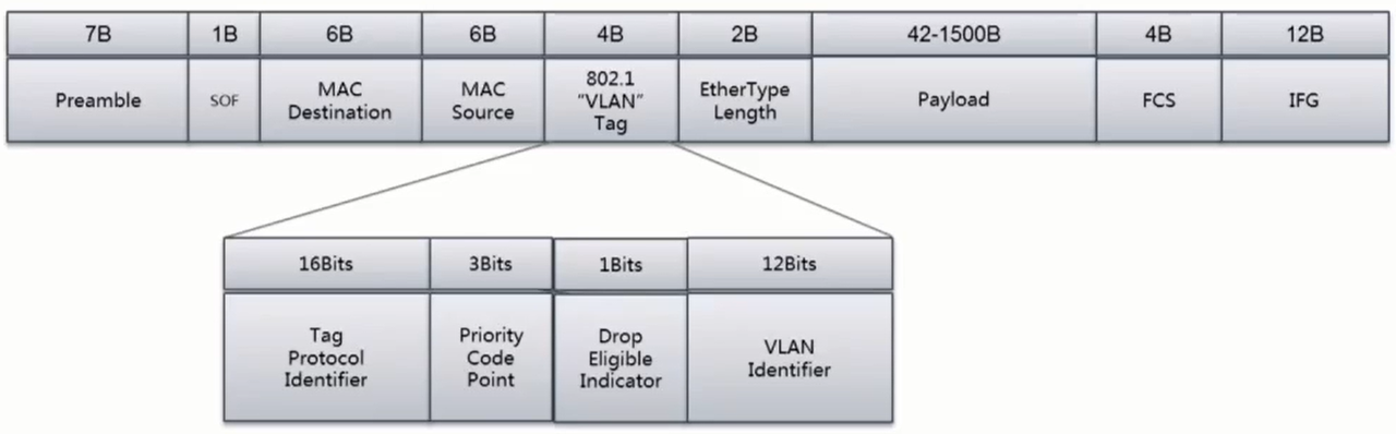

- The VLAN of the 802.1Q standard inserts 4 bytes into the standard Ethernet frame to define its characteristics. The tag bits of TSN are shown in the figure below:
- For TSN networks, services with different priorities or Classes of Service (CoS) correspond to the PCP code in the figure above. The Priority Code Point (PCP) consists of 3 bits; the 3-bit PCP code defines 8 priorities from 0 (lowest) to 7 (highest), with transmission types corresponding to Best Effort, Excellent Effort, Critical Applications, Video (<100ms delay and jitter), Audio (<10ms delay and jitter), Internetwork Control, and Network Control, respectively.

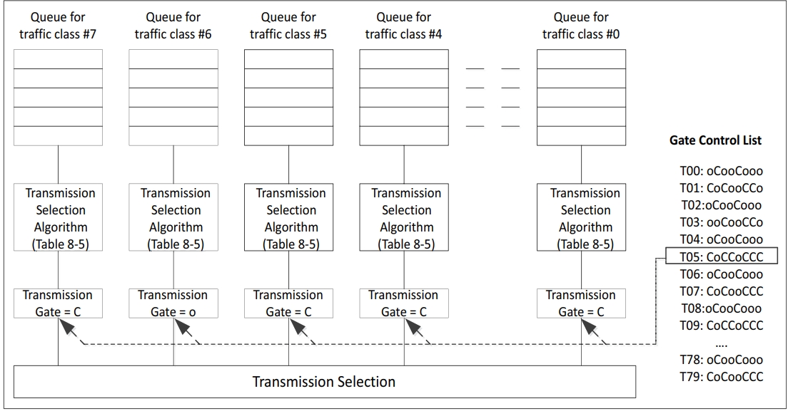

Enhancements to Scheduled Traffic (EST) (IEEE 802.1Qbv-2015)
- EST is defined by IEEE 802.1Qbv, also known as TAS (Time Awareness Shaper). It is a mechanism that dynamically provides on/off control for egress queues based on a pre-set periodic gate control list. Qbv defines a time window. This window is pre-determined in the mechanism. The gate control list is scanned periodically and opens transmission ports for different queues in a pre-defined order.
- Block diagram of the IEEE 802.1Qbv specification, illustrating how the gate control list manages gate close (C-close) and open (O-open) events based on the schedule provided for each event.
- The GCL has the following two parts:
- Time interval: Defines the time, in nanoseconds, for which the gate control item is valid before reading the next gate control item from the list.
- Gate control: Defines the state of the gate for each TC, either logic 1 indicating open (O-open) or logic 0 indicating close (C-close).

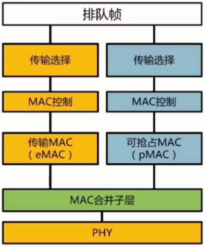

Frame Preemption (FPE) (IEEE 802.1Qbu-2016)
- To address the waste of protection bandwidth and priority inversion issues of EST, the preemption standard was introduced. Therefore, TSN's 802.1Qbu and the IEEE 802.3 working group jointly developed IEEE 802.3br, the preemptable MAC mechanism, consisting of pMAC (Preemptable MAC) and eMAC (express MAC). pMAC can be preempted by eMAC. Through preemption, the protection bandwidth can be reduced to the shortest low-priority frame fragment.
tip
- Since preemption changes the frame format, the peer switch also needs to support FPE when connecting.
