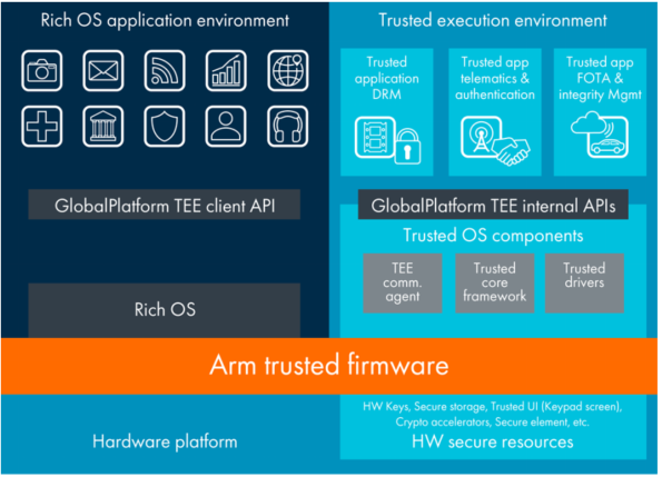

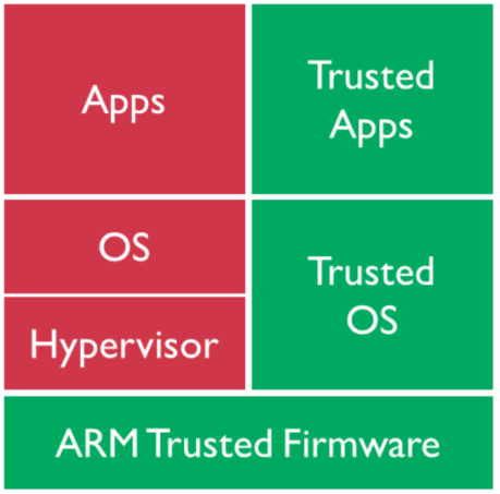

System Architecture
From a system architecture perspective, the following diagram illustrates the system architecture of a 64-bit platform with ARM TrustZone enabled. The entire system is divided into two worlds: the non-secure world on the left, and the secure world on the right. The secure world has access to all resources in both worlds, while the non-secure world can only access resources within its own world. Any attempt by the non-secure world to access secure world resources will result in system bus errors or exceptions, preventing unauthorized access.
Communication between these two worlds requires ARM Trusted Firmware as a bridge. When the CPU is operating in the non-secure world and wishes to enter the secure world, it must first enter ARM Trusted Firmware (via ARM’s SMC hardware instruction). The Secure Monitor code within ARM Trusted Firmware switches the CPU from non-secure to secure state, after which the CPU enters the secure world under secure identity. The reverse process works similarly. This transition between secure and non-secure states is entirely hardware-enforced.
The TEE on the X5 platform can be understood as the combined functionality of ARM Trusted Firmware and OP-TEE OS, implementing both the required secure world functions and the Secure Monitor (the core code responsible for transitions between the two worlds).

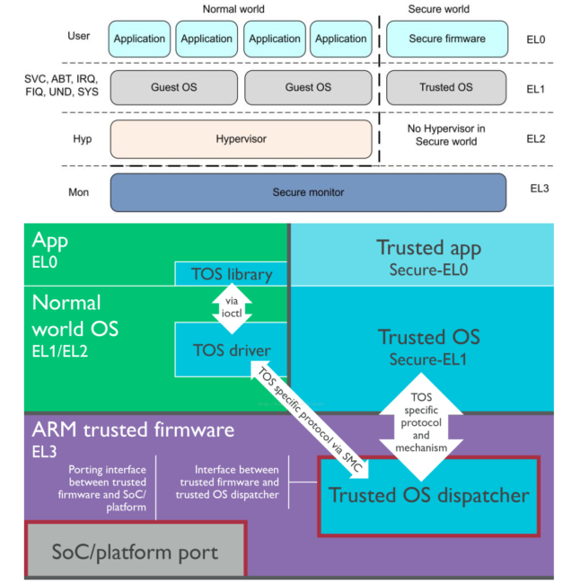

CPU Privilege Levels
From the CPU’s perspective, the following diagram shows a standard CPU privilege level architecture with ARM TrustZone enabled. The privilege levels are divided into EL0, EL1, EL2, and EL3, and further categorized by the world the CPU is operating in—either secure EL0, secure EL1, or non-secure EL0, non-secure EL1.
../../../../_images/exception_level.png
The TEE on the X5 platform can be understood as the combination of EL3 and secure EL1 functionalities.
