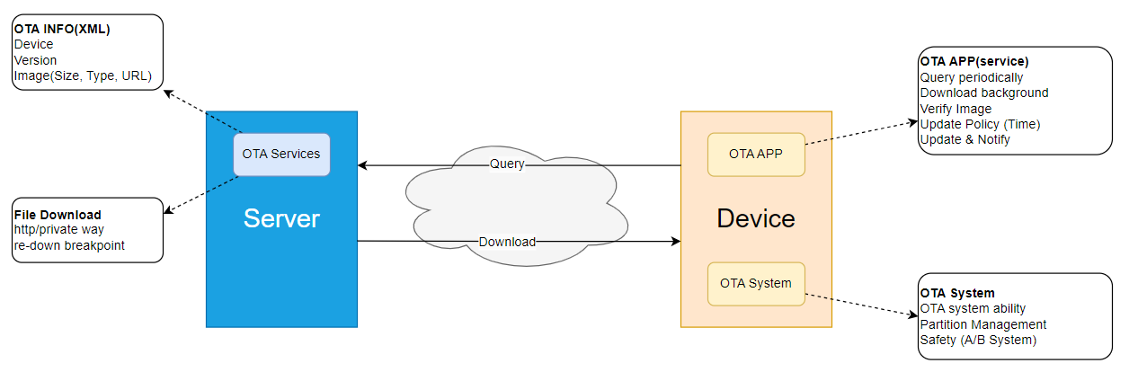

OTA: (Over-the-Air Technology) refers to the technology that enables remote software updates via wireless networks. Initially introduced by the Android system into mobile devices, OTA technology greatly simplifies traditional software update processes—users no longer need to connect their devices to a computer, and can directly download and install updates on the device itself. This technology significantly enhances user convenience and improves the efficiency of device maintenance.
ota_intro
  • In the broad application of OTA, it can be divided into two main components: the cloud side and the device side. The cloud side handles upgrade requests from devices, including performing upgrade verification, delivering update packages, and collecting upgrade results. The device side relies on the update package delivered from the cloud to complete updates for system firmware (FOTA, Firmware Over-the-Air) or applications (SOTA, Software Over-the-Air).
  • This document aims to provide a user manual for the low-level device-side OTA functionality, detailing the mechanisms and implementation methods of OTA in upgrading low-level system software and applications, along with relevant development guidance. It should be noted that the system software and applications upgraded via OTA primarily refer to data stored in external storage (such as eMMC).
  • The deliverables of OTA mainly consist of a set of APIs and their corresponding implementation libraries (e.g., libupdate.so), which implement critical functions such as low-level flashing and verification. The upper-layer OTA service architecture is implemented by the customer to interface with their cloud services. After successfully downloading the update package from the cloud, the OTA service calls interfaces within libupdate.so to perform version upgrades and verifications, ensuring the device completes the software update smoothly and securely.

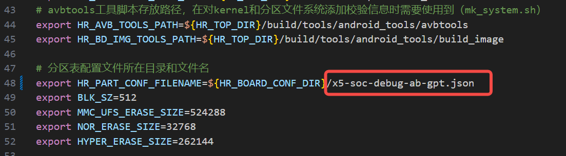

By default, the system uses single partition configuration; if AB partition format is required, the corresponding configuration files must be modified accordingly. The following example illustrates modifications using EVB configuration.
ab_config

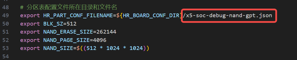

Currently, the specific NAND partition table is not listed. To ensure compatibility, we provide by default a minimal partition table and a dedicated AB-type NAND partition table designed for OTA upgrades, named “x5-soc-debug-nand-ab-ota-gpt.json”. Customers must modify this file according to their specific needs when using it. When switching partition types, please ensure to adjust the NAND_SIZE parameter accordingly. Refer to the diagram below for switching instructions.
nand_ab_config

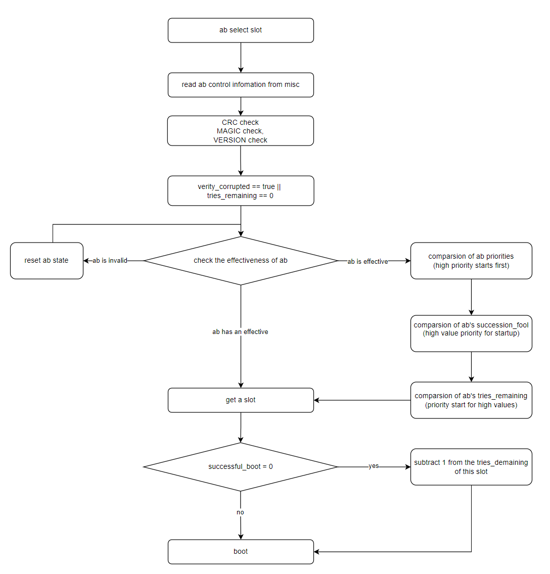

OTA upgrade supports Android’s AB seamless update mechanism, designed to efficiently upgrade system AB partitions.
AB partitions typically contain a complete set of images, referred to as two slots: a and b. During system boot, the system always boots from one selected _a or _b partition. The AB partition upgrade process uses an alternating update strategy. When the system is currently running on slot a, the OTA update will update slot b, ensuring the next boot starts from slot b, and vice versa—if the system is running on slot b, the OTA update will target slot a.
This alternating update mechanism automatically triggers a rollback upon upgrade failure, ensuring the system can revert to its stable pre-upgrade state. After power-on boot, a program named “ab select” runs during the second stage of the bootloader (bl2) to select the appropriate slot (a or b), ensuring the subsequent system boots from that slot.
bl2_ab

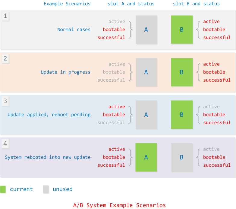

In system partition management, there are typically two main partitions: slot_a and slot_b. By design, only one partition can be marked as active, while both partitions can simultaneously have bootable and successful attributes.
The figure below illustrates four states during the upgrade process, showing the state transitions of the two partitions (using upgrading a from b as an example):
ab
  • State 1: Default state, both ab slots are bootable. Slot b has higher priority than slot a, so the system defaults to booting from slot b.
slot_a = {
    .priority = 14,         //14 or lower
    .tries_remaining = 1,
    .successful_boot = 1,
    .verity_corrupted = 0,
    .reserved = 0
slot_b = {
    .priority = 15,         //15
    .reserved = 0
  • State 2: Upgrade state (flashing state), slot a is unbootable and boot success is 0.
slot_a = {
    .tries_remaining = 0,   //tries_remaining is 0
    .successful_boot = 0,   //successful_boot is set to 0
    .reserved = 0
slot_b = {
    .reserved = 0
Exception Handling: Next boot will start from slot b.
  • State 3: Flashing successful, but not yet rebooted. At this point, the target upgrade slot a is set to active, and the current slot b is set to non-active (priority adjusted).
slot_a = {
    .tries_remaining = 1,   //tries_remaining is 1
    .successful_boot = 0,   //successful_boot is 0
    .reserved = 0
slot_b = {
    .reserved = 0
Exception Handling: If slot a fails verification upon reboot and does not reach successful_boot, tries_remaining will be decremented by 1 during the ab select phase in bl2, making slot a unbootable (equivalent to transitioning back to State 2). The next boot will then start from slot b.
  • State 4: Reboot verification successful, set slot a to successful boot state.
slot_a = {
    .successful_boot = 1,   //successful_boot is 1
    .reserved = 0
slot_b = {
    .reserved = 0
For detailed principles and implementation, please refer to the official documentation: OTA Updates

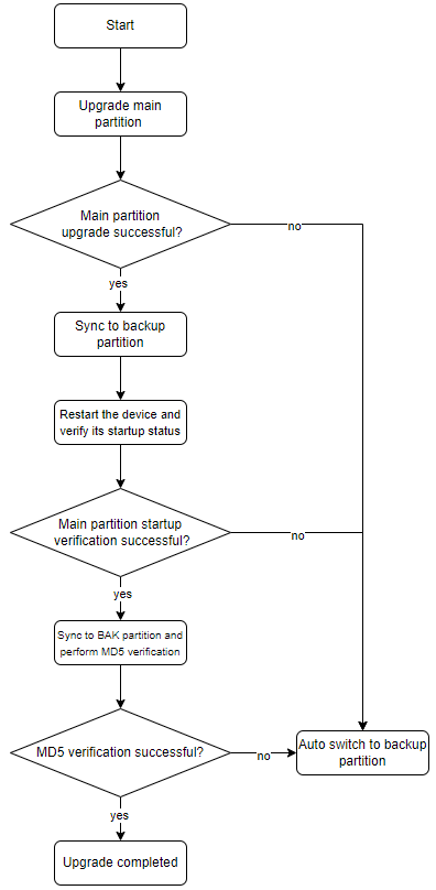

BAK Upgrade
In the device architecture, the miniboot partition is defined as a BAK-type partition. The main function of BAK partitions is to attempt booting from the primary partition first during startup; if the primary partition fails to boot, the system will sequentially switch to the backup partition. Therefore, upgrading using the BAK method is particularly important.
BAK Partition Upgrade Process:
bak_upgrade
  • Upgrade operations are performed only on the primary partition, ensuring the security and integrity of its content.
  • After the primary partition upgrade is completed and verified, the system synchronizes the content to the backup partition to maintain data consistency and recoverability.
  • Then, the device restarts and re-verifies the boot status of the primary partition.
  • If verification succeeds, the content of the primary partition is again synchronized to the BAK partition, and an MD5 checksum is performed to ensure data integrity. If verification fails, the system automatically switches to the BAK partition to ensure device availability.
The following is a detailed analysis of this process:
  1. Start:
    • The process begins at the start node.
  2. Upgrade Main Partition:
    • First, perform the upgrade operation on the primary partition—this step writes the new firmware or software into the primary partition. The upgrade operation is performed only on the primary partition to ensure its content’s security and integrity.
  3. Main Partition Upgrade Successful?:
    • Check whether the primary partition upgrade was successful.
    • If failed (no), the process ends.
    • If successful (yes), proceed to the next step.
  4. Sync to Backup Partition:
    • Synchronize the upgraded primary partition data to the backup partition. This step ensures the backup partition has the latest data for recovery when needed.
  5. Restart Device and Verify Startup Status:
    • Restart the device to apply the new upgrade.
    • Verify whether the device can boot normally.
  6. Main Partition Startup Verification Successful?:
    • Check whether the primary partition functions normally after boot.
    • If verification fails (no), automatically switch to the backup partition to ensure system stability.
    • If verification succeeds (yes), proceed to the next step.
  7. Sync to BAK Partition and Perform MD5 Verification:
    • Synchronize data to the BAK partition and perform MD5 checksum to ensure data integrity and consistency.
  8. MD5 Verification Successful?:
    • Check whether the MD5 checksum passes.
    • If verification succeeds (yes), proceed.
  9. Upgrade Completed:
    • After all steps are successfully completed, the upgrade process ends, and the system is in the latest state.

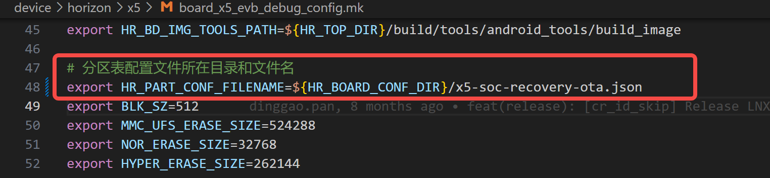

  • Configuration steps (using eMMC version as example):

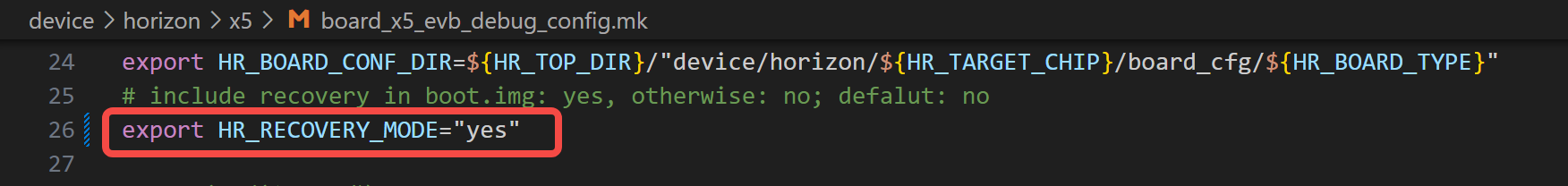

    1. Set the HR_RECOVERY_MODE variable in the board-level configuration file to “yes” to enable system support for recovery mode;
      recovery_config
    2. Use a partition table configuration file that supports GOLDEN upgrade;
      recovery_partition

  2. Modify the configuration file device/horizon/x5/board_x5_evb_debug_config.mk:
    • If the BL2 chip is signed with the customer’s RSA key hash (X5 Customer root rsa key hash programming and usage), both secure and non-secure antirollback domains will have rollback checks enabled; if the BL2 chip is signed with D-Robotics’ key, only the non-secure antirollback domain supports rollback checks after enabling secure boot. For chips with customer-signed BL2, set the following variable:
          export HR_ENABLE_CUSTOMER_KEY="yes"
    • Modify the HR_PART_CONF_FILENAME variable. Since only AB-formatted partitions under eMMC media support image rollback protection, use the x5-soc-debug-ab-gpt.json configuration file. If customers use a custom partition configuration file, ensure it is AB-formatted;
          export HR_PART_CONF_FILENAME=${HR_BOARD_CONF_DIR}/x5-soc-debug-ab-gpt.json

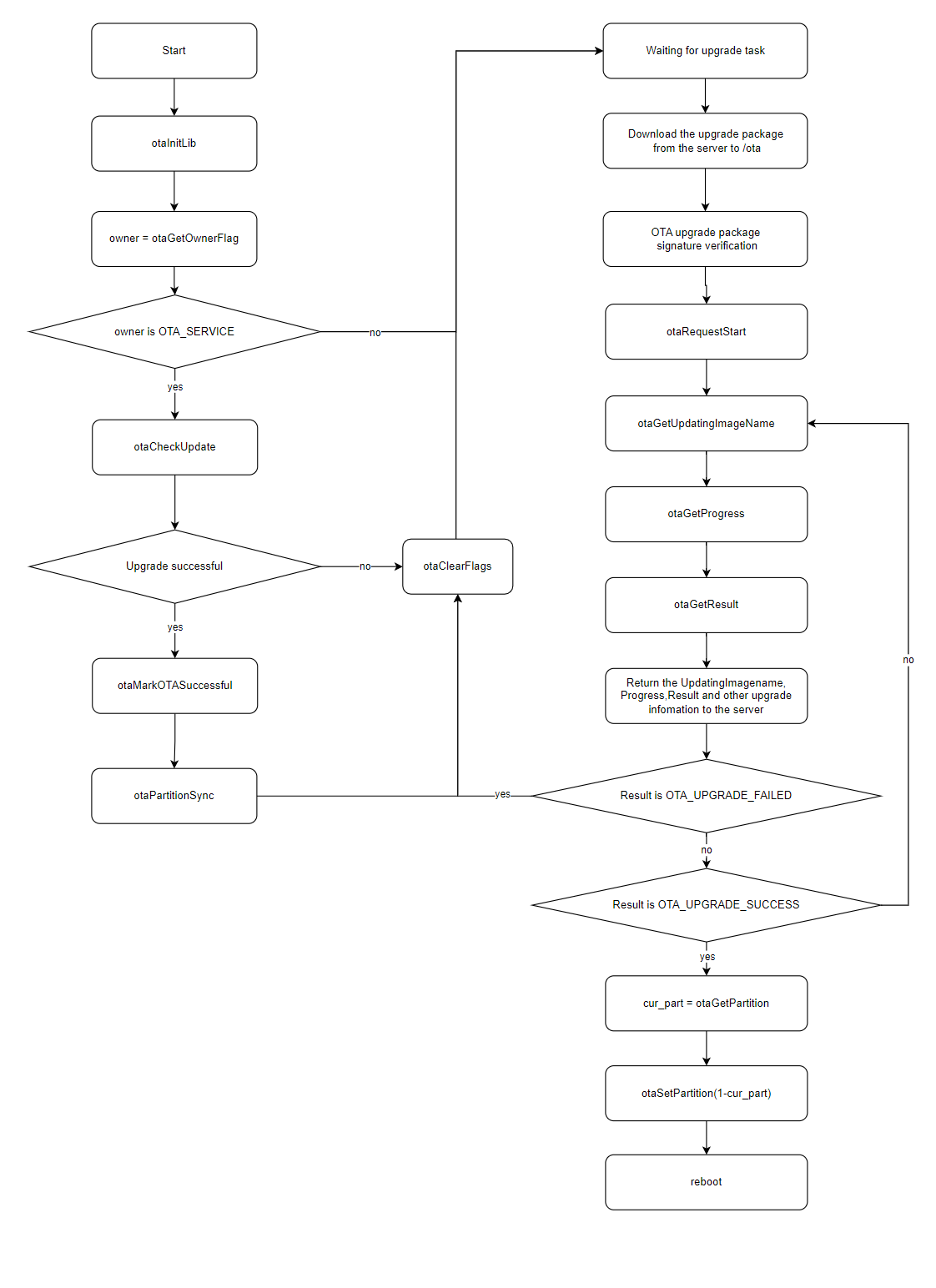

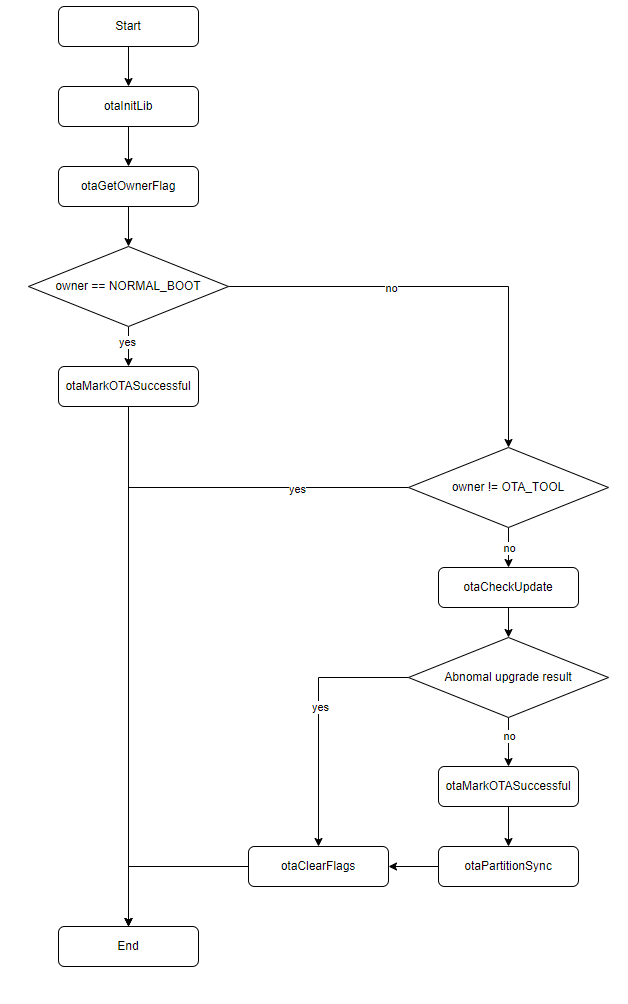

OTA Upgrade Process
  1. The OTA service downloads the update package from the cloud and performs verification. If an OTA partition exists, it downloads the package to /ota; otherwise, it downloads to /userdata. At this time, it also calls otaInitLib to initialize the dynamic library.
  2. An upgrade request is initiated by calling otaRequestStart. This API decompresses the ota_process program from the update package and creates a child process to execute this program for actual image flashing. Meanwhile, this API also creates a file lock to prevent multiple upgrades from occurring simultaneously and creates a pipe file to facilitate communication with ota_process. Additionally, a thread is started to periodically read from the pipe to obtain real-time upgrade progress, results, and partition information.
  3. During the child process upgrade phase, the OTA Service can call otaGetResult to get the upgrade result, otaGetProgress to get the upgrade progress, and otaGetUpdatingImageName to get the image currently being upgraded.
  4. When otaGetResult returns OTA_UPGRADE_SUCCESS, it indicates that the image has been successfully flashed, and the system enters the verification phase.
  5. Call otaSetPartition to set the next boot partition to the opposite slot and initiate the reboot process.
  6. After rebooting, the OTA Service calls otaGetOwnerFlag to get the upgrade owner. If the owner is the OTA Service, it will be responsible for verifying this upgrade and enters the verification process.
  7. Call otaCheckUpdate to get the upgrade result. This API primarily checks whether the image has been completely written and whether the system boots from the expected AB slot or BAK slot.
  8. Call otaMarkOTASuccessful to mark the current partition boot as successful. This API operates the AB state machine, marking the current slot as boot_successful, ensuring subsequent boots will occur from this slot. If any reboot occurs before this step, the next boot will revert to the slot containing the old version image, indicating upgrade failure.
  9. Call otaPartitionSync to synchronize the BAK partition, ensuring the BAK partition content matches the primary partition content.
  10. Finally, call otaClearFlags to clear upgrade markers, completing the entire upgrade process.
Upgrade flowchart as follows:

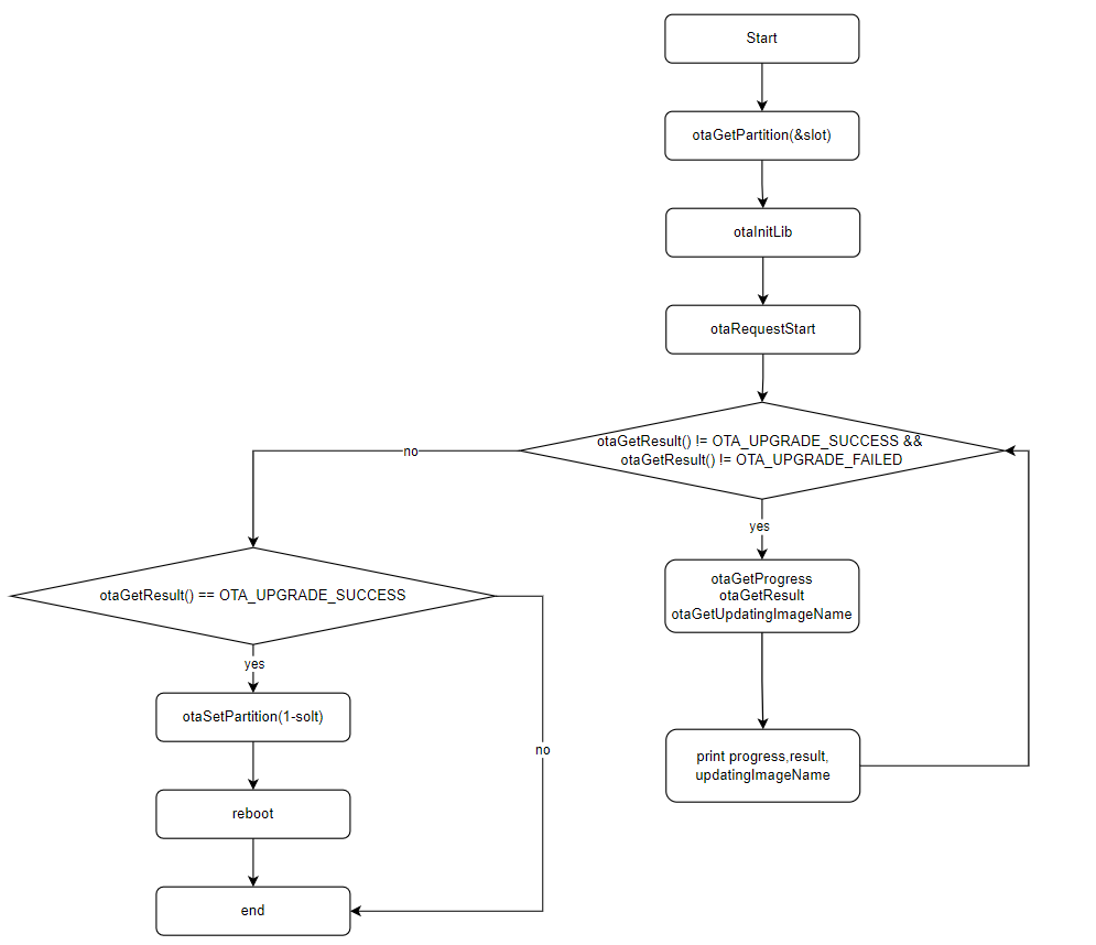

ota_tool Implementation
ota_tool is implemented in C, with the main source file being hbre/otaupdate/src/ota_tool/otainterface.c. It implements functions such as retrieving system software version, setting/getting ab slot, OTA package signature verification, OTA upgrade, upgrade progress display, and reboot detection.
The first half of the main function is responsible for parsing input parameters. For example, if the -c parameter is passed, the corresponding signature file is used to verify the upgrade package.
Finally, the ota_update_all_img function is called to initiate the upgrade process.
ota_update_all_img Implementation
static int32_t ota_update_all_img(const char *zip_path)
	int32_t progress = 0;
	uint8_t		    slot = 0;
	uint8_t		    next_slot = 0;
	int32_t		    ret = 0;
	ota_update_result_e result = 0;
	char		    part_name[ARRAY_32] = { 0 };
	ret = otaGetPartition(&slot);
	if (ret < 0) {
		return ret;
	if (slot == 2) {
		next_slot = 0;
		printf("The slot [%d] to be burned\n", next_slot);
	} else {
		next_slot = 1 - slot;
	ret = otaInitLib();
	if (ret < 0) {
		printf("error:init failed!\n");
		return ret;
	ret = otaRequestStart(zip_path, OTA_TOOL);
	if (ret < 0) {
		printf("error: start ota update failed!\n");
		ret = -1;
		goto err;
	while (otaGetResult() != OTA_UPGRADE_SUCCESS && otaGetResult() != OTA_UPGRADE_FAILED) {
		progress = otaGetProgress();
		result = otaGetResult();
		otaGetUpdatingImageName(part_name, sizeof(part_name));
		if (result == UPGRADE_FAILED) {
			printf("error: ota update failed!\n");
			ret = -1;
			break;
		OTA_show_Process_Bar(part_name, progress,
				     "OTA is upgrading ...");
		usleep(100 * 1000);
err:
	if (otaGetResult() == OTA_UPGRADE_SUCCESS) {
		ret = otaSetPartition(next_slot);
		if (ret < 0) {
			printf("error: set partition failed!\n");
			return ret;
		if (g_is_reboot == true) {
			printf("reboot system!\n");
			ota_system_exe("reboot");
		} else {
			printf("ota update success and waiting for reboot!\n");
	otaDeinitLib();
	return ret;
  1. Call otaGetPartition to get the current ab slot.
  2. Call otaInitLib to initialize the libupdate.so library.
  3. Call otaRequestStart with the upgrade package path and owner (OTA_TOOL) to start the upgrade.
  4. Wait for otaGetResult to return OTA_UPGRADE_SUCCESS or OTA_UPGRADE_FAILED. During this time, call otaGetProgress, otaGetResult, and otaGetUpdatingImageName to get upgrade progress, result, and the image being upgraded, and print progress on the console via OTA_show_Process_Bar.
  5. If otaGetResult returns OTA_UPGRADE_SUCCESS, consider the upgrade successful, call otaSetPartition to set the ab slot to the opposite slot, and reboot the system according to configuration.
otatool-ota_update_all_img
ota_boot_check Implementation
After system boot, an S99ota_update_check service is started, which calls ota_tool -b to perform upgrade verification, entering the ota_boot_check process.
int32_t ota_boot_check(void)
	int32_t		      ret = 0;
	enum ota_update_owner owner = 0;
	if ((ret = otaInitLib()) != 0) {
		printf("error: init failed!\n");
		return ret;
	if ((ret = otaGetOwnerFlag(&owner)) != 0) {
		printf("error: Get owner flag failed!\n");
		goto exit;
	if (owner == NORMAL_BOOT) {
		printf("Normal boot\n");
		if ((ret = otaMarkOTASuccessful()) != 0) {
			printf("error: mark boot success failed\n");
		return ret;
	if (owner != OTA_TOOL) {
		printf("ota_tool is not owner, owner is [%d]\n", owner);
		return otaDeinitLib();
	if ((ret = otaCheckUpdate()) != 0) {
		printf("error: boot check failed\n");
		goto exit;
		goto exit;
	if ((ret = otaPartitionSync()) != 0) {
		printf("error: partition sync failed\n");
		goto exit;
exit:
	otaClearFlags();
	otaDeinitLib();
	return ret;
  1. Call otaInitLib to initialize the library.
  2. Call otaGetOwnerFlag to get the current update owner.
  3. If the owner is NORMAL_BOOT, call otaMarkOTASuccessful to mark boot as successful, then exit.
  4. If the owner is not OTA_TOOL, exit normally and wait for another owner to perform the reboot check.
  5. Call otaCheckUpdate to obtain the update result. If the result is abnormal, call otaClearFlags to clear the OTA flags and terminate the OTA process.
  6. Call otaMarkOTASuccessful to mark the boot as successful.
  7. Call otaPartitionSync to synchronize the A/B partitions with the BAK partition. If this call returns a non-zero value, the synchronization between A/B and BAK partitions has failed, leaving the affected partitions in an unusable state. A new OTA update must be performed to repair the corresponding A/B and BAK partitions.
The ota_boot_check flowchart is shown below:
otatool-ota_boot_check
