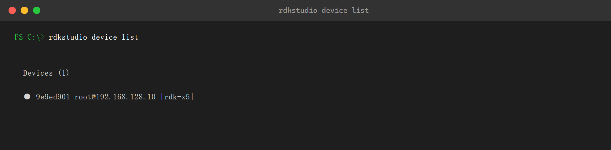

rdkstudio device list output: lists connected RDK X5 devices

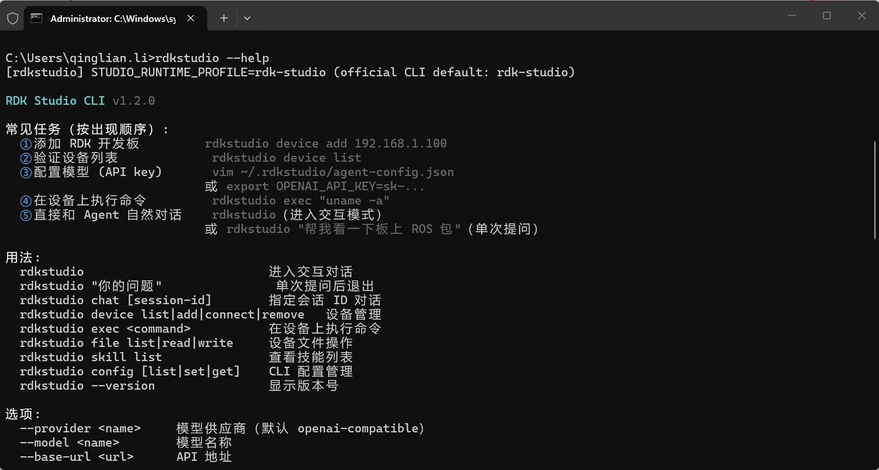

Verifying Installation
rdkstudio --version
rdkstudio --help
These commands should print the version number (matching the desktop client) and help information. Typical output of rdkstudio --help:
RDK Studio CLI v1.1.0
Common Tasks (in order of appearance)
· Add an RDK dev board rdkstudio device add 192.168.1.100
· Verify device list rdkstudio device list
· Configure model (API key) vim ~/.rdkstudio/agent-config.json
· export OPENAI_API_KEY=sk-...
· Execute command on device rdkstudio exec "uname -a"
· Chat naturally with Agent rdkstudio (enters interactive mode)
· rdkstudio "Check ROS nodes on the board" (single query)
Usage:
rdkstudio Enter interactive chat
rdkstudio "your question" Ask once and exit
rdkstudio chat [session-id] Chat with specified session ID
rdkstudio device list|add|connect|remove Device management
rdkstudio exec <command> Execute command on device
rdkstudio file list|read|write File operations on device
rdkstudio skill list List available skills
rdkstudio config [list|set|get] CLI configuration management
rdkstudio --version Show version
Options:
--provider <name> Model provider (default: openai-compatible)
--model <name> Model name
--base-url <url> API endpoint URL
--api-key <key> API key
--agent <id> Agent ID (default: main)
--pipe Pipe mode (read from stdin, plain-text output)
--approval Enable tool approval (on-miss mode)
--approval always Require approval for every tool call
Add --help to any subcommand for detailed examples, e.g., rdkstudio device --help.
