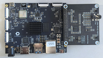

  • Audio sub-board, for voice function testing

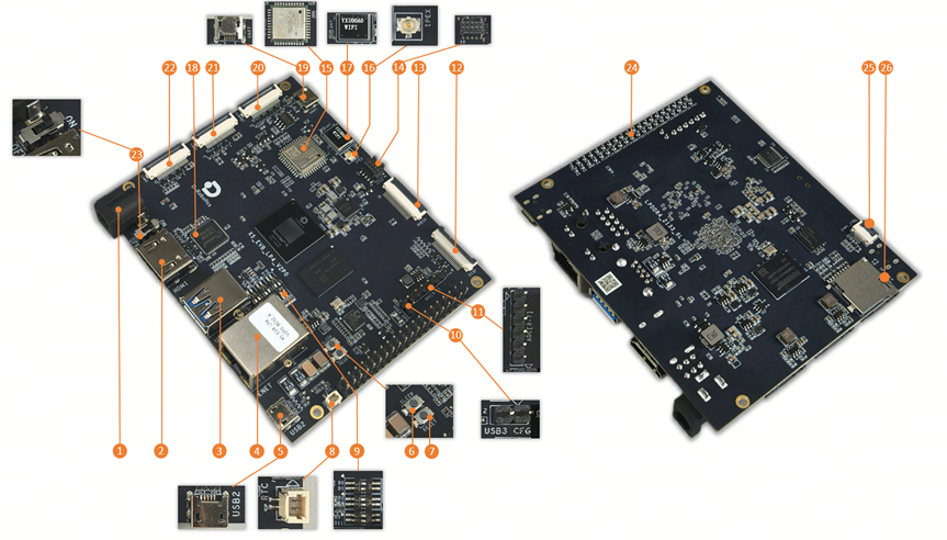

2.2.2. Functional Module Layout
image-20250525102507117
Interface Function Interface Function
1 12V DC power adapter interface 14 JTAG debugging interface
2 HDMI Type-A interface, supports up to 4K@30 output 15 Wi-Fi 6 & Bluetooth 5.4 module FCS960KAAMD
3 USB 3.0 Type-A interface 16 IPEX Antenna (Bluetooth antenna interface)
4 Gigabit Ethernet interface 17 Wi-Fi SMD Antenna, 2400–2500 MHz; 5150–7125 MHz
5 Micro USB 2.0 data interface 18 Low-power HDMI 1.4 transmitter, LT8618SXB
6 Reset function button 19 Micro USB 2.0 debug serial port
7 Wake-up function button 20 4-lane MIPI CSI interface (can be split into 2 x 2-lane MIPI CSI interfaces via expansion board)

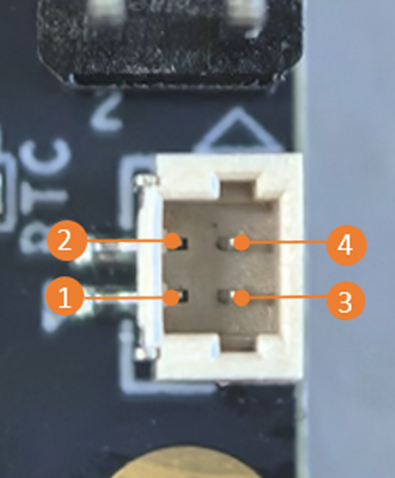

8 RTC external power supply interface 21 2-lane MIPI CSI interface
9 Boot configuration DIP switch, for selecting boot mode 22 2-lane MIPI CSI interface
10 USB 3.0 host/device mode switching interface 23 Power switch

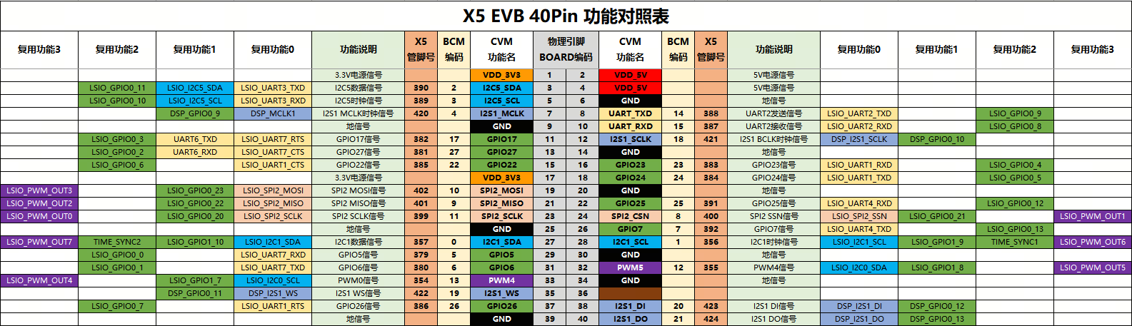

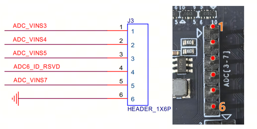

11 ADC[3-7] functional pins 24 40PIN functional pins, supporting UART, I2C, SPI, PWM, I2S
12 4-lane MIPI DSI interface 25 Independent I2C interface, can be used to expand MIPI CSI interface
13 I2S&PDM audio interface 26 TF card interface

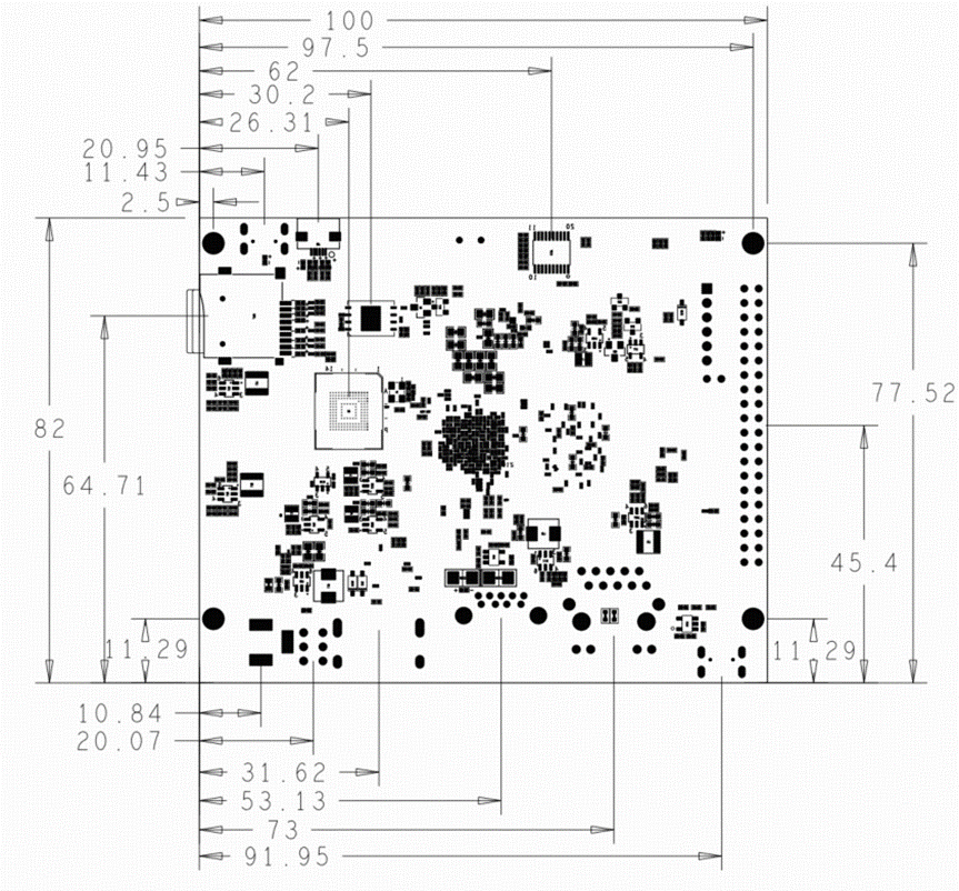

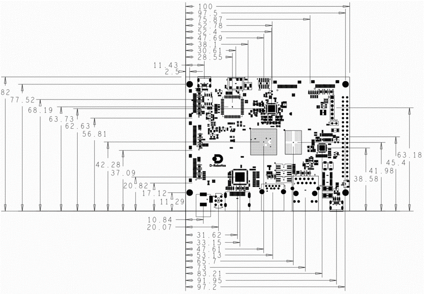

2.2.2.1. Dimension Diagram
image-20250525103157887
image-20250525103208120

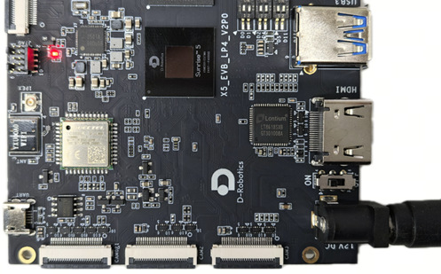

2.2.3.1. Powering On the Development Board
Please follow the steps below to set up and power on the development board.
  • Before powering on, ensure the boot configuration DIP switch (Interface 9) is set to D0/D5: ON, D1/D2/D4/D11: OFF, indicating boot from eMMC, serial port baud rate 115200, and eMMC latching data on the clock rising edge, as shown in the figure below:
    image-20250525103334208
  • Connect the 12V power adapter (Interface 1), turn on the power switch (Interface 23), and the red indicator light will illuminate, indicating normal power supply to the board.
    image-20250525103441164
Note: If the power indicator is on but no output appears on the debug serial port, please verify the DIP switch settings.

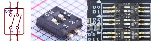

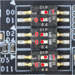

2.2.3.2. DIP Switch
The DIP switch (Interface 9) determines the boot mode configuration and debug serial port baud rate of the development board, allowing users to configure different operating modes.
The internal structure and physical appearance of the DIP switch are shown in the figure below. When set to ON, it indicates a high-level signal 1.
image-20240424225353367
  • D5, D2, D1, D0 correspond to the 2NDBOOT_SEL pin of the X5 chip, used to determine the board’s boot mode.
  • D4 corresponds to the UART_BPS pin of the X5 chip, used to set the debug serial port baud rate.
  • D11 corresponds to the EMMC_CLK_LATCH pin of the X5 chip, used to select the clock edge for eMMC data sampling.
The corresponding DIP switch truth table is as follows:
2NDBOOT_SEL Value Option Boot Mode Description
D5, D2, D1, D0 1000 2NDBOOT UART Boot from UART interface
1001 2NDBOOT eMMC Boot from eMMC storage device
0010 2NDBOOT USB2.0 DFU Boot from USB2.0 DFU (Device Firmware Upgrade) interface, via Dp/Dm
1011 2NDBOOT SD Card Boot from SD card
1100 2NDBOOT QSPI NOR Flash Boot from QSPI NOR Flash storage device
1101 2NDBOOT QSPI NAND Flash Boot from QSPI NAND Flash storage device
0110 2NDBOOT USB3.0 DFU Boot from USB3.0 DFU (Device Firmware Upgrade) interface, via Dp/Dm
1111 2NDBOOT QSPI NAND Flash (disable mmu) Boot from QSPI NAND Flash storage device with MMU disabled during boot
Note: X5 burning only supports the USB 2.0 protocol. Regardless of whether the USB 2.0 or USB 3.0 interface is used, it is burned according to the USB 2.0 protocol, and the maximum speed is 480Mbps.
Note: To boot the board from USB DFU, D5 must be configured to low level (0).

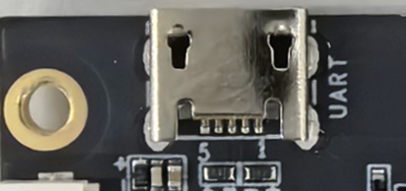

2.2.3.3. Debug Serial Port
The development board provides one debug serial port, corresponding to Interface 19. The board uses a CH340N USB-to-serial chip to convert the serial signal to a USB interface. Users can connect a Micro USB data cable to enable serial communication between the PC and the development board.

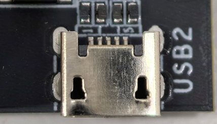

2.2.3.6. USB 2.0 Interface
The development board provides one Micro USB 2.0 interface, corresponding to Interface 5, supporting OTG functionality.
image-20250525104844207
Main applications of this interface include:
  • Functional debugging, defaulting to adb mode, with support for switching to rndis, uvc, etc.
  • Image flashing, supporting dfu, fastboot, and other flashing modes
  • Peripheral connection, enabling various USB peripherals via an OTG cable

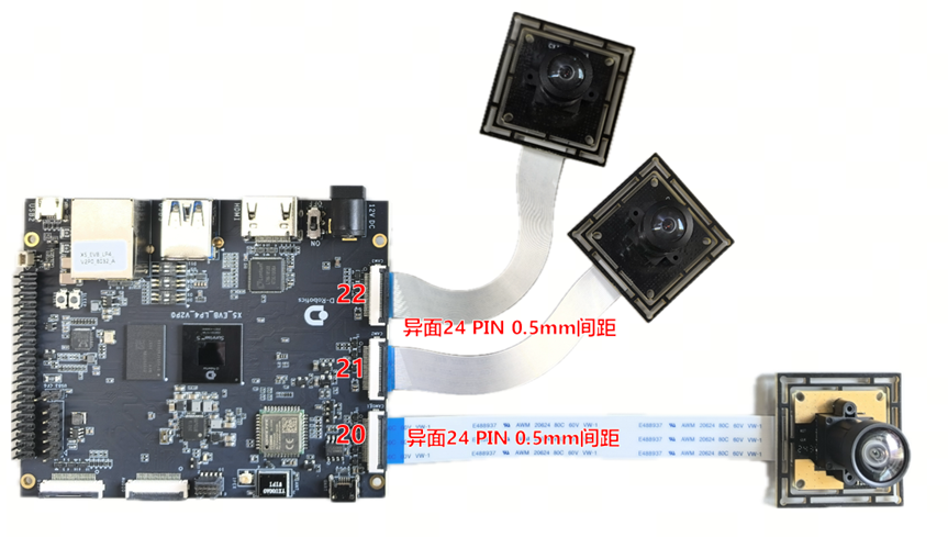

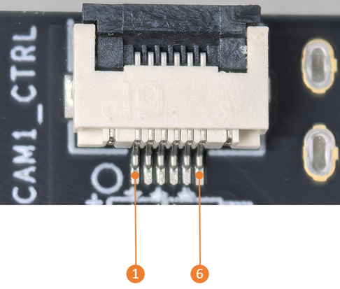

2.2.3.7. Camera (MIPI CSI) Interface
The development board provides 3 MIPI CSI interfaces, corresponding to Interfaces 20, 21, and 22.
Capabilities and configurations of the three interfaces are listed in the table below:
Interface MIPI CSI Host Max Supported Lanes I2C Bus Reset GPIO
20 MIPI_CSI0&1 4 lanes I2C4 AON_GPIO_PIN0 - 498
21 MIPI_CSI2 2 lanes I2C2 AON_GPIO_PIN4 - 502
22 MIPI_CSI3 2 lanes I2C7 LSIO_GPIO1_06 - 353
Note: Interface 20’s MIPI CSI0&1 can be split into two 2-lane MIPI CSI interfaces (MIPI CSI0 and MIPI CSI1) using an external expansion board.
Currently supported camera modules include SC230AI, SC132gs, IMX415, and others, enabling users to test various imaging scenarios. For the complete list of supported Camera Sensors, please refer to Camera Sensor Support List.
Camera modules are connected to the board’s camera interface via a 24PIN flex cable. Pay attention to the orientation when connecting, as shown in the figure below:
image-20250525104903968
The number of MIPI lanes used by the camera module is the sole factor determining interface selection. Examples:
  • The SC132gs module uses 2 lanes, so it can be connected to any of Interfaces 20, 21, or 22.
  • The IMX415 module uses 4 lanes, so it can only be connected to a 4-lane interface, i.e., Interface 20.
After installation, use commands to verify if the module’s I2C address is detected. If not detected, check the FPC connection for poor contact or incorrect orientation.

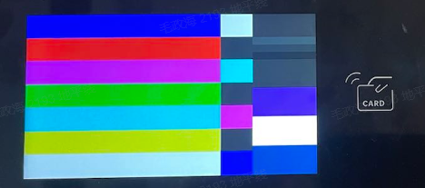

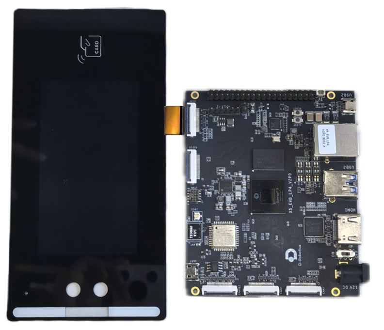

2.2.3.9. LCD (MIPI DSI) and TP Interface
The development board supports MIPI DSI and touchscreen interfaces, corresponding to Interface 12, requiring connection to a compatible display, as shown in the figure below:
image-20250525105009502
After successfully entering the Linux system, load the drivers using the following commands:

Test using the command: modetest -M vs-drm -a -s 73@31:720x1280 -P 33@31:720x1280@NV12.
The connected screen will light up, displaying a pattern as shown in the figure below:
image-20240426174508923

2.2.3.14. 40-Pin Interface
The development board provides one 40-pin interface (Connector 24), for easy expansion of peripheral interfaces. Pin definitions and supported multiplexing functions are shown below:
image-20250331-120318

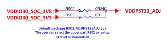

All IO pins on the 40-pin interface default to the 3.3V voltage domain. The voltage domain can be switched between 3.3V and 1.8V by adjusting resistors R903 and R902.
VDDPST33ADJ
Warning: U-Boot code must be updated accordingly when switching voltage domains. Failure to do so may result in a mismatch between software configuration and actual power supply, potentially causing chip damage.
Connection Example:
Below is a hardware reference connection diagram for an Audio Driver HAT:
image-20250525105101571
2.2.3.15. RTC
The development board uses an external RTC circuit and an external battery to maintain system time after power-off. The RTC battery connector (Connector 8) is defined as follows:
image-20250525105136462
Connector Type: JST_1X2P_PITCH1
No. Name Description
1 VRTC Battery positive, 3.3V
2,3,4 GND Battery negative, ground reference
Note: The X5 EVB V2P0 board does not have an external RTC; it only includes the RTC built into the X5 SOC. After booting, check the boot log to confirm the related messages from the X5 SOC’s internal RTC:

2.2.3.16. ADC Interface
Connector 11 is the ADC (Analog-to-Digital Converter) interface on the development board. It provides five pins labeled ADC[3-7], used to connect analog signal sources and convert analog signals into digital signals for system processing. Users can read corresponding system files to obtain the converted ADC values.
  • Input Voltage Range: The supported input voltage range for the ADC is 0.1~1.7V. Users must ensure that the input signal voltage stays within this range to avoid signal distortion or ADC damage.
    image-20250525105335886
Reading ADC Values
Read the system files /sys/bus/iio/devices/iio:device0/in_voltage3_raw to /sys/bus/iio/devices/iio:device0/in_voltage7_raw to obtain raw ADC values from channels ADC[3-7]. For example, to read the value from ADC3, use the following command:
root@buildroot:~$ cat /sys/bus/iio/devices/iio:device0/in_voltage3_raw
1020
This command outputs the raw digital value converted from channel ADC3. Users can read values from ADC[3-7] by replacing in_voltage3_raw in the command with the corresponding in_voltageX_raw (where X ranges from 3 to 7).
