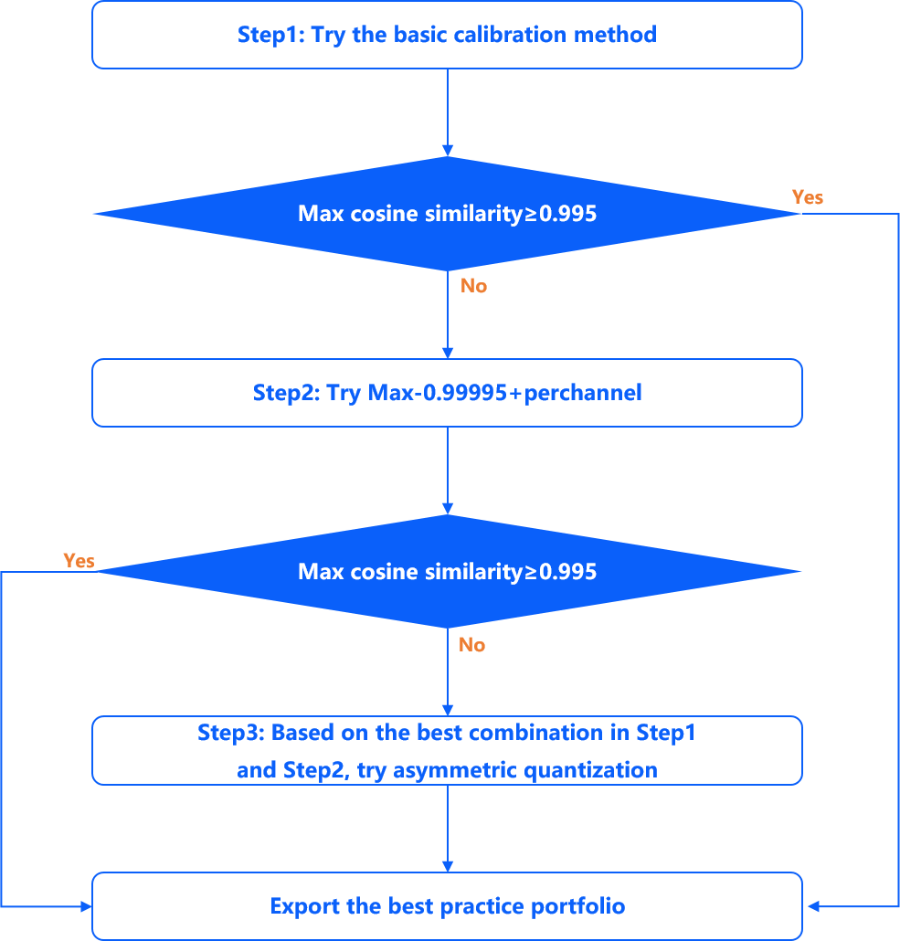

4.1.1.10.5. How to understand D-Robotics’ default calibration method?
To reduce the user’s workload in debugging calibration solutions, D-Robotics provides a default auto-search strategy, whose current internal logic is as follows:
../../../../_images/faq_default.png
  • Step1: Try the Max, Max-Percentile 0.99995 and KL calibration methods to calculate the respective cosine similarity. If the highest cosine similarity among the three methods is less than 0.995, go to Step2; if not, return the threshold combination corresponding to the highest similarity.
  • Step2: Try the combination of Max-Percentile 0.99995 and perchannel quantization methods, if the highest cosine similarity is also less than 0.995, go to Step3. if not, return the threshold combination corresponding to the highest similarity.
  • Step3: Select the method corresponding to the highest cosine similarity in Step2, apply asymmetric quantization as the 5th method, and select the best solution among the 5 solutions according to the cosine similarity, return the corresponding threshold combinations.

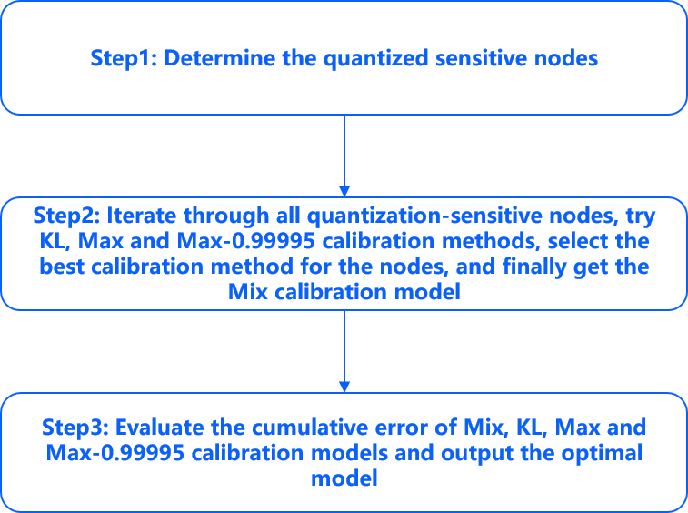

4.1.1.10.6. How to understand D-Robotics’ mix calibration method?
To integrate the advantages of different calibration methods, D-Robotics offers a mix search strategy, which currently has the following internal logic:
../../../../_images/faq_mix.png
  • Step1: Determine the quantized sensitive nodes.
  • Step2: Iterate through all quantization-sensitive nodes, try KL, Max and Max-0.99995 calibration methods, select the best calibration method for the nodes, and then get the Mix calibration model.
  • Step3: Evaluate the cumulative error of Mix, KL, Max and Max-0.99995 calibration models and output the optimal model.
