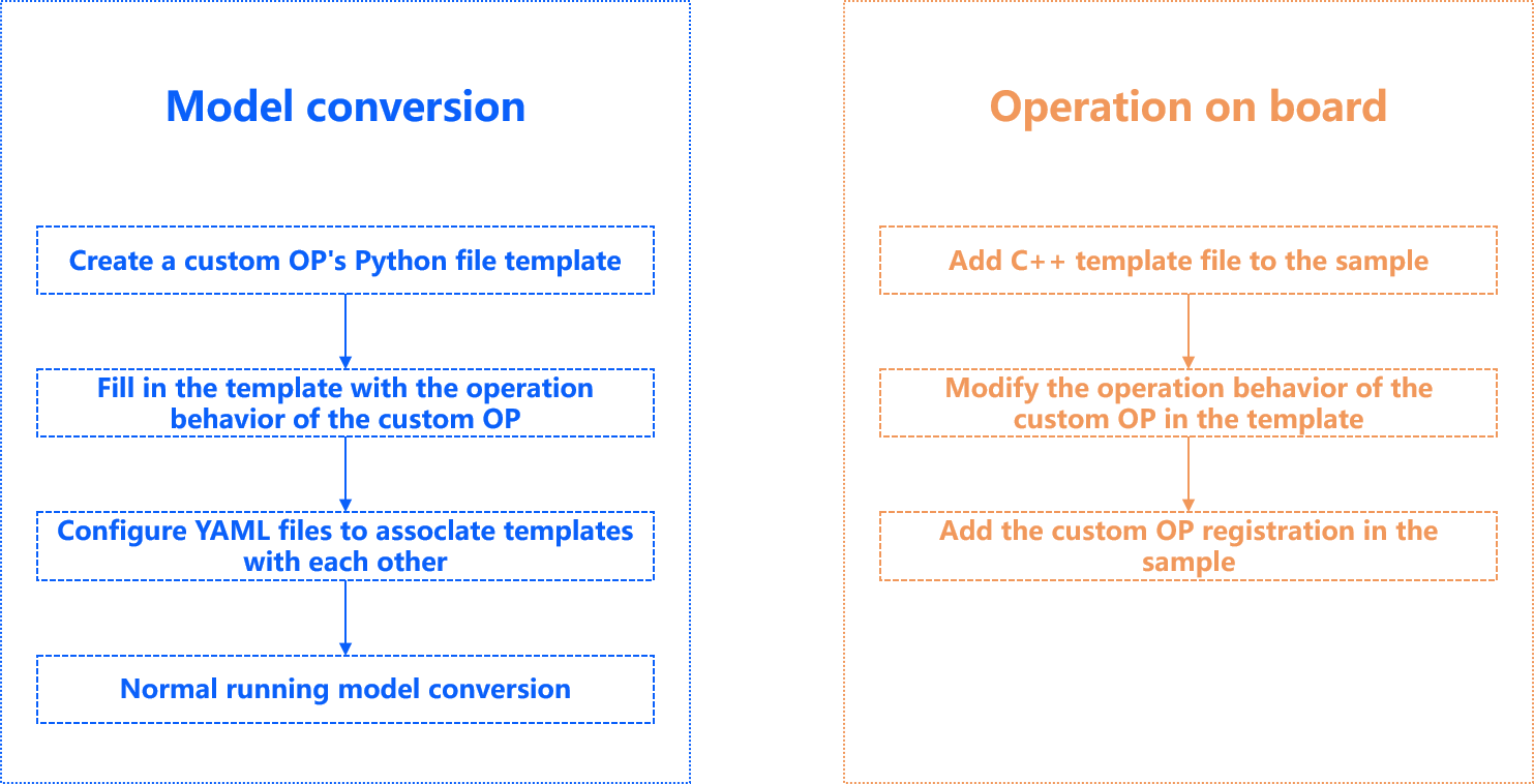

In most cases, your models should be able to be deployed into D-Robotics’ computing platform because the Algorithm Toolchain has provided rich OPs. The supported operators can be found in Model Conversion Toolchain Operator Support Constraint List section. But if you find that there are unsupported OP(s) in the models, we strongly suggested you to try to replace the unsupported OP(s) with those supported ones, so as to utilize D-Robotics’ computing platform capacities to the full, and the development cost will be lower.
The customized OP provides the ability to allow a customized operator to be computed on the CPU. A complete custom OP development process should include template creation, OP implementation, OP compilation, model conversion of customized OPs included and model execution of customized OPs included. Please refer to the following diagram:
../../../../_images/custom_op_development.png
As above shown, it takes 2 stages to define a customized OP: At model conversion stage, there must be the Python code of the customized OP; At simulator/dev board inference stage, there must be the customized OP and its C++ code. In addition, computation the codes in 2 stages must be consistent.
