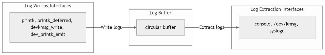

Linux 的日志系统主要可以分为三个主要部分:
  1. 日志缓冲区:日志缓冲区(log buffer)是日志系统核心组件。
  2. 日志写入:通过 printkprintk_deferreddevkmsg_writedev_printk_emit接口日志写入日志缓冲区。
  3. 日志提取:通过注册控制台(console)、/dev/kmsg 以及 syslogd提取日志信息。
三个部分可以描述下图:
log_system
log buffer

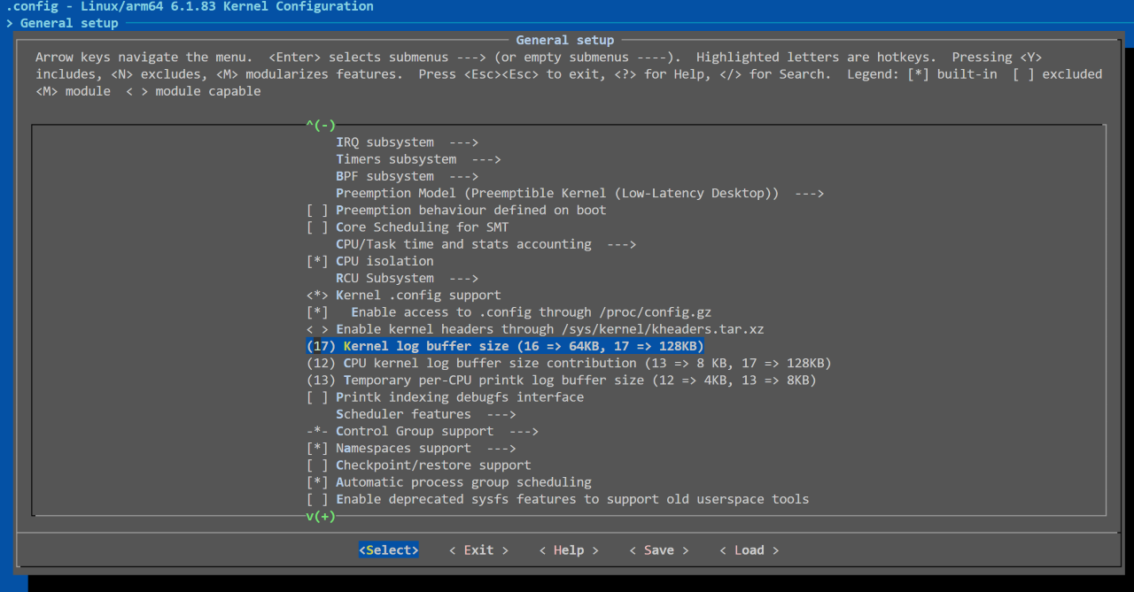

__LOG_BUF_LENCONFIG_LOG_BUF_SHIFT 影响,CONFIG_LOG_BUF_SHIFT 在 kernel config 中设置大小:
log_buf_size
可以看到,当前系统设置CONFIG_LOG_BUF_SHIFT 大小是17,所以 log buffer 的大小就是 2^17B(128KB)。若需修改 log buffer 大小,只在 menuconfig 中修改 CONFIG_LOG_BUF_SHIFT,然后重新编译内核镜像即可。
需要注意,在当前系统内核版本中(Linux V6.1.83) log buffer 的范围是 4KB ~ 32MB (CONFIG_LOG_BUF_SHIFT范围是12~25):
# init/Kconfig
config LOG_BUF_SHIFT
	int "Kernel log buffer size (16 => 64KB, 17 => 128KB)"
	range 12 25
	default 17
	depends on PRINTK
	help
	  Select the minimal kernel log buffer size as a power of 2.
	  The final size is affected by LOG_CPU_MAX_BUF_SHIFT config
	  parameter, see below. Any higher size also might be forced
	  by "log_buf_len" boot parameter.
	  Examples:
		     17 => 128 KB
		     16 => 64 KB
		     15 => 32 KB
		     14 => 16 KB
		     13 =>  8 KB
		     12 =>  4 KB

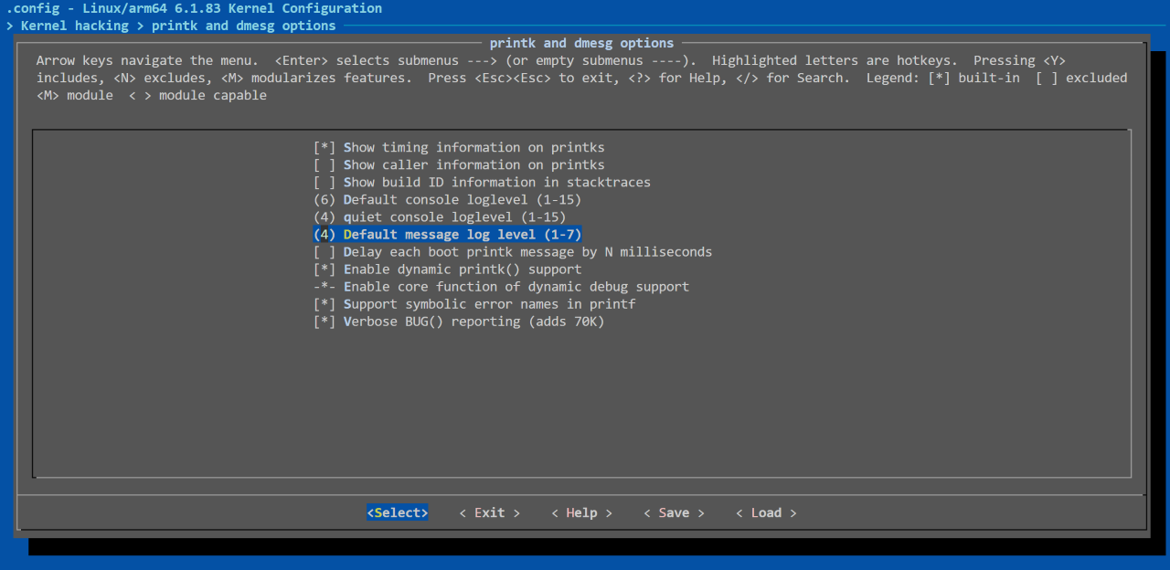

指定 log level,默认 loglevel 是 default_message_loglevel,默认为 4,也就是只会显示 KERN_WARNING 级别以上日志:
// kernel/include/linux/printk.h
#define default_message_loglevel (console_printk[1])
/* printk's without a loglevel use this.. */
#define MESSAGE_LOGLEVEL_DEFAULT CONFIG_MESSAGE_LOGLEVEL_DEFAULT
// kernel/kernel/printk/printk.c
int console_printk[4] = {
	CONSOLE_LOGLEVEL_DEFAULT,	/* console_loglevel */
	MESSAGE_LOGLEVEL_DEFAULT,	/* default_message_loglevel */
	CONSOLE_LOGLEVEL_MIN,		/* minimum_console_loglevel */
	CONSOLE_LOGLEVEL_DEFAULT,	/* default_console_loglevel */
default_message_loglevel实际就是 MESSAGE_LOGLEVEL_DEFAULT ,而 MESSAGE_LOGLEVEL_DEFAULT在 kernel config 中设置的:
MESSAGE_LOGLEVEL_DEFAULT取值范围是 1~7:
# lib/Kconfig.debug
config MESSAGE_LOGLEVEL_DEFAULT
	int "Default message log level (1-7)"
	range 1 7
	default "4"
	help
	  Default log level for printk statements with no specified priority.
	  This was hard-coded to KERN_WARNING since at least 2.6.10 but folks
	  that are auditing their logs closely may want to set it to a lower
	  priority.
	  Note: This does not affect what message level gets printed on the console
	  by default. To change that, use loglevel=<x> in the kernel bootargs,
	  or pick a different CONSOLE_LOGLEVEL_DEFAULT configuration value.

在 Linux 系统中,日志输出途径多种,其中包括通过 console/dev/kmsgsyslogd 提取日志。以下详细介绍三种主要日志提取方式。

查看系统使用日志等级信息:
root@buildroot:~# cat /proc/sys/kernel/printk
6       4       1       6
四个数字依次对应 console_logleveldefault_message_loglevelminimum_console_loglevel 以及 default_console_loglevel
  • console_loglevel:控制台使用日志级别;
  • default_message_loglevel:调用 printk() 未指定日志级别使用日志级别;
  • minimum_console_loglevel:允许设置控制台日志级别(console_loglevel)最小值;
  • default_console_loglevel:系统启动使用日志级别。
通常情况下,为了加速系统启动,系统启动信息非常少。比如 default_console_loglevelconsole_loglevel 为 4 的情况下,只能显示 err、crit、alert 和 emerg 等调式信息,所以,在内核模块调式需要调整日志显示级别。
控制台中,一般常用下面两种方式调整控制台输出日志详细程度:
1) 修改 proc/sys/kernel/printk
echo "8" > /proc/sys/kernel/printk
上述命令控制台日志级别设置8,显示所有级别日志。这里需要注意,控制台只会显示大于设置等级信息,所以,想要显示 debug 信息,console_loglevel 应设置大于 7值。另外,这种修改方式系统重启失效。

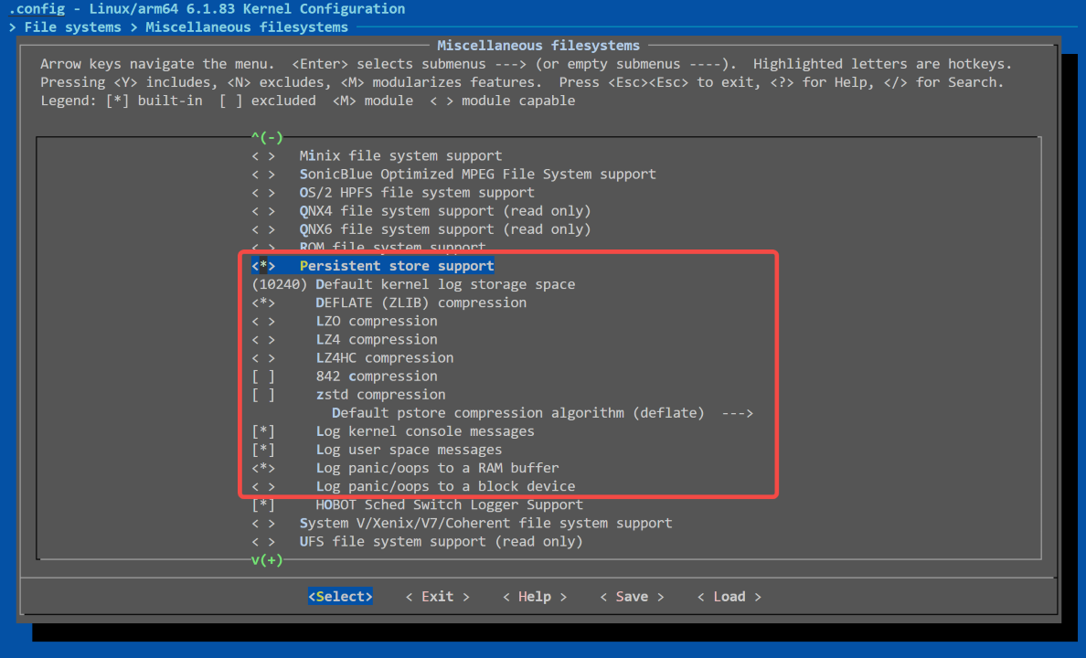

pstore
pstore(Persistent Store)是 Linux 内核提供一种机制,旨在关键错误信息(如内核崩溃日志、崩溃内存快照等)保存持久存储中(如闪存中),即使系统重启后,这些信息仍然可以访问分析。这有利于调试分析 Linux 系统硬件故障、内核崩溃、或者严重系统错误。
pstore 具有以下特点:
  1. 持久存储:pstore 可以重要内核调试信息(如 Oops 信息、内核崩溃日志等)保存持久存储设备中,这样即使系统重启后,依然可以获取崩溃信息。

启用 pstore 功能,需要内核配置启用相关选项(默认开启):
pstore
注意,这里配置 pstore 日志保存位置是 RAM 上,所以系统 panic 后那次自动重启才能/sys/fs/pstore看到相应日志,一旦掉电重启后,/sys/fs/pstore文件便会清空:
<*>     Log panic/oops to a RAM buffer
掉电重启需要转存目录 /userdata/log/pstore/查看最新一份日志。
