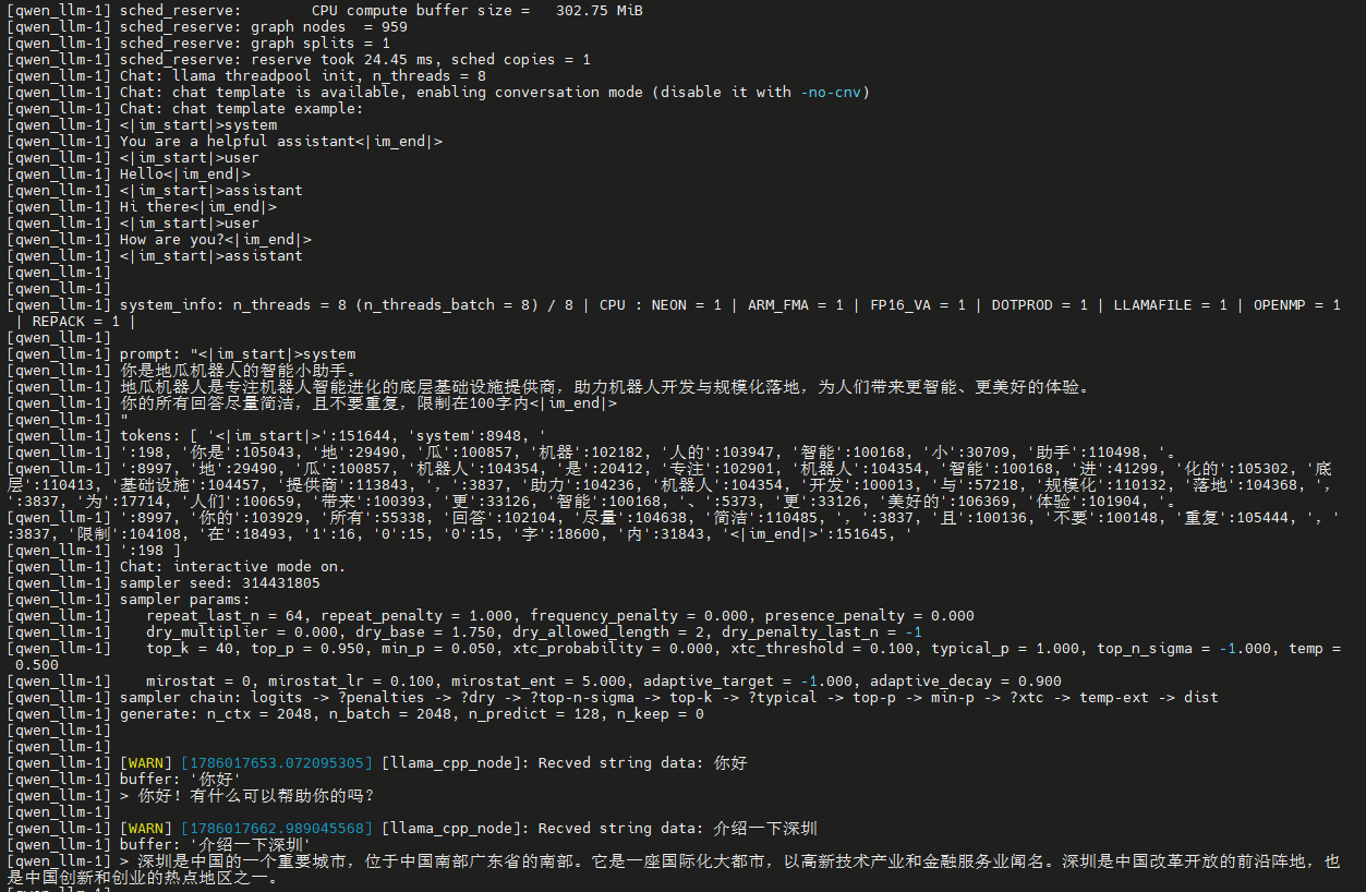

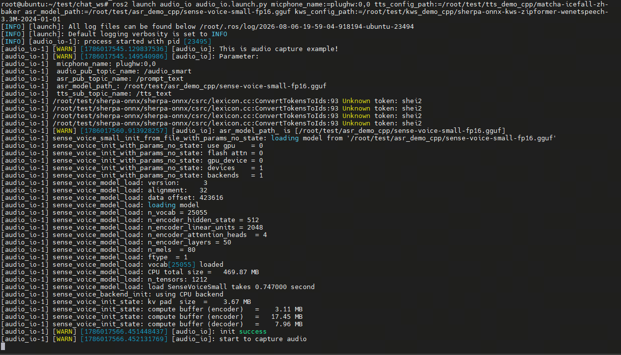

#设置TTS,ASR,KWS模型路径
#启动后加载模型较慢,请稍作等待
source chat_ws/install/setup.bash
ros2 launch audio_io audio_io.launch.py micphone_name:=plughw:2,0 tts_config_path:=/root/test/audio_demo/tts_demo_cpp/matcha-icefall-zh-baker asr_model_path:=/root/test/audio_demo/asr_demo_cpp/sense-voice-small-fp16.gguf kws_config_path:=/root/test/audio_demo/kws_demo_cpp/sherpa-onnx-kws-zipformer-wenetspeech-3.3M-2024-01-01
chatbot-result-screenshot-1
ros2 launch qwen_llm qwen_llm.launch.py llm_model_path:=/root/qwen2.5-1.5b-instruct-q5_k_m.gguf
chatbot-result-screenshot-2
