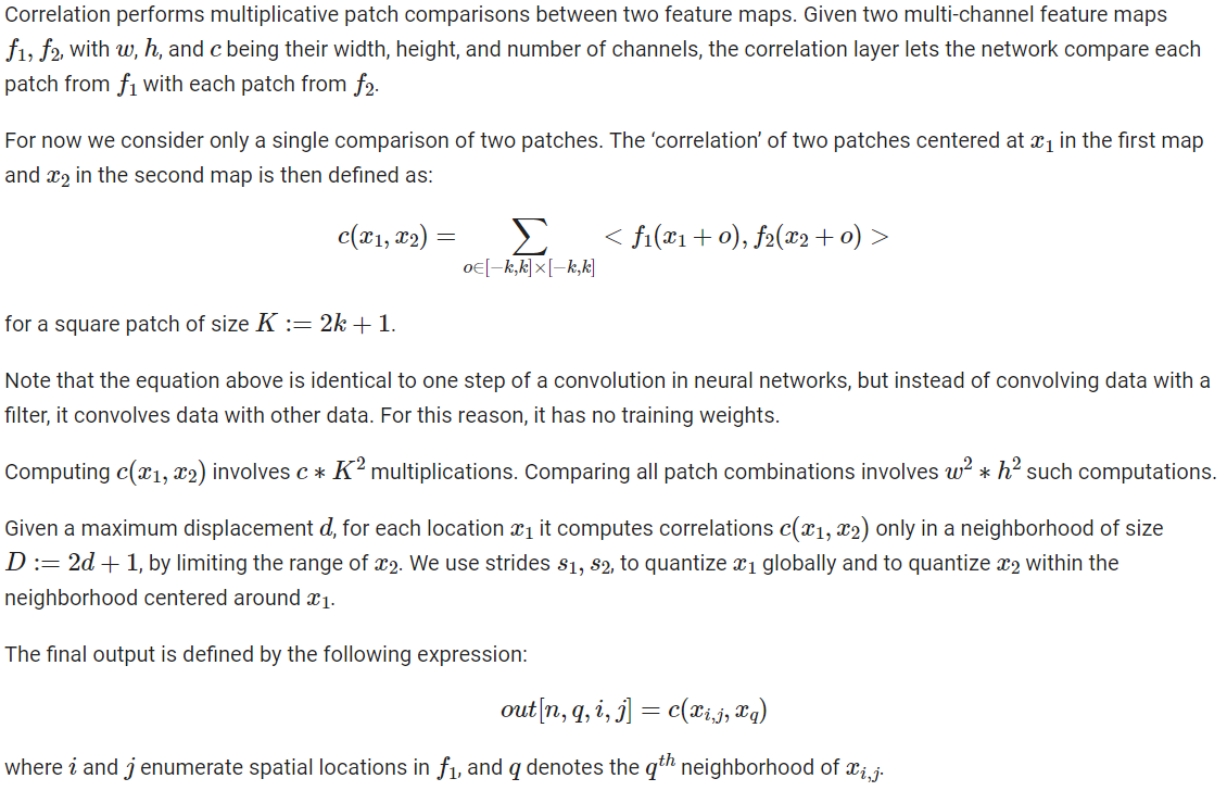

class horizon_plugin_pytorch.nn.Correlation(kernel_size: int = 1, max_displacement: int = 1, stride1: int = 1, stride2: int = 1, pad_size: int = 0, is_multiply: bool = True)
Perform multiplicative patch comparisons between two feature maps.
qat_correlation
参数
  • kernel_size – kernel size for Correlation must be an odd number
  • max_displacement – Max displacement of Correlation
  • stride1 – stride1 quantize data1 globally
  • stride2 – stride2 quantize data2 within neighborhood centered around data1
  • pad_size – pad for Correlation
  • is_multiply – operation type is either multiplication or subduction, only support True now
forward(data1: Union[torch.Tensor, horizon_plugin_pytorch.qtensor.QTensor], data2: Union[torch.Tensor, horizon_plugin_pytorch.qtensor.QTensor]) → torch.Tensor
Forward for Horizon Correlation.
参数
  • data1 – shape of [N,C,H,W]
  • data2 – shape of [N,C,H,W]
返回
output
返回类型
Tensor
