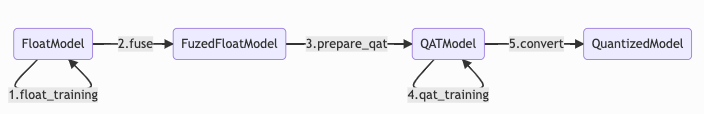

Workflow
The overall workflow for quantization-aware training (QAT) in eager mode is shown in the diagram below:
